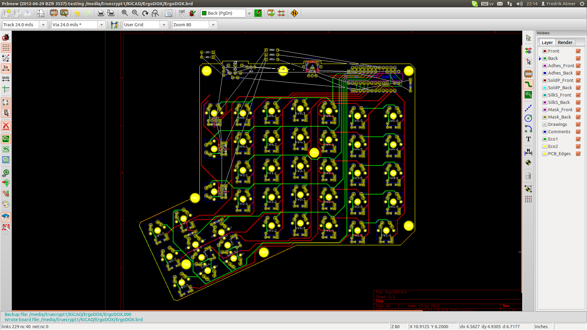

I think this is going to work out pretty smoothly =) I moved the Teensy a tiny tiny bit to the left. Is this going to cause any trouble? Also, dox, I think I will soon have come far enough to dare sharing the actual files.. I'll contact you by PM for your email.
Edit: Also I see my username changed as I requested (thanks webwit). No more Prins'ing me ;) You'll have to come up with something new...

bpiphany: Teensy moved to the left is good. You should add the holes for the reset pin on the teensy as the button is not accessible. It's easy to reset it just by jumping this pin to ground in case you load a bad firmware and you are unable to flash it with the bootloader key. PM replied.

I had a hole for reaching the reset pin but it ends up interfering with the pads for the expander =P The reset button will be accessible as long as the Teensy is mounted on the right hand part, as the design intends. And if mounted flipped on the left hand side, it is still very ease to activate the reset by shorting the reset pad on the short end of the Teensy board to the neighbouring GND pad. It is usually sufficient to just touch the reset pad with a needle or something else narrow and conducting (sometimes touching the GND pad first).

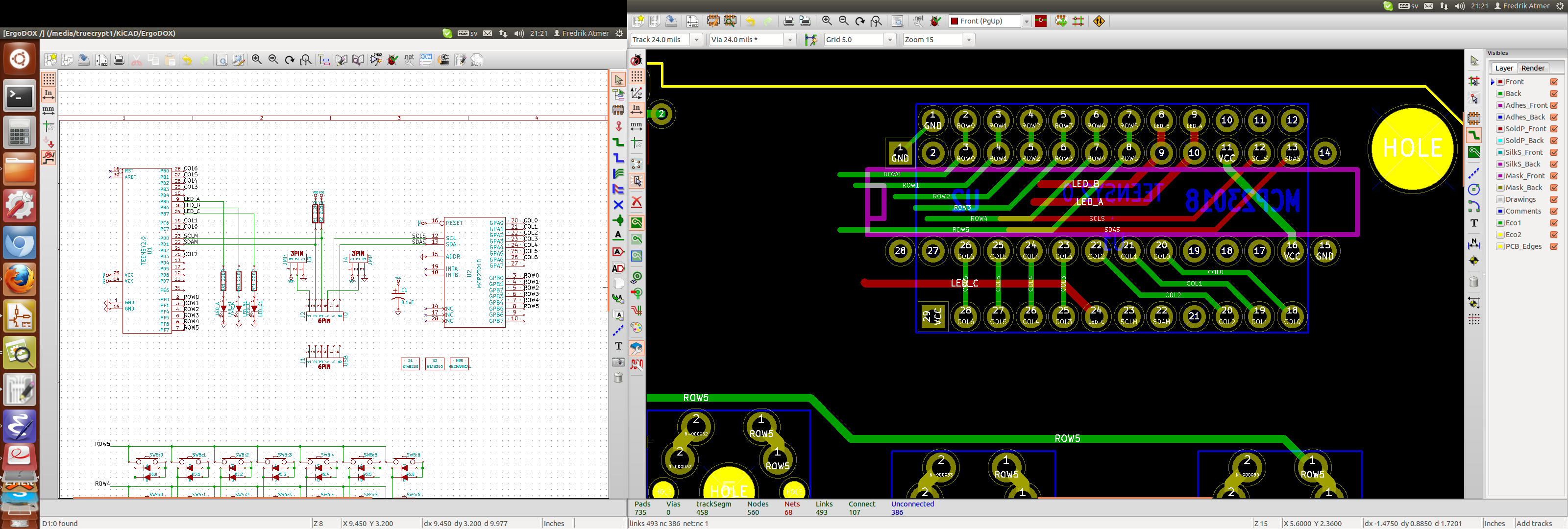

Having fun playing with KiCAD all day long =) I am going to have given Ben, the guy writing the firmware, a pretty good headache by now I suspect.. There is a lot left to do still, but the PCB is taking shape. Only need to convince the other guys my small changes are absolutely vital =D
