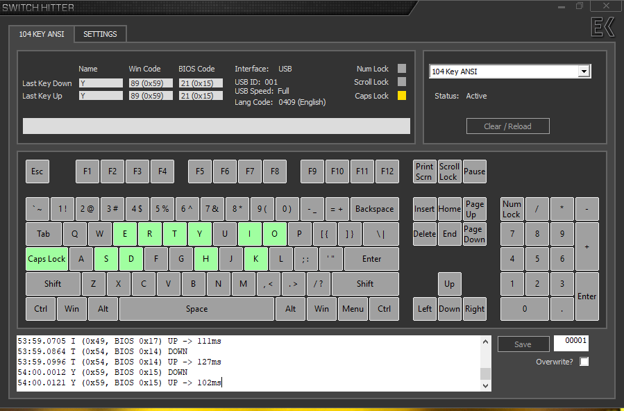

@Hasu, thanks for replying. As I said in the edits to my post:
I used the PS/2-USB Converter rev. 1 on the Hasu TMK Editor site to generate a modified hex file. I substituted the actual key functions rather than the spatial location of the keys. I uploaded the new hex file into my Teensy 2.0 setup, and it worked! I now seem to have a correctly functioning Z-150 keyboard with my HHKB-ish layout.
However, when I tried this with a Pro Micro using QMK Toolbox, it didn't work. QMK Toolbox showed that the flash was successful, but I could not get any response from the keyboard.
I might try this with a new Pro Micro. On the other hand, because it works with a Teensy 2.0, I may go ahead and make the converter with the Teensy. However, I need to do more typing tests first to be sure that there are no more missed or repeated key presses.
EDIT:
I am typing this on a Zenith Z-150 100-1886 Black Label XT-type keyboard using a Teensy 2.0 and a customized hex file generated using Hasu's online TMK editor. I used the PS/2 to USB rev.1 as a template and revised Hasu's latest XT hex file using the functional definition of the keys rather than their spatial location on the keyboard. I used the teensy.exe program in Windows to upload the hex files to the Teensy 2.0. I tried it out using a breadboard prototype with and without a 1kOhm pull-up resistor between Clock and Vcc and between Data and Vcc. The converter worked both ways, so I decided to simplify and wire it up without the resistors.
I have now done typing tests, and thus far, all the former problems have disappeared. No more unwanted key presses or missed key presses. In addition, the Right Shift no longer intermittently behaves as if it were the Caps Lock key.
Again, I have tried this using a Pro Micro Orihalcon internal converter that had been flashed with Soarer's converter. I used qmk_toolbox.exe to reflash the Pro Micro. The software indicated that the reflash was successful, but I cannot get any response from the keyboard. I think that the apparent discrepancy between the Teensy and the Pro Micro might be due to the different pin assignments.At some point, I might try revising the configuration file, but for the time being, I am going to use the Teensy with the teensy.exe loader software.
More's the pity, because the qmk_toolbox mades reflashing the Pro Micro very easy. You check the Auto-flash box so that it automatically loads the hex file when you reset the Pro Micro by shorting the reset and ground pins. With other software, after shorting the pins, you have 7 or 8 seconds to upload the hex file before it exits from upload mode.
BTW, I have been using Switch Hitter software, a free download from the EliteKeyboards site, as an alternative to hid_listen. This gives you a nice graphical display of the keyboard with each key lighting up as it registers. If chattering is detected, the key lights up in a different color. Switch Hitter is a Windows program, but I found that it runs in Linux with Wine -- the only things that don't work in Linux are the lock-light indicators.
