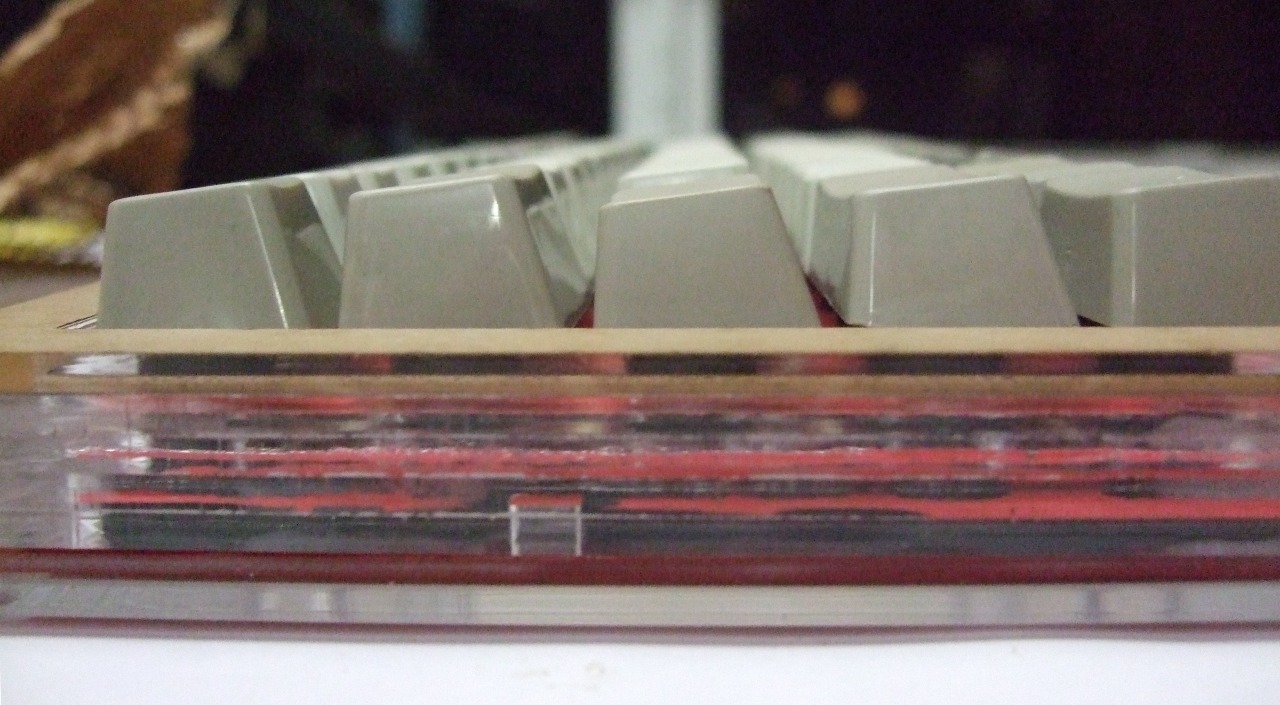

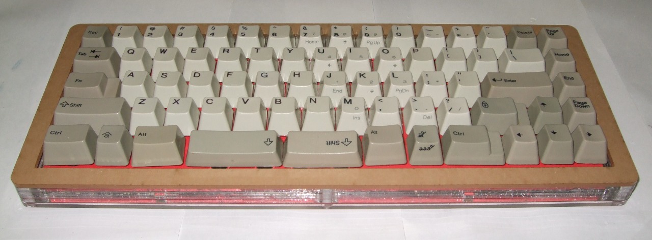

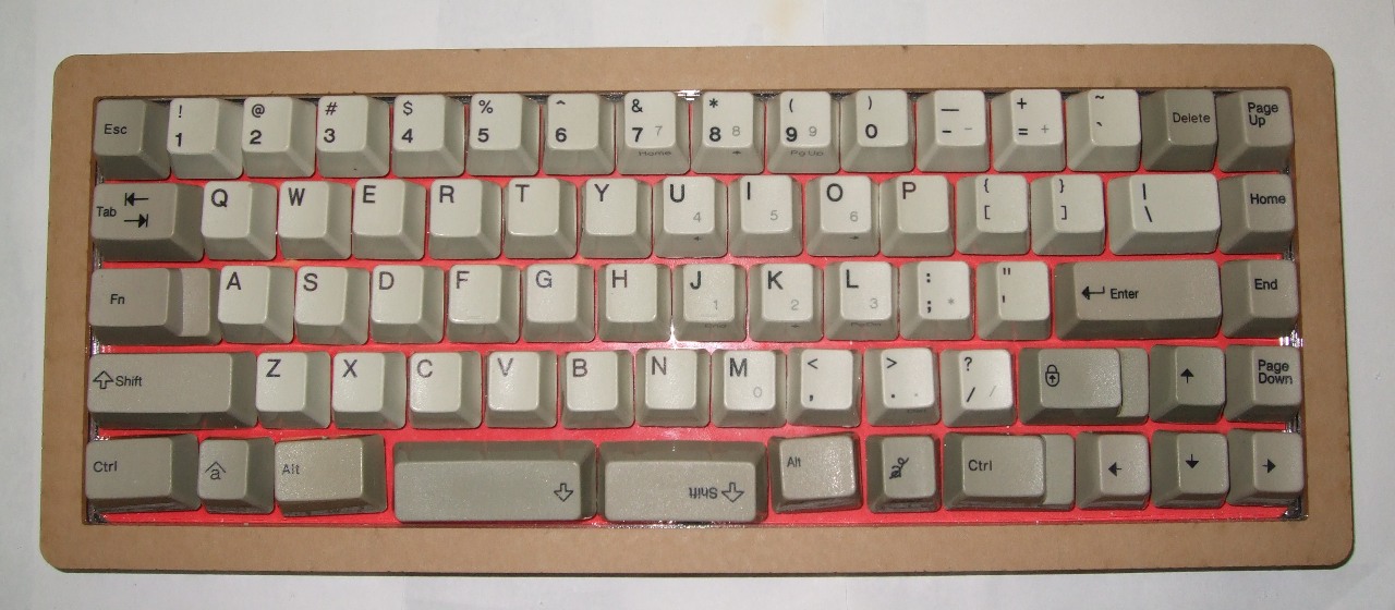

By request, a sound comparison video. My keyboard first, then a (mostly) stock IBM model M (case was dyed black). The camera is resting on the same table as the keyboards - about 4" away. YouTube says that it will be about an hour before the file is uploaded, sorry about that.
In the video, i type "the rain in spain falls mainly on the plain" on both keyboards, then type across the home row. Most of you guys know what a model M sounds like - i suggest that you adjust your volume so that the second keyboard sounds like what you remember in order to get a good idea about what the new keyboard sounds like.
[youtube]http://youtu.be/_5Ni1_zs3AU[/youtube]
test assembled angle2.JPG (125.25 KiB) Viewed 12938 times
test assembled top2.JPG (167.66 KiB) Viewed 12938 times
test assembled side.JPG.JPG (212.08 KiB) Viewed 12938 times

I like the muted click from your acrylic board much better than the original. Thanks for posting. Nice comparison

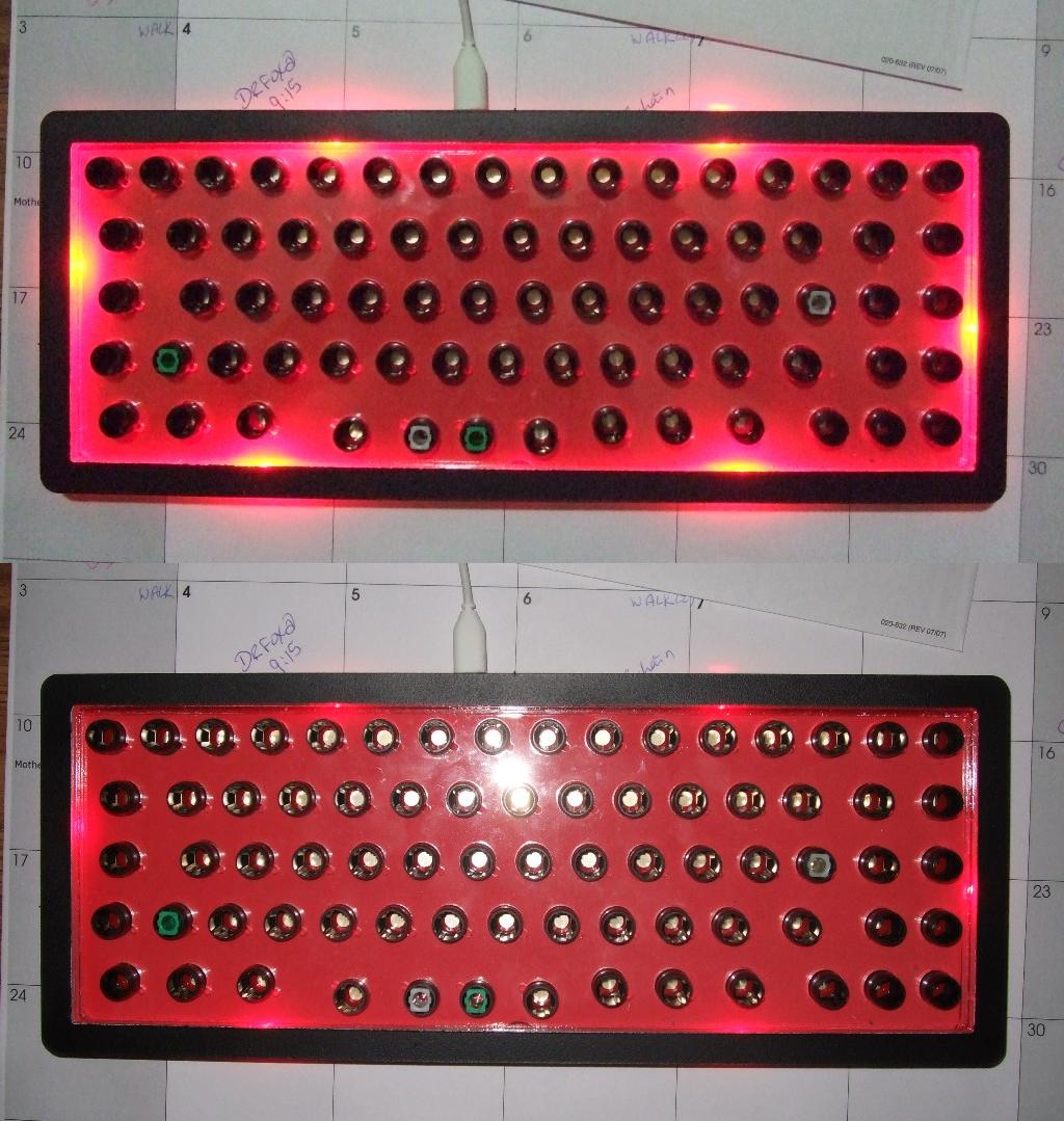

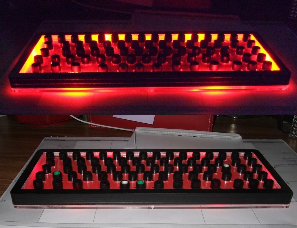

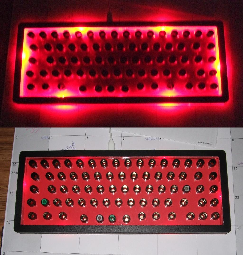

This is probably the last update from me until after the KeyCon. I want to get the keyboard to look and feel as much like the final product as i can - considering that I still don't have a real top membrane or programmed controller yet. To achieve this, i painted the case (3 white base coats and 3 black coats) and hot-wired the LEDs. FYI, it is really difficult to capture light effects with a point-and-shoot camera - if you use a flash, it washes out the effect, but without a flash the LED appear much brighter than they really are. My camera does that "with-flash-without-flash-double-shot" thing, so here they are.

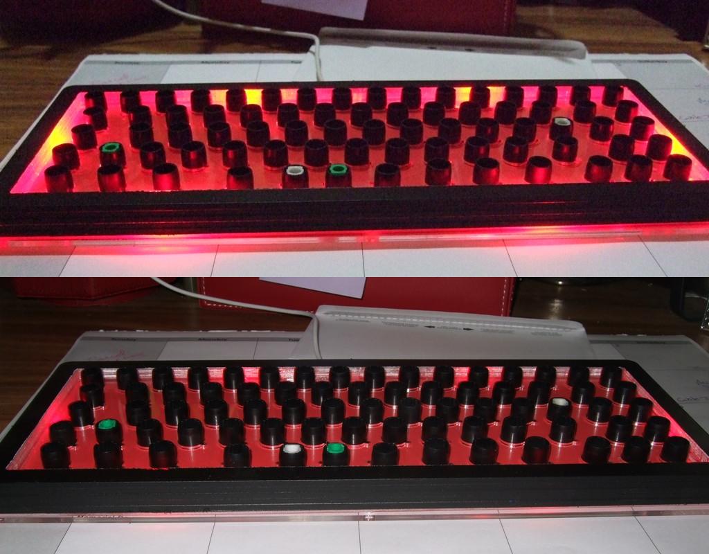

First, these shots taken in a brightly lit room.
And now some shots with the room lights off.
If you average the with/without flash, it would be much closer to the actual visual effect. Yes, there are LED hotspots, but they don't look yellow at all, or as blinding as they do in the "no-flash" shots.
wcass
11 May 2015, 05:57

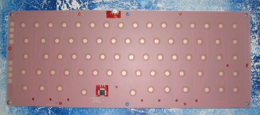

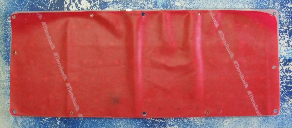

Hot-wired LEDs = Instead of the LED's coming from the controller, they are connected directly to +5 and it has 150 ohm resistors instead of 56 ohm as it will when coming from the 3.3v output of the controller. The LEDs are rated at 20 mA, but i'm driving them at about 6 mA (one resistor and three LEDs x two lines). I double-checked the documentation before i soldered on the LEDs but still managed to install all of the LEDs backward the first time. It is tradition to mark the cathode, right? Well, not this guy.
I also wanted to show you the custom separator, the "stand-in for the top membrane", and the rubber mat. The separator is 5 mil (just like IBM model M), the top membrane is 4 mil (IBM used 3 mil), and the rubber mat is 8 mil (same as IBM). All were punched by hand. Laser cut would be nice.
fake top membrane.JPG (75.79 KiB) Viewed 12566 times
rubber mat.JPG (98.11 KiB) Viewed 12566 times

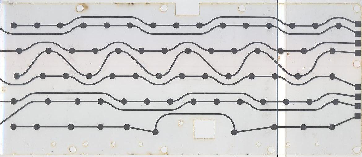

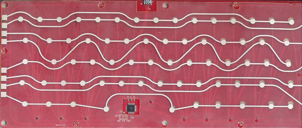

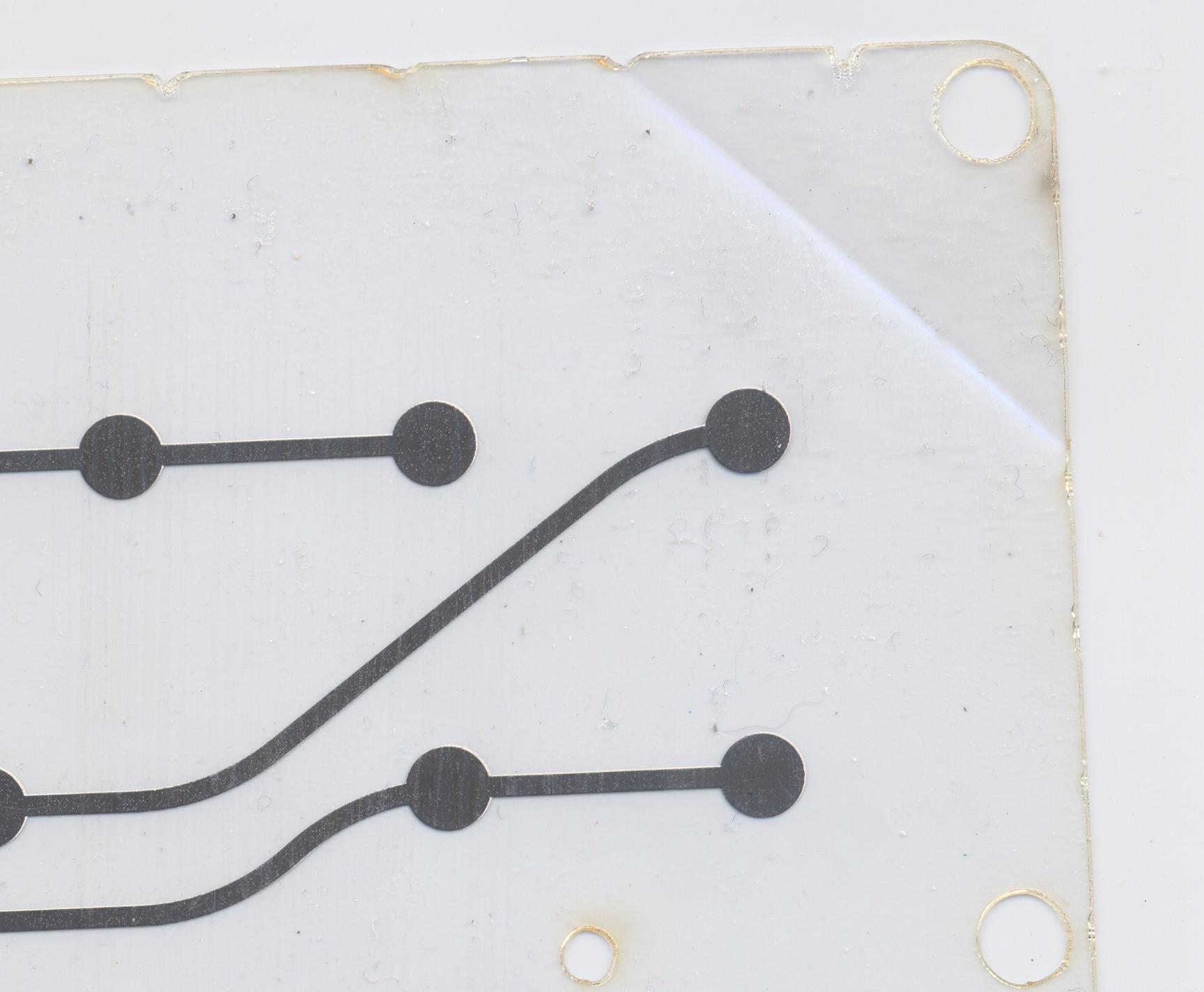

When I sent out RFQ for membranes, i asked for 10 copies of my design (attached PDF, DXF, and gerbers), "conductive silver ink on 3 or 4 mil PET substrate". I sent requests to about 20 printers in the US and about 4 in China. I got replies back from about half. The quotes from the US vendors were between $230 and >$1000. Some were helpful with little tips like "We know you specified the .003 but we have found that thin of material likes to crinkle and float around in our dryer. We can go to a .005 but prefer .007 thickness."
In the end, i went with the low bid of $80 (+30 for shipping) from China. There were several communication issues, but I believed that all that was resolved. The membranes came in on Thursday, but i have been too busy to get a good look at them until today. My first impression was ... WTF? On one side the traces are silver-white but on the other side they are black. There is noticeable scorching, a crease, and it feels too thick.
The first thing i did today was to get out the multimeter and check the resistance from start to end of the longest trace. I suspect that the black is carbon and would be very resistive. Well, it might be carbon, but the traces are not any more resistive than a 25 year old model M membrane, so the color of the trace is not a concern. Only one of the ten has a crease and that is in a corner not near any of the traces. The cuts and print line up perfectly with the PCB. The scorched edges are mostly cosmetic, but the thing i am most concerned with is that the substrate is 10 mil (and up to 15 mil near some of the laser cuts). I'll try these out an hope that 10 mil is not too thick.
membrane 001.jpg (78 KiB) Viewed 12416 times
membrane 002.jpg (126.66 KiB) Viewed 12416 times
