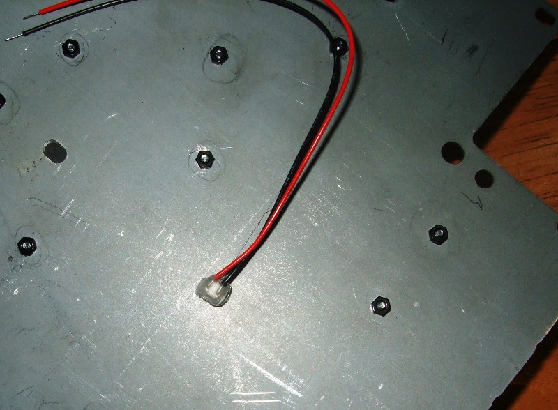

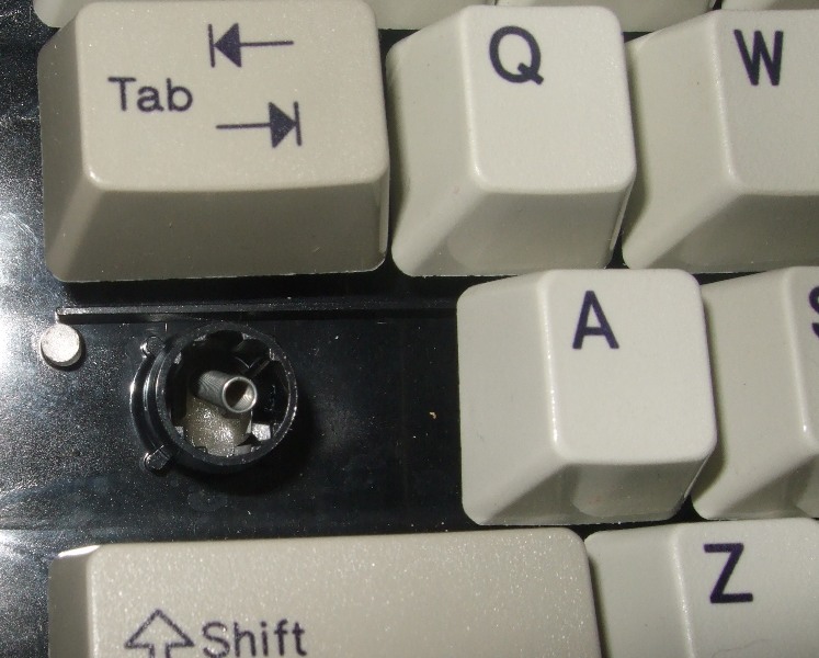

wcass
21 Aug 2016, 18:00
Re LEDs ... I've used light pipes to very nice effect on my custom model M. The light pipe takes the place of any bolt from a bolt mod. This build is not using most of the bolt holes, but we could add one one or more where space allows.

lot_lizard
21 Aug 2016, 18:14
@WCass... What do you think about a membrane style circuit that sits between the foam and top plate that has integrated LEDs? We would have a cutout in front of each barrel that the LEDs rise up into. Then all the "wiring" is contained in the assembly, and could be installed as a single sheet across the entire board at once. Crazy talk, or reasonable? We would still vote for even wanting it in the end, but looking for plausibility and a guess at the manufacturing cost
21 Aug 2016, 18:27
I would never use backlighting myself, but can you get it thin enough?
I have had trouble with "Z" shaped sheet metal brackets to convert Fs to use M spacebar wires - even the slightest bit too tall and they interfere with the downstroke of the key cap.
