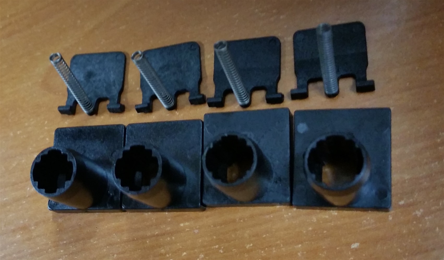

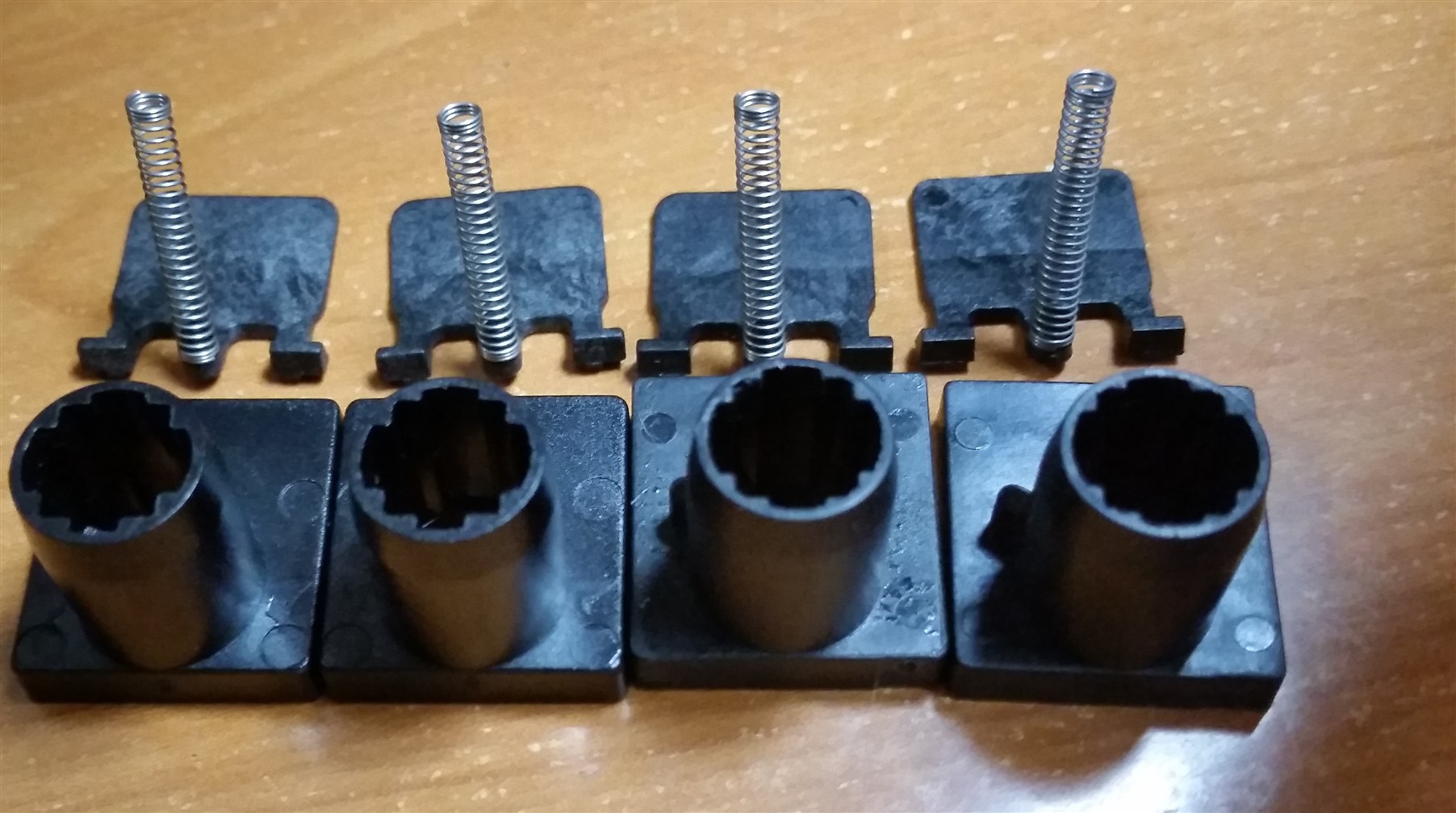

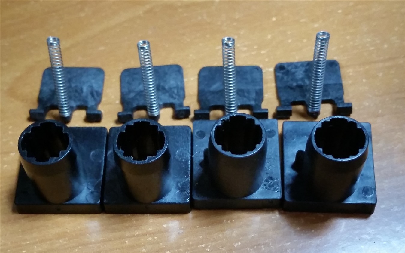

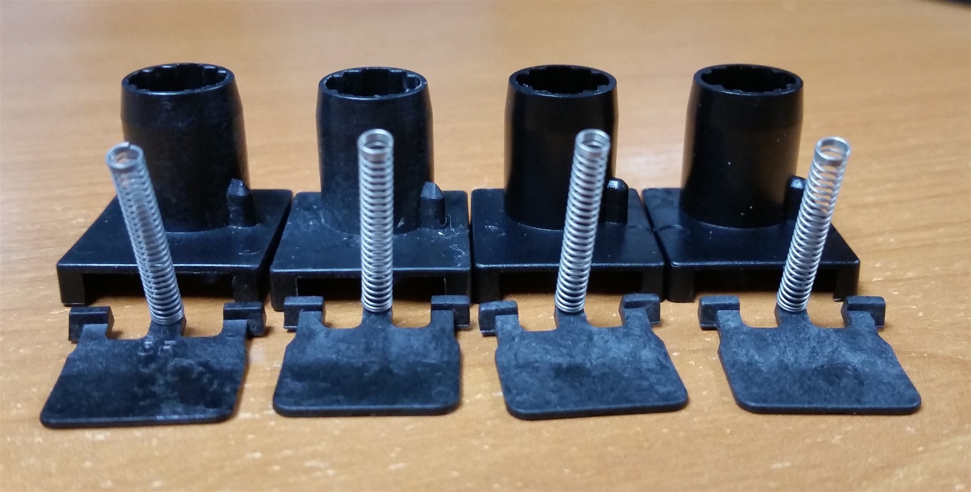

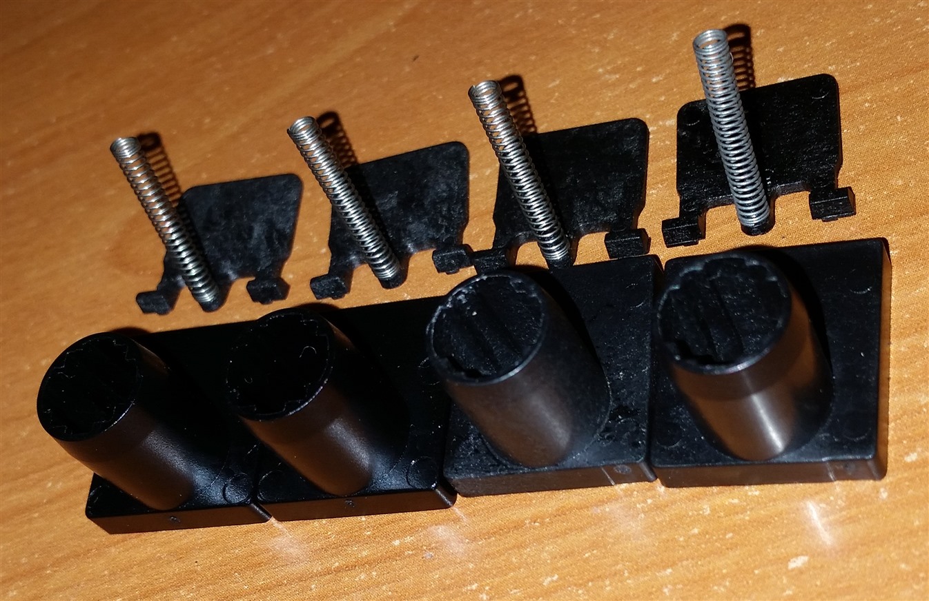

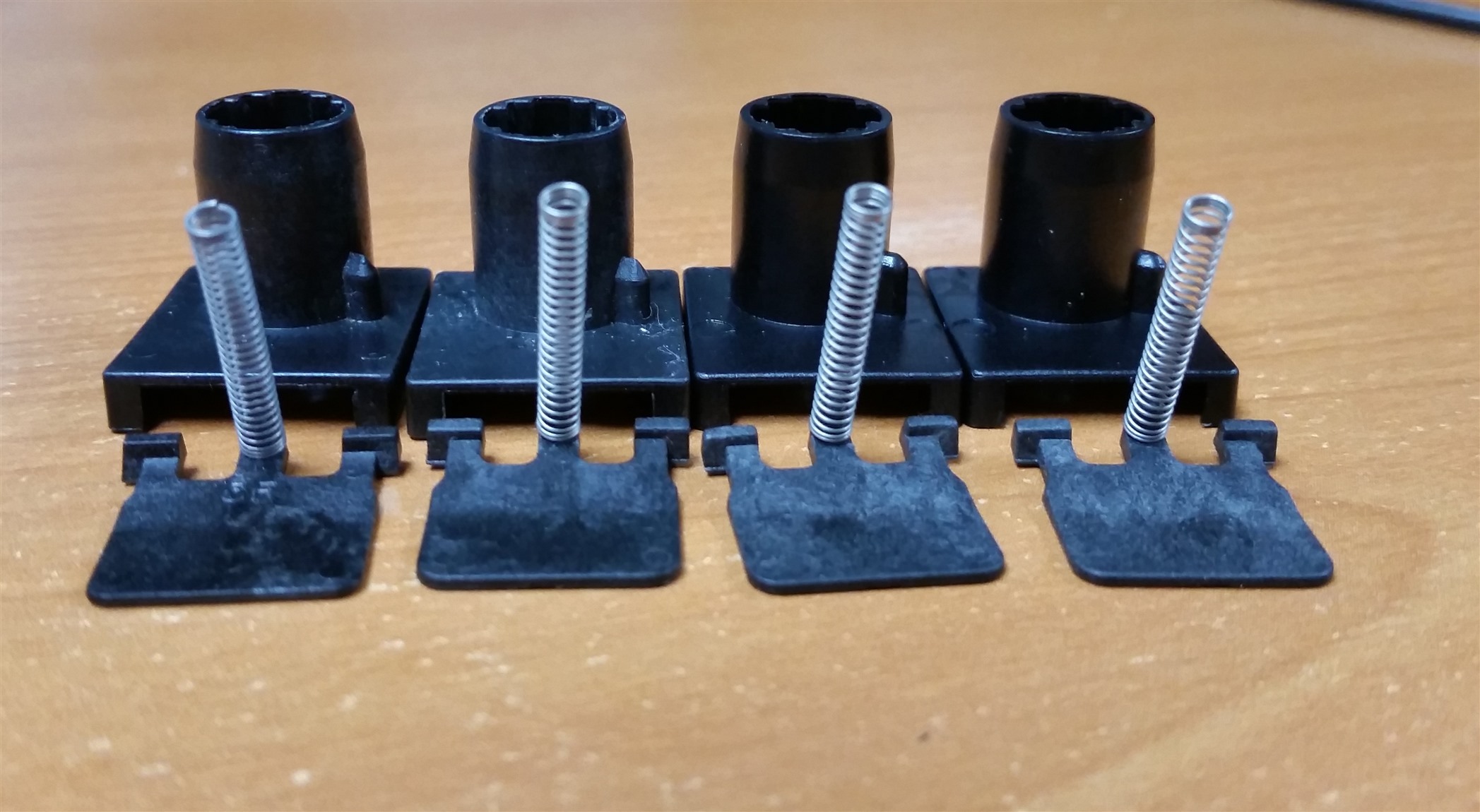

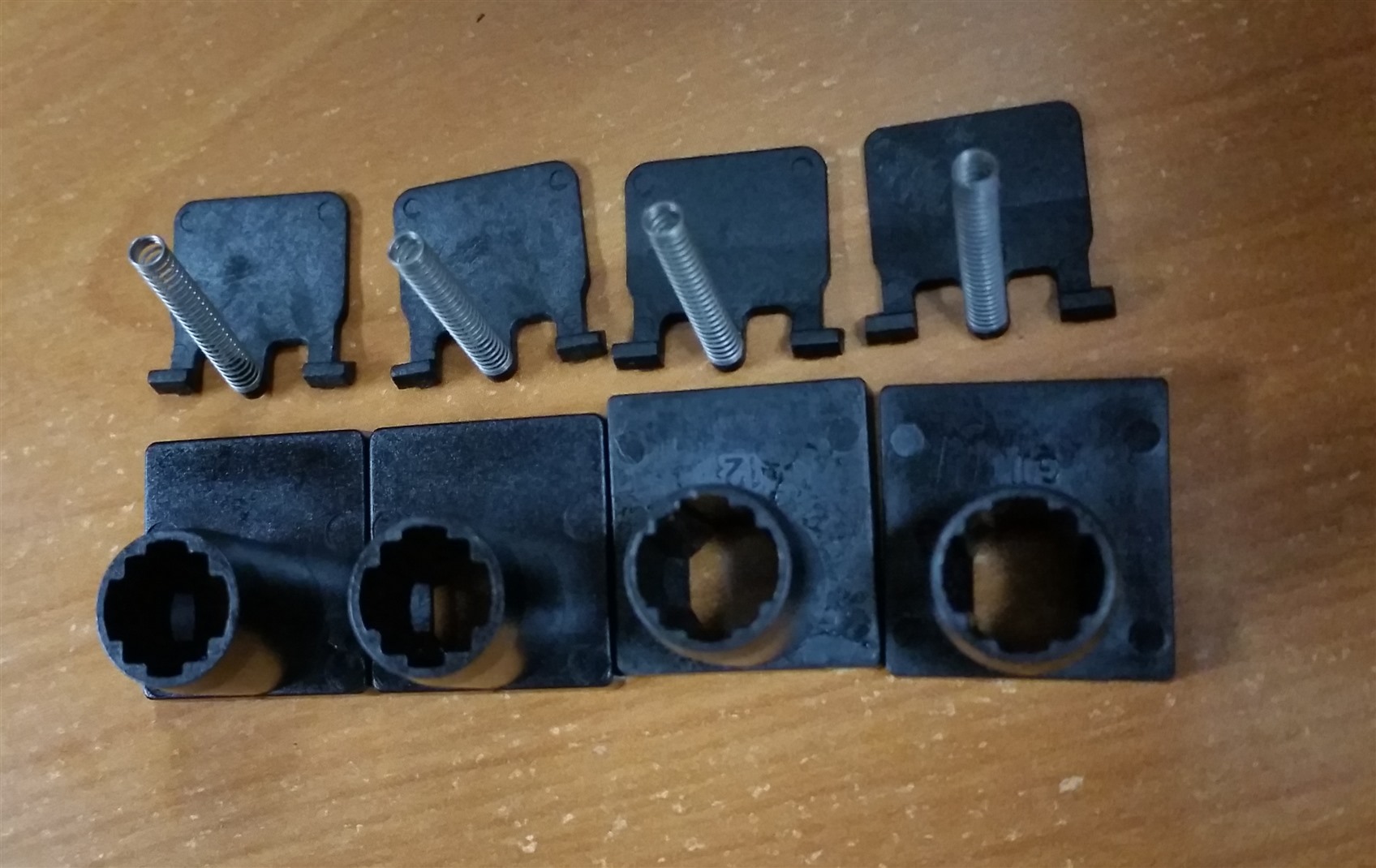

Major update: The sample barrels, springs and flippers have arrived! They all appear to be very good quality and the correct materials for this project.
After some brief testing the flippers work! This is a major relief that the plastic might not prove correct. The new flippers convey key presses firmly and accurately as well as the originals, from my initial testing (of course extensive testing will be done after the full prototypes arrive). The new springs are also excellent and require the same amount of force to buckle as original Model F springs. They fit on the flippers well.
Unfortunately the barrels will need a few 0.1 mm adjustments in the molds before they are excellent (the insides of the new barrels require a little more room to match the originals). I filed down one sample barrel 0.1 mm in the needed areas to correct this issue and the new barrel is just as smooth in operation as the originals. This will likely cause a delay in the project unfortunately.
To show how similar my units are to the originals, in the photos I have included a mix of original barrels/flippers/springs as well as the reproductions that arrived today.
Can you tell which ones in the photos are originals and which ones are the new ones?

Nice! Using the view with springs in front, I'd guess the new ones are the two sets of barrels and corresponding springs/pivot plates on the right side. Originals are the two sets on the left.
Posted: 02 Dec 2015, 03:12
by webwit
When I saw the first photo, I guessed the opposite, because the ones on the right have more dust and look older. Could be the light.
Edit: That's from the opposite view, so we're talking the same thing.

by wcass
I agree that they look excellent!
There's one give-away. IBM made so many of these that they numbered the molds (probably to track when they needed to replace them). Look for the numbers and you will find the originals.

Interesting. The profiles of the new barrels are visibly different than the originals. I guess that's where the 1mm difference lies.

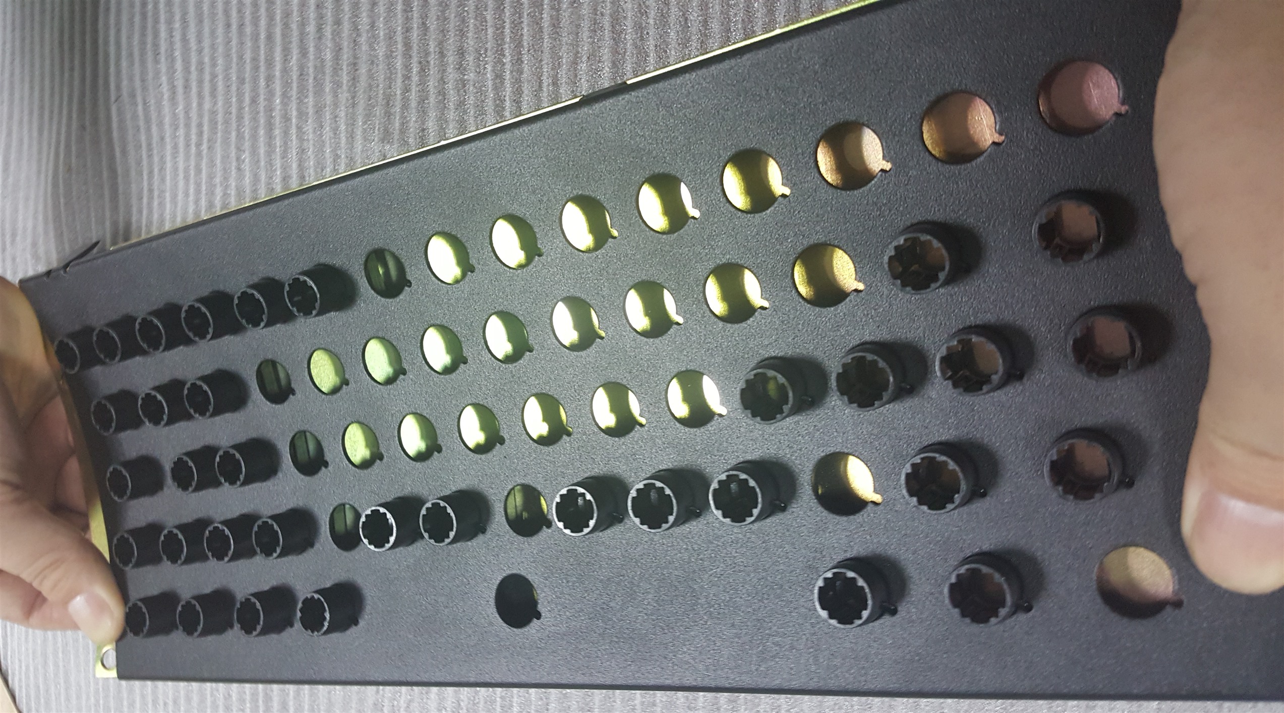

The factory is continuing to do the testing and they have been very kind to document their progress with many of the photos I've been posting. In this recent photo they are checking the fit of top inner assembly with the barrels. They confirmed that it is a good tight fit, even with foam and the space needed for the capacitive PCB. Too tight a fit and it could scratch the barrels or powdercoated paint, while too loose a fit and there may be more barrel movement than the movement allowed by the original standards.

The cut outs for the key on the side of the barrels do not look very uniform to me. Is this just a prototype ?

andrewjoy wrote: The cut outs for the key on the side of the barrels do not look very uniform to me. Is this just a prototype ?
I wondered about that, too.
In the "middle of the field" it won't matter because they stand shoulder-to-shoulder and keep themselves in place, but around the periphery the alignment tabs are more important. Anyway, once seated in the foam they should be stable.

From a production standpoint would the XT style not have been a better call ?

I think it is more of an optical illusion as the picture is of on an angle to a curved plate.
Posted: 03 Dec 2015, 18:55
by chzel
Codemonkeymike, as I understand it, andrewjoy means the locating notch. Some of them show very clearly and not so gracefully that they are a 3 part operation, drill large hole, drill small hole, remove bridge. Look at the lower right. It's more evident there.
I imagine that the final plates will be stamped, eliminating this issue.

I see what you mean, I thought he was saying the issue is with the alignment of the holes across the row.

Yep when I get the prototypes I will be sure to inspect them closely. If they are not good I will send them back. That bottom right hole does look a bit odd in the photo and I am waiting to hear back from the factory.

It's not just that bottom right one - pretty much every barrel hole in that pic has some issues.
Can you get a pic of how the bases of the barrels align on the back side of the plate?

010 I have reached out to the factory for some higher resolution photos of the top inner assemblies with no barrels installed.
They do not yet have the foam I'm using, so I can't send the bottom alignment. I did open up my original F77 and put some of the new barrels and flippers in as an initial test, and all worked well.
