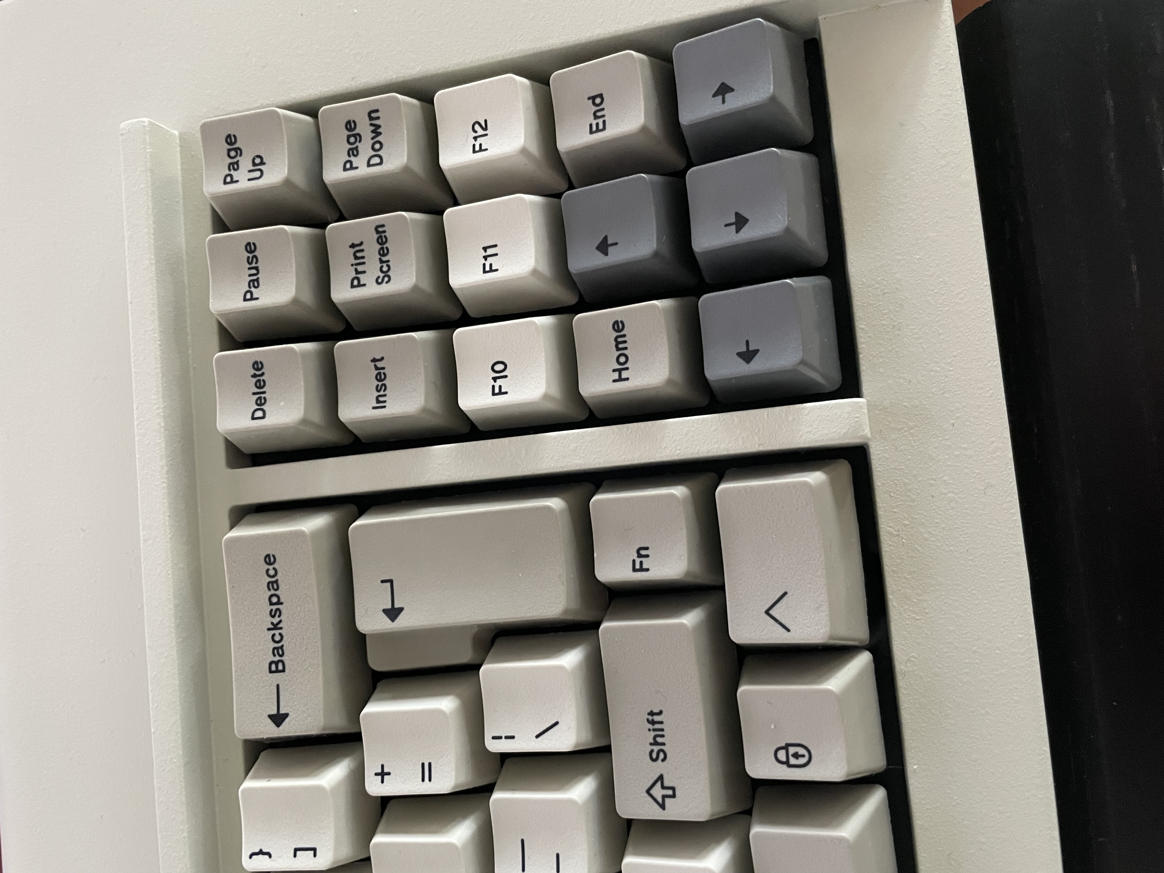

Arkku wrote: 05 Aug 2022, 19:41 The keys in the numpad section of the F77 do all have flippers, though. Or, at least mine did, even though the keyboard was ordered with the arrow key layout that has two blank keys. (edit: Actually, they must have flippers on all keyboards, so that they can have springs, because without springs the keycaps would not sit at the correct level.)
Agreed. Mine came with flippers there, too. Hopefully pandrew will recant his decision to set those to KC_NO in VIA and turn them on by default. I bet almost everyone wants to use those keys. I mean, why waste them, right? :mrgreen:

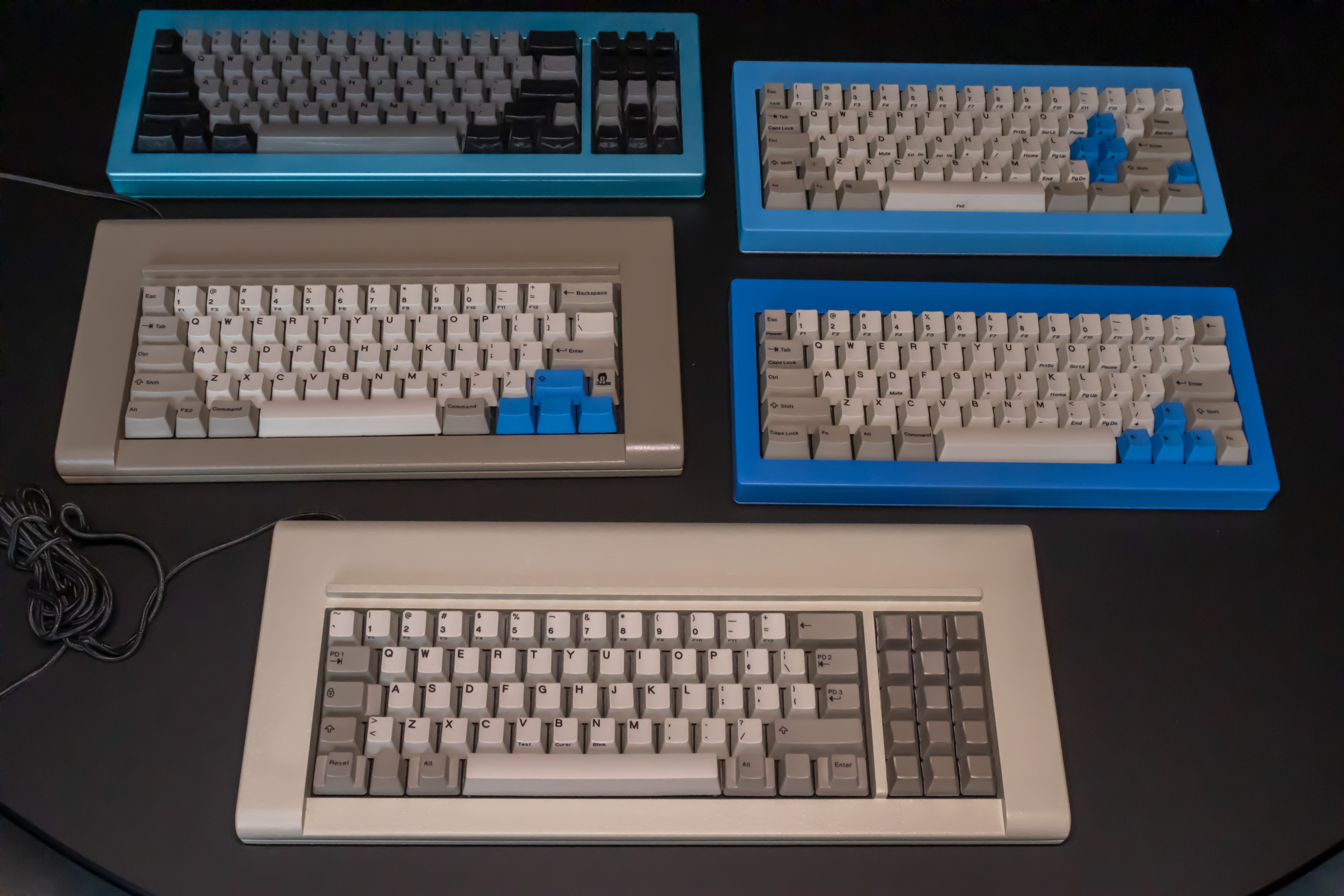

darkcruix wrote: 10 Aug 2022, 20:54 Brand New Model F family ...
Where did you get the short space that leaves room for an extra key on the left, I didn't notice it being available? What position is that in the keymap?
P. S. Nice keyboards! =)

Arkku it looks like that's the scumnc / scumyc layout - the only custom PCB layout available for the new Model F project.

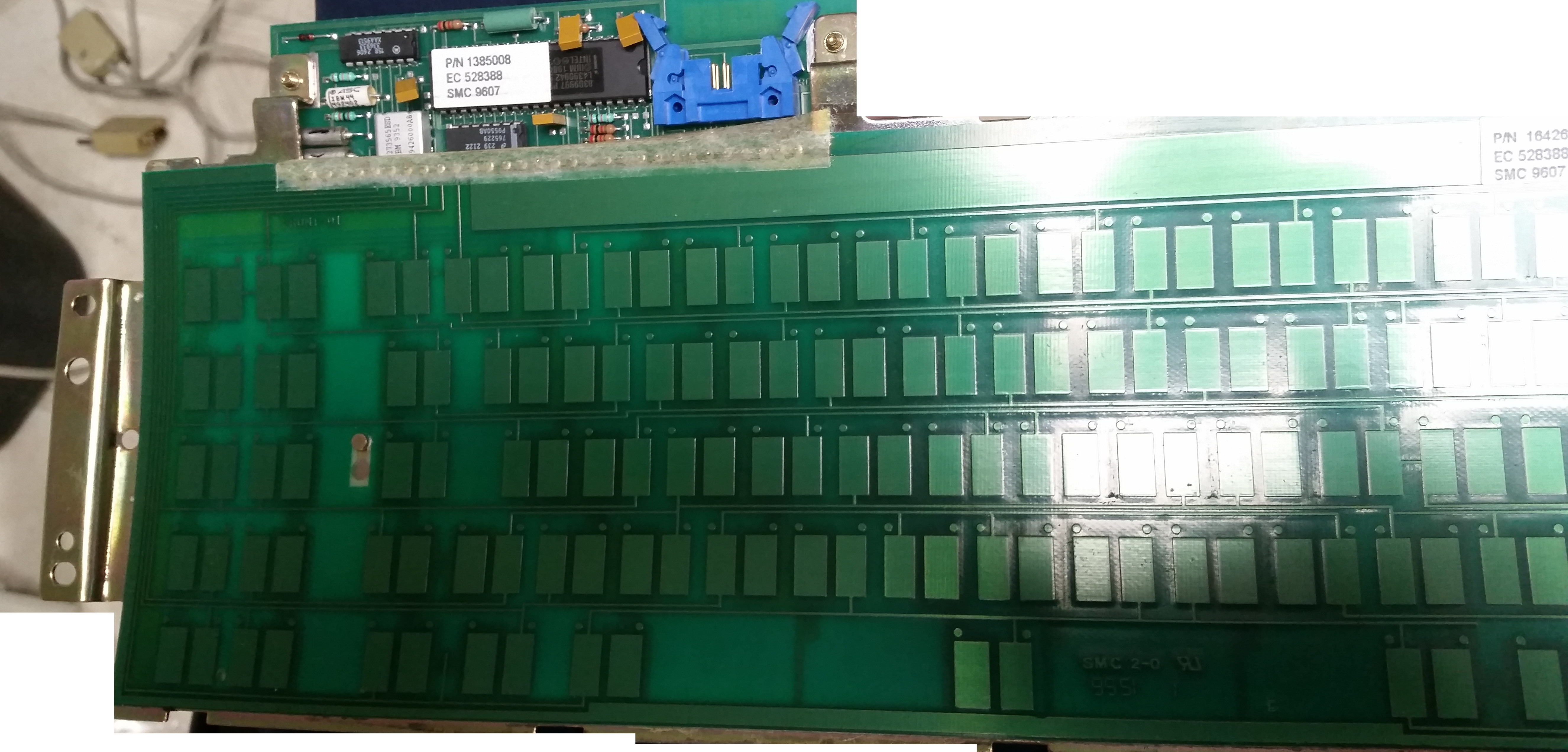

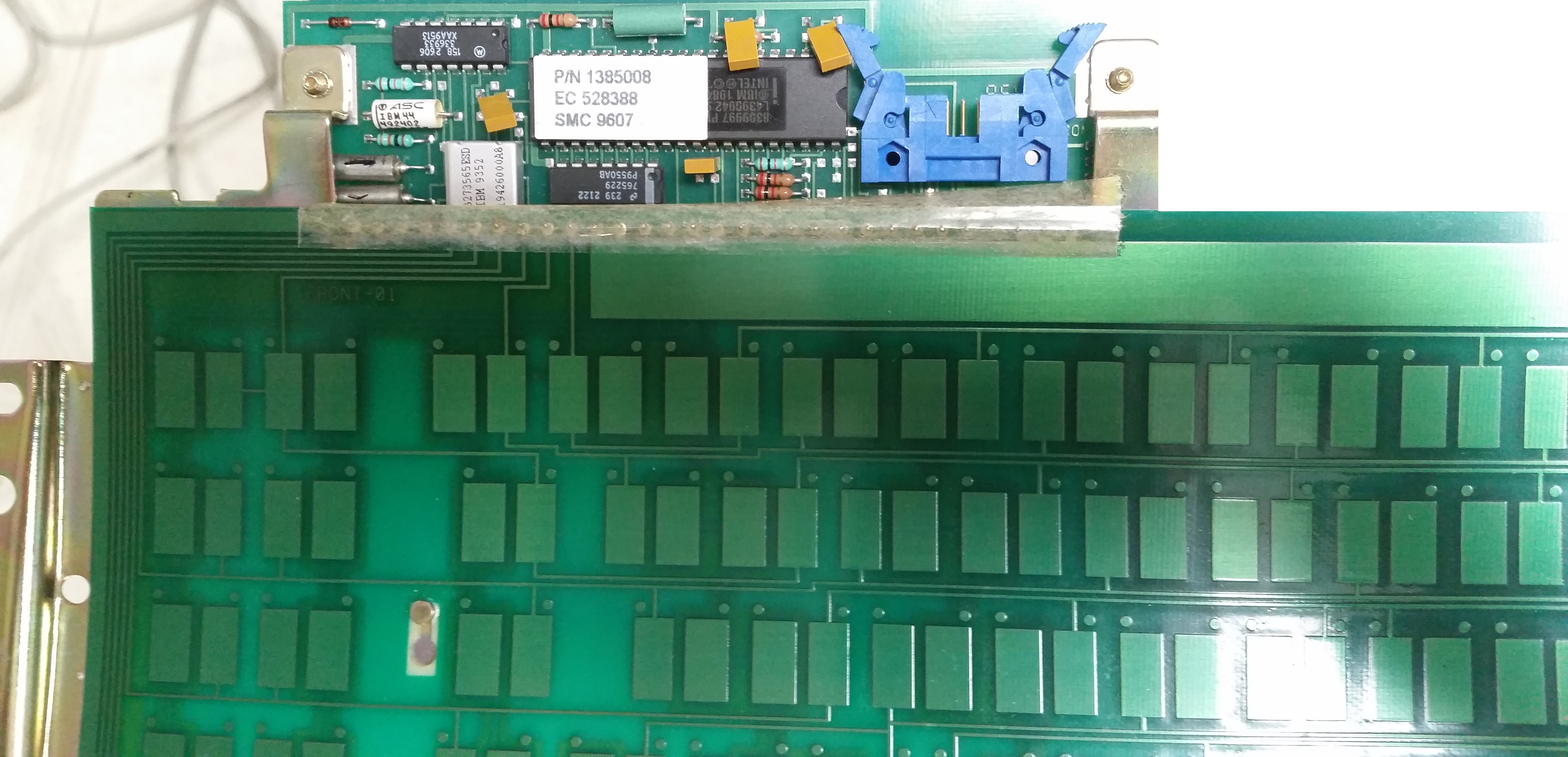

If they do not know already, I wanted to let folks know of a great Model F history resource in addition to the Deskthority wiki - lots of great photos and information: https://sharktastica.co.uk/wiki?id=modelf
I am wondering which person has photos of among the last production line Model F keyboards made from all new parts, if they have labels of all the various dated components in the board (the WWYY of the controller or capacitive PCB, labels on cables, the case bottom label, etc.). Some F107s formerly in my collection I believe had everything dated 1990; personally I have not seen any all 1991 Model F keyboards. Shark has noted a 1992 Unsaver photographed here, as well as 1994-made (or refurbed?) 5291s: http://kishy.ca/?p=1606 As shark notes on the wiki site, Lexmark did refurbish keyboards well into the 1990s, as late as 1996. I can confirm several of my F107s had controllers and capacitive PCBs with production dates of 1996 while the rest of the keyboards clearly had components dated in the prior decade, including the F107's metal cases.
I wonder what is the latest all new production of each model F122, XT, AT, etc.
F107 1996 PCB refurb (2) - Copy.jpg (2.45 MiB) Viewed 27331 times
F107 1996 PCB refurb (1) - Copy.jpg (2 MiB) Viewed 27331 times

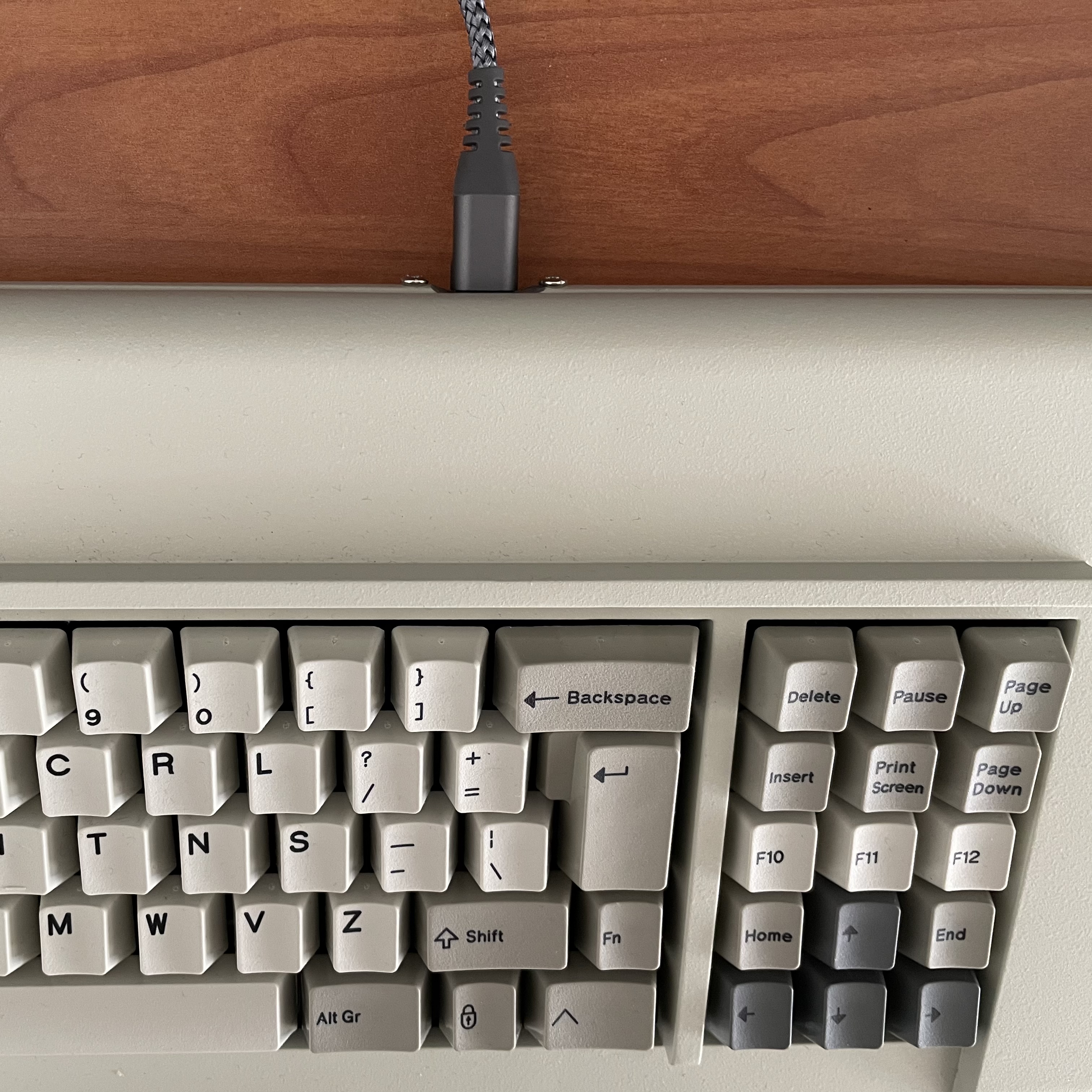

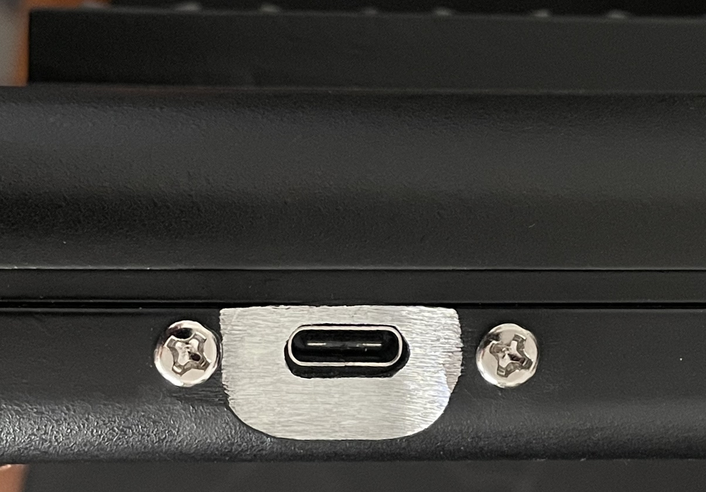

So, I modified my F77 and F62 to have a detachable USB-C cable. Even though it looks clearly DIY, I actually prefer this panel-mounted connector over the ultra-compact version's PCB-mounted connector accessed through a hole. And if the connector wears out or breaks, it's like €10 to replace the extension cord inside the keyboard.
(I also modified both of the keyboards to work with USB-C to USB-C cables, which is what I'm mostly using these days. Thanks again to pandrew for the instructions!)
BuGless
14 Aug 2022, 23:29
Arkku wrote: 14 Aug 2022, 18:20 So, I modified my F77 and F62 to have a detachable USB-C cable.
Can you be more specific about the components used? From the picture it's not quite clear what you did.
Arkku
14 Aug 2022, 23:53
BuGless wrote: 14 Aug 2022, 23:29
Sure, there's just a 90º angled USB-C extender directly plugged in to the controller inside the keyboard, and then a 15–20 cm long USB-C extension cable where the female side has screw holes for mounting to a panel. The case of the keyboard is thinned around the connector (the plug doesn't reach the socket otherwise).
(I've linked to the specific ones I bought. For the resistor modification to make USB-C to USB-C cables work, see my earlier post.)
Content warning: crudely modified keyboard case:
I considered airbrushing the exposed metal with black paint, but in the end I decided I kind of like it as is, and it is behind the keyboard anyway.

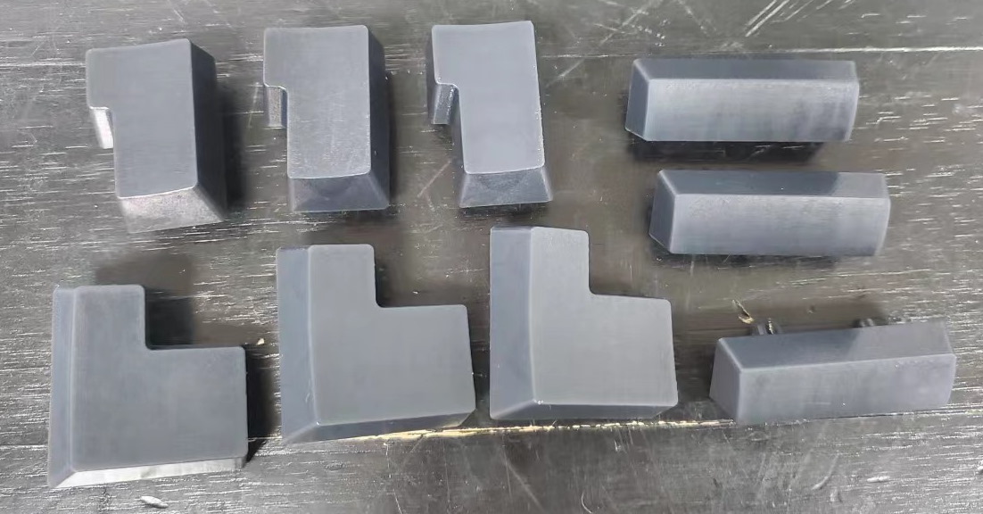

The first 3d printed sample keys for the PC AT style enter, code key, and non-stepped ISO Enter key are being evaluated by the factory, and I expect to receive the mold quotation soon. If the cost to add the PC AT and code key is minimal then I hope they can be added.
I expect to go with the wheelwriter style code key and wheelwriter-style PC AT enter key; this key should be backwards compatible if you use the new horizontal insert (I am not making the old rectangle style insert/post as this key is not an exact reproduction of the PC AT's enter key which appears to have been designed before the latest stabilizer insert design was finalized. This PC AT enter key has no wire stabilizer, a standard horizontal key style post on the bottom left barrel, and no post on the top, same as on the wheelwriter. The code key closely reproduces the wheelwriter version as well.

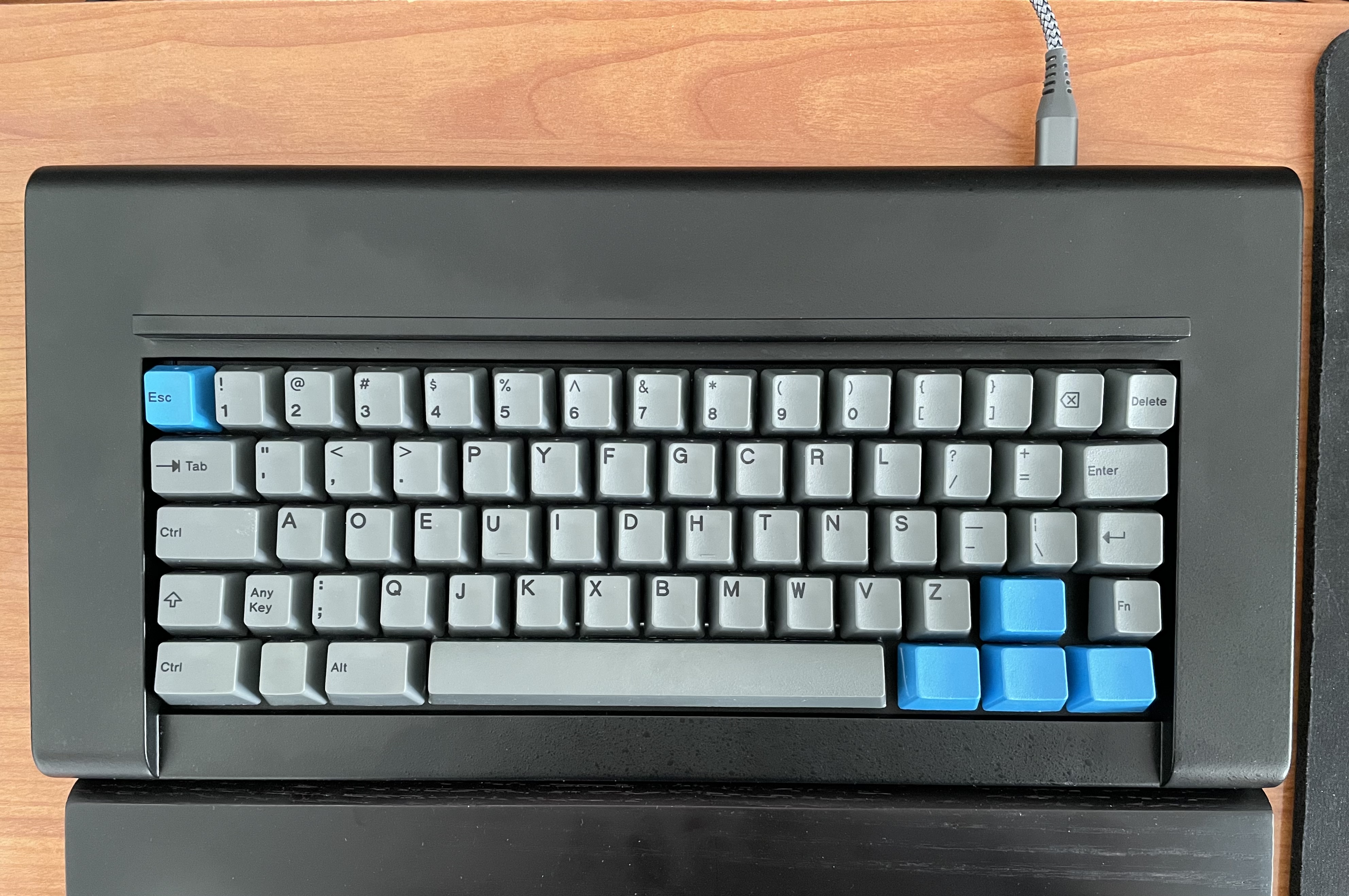

Here's another great keyboard photo - this time of the new dark blue ultra compact F77 keyboard with the new production unprinted dark gray keys. Posting with permission.
