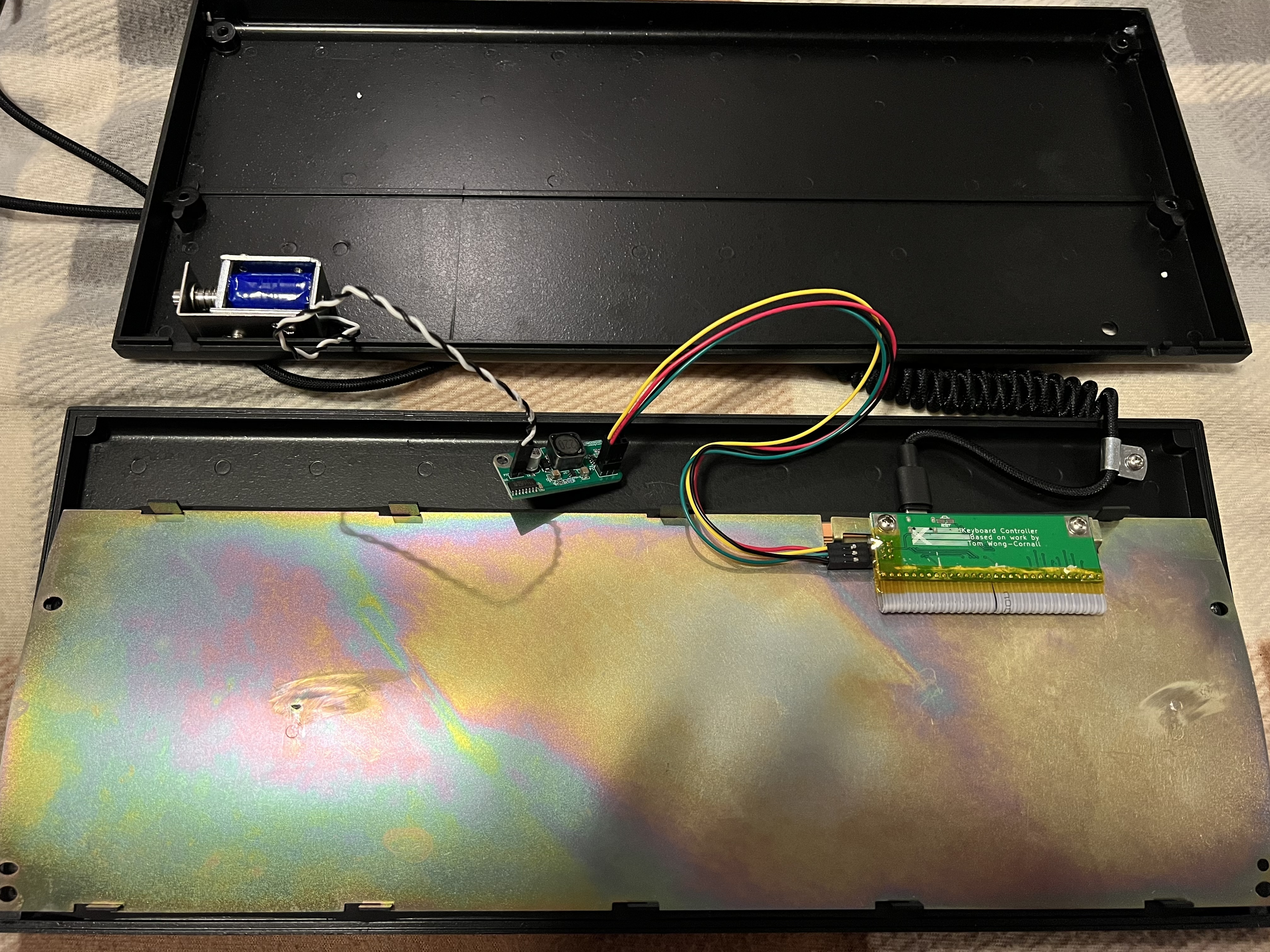

I'm having issues with the solenoid, I installed according to the video but it doesn't work. I just hear a fain buzz when enabled but it doesn't work. Does anyone know how to fix it?
Re: F62+F77 orders now open! New Kishsaver+Industrial Model F Keyboards
Posted: 06 Jun 2022, 04:14
by elira
elira wrote: 06 Jun 2022, 03:37 I'm having issues with the solenoid, I installed according to the video but it doesn't work. I just hear a fain buzz when enabled but it doesn't work. Does anyone know how to fix it?
Ok, solving my own issue. I took the solenoid and controller out given that I saw it has a small LED that tells you if the solenoid is enabled or not. Once I did that I saw that the controller's LED was flashing properly. Upon further inspection I saw that the header solder joints looked bad (on the solenoid controller), so I reflowed them and now it works fine. It's my first keyboard with solenoid. I think I have fixed all the keys that were funky, so far it seems like an interesting keyboard, but it seems to need a lot of tweaking to get it to work. So far I have had to replace 3 springs, and re-seat a couple more.

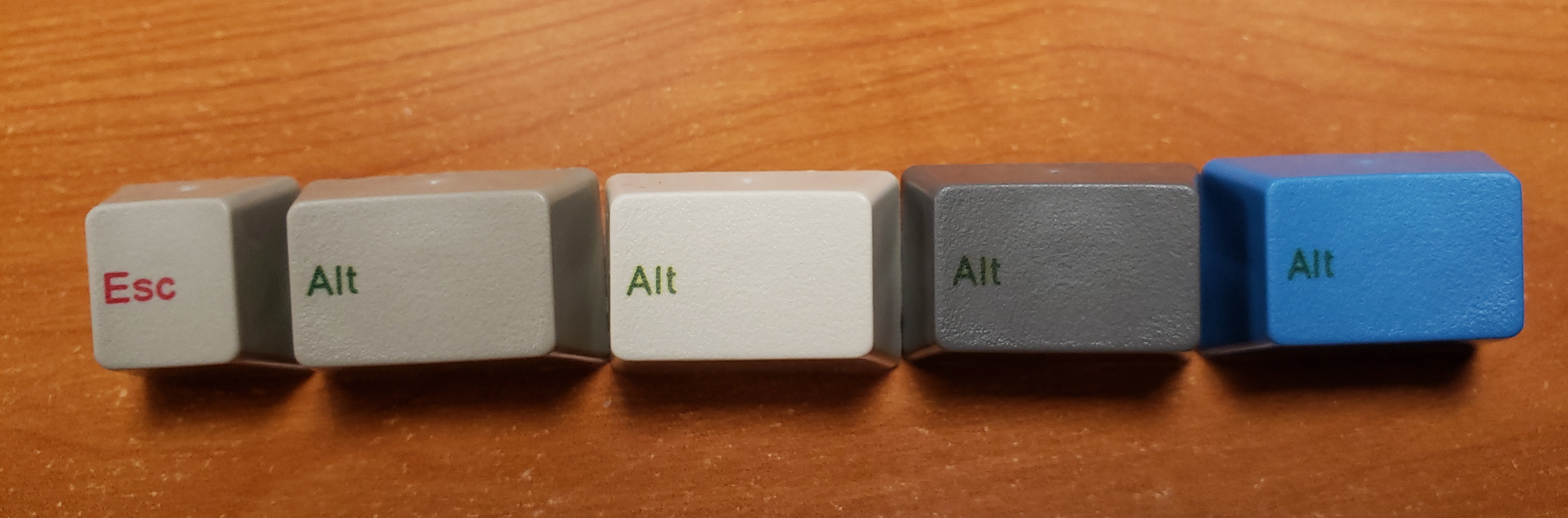

Project milestone: this week the 3000th Brand New Model F Keyboard shipped! I am still going through the backlog and expect to finish up over this month and next month as noted earlier.
Also the first red and green text dye sublimation keys arrived from the factory and look nice. Some folks wanted red text esc or green font for the alt key like on the Model M keyboards.
Posted: 13 Jun 2022, 01:43
by RaoulRod
I got my solenoid in and installed it, got it working!
In the manual it shows you where to install the solenoid in the classic case. But nothing deals with where to put the driver board. Other than using some double stick tape, does anyone have a good suggestion?
There is a spot for a screw on the driver board, but I didn't find any good spots to mount it in the case
Posted: 13 Jun 2022, 02:23
by Ellipse
A helpful person emailed me the answer to setting up the toggle keys - the secret to getting the right side blocks 4 and 5 working.
In summary you set one key (for example the key between Right Alt and Right Ctrl) to be the toggle key: on the QMK configurator site, go to the Quantum tab and drag the TG key in the Layer and Tap Functions section to the keyboard and then enter in the number 3 in the text box inside this key (to indicate "layer" 3). Then click layer 3 on the left side of the keyboard and drag the Insert/Del/etc. keys to the positions as indicated however you installed the keys (example "Del" on the 6 num pad key).
With this setup, I was told that you can press the toggle key to act as a quasi-num lock key - when it is pressed, pressing the 6 num pad key in the above example will send the Del signal, and when the toggle key between Right Alt and Ctrl is pressed again, it will go back to num pad. I think this is the solution we are looking for to getting the additional right side block keys working but please let me know if this is accurate.
RaoulRod the solenoid driver can be loose but I recommend taping the bottom side with polyimide or electrical tape so that it does not accidentally come in contact with any exposed metal surface such as the bottom inner assembly plate.
Posted: 13 Jun 2022, 13:13
by RaoulRod
Ellipse, thanks for the reply. I think mentioning the solenoid driver location/electrical isolation is something that should be added to the manual/video. Also, I did experience the same electrical gremlin that AgentOrange96 experienced. Initially I screwed the solenoid in too tightly, and it didn't work when the case was closed. I replaced the outer washer that I ripped trying to secure the solenoid and it is working now.
I do need to raise the board more than the standard cork feet to account for the extra height of that screw.
Again, something to probably add to the manual
Posted: 13 Jun 2022, 18:22
by Ellipse
Confirmed I have added the solenoid notes to the manual as well as on the solenoid product page.
