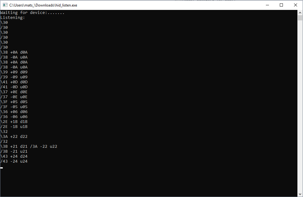

I've read it to some extent, yes. Here's a screenshot from HID listen:
Is it the first numeric values that are the HID codes? After reading the documentation I think I'm looking for codes like "0x09" and so on, so it's confusing when I don't see codes similar to those. :?

I think
\, /, +, - and d,u
all represent the state of the key (up or down). So you have basically two values to figure out (scan code and key code?).
E.g with:
/37 -0E u0E
You have "up" for key 0E (37). Maybe stuff like this: https://techdocs.altium.com/display/FPG ... Scan+Codes

Laser wrote: I think
\, /, +, - and d,u
E.g with:
/37 -0E u0E
Hmmm, interesting. So this means clicking all the buttons and cross-checking them up against Soarer's table and one like the one you linked to, and then make my own or edit an existing sc-file?

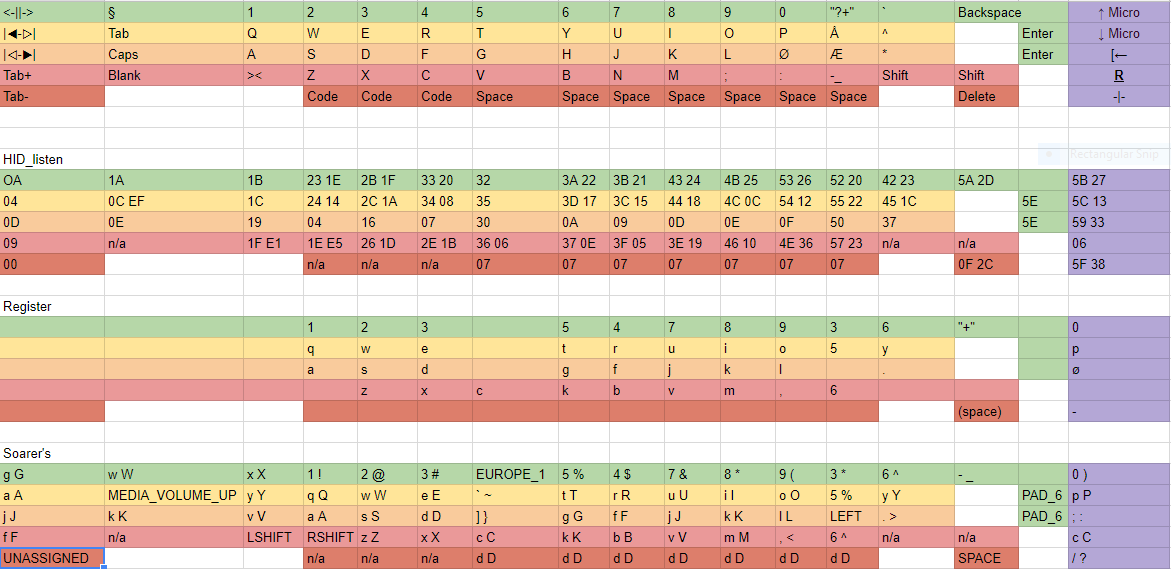

Alright, let's see if this makes some sense.

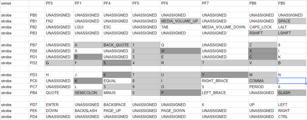

The first thing I did was try to make a "model" of my keyboard as is, in a spreadsheet. (1. set)
Then I tried to map what HID_listen registered when I hit all of the keys, and added in the different codes. (2nd set)
After that I added another one where I added what actually registers when I hit the keys. This is of course effected by what config file is used. (3rd set)
Finally, I cross-checked the 2nd set with Soarer's list of HID-codes. (Fourth set)
Then I proceeded to copy the matrix (?) from the config file, and see which keys "match up" in some way.
Some keys output the same character twice, those cells are the darker ones.
For now I'm not sure if any of this makes any sense, but if anyone have some inputs here I'd be thrilled. :)
