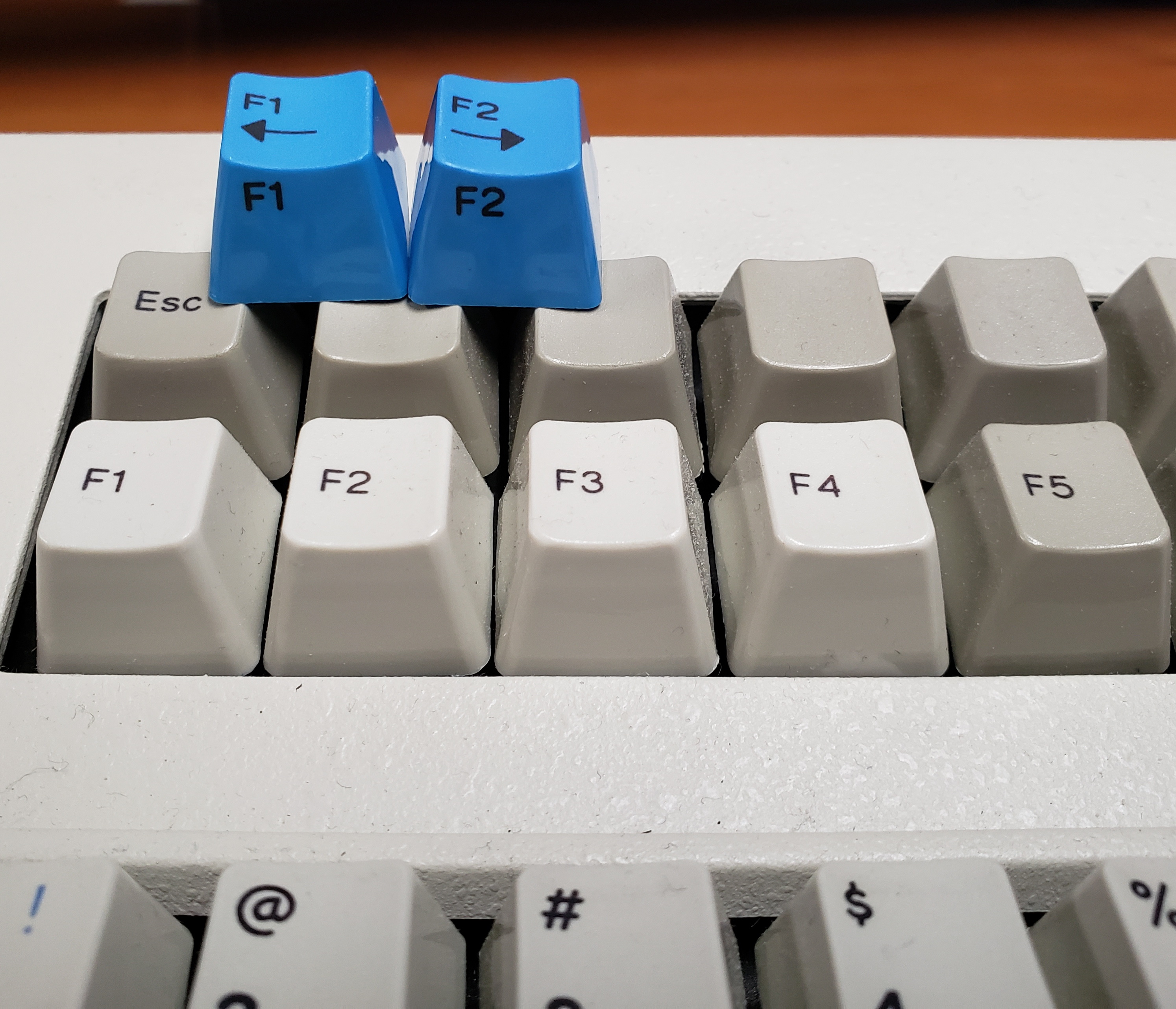

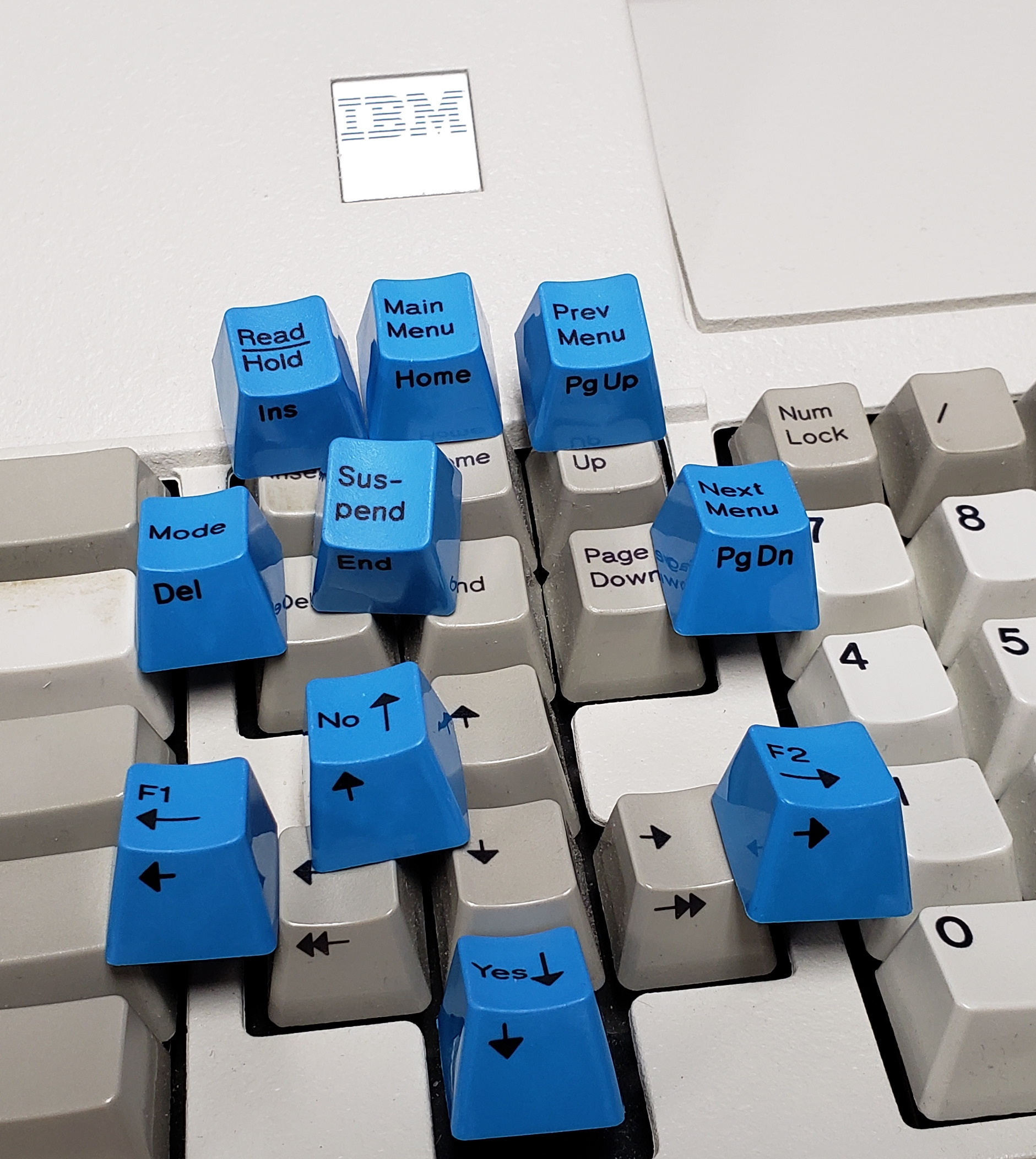

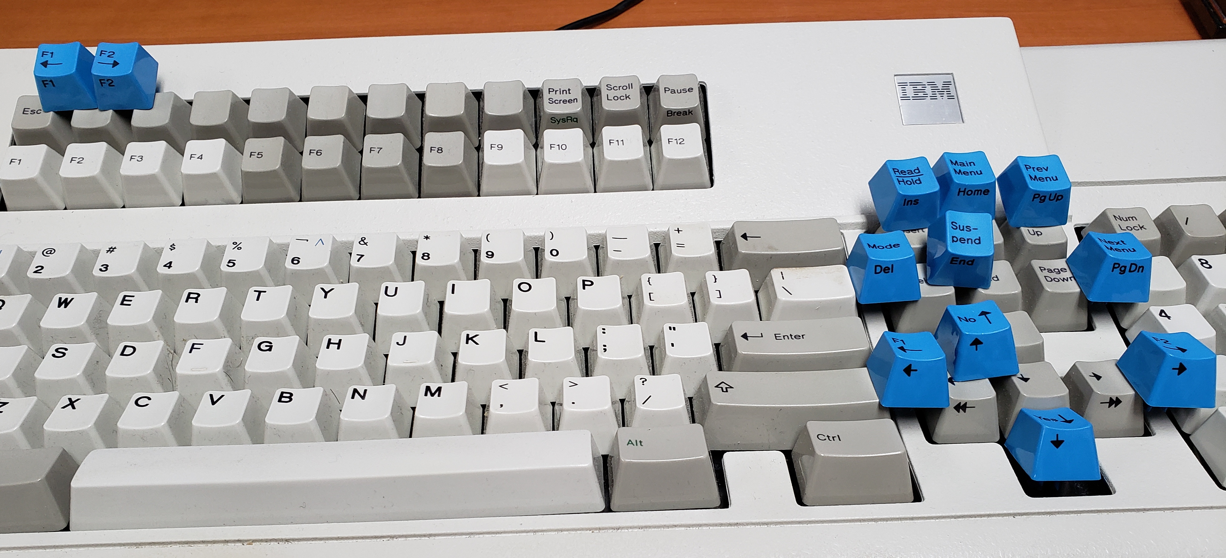

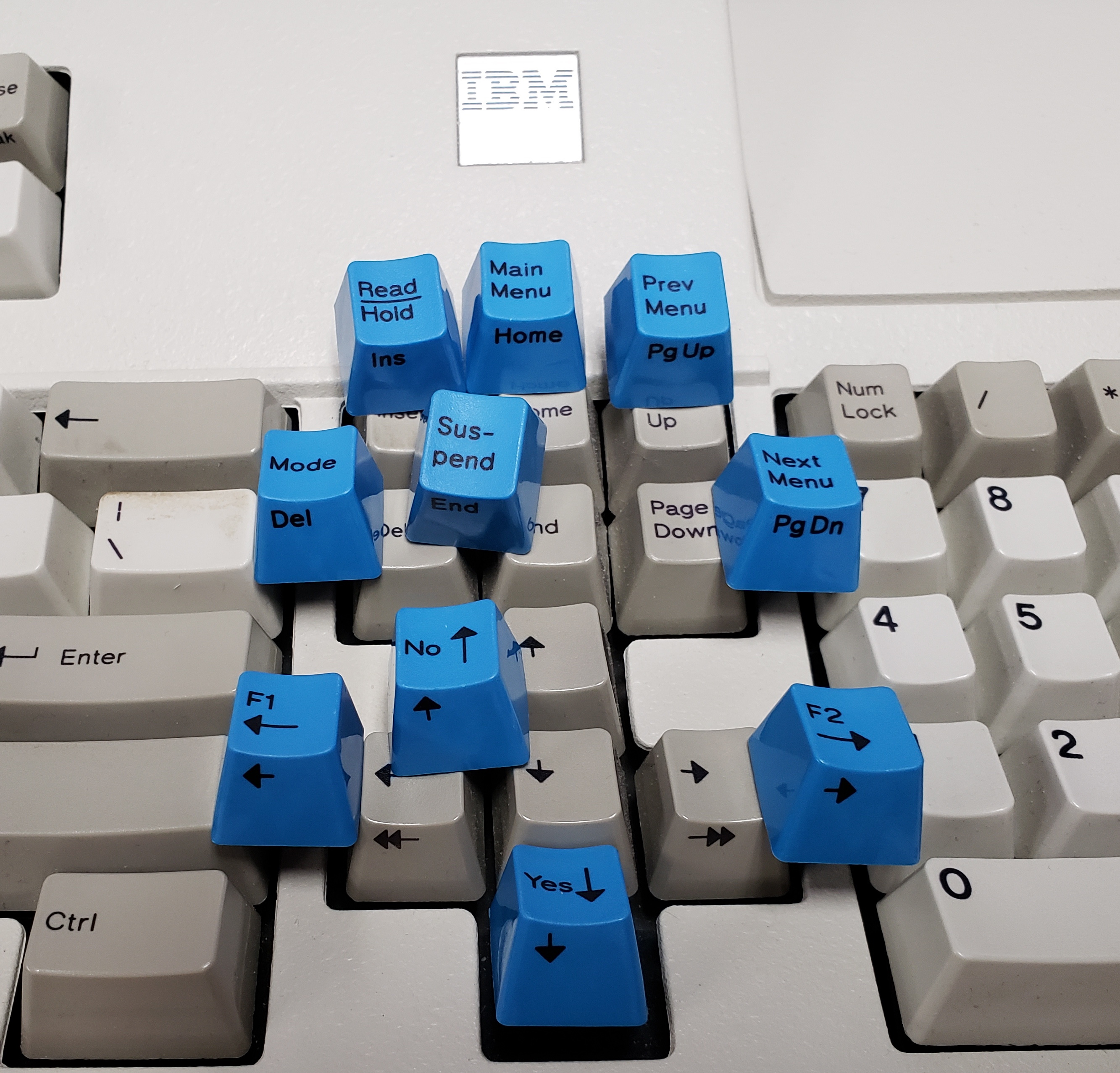

Today a bunch of the remaining key sets arrived by express mail from the factory, including the Industrial SSK 12 key sets, many of the remaining international sets (Swedish-Finnish, etc.), and some of the Extra Keys. Another air shipment batch over the coming weeks should have the remaining dye sublimated keys we have been waiting on.
The Industrial SSK 12 Key sets look great - I would say they are even an upgrade over the IBM/Lexmark Model M originals. As always please disregard the colors (cell phone photos). I am glad the factory focused extra effort on making sure these sets look as good as they do, even though this resulted in a delay for these keys. The Front Printing was by far the most difficult part of the dye sublimation and it took more than one year to get it right.
That means that many of the orders containing these sets can start shipping this week!
