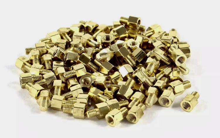

The standoff spacers have been ordered (m3x4mmx4mm). As a reminder, these hold and ground the PCB to the backplate at 3 points on the SSK and 4 points on the Full-Size. The top plate is then tensioned down into the standoffs. They are the only points where the plate fasteners are attached from the top. Unfortunately, Fastenal didn't carry the size and style we needed, so had to use conventional means to procure.

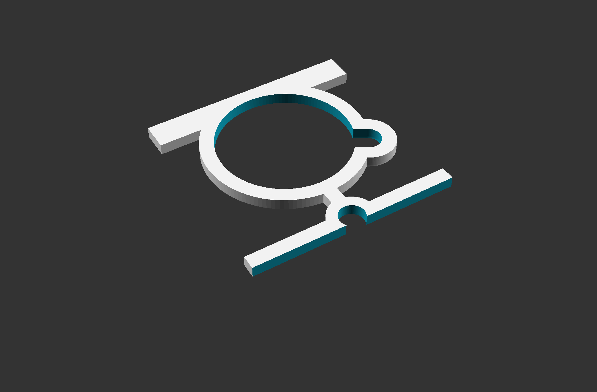

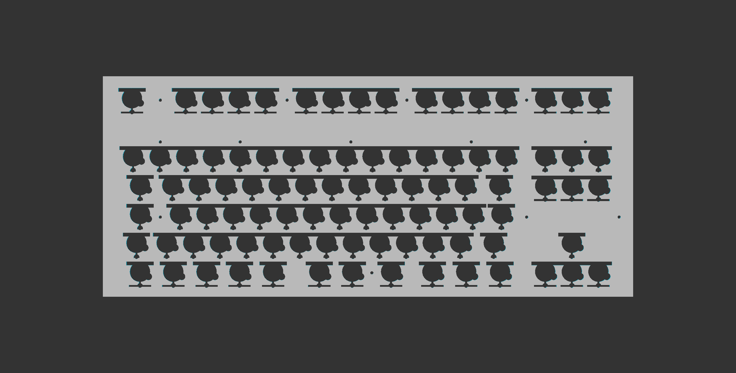

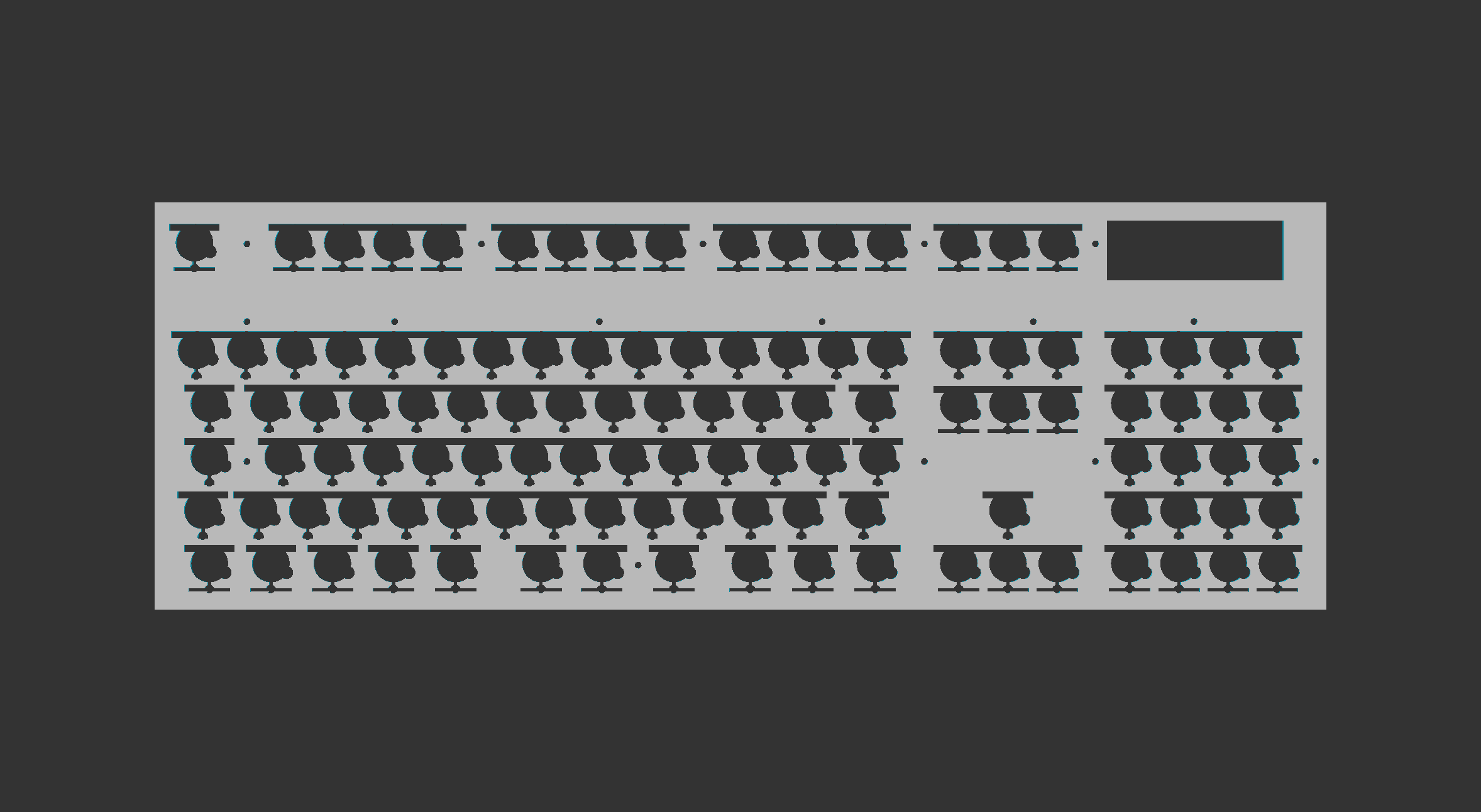

The final version of the foam is finally put together. I realize in advance that I have WAY more interest in this aspect of our project than others, but strongly believe it is one area where we could have the greatest improvement over any existing architecture to date. Came up with several prototypes that were tested in reality (maybe 10?), and settled on this being the design.
Again, the goal is
  • first consistent key feel throughout the board (remember we are closer to an F122 than a 4704
  • secondly consistent audible feedback
I believe we achieve both. The core ring is made of silicone rubber that both helps seal barrel openings and stabilizes with consistent pressure at key points. There are two flavors of the ring. Those where the barrel front is supported by the overhang of the previous rows ring, and isolated (includes bottom row) barrel rings. Also, should we make our own barrels in the future this two part approach would also accommodate flat plate profiles, the silicone stabilizer rings will still fall within spec.
The voids not accounted for by the stabilizer rings will be filled with MLV (mass loaded vinyl). At least that is the goal. If MLV proves cost prohibitive, the fall back is a thicker than normal closed cell foam like neoprene. I have ordered several foams to test on the laser cutter, and will report the results.

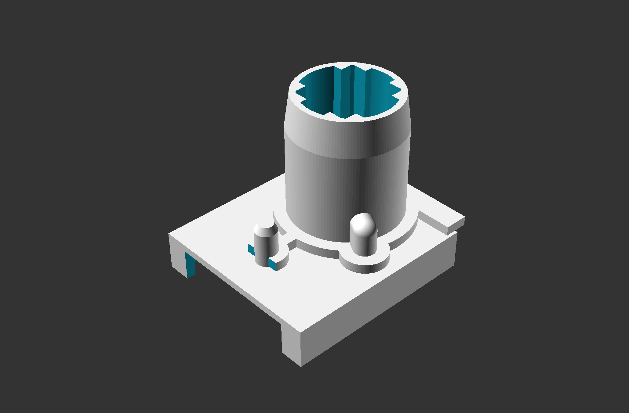

The following are the renders to help visualize. Regardless of the material chosen for the secondary foam, this design will be the final unless issues arise. Note that the secondary (form factor specific cutout) foam will sit INSIDE of the assembly, and will not be sandwiched between the top and bottom plate on the edges.
Standard silicone stabilizer ring.  Note that rectangle at the top of the barrel base stabilizes the rings barrel AND the barrel on the row above

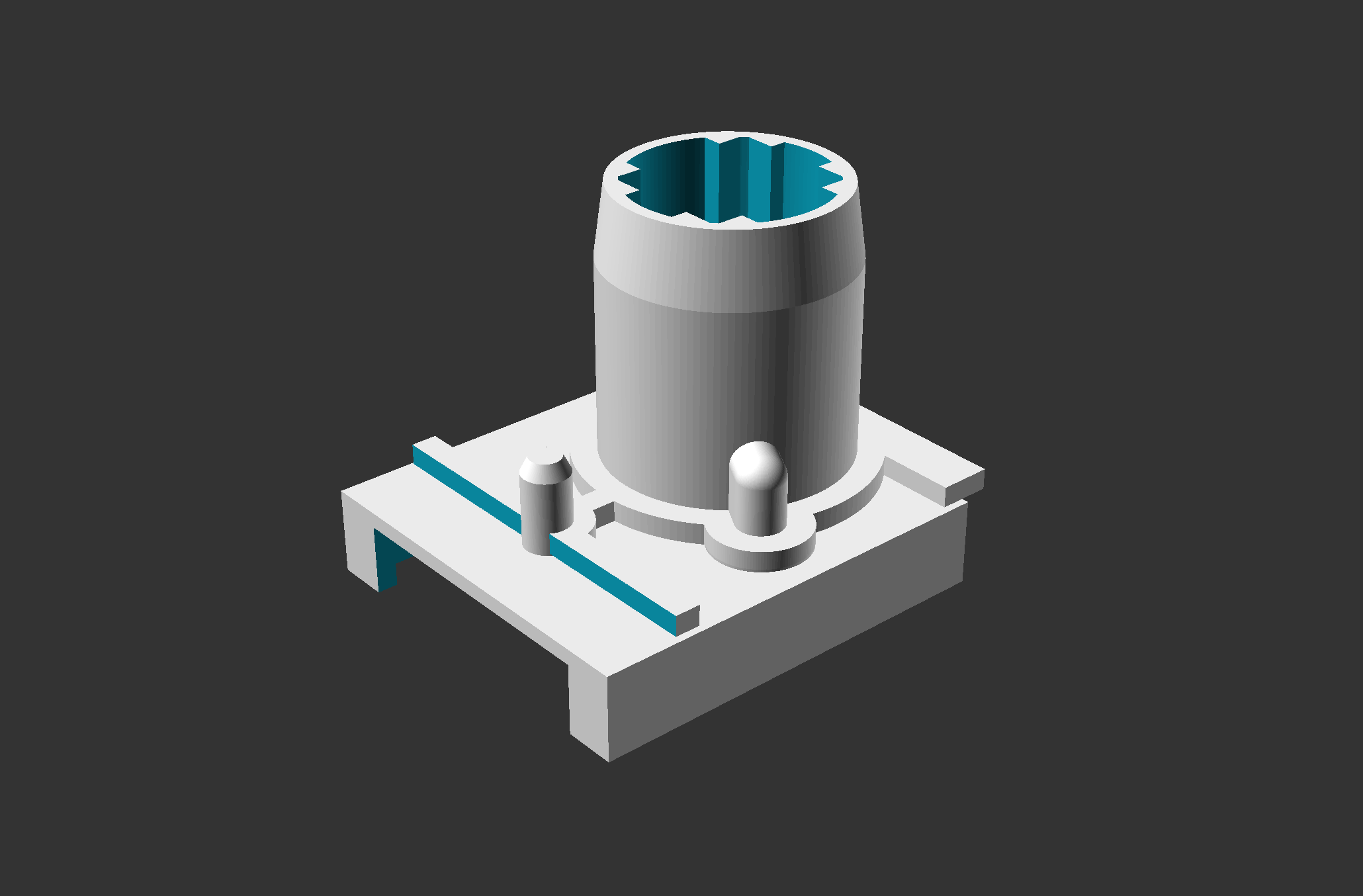

Standard silicone ring fitted on a barrel.  The example shows both barrel locks (XT and AT)

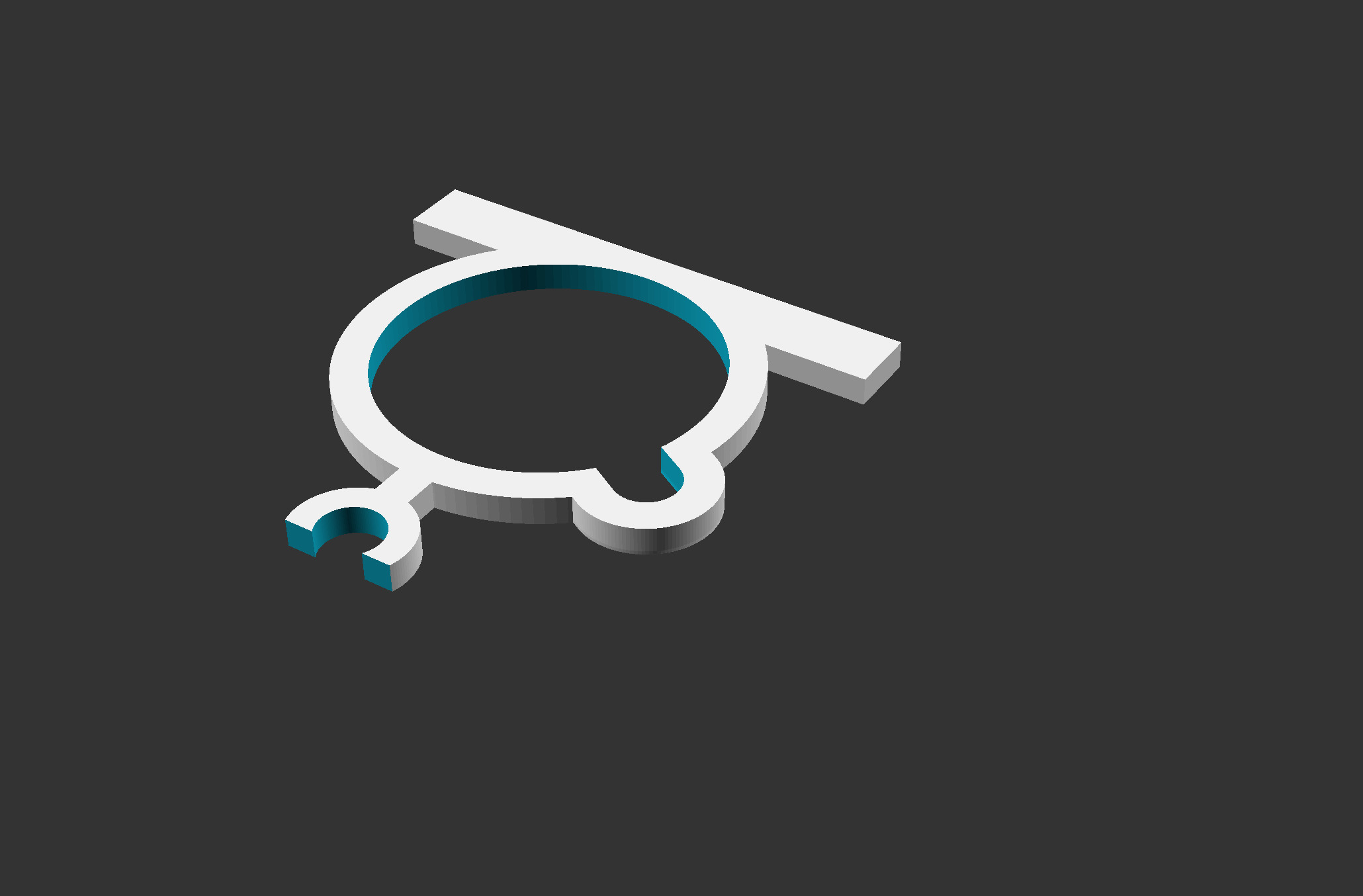

Stabilizer ring for isolated barrels (barrels that do not have a row directly below them)

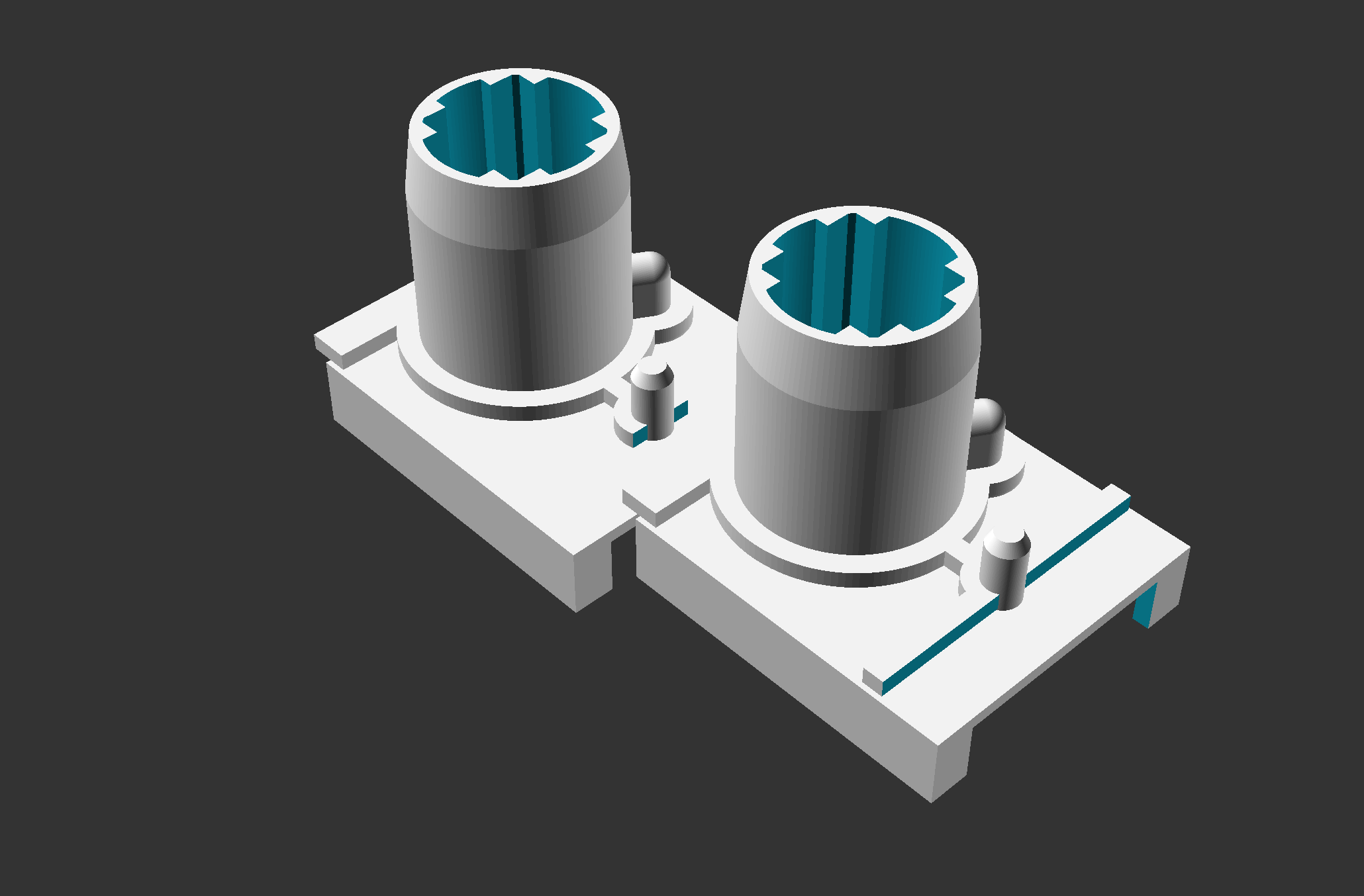

Isolated stabilizer barrel fitted on a fictional dual lock barrel
Standard and isolated rings fitted on stacked rows.  Note the overhang of the ring on the lower row stabilizes the one above
Closed cell foam cutout for the SSK to fill voids
Closed cell foam cutout for the Full-Size to fill voids

That looks great! I really appreciate the renders helping me visualize it. I had the impression you experimented with a lot of layers at one point. Did you come to the conclusion that was overkill? This looks like it will be very straightforward to assemble, which I like! I was a little worried about the two types of stabilizing rings, but seeing the cut foam I realized that will be a perfect guide to indicate which type to use in each place.
lot_lizard
25 Jan 2017, 15:29
There is a bug in my render for the foam sheets. It is pointing at an old version of the ring. The isolated ones have a shorter width on the support silicone so the foam isn't so delicate on bottom rows of the function, arrow, nav cluster, and 10-key. I will regenerate and update the previous ones later today
Techno Trousers wrote: I had the impression you experimented with a lot of layers at one point. Did you come to the conclusion that was overkill?
The term "layers" was a poor choice on my part. It was always something similar to this. More of a "multi-part". There is another layer than sits under the PCB itself (separating from the backplate), but it is VERY thin. Thicker than the sheets on the original F122, but something along those lines if you want to think of it that way

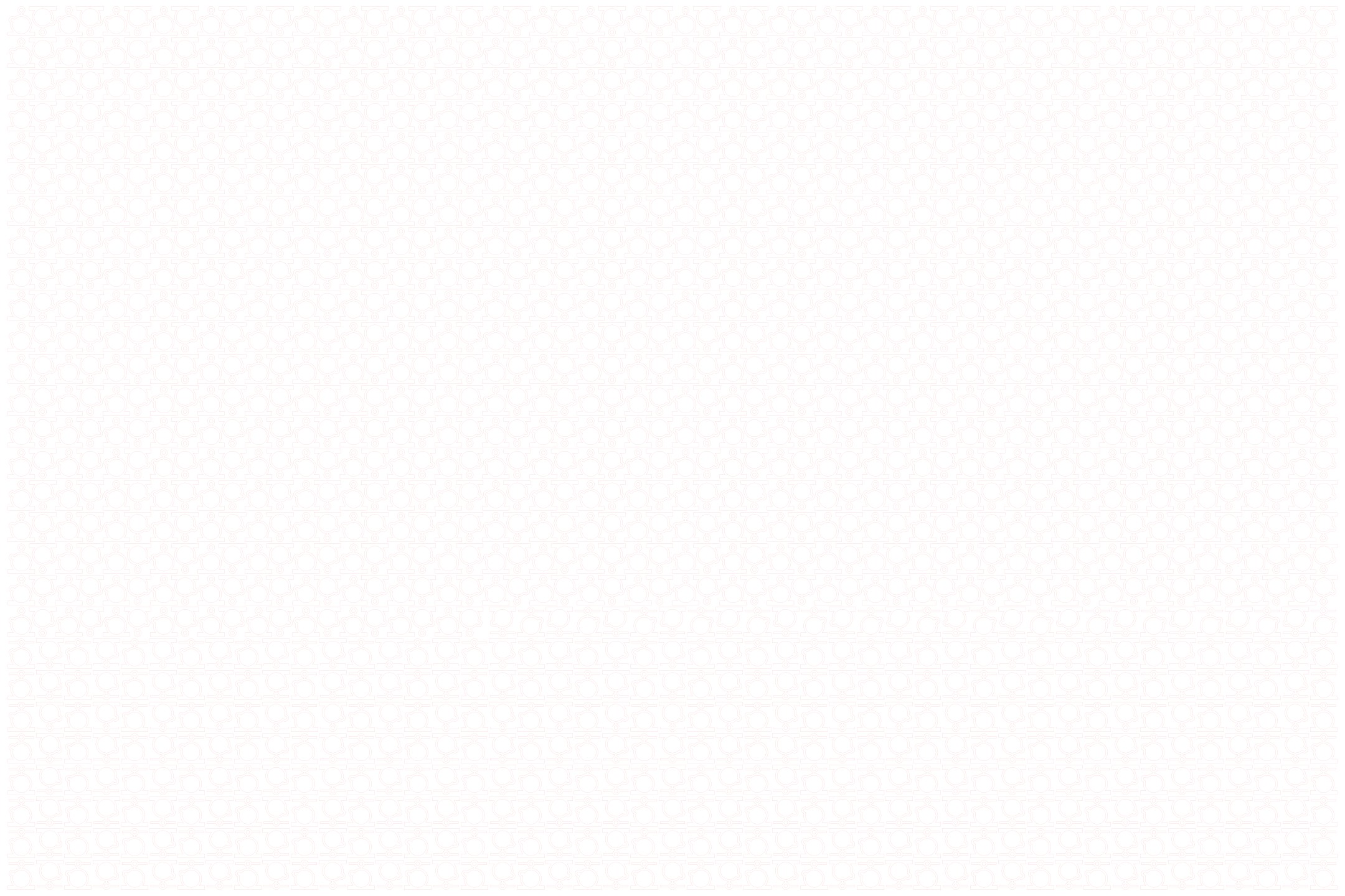

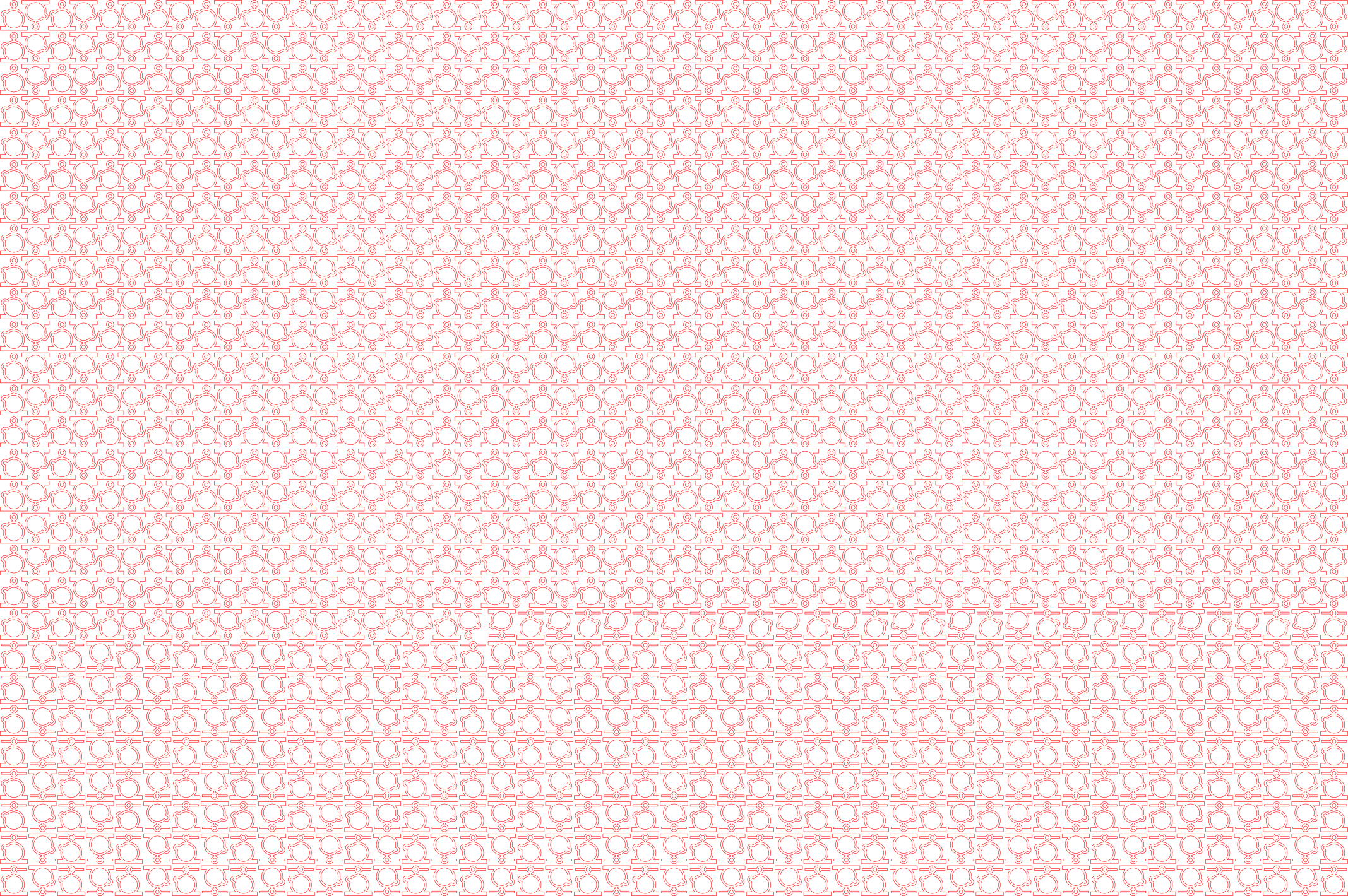

If anyone was curious, this is a very scaled down (60dpi) version of the SVG that is being used to cut the stabilizer rings out of the silicone sheeting. The line width has been increased so that it is visible. The spoiler would be the actual hairlines at .001 inch (needed to tell the laser to cut instead of engrave), but it is hardly an interesting picture to the naked eye at this resolution. The engraver has a 36x24" cutting bed. This utilizes all of that space with a .5 margin all the way around. Total would be 1491 rings per silicone sheet (1092 standard, and 399 isolated with extra stabilization bar around the AT barrel lock). That should take the engraver a while ;)

lot_lizard wrote: If anyone was curious, this is a very scaled down (60dpi) version of the SVG that is being used to cut the stabilizer rings out of the silicone sheeting.
Is there a meaningful reason the pattern shifts near the bottom of the graphic?
lot_lizard
26 Jan 2017, 16:19
E TwentyNine wrote: Is there a meaningful reason the pattern shifts near the bottom of the graphic?
The bottom 8.5 rows are the isolated version of the ring. So barrels that don't have a row underneath them that need to be further stabilized. The standard barrel rings have an overhang if you go back and look at the renders that actually supports the front of the barrels on the row above it. These "isolated" barrels wouldn't have that benefit and needed to be slightly altered
