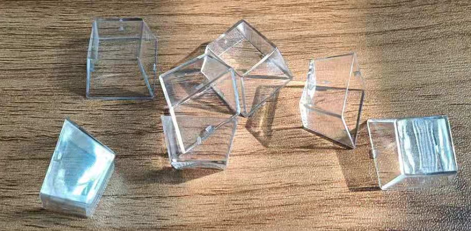

Update: New transparent cap reproductions now available to order, for delivery around year end 2021 (not until the keyboards have gone out - getting the keyboards out is my continued top priority)
https://www.modelfkeyboards.com/product ... -cap-stem/
Check out the first sample units from the new molds in the below photo - the caps are super-clear!
2021-06-21 relegendable cap first samples cropped.jpg (185.35 KiB) Viewed 9529 times
As requested by many people asking about these caps, I have ordered a new mold for these transparent relendable caps based on the exact dimensions of the original IBM 4704 transparent (now yellowed!) caps. The relegendable caps allowed banks using 4704 terminals to put in specific function keys before the days of the GUI for IBM mainframes and terminals, so it is definitely in line with the 4704 reproduction project. Nowadays they can be used for designing your own key, to open a specific program, to run a particular macro, etc.
The plan is to offer the lowered pricing currently shown on the product page for the group buy folks and then to increase pricing once they are actually in stock, to help cover project cost overruns and pay for the new molds.
Ordering one unit of this product gives you one clear relegendable cap and one Model F / Model M compatible stem. The stem will be provided in assorted colors - you can't pick, but you won't see it anyways once your relegendable paper label is installed.
I am aware that Fentek may still have some transparent caps in a non-original design at lower prices and I recall that a Deskthority forum member has posted a comparison of original vs. fentek caps.
This is the only place to get these IBM-style reproduction transparent caps, unless you buy an original 4704 keyboard that happens to have these caps (if you can find one!).

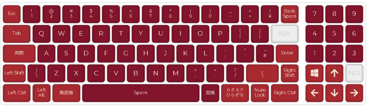

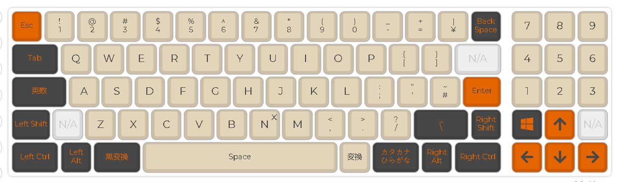

Those who know about JIS, please review the proposed JIS layout attached, as updated by a forum member here. Is this representative of the JIS layout on an IBM keyboard (obviously with fewer keys for the F77 or F62)?
Something similar to this, with the exception of the blank key that should have been the printed 1.25U key supplied by Unicomp.
qmk test.PNG (39.76 KiB) Viewed 9849 times
jis qmk d.zip
(676 Bytes) Downloaded 191 times
