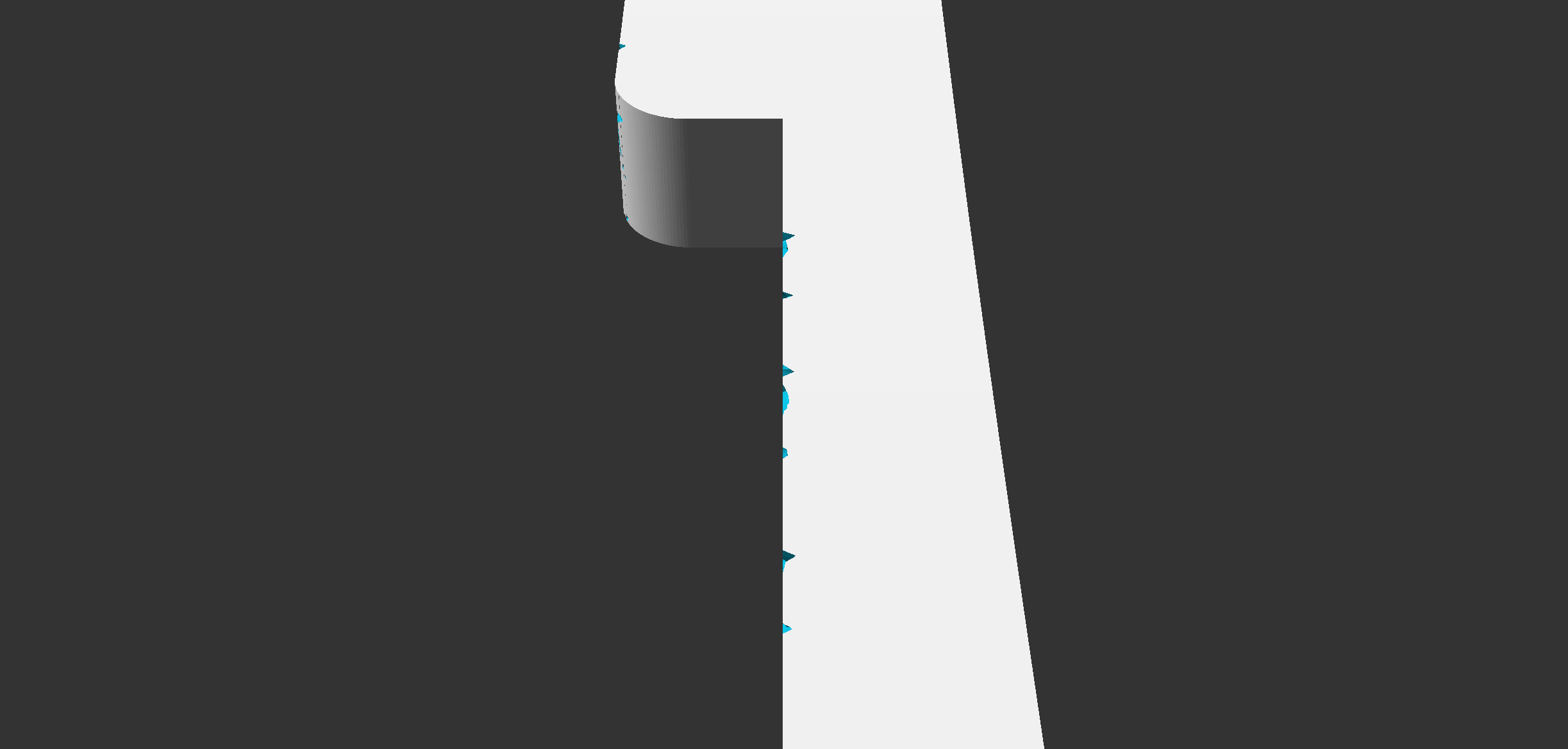

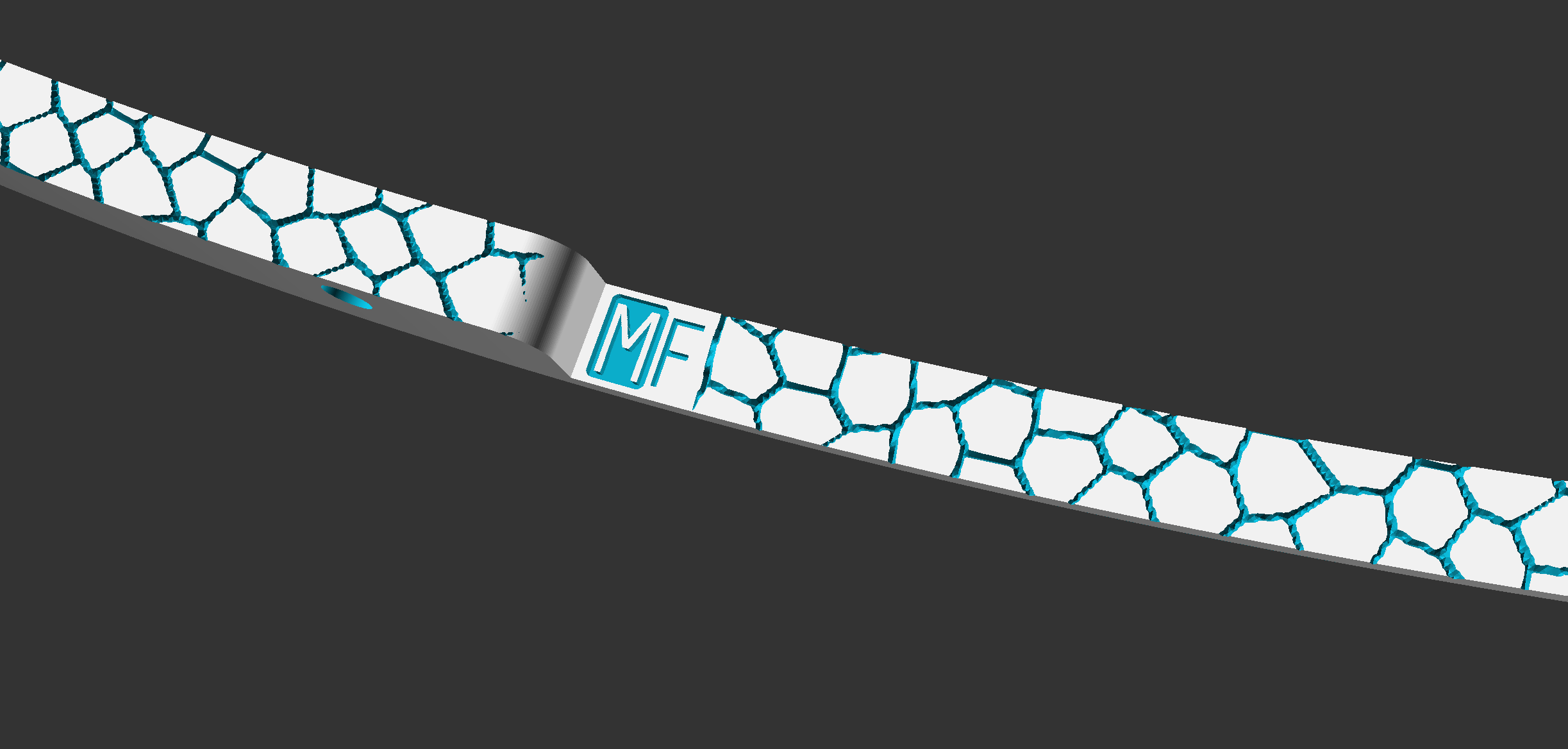

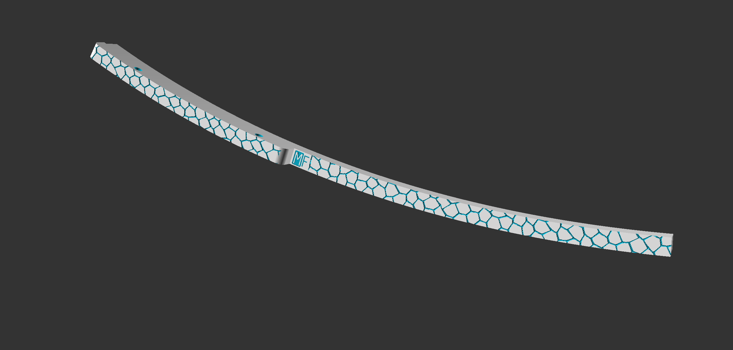

Printed samples of the side spacers, but really think we need a pattern on the side to break up the "3d printed" look. I threw this together, and will give them a go on the printer later today. Keep in mind the blue cutaways will be much less pronounced in real life. I realize this is silly stuff, but want to do what we can to make this has polished a product as possible.
Left spacer from the Full-Size
Close-up view of the logo and pattern.  The pattern will be a v-cut to avoid any issues with dust build-up
Side view so you can get an idea of the depth of the cut.  Again, much less pronounced than the OpenSCAD render where the "difference" is in blue

I tried the MF logo and it turned out a bit gaudy. I considered interlocking Escher lizards. I agree with ohaimark that the texture of the best of prints is just "meh" when it's looked at in detail. This is just a simple mosaic pattern that is hopefully chaotic enough to break up the print patterns. We'll see. Currently printing, and needs another 45+ minutes.

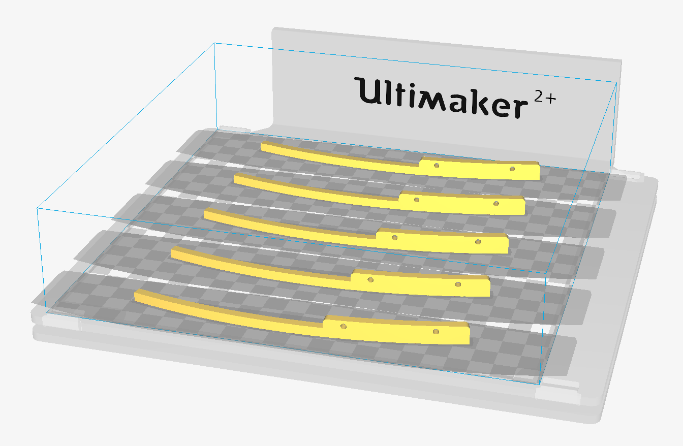

So I have printed a few different configurations with patterns and logos, and the cleanest look is just going to be the original flat finish (which turned out quite nice). Even with the .25 nozzle in, the co-polyster just doesn't get the level of detail we need to look what I would consider more desirable. I REALLY do like the co-polyster material... it's a tank with nice flat results (still appreciate the recommendation @andrewjoy), and don't want to give it up.
The .4mm nozzle will let me plow through these at about 1 an hour. So 150 units x 2 spacers per unit x 1 hour = you get the idea... The detail needed to be worth it. It wasn't

Wow, 300 hours just to print these at full tilt?! That's gotta take like 3+ weeks realistically, right? I hope you factored wear on your 3D printer into the price we paid for these, and find time to sleep. :o
lot_lizard
19 Jan 2017, 02:09
It can do 5 at a time, printing one complete before moving onto the next... So that certainly helps, and they are just shy of 50 minutes a piece. Should take about 14-16 days with down time gaps. It could print more on a single deck if we did a single layer to every piece before returning to the first (no head collisions with previous printing), but I'm getting better end results doing a full piece at a time. Note we are printing these as solids, so that just takes time. See the image below for an idea of layout on the deck.
This is the printers purpose, and why I picked it up. I prefer machines don't sit idle much, especially those that deprecate rapidly because the technology will be obsolete quickly. I charged you guys 60% of what Shapeways would have charged us for the same STLs, and applied that margin towards the printer. In the end, 200-300 of the proceeds went towards the printer, and since this project is officially being run as "business" according to taxes... I will deprecate the equipment over 5 years before it is capitalized (even though the business operates as break even). In the end, I'll be out 500-1k on it, but I've already been using it quite a bit for other research. It's goodness.
Screen Shot 2017-01-18 at 4.31.18 PM.png (128.49 KiB) Viewed 7707 times
19 Jan 2017, 10:47
Have you tired messing with the settings to see if you can reduce print time?
A few things spring to mind.
Bump up the print speed on the infill , it does not matter how accurate that is.
Reduce the infill , you will be amazed how little you need for strength.
They look far enough apart to print one at a time not all at once , this will allow you to bump up the parameter speed and acceleration without stringing, it will also reduce the need for retraction.
Consider upgrading your ultimaker to an E3D hot end, it is a bit of a waste if you have the 2+ over the 2 however you can then use the E3D volcano heater block that allows much faster printing with larger nozzle sizes ( up to 1mm !!!!)
http://wiki.e3d-online.com/wiki/E3D-v6_on_Ultimaker_2
