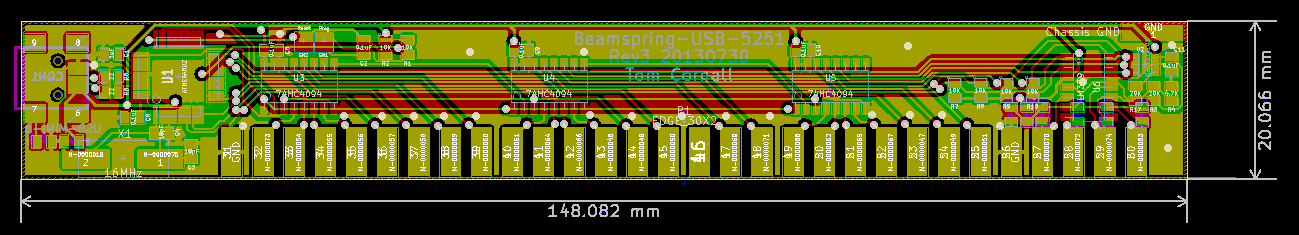

OK I've more or less done Rev3 PCB layout, which has a few changes from Rev1 and 2:
  • Surface-mount-hack mounting of edge connector, allowing board to lie flat and be used with 3278s etc.
  • Move to SPI-protocol DAC for Vref (trigger voltage); this in theory means that Vref can be changed per column or even key if necessary
  • Removal of pushbuttons for Program and Reset. There are test pads instead.
  • Larger HC49-style crystal instead of the special tiny thing that was used before. Saves some cost.
  • Solder-mounted chassis ground connection instead of massive through-hole hole
  • Last but not least---15% reduction in board size. Makes it a bit cheaper.
I really hope this will fit inside a 3278 (remember the edge connector will be soldered at 90 degrees to the board):
The DAC for Vref is interesting. I2C (that was used with the last DAC) is very slow and thus precludes changing Vref on the fly (if there was a dodgy column etc.). SPI is way faster (with 16MHz AVR the multipliers work out so we can communicate at 8MHz, instead of 400KHz max for I2C, although it was probably about 100-200KHz as we were bit-banging).
Unfortunately SPI DACs are more expensive, so instead of using a 12-bit DAC I went with a 10-bit. In theory this means we have a quarter of the resolution with Vref, but I'm using a three-resistor window divider to output between 0.8V and 1.6V (with 1024 possible values, so that's 0.78mV resolution) instead of before where it was outputting the full range between 0V and 5V (with 4096 possible values, so 1.22mV resolution).
The pushbuttons have gone as they are relatively expensive, take up a lot of board space (and we only really have one side now that the board is mounting `on-flat'), and are mostly useless as the controller can be reset into the bootloader for updating the firmware using the GUI util. I've left test pads on there so it can be manually reset by shorting out the pads with a screwdriver or whatever.
After I order this and make a few the next project is a Displaywriter converter---those are quite different from the other beamsprings, having 8 rows. They seem similar to a Model F controller in some respects.

Awesome! I don't have the board handy at the moment, but aren't the connections coming into the edge connectors on both top and bottom sides (rows on top on the right edge, iirc)? So how does surface mounting it account for the top row, or does one just bridge with some wire or somesuch?
Also I totally already ordered components for the previous board iteration - looks like another order will be needed. I'll have to compare the BOMs and stuff.. At least I didn't get the pcbs yet!

Yes the keyboard PCB itself uses both sides, and the connector has individual top-side and bottom-side pins. However there are pads on this controller PCB on both the bottom and the top, and they are linked together with vias (see the little grey dots above the connector pads in the above pic).
As for previous board iteration---if it's for your 5251, there's no harm in using the Rev1 board (or Rev2 board if you're getting the connector with PCB pins instead of big fat solder lugs). Obviously there's the mounting issues with the 3278. And that will probably be an easier board to put together to be honest, the component spacing is wider (as lots of components on the back), and the through-hole mounting of the edge connector should be much easier to attach.
However if you're getting the Rev3 board (which you might for your 3278) then there's not a lot of difference with the components. The crystal has changed to a big cheap standard thing (HC49US), there's a couple of extra resistors (20k), and the DAC is different. All the rest is identical.

Aha, I get it now. Clever! The connectors that I got are the lug kind. I'd definitely want to use these on my 3278s first especially since the 5251 is lacking some bits and I already polywrapped the smaller 3278..

Have assembled and tested a Rev3 board with the flat mounting. Seems to work, yay! Had to write some ugly #ifdefs in the code to handle the fact there's different DACs on different board revisions and different pin assignments for the rows.
Not too bad to assemble. The connector was attached flush to the bottom, leaving a gap to the top-side pins. I tried bending these down with pliers but they need to be overformed so sprung back up while the solder was still molten. In the end I just pushed them down with a big hoof tip on the soldering iron and lots of solder. Ugly but effective.
So we now have support for 3278s. Next step is Displaywriters.
