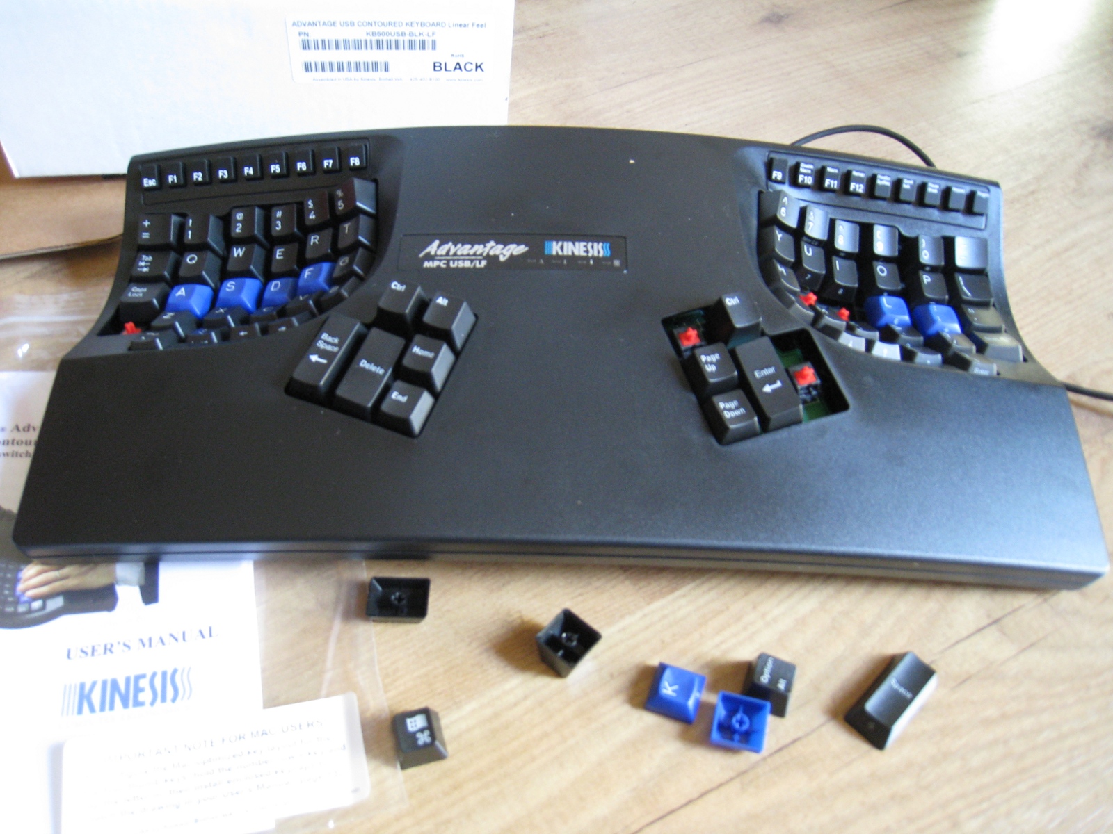

Great service! I think this keyboard is much better than the Truly Ergonomic, still a pity it isn't split. The red switches seem much more suited to a keyboard like this than an ordinary keyboard.
- sordna
- Location: USA
- Main keyboard: Kinesis Advantage LF / Dvorak layout
- Main mouse: Logitech M500
- Favorite switch: Cherry MX Red
Yes. Especially since the Kinesis has a configurable audible click (tiny loudspeaker), this works really nice in combination with the linear switches. You get the audible feedback, and the key stroke remains smooth as butter.
I too wish there was a split keyboard with non-staggered layout. The uTron is the only thing close. Of course, there are a few people that have cut their Kinesis in half... maybe I'll try it on my older white one
By the way, now that Kinesis has a batch of red MX cherry switches, whoever orders the Advantage LF next will get it in a few days. I would hurry before they run out! They charge slightly higher since it's a special order: $325.

They didn't exactly make a custom keyboard for me. They liked the idea, and made it into a specal order model that anyone can get. They even made labels for the new model, ie in the LED area (you can see it in the photo) it says: MPC USB/LF.
By the way, I'm grateful to both Deskthority and Geekhack, I first found out about the red switch (and their part number) from Geekhack, and I found out from Deskthority that the switch (which was discontinued) resumed production. I was always dreaming of a lighter feel switch than my browns.
Regarding the switches: I don't like browns very much, it's a personal opinion. They are too vague, the tactile point doesn't exactly correspond to the key registering, if you type fast you can't notice the tactile point anyway (the switch just feels gritty to me, especially on the older PS/2 Kinesis I have). If you type slow, it interferes with the stroke and requires more force from your fingers to overcome it.
So I decided I don't need the tactility and the baggage that comes with it; the Kinesis audible click (at the precise point the key registers) gives me all the feedback I need to avoid bottoming out. Of course YMMV, some people do better with tactile switches.
The reds feel smooth all the way, whether you're hitting the keys fast or slow. It feels easier to my hands.
Anyway, Kinesis sent me an email today, saying they sell replacement keywells with red switches (without keycaps) for $90 a pair, but you need to contact [email protected] and provide your serial number, so they use the appropriate ribbon cable. You could by 1 keywell at $45, that's a cheap way to try reds on one of your Kinesis

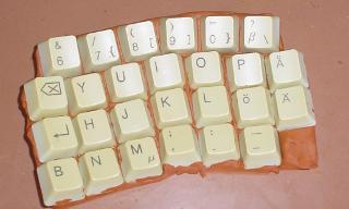

So far, I have mostly been playing around with mock-ups of the right half's main area by sticking key caps into modelling clay.input nirvana wrote:Any renderings yet or---?Findecanor wrote: Myself, I have finally decided on the layout for a split ergo keyboard that I am going to build. I am going to make it a middle-way between the M-system layout, the µTron and the Maltron. Slight curve and a slightly dished 3D-shape.
Each half's main area will be built on an ordinary flat circuit board, with key caps of different heights for different fingers. I think that a completely parallel key-stroke angle would be best for all fingers in almost all cases.
Each half will be angled 20°. All modifiers will go on thumb keys that I have not got around to sculpting yet.
I have been thinking of making the key caps by gluing empty caps onto stems with different spacers inside.
- mockup.jpg (17.16 KiB) Viewed 11647 times

The flat pcb and the different height/angled keys...interesting thought, potentially a ground breaker (no curved components like Maltron/Kinesis...do you feel you will be able to have enough of a curve in the keywells? I ask because as I look at my Kinesis, it would be tough to replicate with just the curve from the keys only.

It's a good question. The idea is that the slight vertical staggering should compensate for the differences in height not being as large as on a Maltron or Kinesis. I am more afraid that the highest keys (who are twice as high as the 'K' key) could be too wobbly or too acutely angled.input nirvana wrote:The flat pcb and the different height/angled keys...interesting thought, potentially a ground breaker (no curved components like Maltron/Kinesis...do you feel you will be able to have enough of a curve in the keywells? I ask because as I look at my Kinesis, it would be tough to replicate with just the curve from the keys only.

The very tall keys would be a concern of mine. I can see that being a possible issue.
