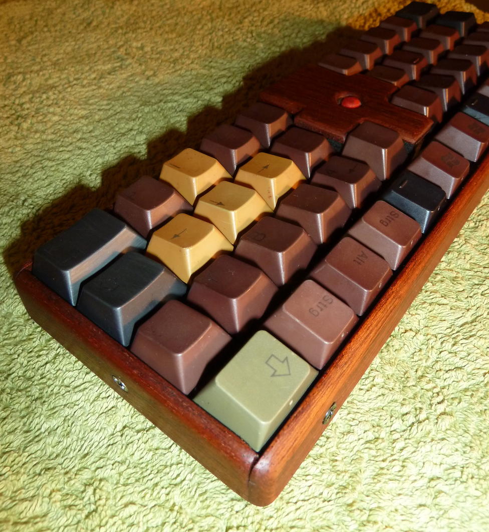

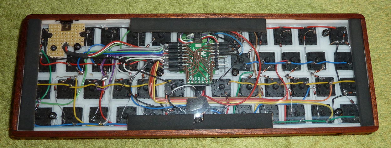

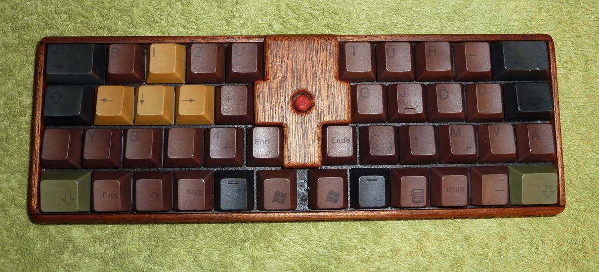

18 Feb 2013, 21:56
The wooden frame around my HyperNano took me longer than expected, but I'm kind of happy with it now and have colored a bunch of keycaps in the meantime to find a pleasant color scheme to go with it.
Top
Top
Side
Side
I also I put an acrylic baseplate on and finally added a proper mini usb socket - no the most beautiful attachment, but it works.
Bottom
Bottom
On the software side of things, I ported the mousekey support from tmk_firmware and am quite surprised how well it works with the right settings - especially for emulating a scrollwheel as recently discussed on the HyperMini thread (if I didn't have that functionality with the trackpoint already I'd miss this sorely by now). By the way, I seriously consider switching to that amazing firmware altogether in the near future, seems to be a lot more advanced than my hackish attempts, with a bunch of nifty features I'll find hard to implement.
Other than that I've been typing for almost a week on this little beast and am impressed how pleasant the layout is: No comparison to a split and tented setup which I'd much prefer, but the symmetric 1/4 stagger together with larger than usual hand separation makes it more natural for me to type on than on a standard desktop keyboard.

suka
frobiac
21 Feb 2013, 18:47
bearcat wrote:Did you have any trouble with the fit on any of the early prototypes? Or does the extra rigidity from the PCB below take up any slack or wobble?
Since it is 3D-printed, all corners of the cut-outs are rectangular - don't know what the tolerances of the switches are if you mill it.
There is no PCB in my designs! Just the plastic frame however is stable enough to support the whole keyboard, especially since it it enclosed in a frame.

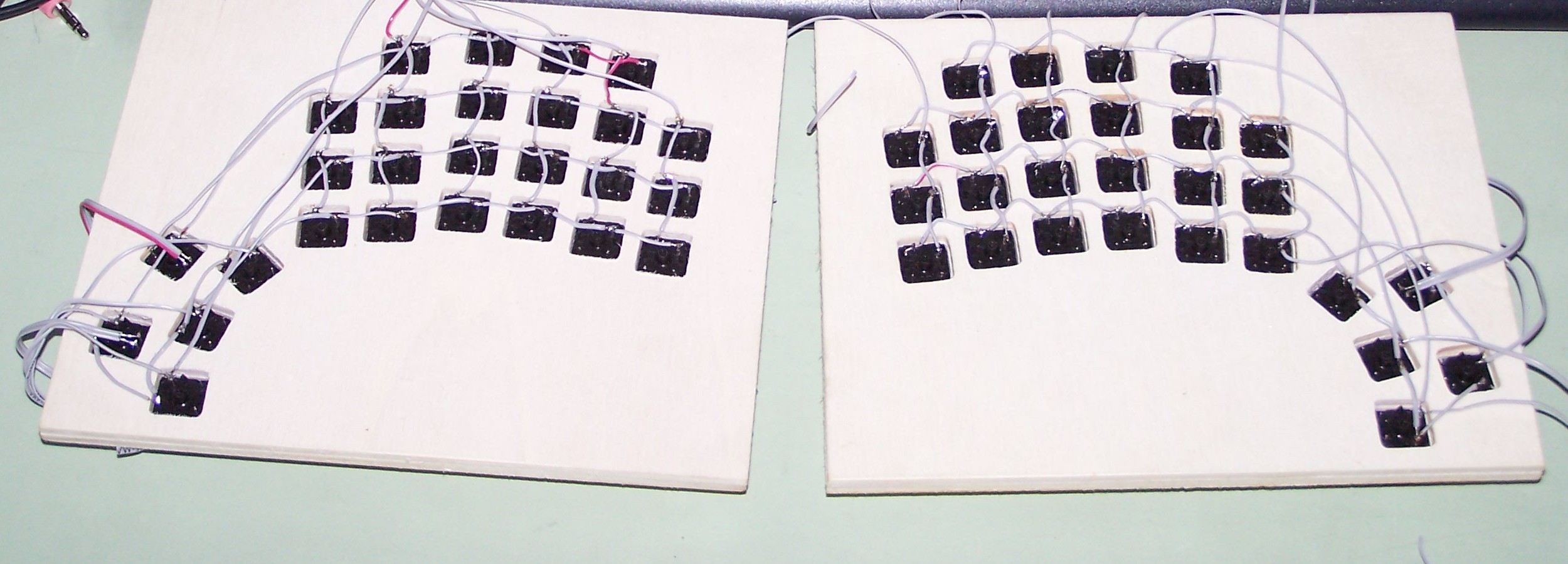

imp
24 Feb 2013, 02:50
bearcat wrote: I have a mill and i'm going to try cutting some grids this weekend. Thanks for the inspiration! :)
I'm a little concerned about the 14mm^2 holes; as i'm using a mill, it's tough to get sharp corners on inside pockets, and the cherry's have most of the "lip" on the corner. Did you have any trouble with the fit on any of the early prototypes? Or does the extra rigidity from the PCB below take up any slack or wobble?
You don't need to overcut the corners if your bit is small enough.
I did this boards long time ago with a 2mm bit and had no problem with inserting the switches. If you take a close look at the corners in the image, they are not perfect :).
tasta v0.1
tasta v0.1
The plates are 2x 4mm wood glued together after cutting them. Oh, and don't do the wiring that way, it broke way to fast (it's better to use enamelled copper wire).
bearcat
25 Feb 2013, 19:52
Whoa, that's great! Definitely gonna have to give it a go. Didn't get to it this weekend but have been playing around in openscad getting the model ready.
imp wrote: You don't need to overcut the corners if your bit is small enough.
Mind if i ask: what is the separation you're using between holes? E.g., a 14mm^2 hole separated by 3mm? 4? what's normal?
