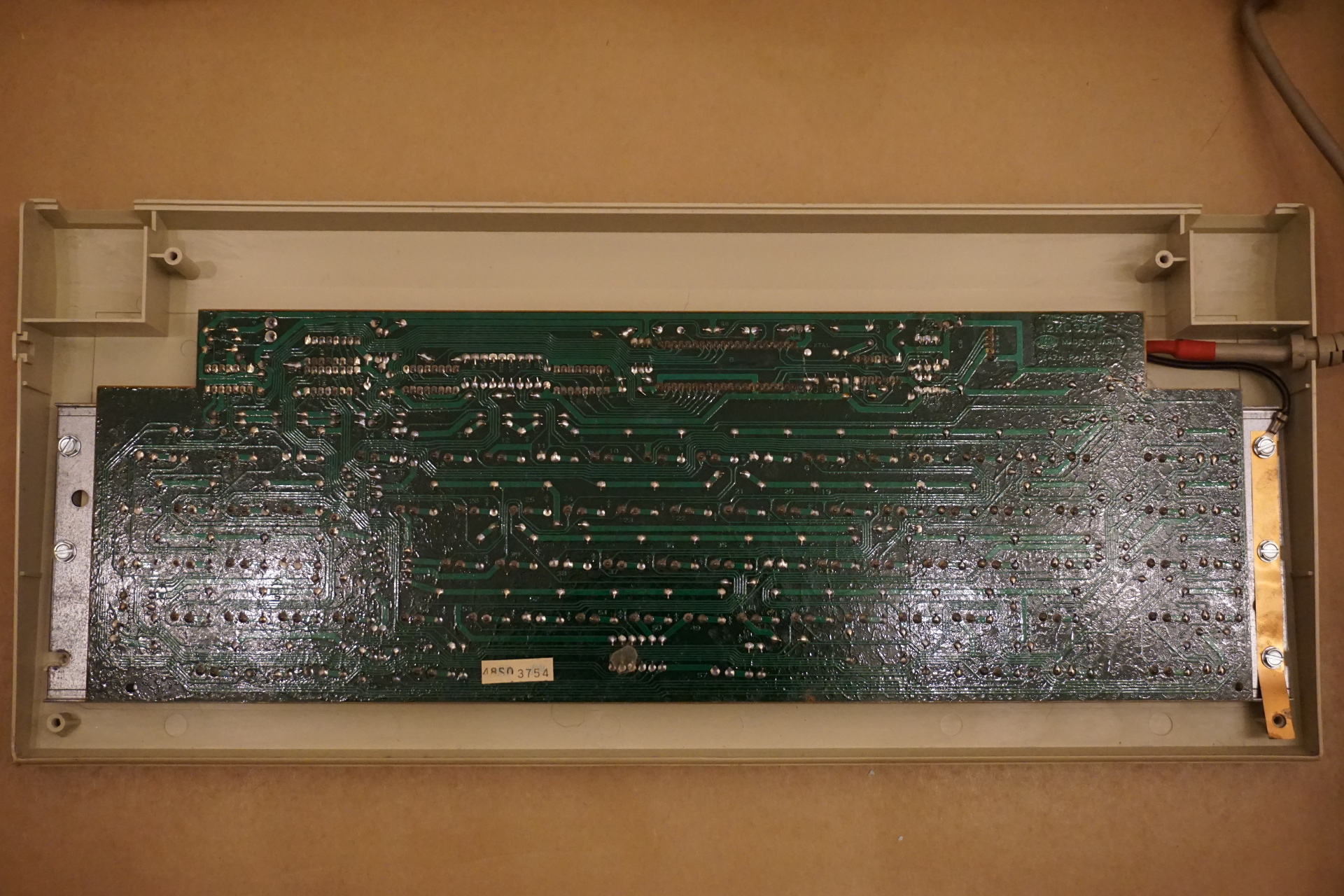

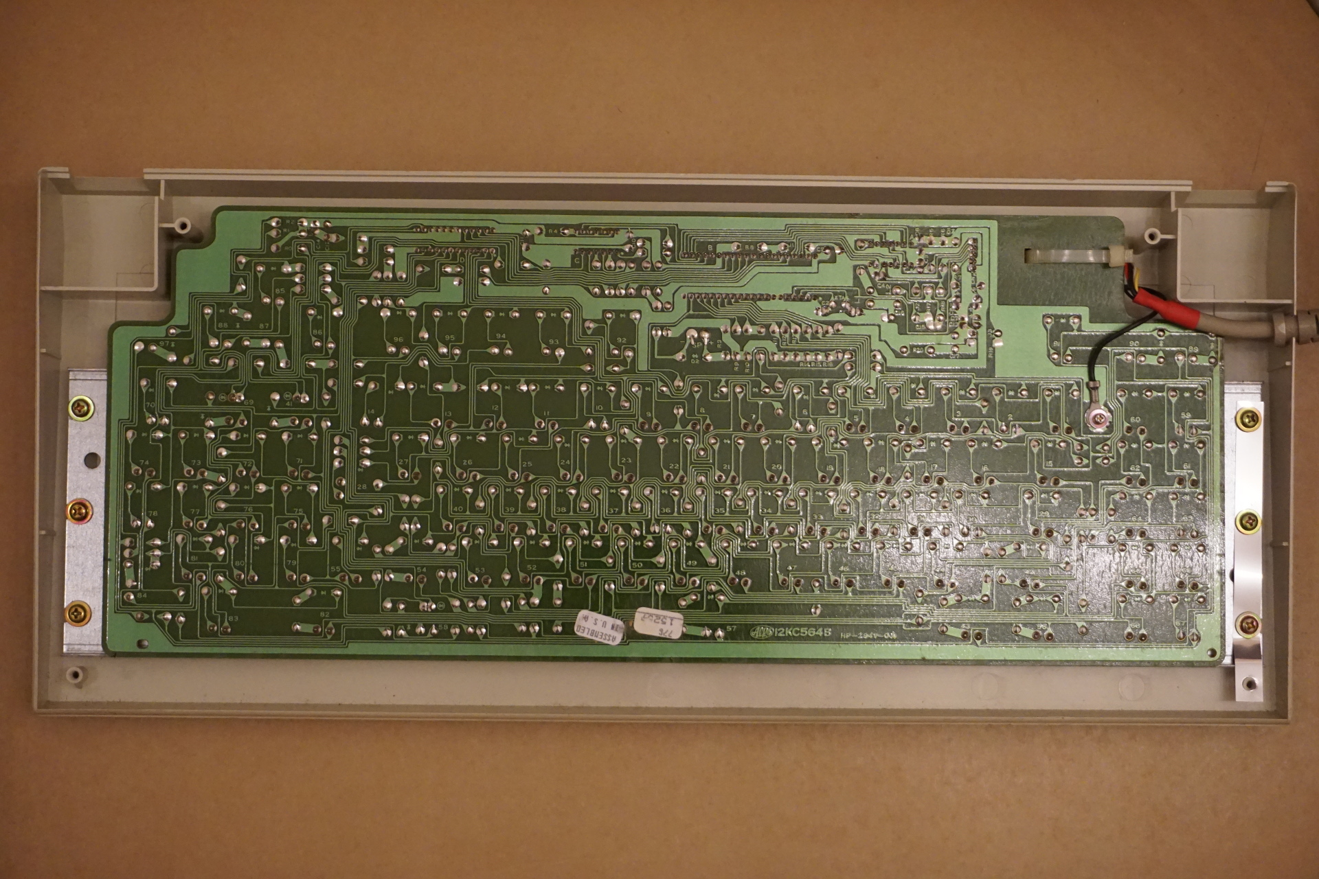

Posted: 22 Feb 2018, 22:31
by Slom
I always wondered about this whole "rounded edge" thing, so today I opened up my boards ...
rounded
angled
Posted: 23 Feb 2018, 01:38
by //gainsborough
Is the top one a beige label and the bottom one a black label?
Posted: 23 Feb 2018, 06:31
by Slom
//gainsborough wrote: Is the top one a beige label and the bottom one a black label?
Yes, exactly.
