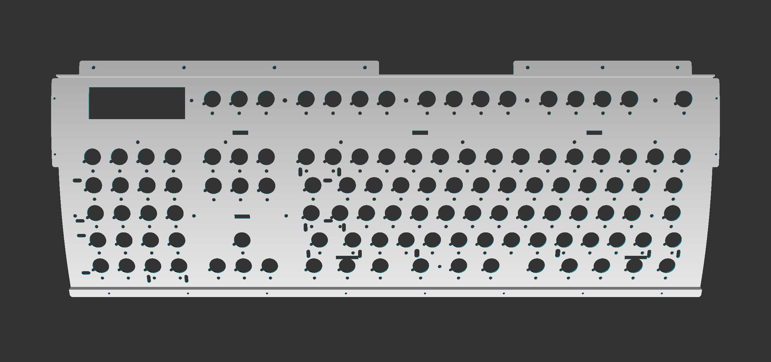

Looks good. Maybe it's the render, maybe I'm delusional, but are the F1-F4 cutouts *slightly* too far to the left?
lot_lizard
07 Jan 2017, 00:50
E TwentyNine wrote: Maybe it's the render, maybe I'm delusional, but are the F1-F4 cutouts *slightly* too far to the left?
Shouldn't be... I can double check against the previous renders with version control though, but key alignment has been hardened for quite a while. We did take the opportunity to center all of the key clusters in the top shell cutouts when the opportunity arose. If you study your Ms closely, you will see multiple clusters of keys that are not centered properly. They are very close, but .1-.3mm improvements were made throughout the board.
EDIT: just noticed the bottom corners weren't rounded on the final top plates when checking against version control. That has been corrected for both the SSK and Full-Size. I have updated the previous posts with renders for the top and bottom plates

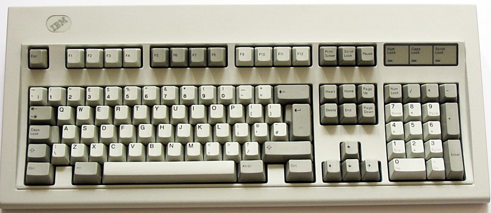

lot_lizard wrote:If you study your Ms closely, you will see multiple clusters of keys that are not centered properly. They are very close, but .1-.3mm improvements were made throughout the board.
I'm so glad that you are overseeing the design and production on these, lot_lizard. Your attention to detail is incredible! I had no idea that IBM had made errors like that in their design. Maybe it was because they were working in imperial units! ;)
lot_lizard
10 Jan 2017, 14:52
Techno Trousers wrote: I had no idea that IBM had made errors like that in their design. Maybe it was because they were working in imperial units! ;)
Appreciate the kind words... I don't know that I would call them errors, but they were odd choices by today's standards. Again, these are just minor alignment bits at best. I can only assume the location the key clusters was based on vantage point (which we still are mind you even with adjustments), but that it would have been originally for a person with their face MUCH closer to the keyboard than any of us would be. Targeting shorter folks that still needed to be hunched over the keys to hunt and peck?!? No idea... but that is the only thing that makes sense as to the cluster/shell alignment they chose.
E TwentyNine
10 Jan 2017, 14:54
I thought F1 was centered over 2, F5 centered over Y, and F9 centered over minus, but I cannot say I ever took precise measurements. That's not the case?
Can you give some examples of improvements made vs the originals?
lot_lizard
10 Jan 2017, 15:14
I'm traveling this week, so don't have anything to photograph, but the following captures it reasonably well. There are MINOR adjustments really across the board to be honest (aside from the core cluster). Arrow/nav/10-key are too far left, Esc too far right, and only the slightest adjustment to the function row. Again, please don't think I shifted things all over creation (these are .1-.3mm bumps). It isn't ever really noticeable in photographs because the vantage is so far away with the camera when the whole board is in view. Maybe they did it to photograph better?!? If you get your M out, set it in front of you at any distance that would be comfortable typing, you'll notice I think. I've tested alignment against several different shells with our prototypes to verify, and we are in a very good place.
EDIT: If I hadn't have called it out, I doubt any/many would have even noticed. I just studied this thing like an eagle looking for fish for a couple of months early on, so it became something that started to bother me as time grew (never noticed before starting this project).

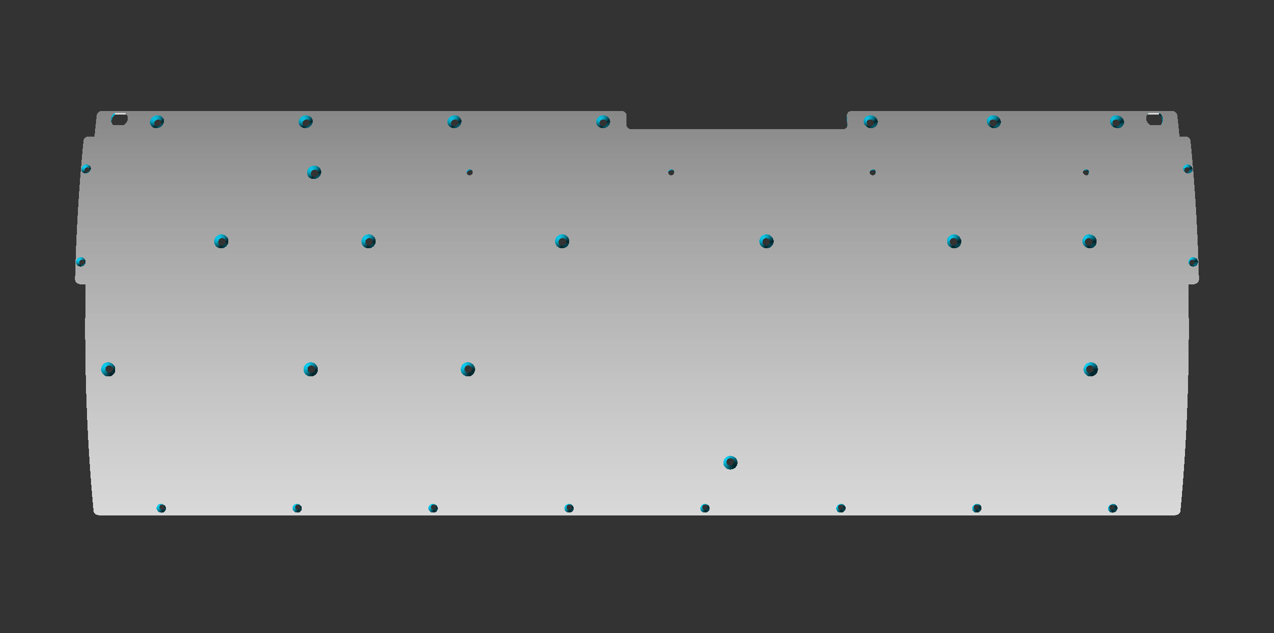

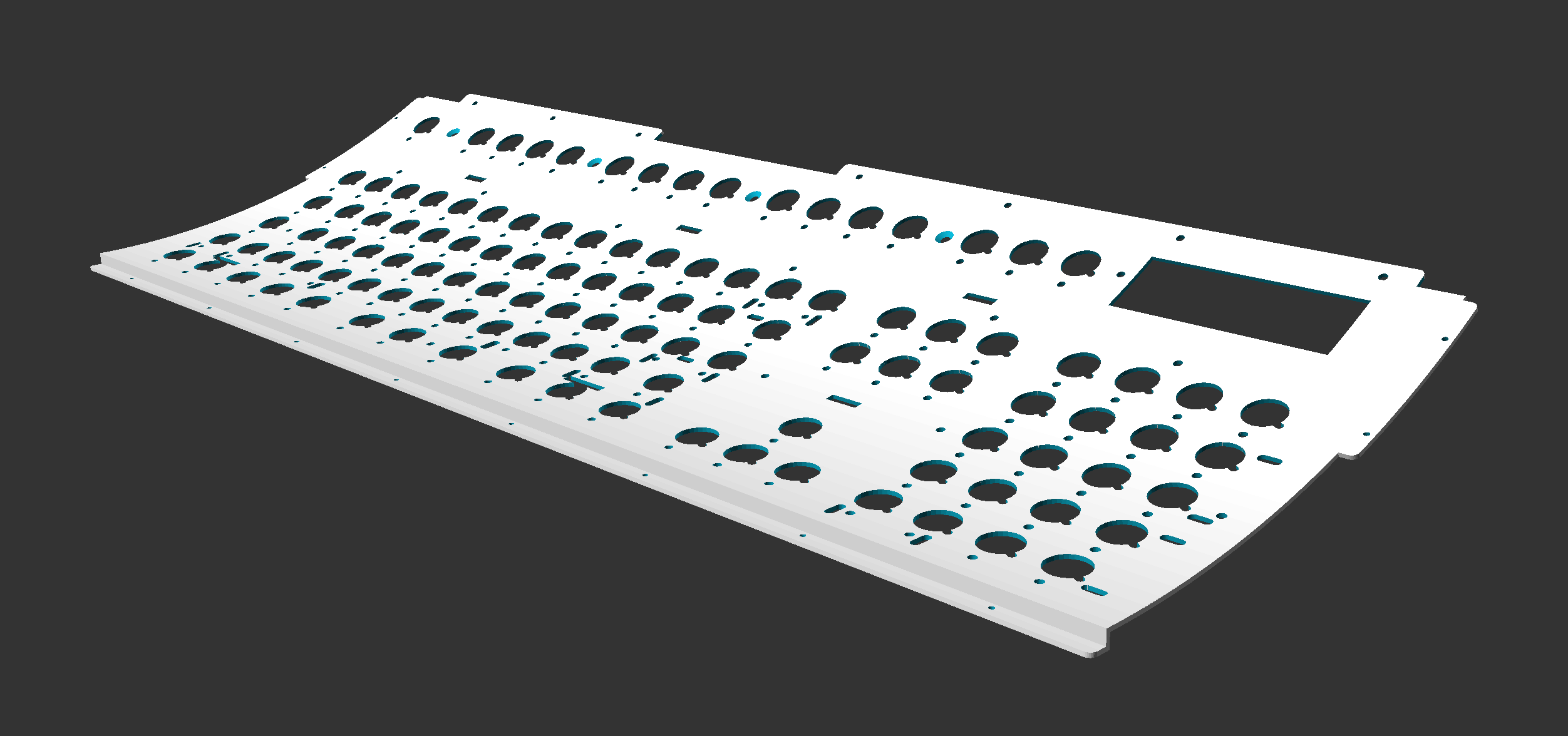

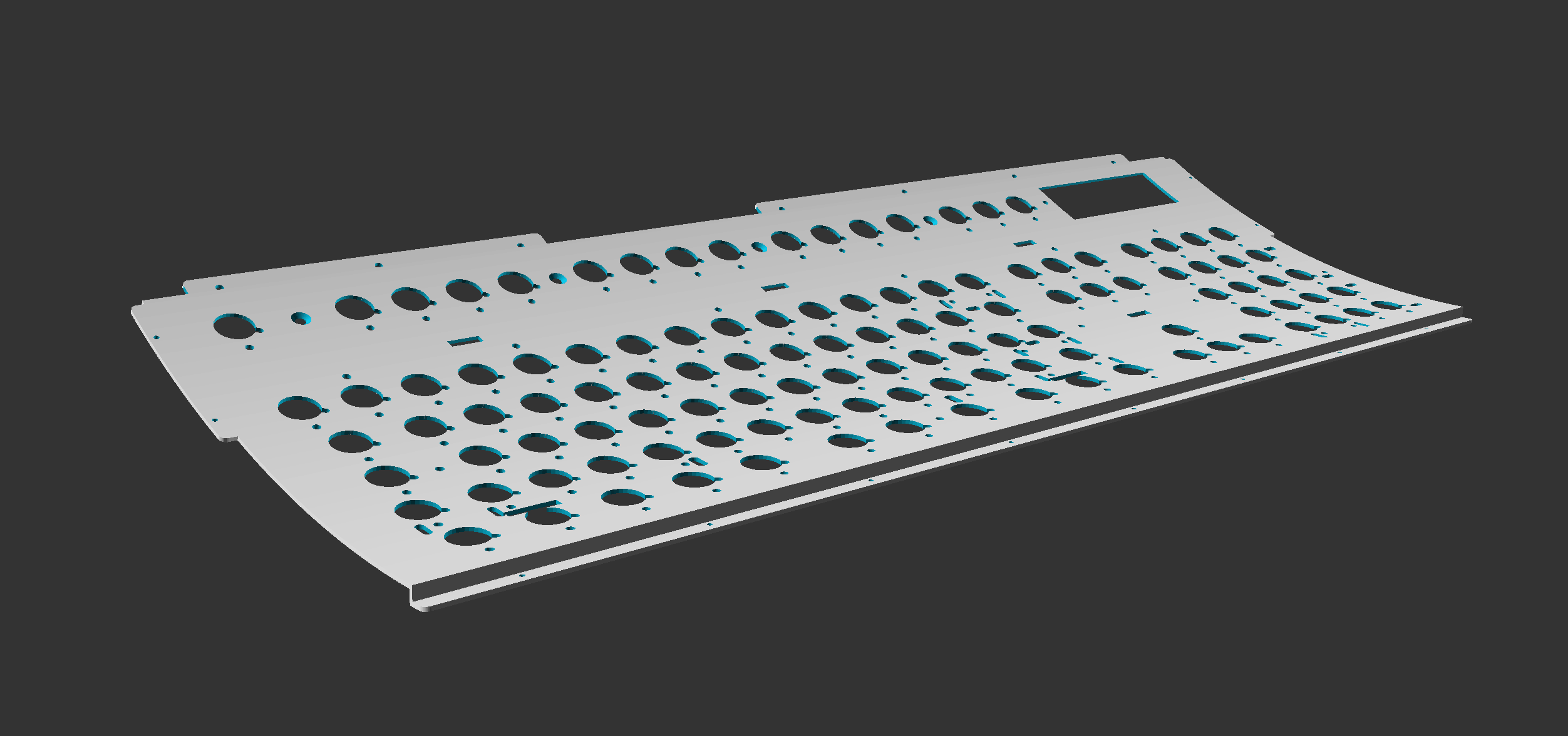

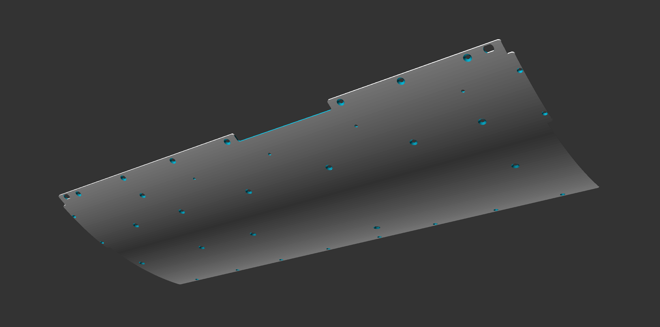

lot_lizard
12 Jan 2017, 03:46

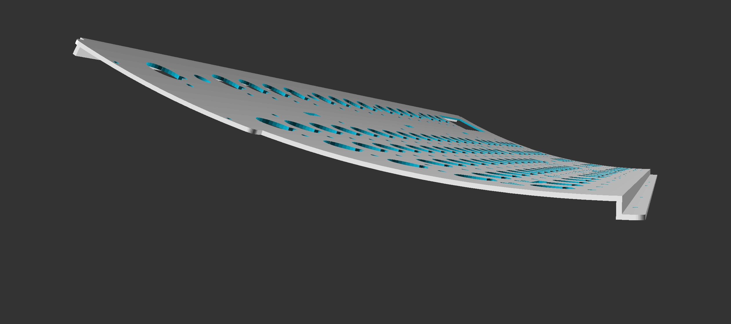

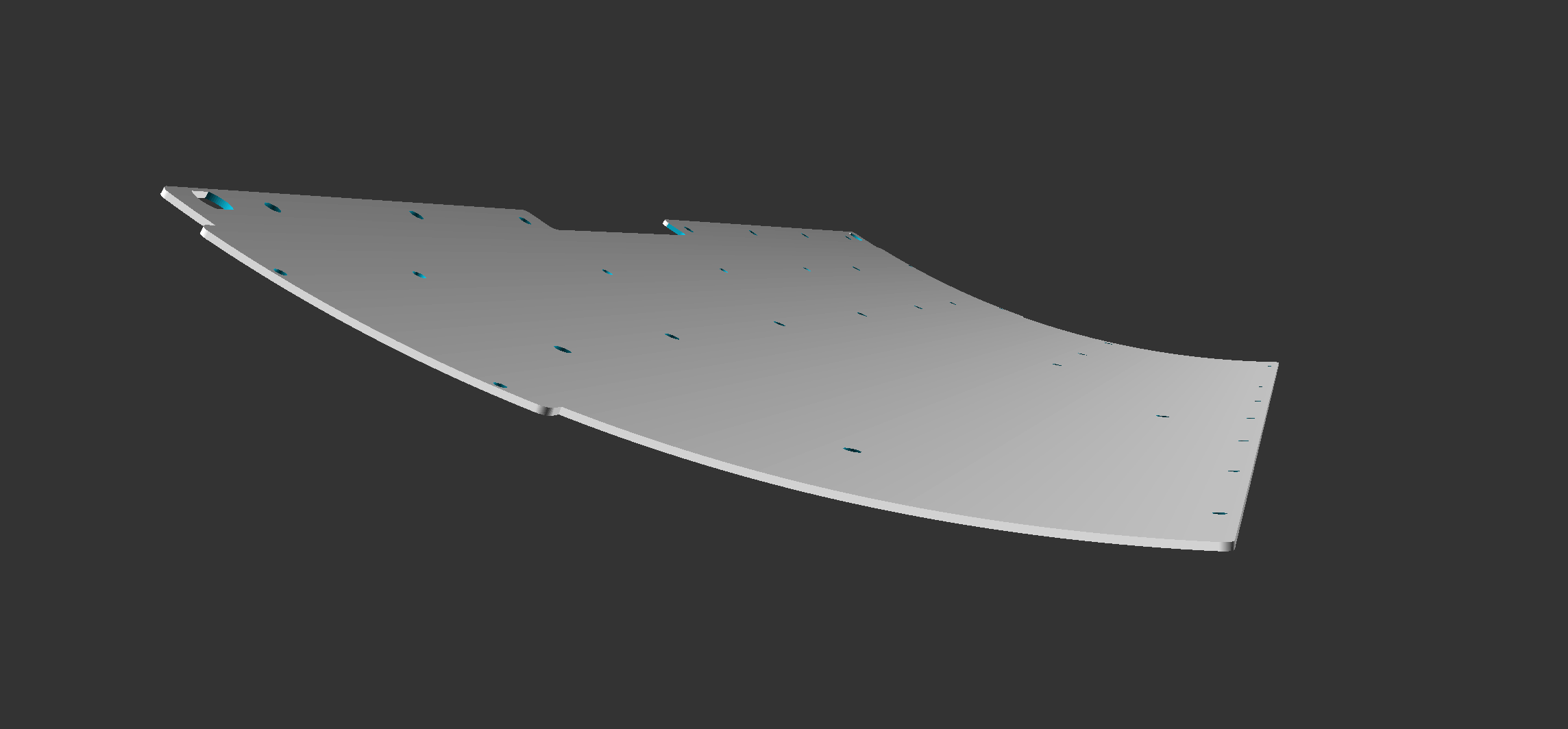

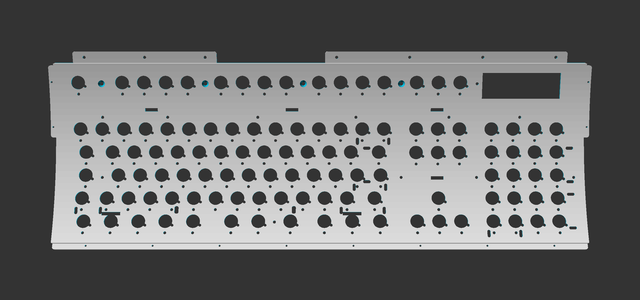

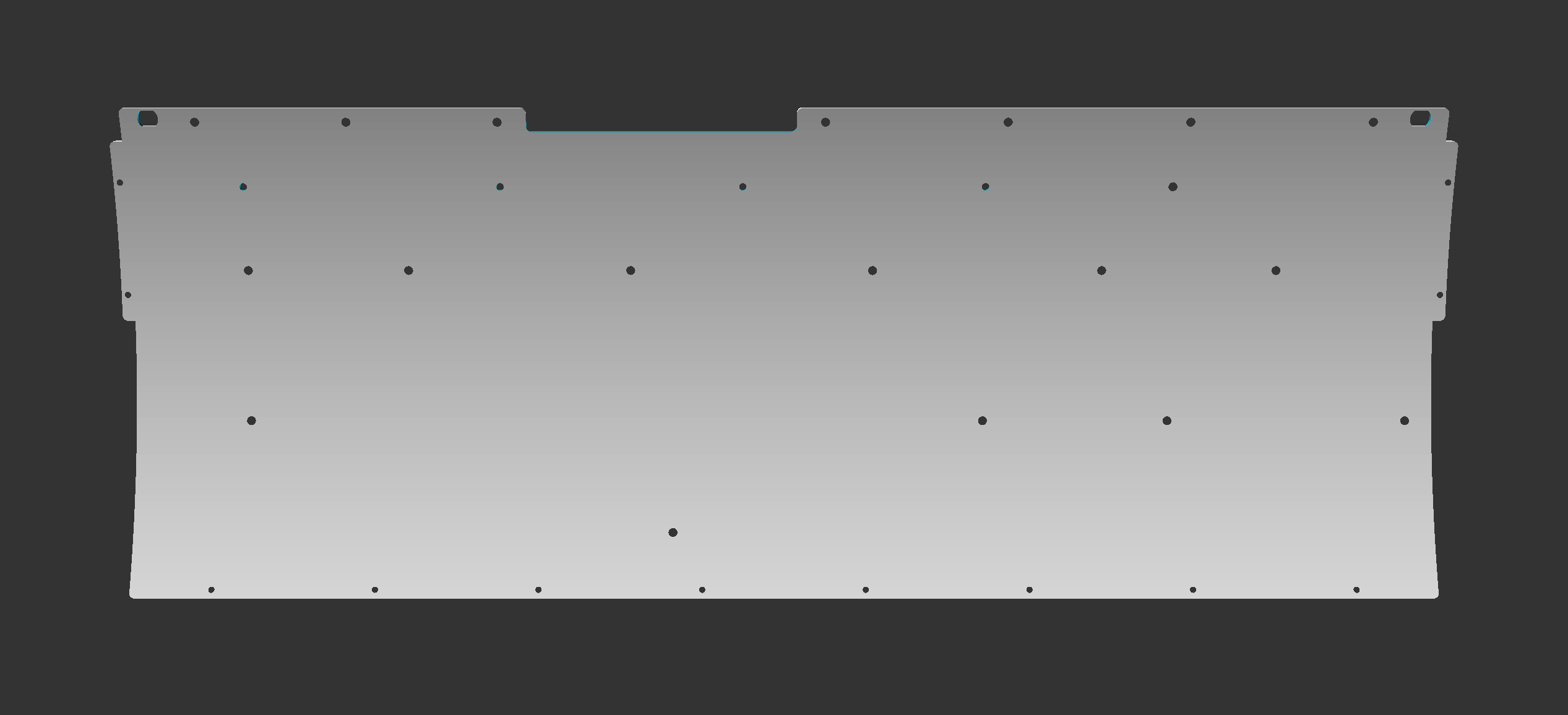

Return from my work trip tomorrow and will be home next week to make some progress. My wife has let me know that several packages have arrived this week. I did finish the updates to the Full-Size plates as well to align with our SSK adjustments. On Friday morning, I will visit our metal fabrication friends and have a final prototype made for both form factors. The following are the renders of the Full-Size top and bottom plates. It would probably be difficult to tell unless you really studied both the last and current versions, but there are approx. 15 changes of reasonable significance (mostly related to tension screw placement, the top ridge, LED cutout, and wire stabilizers... no adjustments to key locations). Like the SSK, the PCB will be grounded to the back plate with standoffs.
Full-Size top plate from above
Full-Size top plate from beneath
Full-Size top plate angled
Full-Size top plate angled from the other side
Full-Size top plate from the side
Full-Size backplate from above
Full-Size backplate from beneath
Full-Size backplate angled from below
Full-Size backplate angled from the side

Thanks for the update! Is it too late to ask for F style wire stabilizer points below the zero key position on the numpad? I can post a really crude mock up if it would help you to know what I'm talking about. I think that's all I'd need to have an all-F122 style numpad without alternate legends on the numbers.
emdude
Model M Apologist
12 Jan 2017, 05:16
I'm a little confused; shouldn't there be stabilizer cutouts for wire-stabilized numpad Enter and + keys?
I apologize if I missed something. If I did, then I'd also like to request stabilizer cutouts for those keys as well, if possible!
lot_lizard
12 Jan 2017, 06:37
They're there, just not in the renders for some reason again. I'll update the images when I return tomorrow/Friday. No worries, all three are present already on the numpad

lot_lizard
14 Jan 2017, 04:31

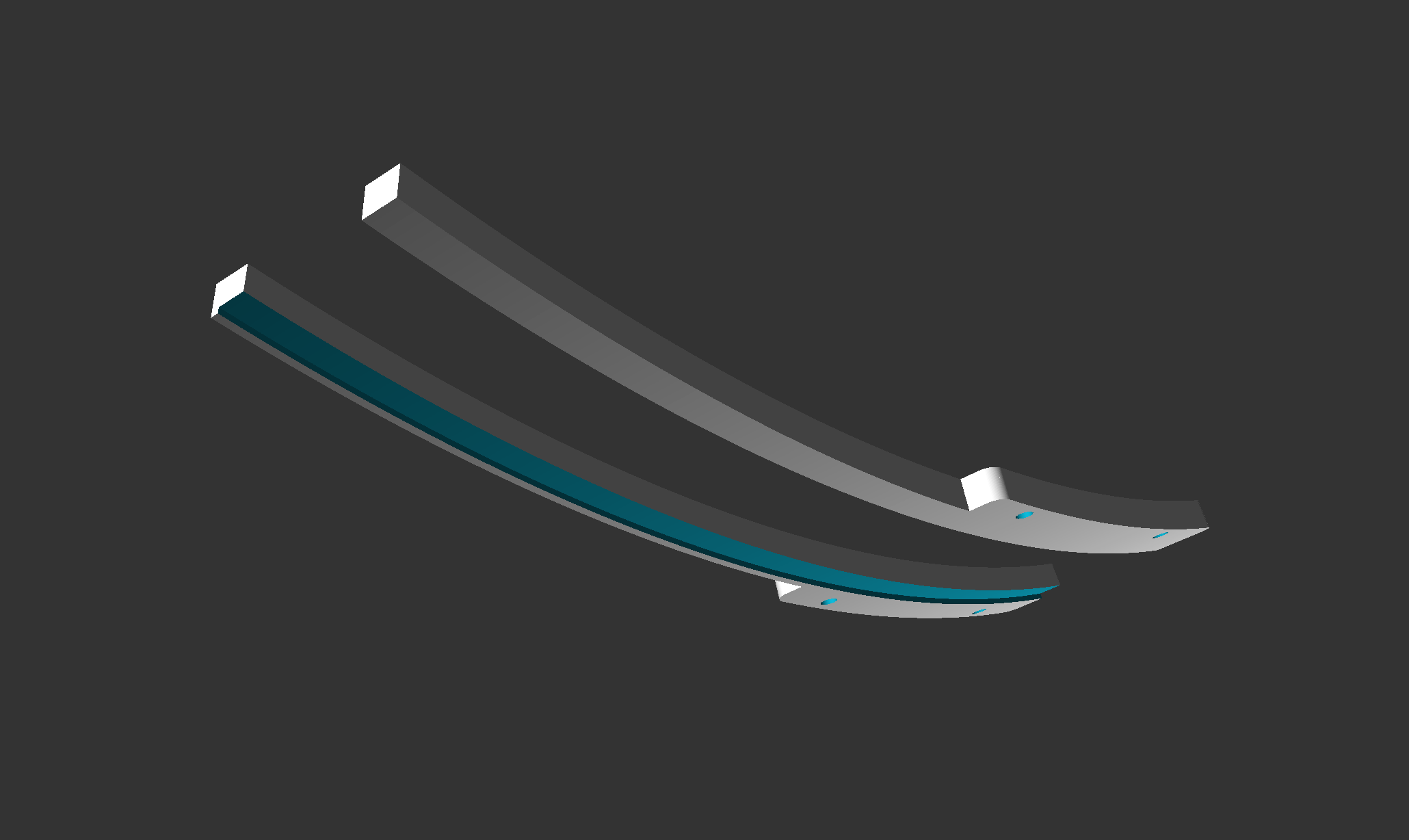

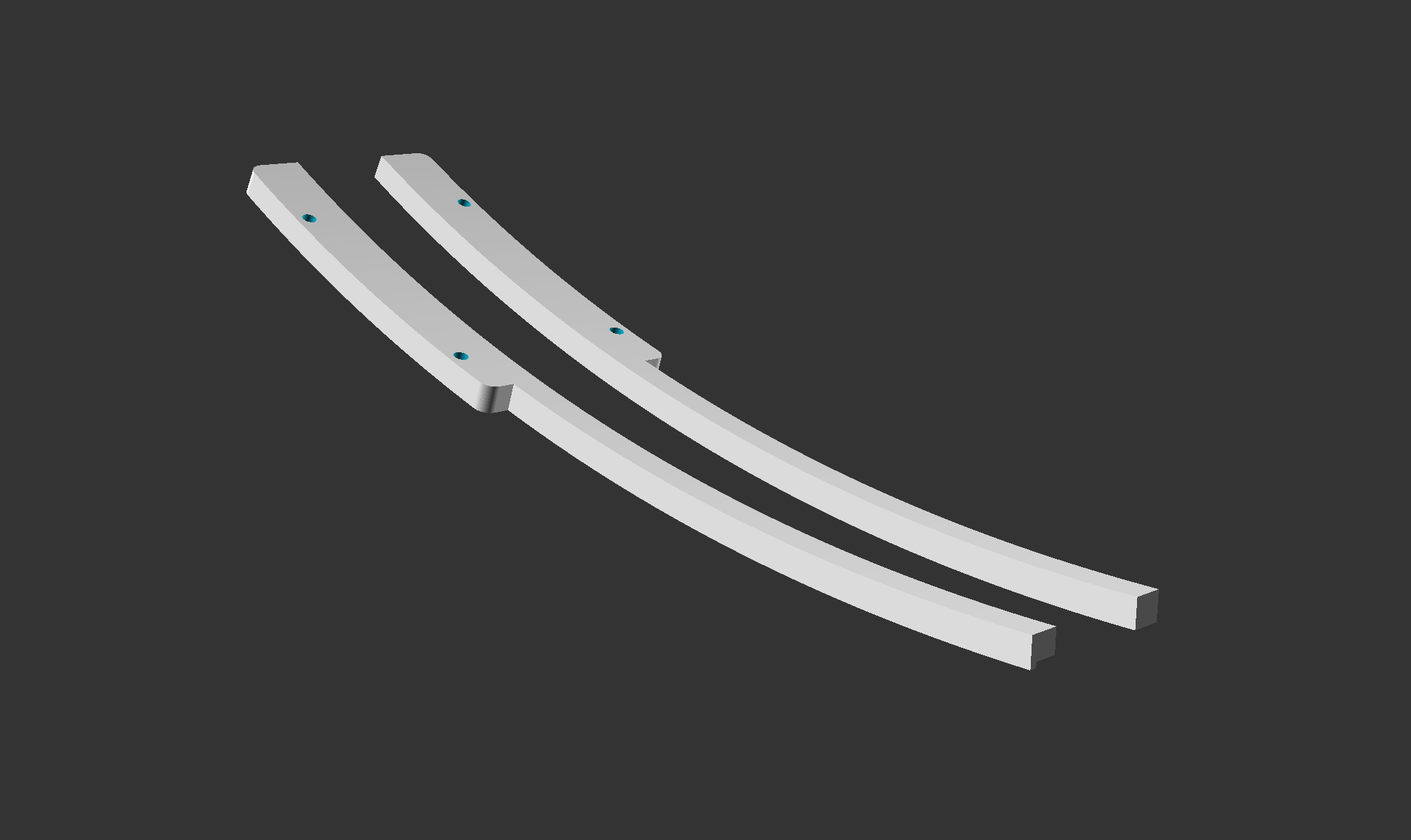

Previous renders have been updated. They take several hours at this point to build with the proper number of facets on a curved plane. We have managed to stress OpenSCAD to it's limits actually (at least with the high detail renders), as I have noticed on multiple occasions it omitting artifacts that should be there. Luckily the actual plates that are produced are only two dimensional PDFs, so we can really turn the facet counts up there as needed. It's been a fun exercise to learn the language, but it is certainly more suited to smaller projects... or at least those with less facets.
Attaching the images for the spacers for the Full-Size. The right side would be identical to the right side of the SSK.
Full-Size spacers
Full-Size spacers
Full-Size spacers from below
