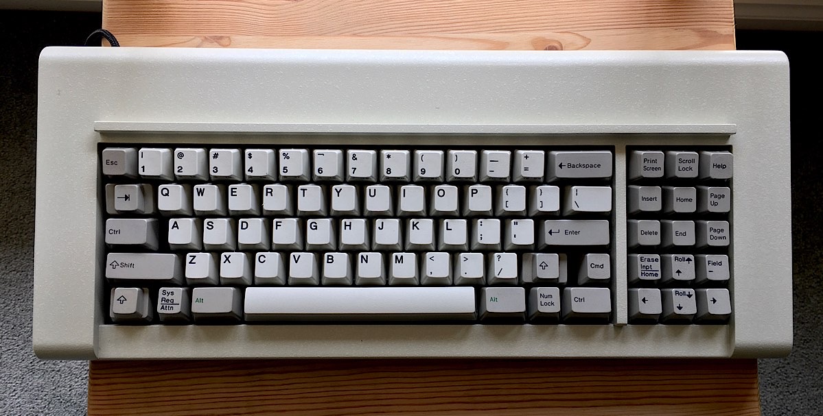

Got my F77 working with the QMK beta a couple weeks ago. Had some initial issues with keys not working and random keystrokes on the original xwhatsit firmware, but that all cleared up after switching to QMK. So big thanks to pandrew for his work on that.
Here are some pictures for anyone interested. All keycaps were taken from Model Ms. Also made a very minor mod to make the USB cable detachable.

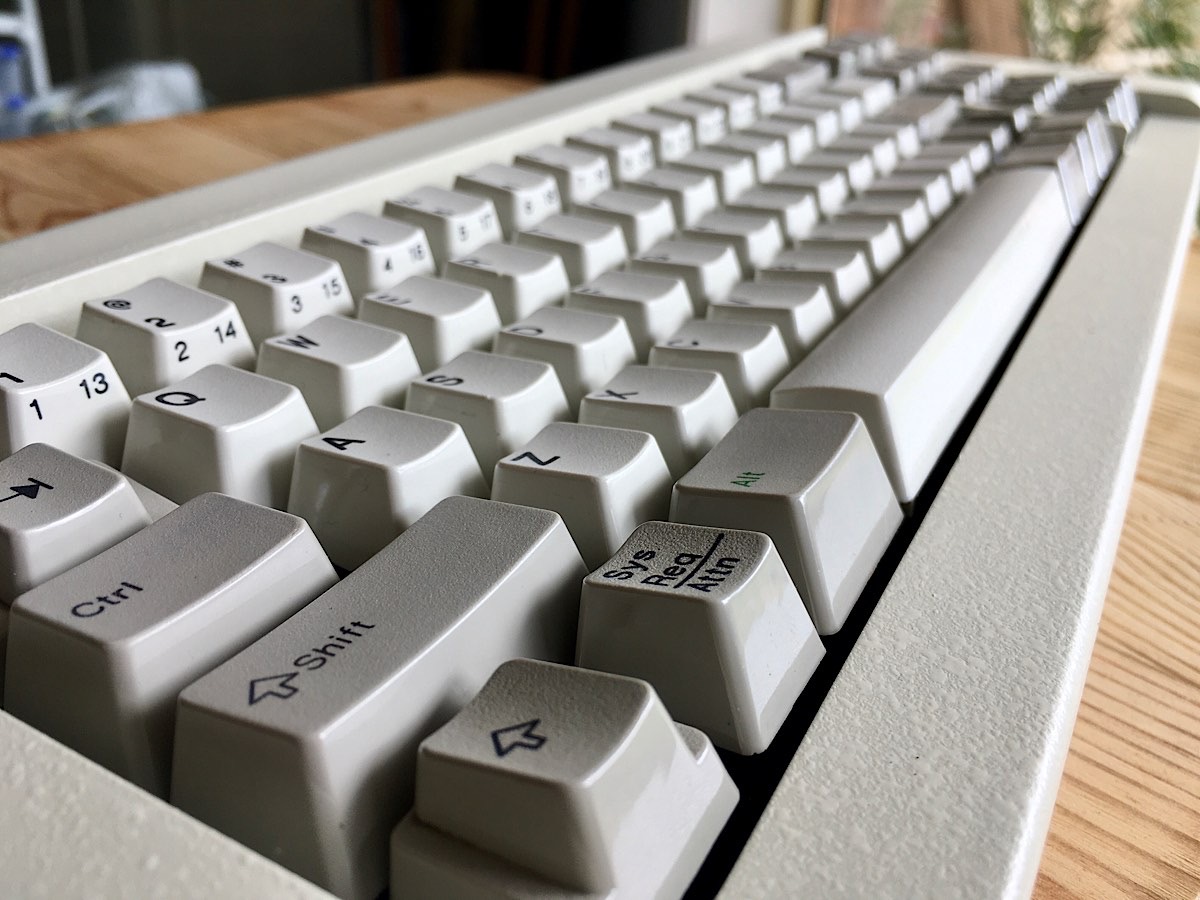

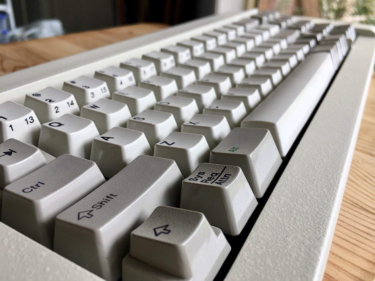

Some photos:
4704 50 key 20140714_155811 - Copy.jpg (1.83 MiB) Viewed 15321 times
20150314_125627 - Copy.jpg (1.02 MiB) Viewed 15321 times
20150331_195556 - Copy.jpg (175.36 KiB) Viewed 15321 times
DSC_6470 - Copy.jpg (1.34 MiB) Viewed 15321 times
DSC_6478 - Copy.jpg (865.49 KiB) Viewed 15321 times
DSC_6489 - Copy.jpg (526.63 KiB) Viewed 15321 times
DSC_6529 - Copy.jpg (1.55 MiB) Viewed 15321 times

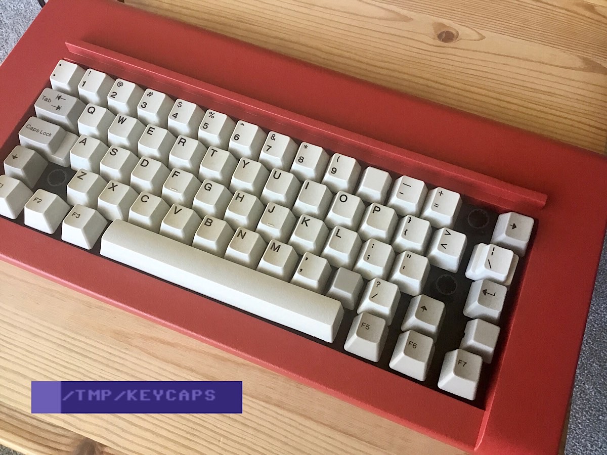

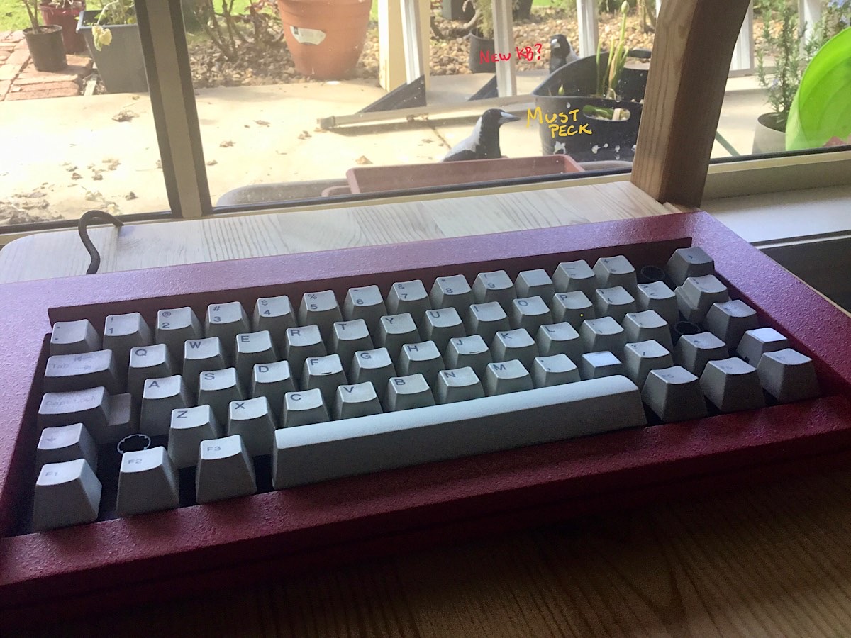

Finally got my F77, and i'm super impressed.
I did have one major issue - I had the problem where I had large swaths of keys that were unresponsive, and the issue seemed to be the pins on the ribbon cable connection poking through the tape and shorting out on the case. I layered some scotch tape for a temporary solution until I buy some more electrical tape.
I feel like Ellipse should check to see what's going on here, might want to invest in some thicker tape. :)
The typing feel is amazing. I had heard the Model F had a lighter actuation than Model M but I was really surprised with how light they are. Even though they are light, they have a very satisfying tactile event. The more I use it, the more I love it.
It sounds like a bag full of nails and springs tumbling down a hill. The ping and general racket of it all is impressive to me but perhaps a bit much for my girlfriend. :D
Still, even she agrees, it's quite the looker:
After ensuring the hardware was all working properly, I started my journey on the firmware side. It took me awhile to figure it all out for my particular board/firmware, so I'll post simple instructions for anyone who needs them here. I found the manual to be extremely thorough but overwhelming with the possibilities. Remember though, this was my path. Your mileage may vary.
My board came with QMK firmware installed, so I assume all boards coming out from this point on will??
I messaged pandrew who sent me detailed instructions showing many different paths that might be overwhelming. This is what I did. (Windows 10, QMK Firmware)
1) Go to the Online QMK configurator from pandrew (link in instructions).
2) Select your exact configuration from the dropdown, use the /wcass one, and then select the layout you have
- your entire default layout below might disappear at this point. There should be a link to a zip file with a bunch of different .json files, find your right layout and drag/drop it onto the online configurator. this will reset your defaults.
- you might now notice that your enter and left shift have iso splits - just ignore it. Double check that you choose an ansi layout if you are ansi.
3) Make your alterations to the layout how you prefer.
4) Click COMPILE button in upper right. The service may be down as it was with me, but after a moment it was back up.
5) Download the .hex file with the FIRMWARE button which is now lit up. It may say "are you sure you want to leave site" but dont worry, it wont take you away from the configurator. It will just download the file to your local.
6) Download QMK Toolbox, install it, run it.
7) Select the .hex file you downloaded from the configurator, and under MCU select atmega32u2
8) On your F77(62 also?), Hold LSHIFT+RSHIFT+ESC to reset, QMK will tell you that a DFU device connected
9) Double check your Local File and MCU are correct, and hit FLASH.
10) Profit.

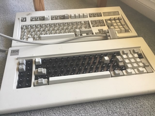

I have an F77 and an F62 still with the xwhatsit firmware. They are gorgeous to type on. Compared to my old Model F the feel is almost identical (except for the space bar) and even the metallic after-ping is very similar although it’s a slightly different pitch or tone (not sure exactly)... very impressive.
While waiting for the keycaps, I am using some from old keyboards but didn’t have enough of the correct ones so the layouts are a bit eccentric.
A couple of notes on my issues and resolutions:
  • The F62 worked out-of-box (almost). I carefully followed the instructions in the video for adding the keycaps but I still had some issues with sets of random characters for a couple of keys. In each case however it was fixed by redoing the key VERY carefully to ensure the spring was in the correct position. So... my fault.
  • The F77 was spamming lots of key press when plugged in. I tried it with a Dell and an Apple, with unpowered and powered hubs, and with USB ports on a thunderbolt dock. Same in all instances. Temperature made no difference. Fortunately I found an really easy solution that didn’t require reloading firmware or anything complex at all. I detailed that over on the Geekhack thread previously. It is perfect now.
Now I’m waiting for the printed keycaps and solenoid.
The keycap donors. These were broken and very dirty:

Posted: 10 Sep 2020, 23:13
by Tritian
Not to outdo darkcruix, but i'll be taking mine scuba diving next week. ;)
Seriously though, I tried to take a better natural light photo for the color red, but then this happened to our skies:
But anyway, I decided to try my hand at photographing it again indoors. This time with better lighting/saturation, although i'm not actually any good at photography so bear with me.
And with some Model M caps instead of M13
@scarpia, would love to see a pic of yours with that ibm badge
