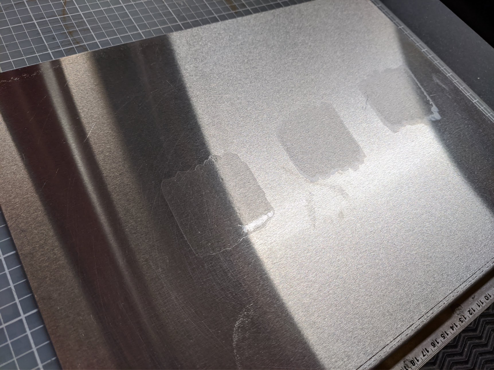

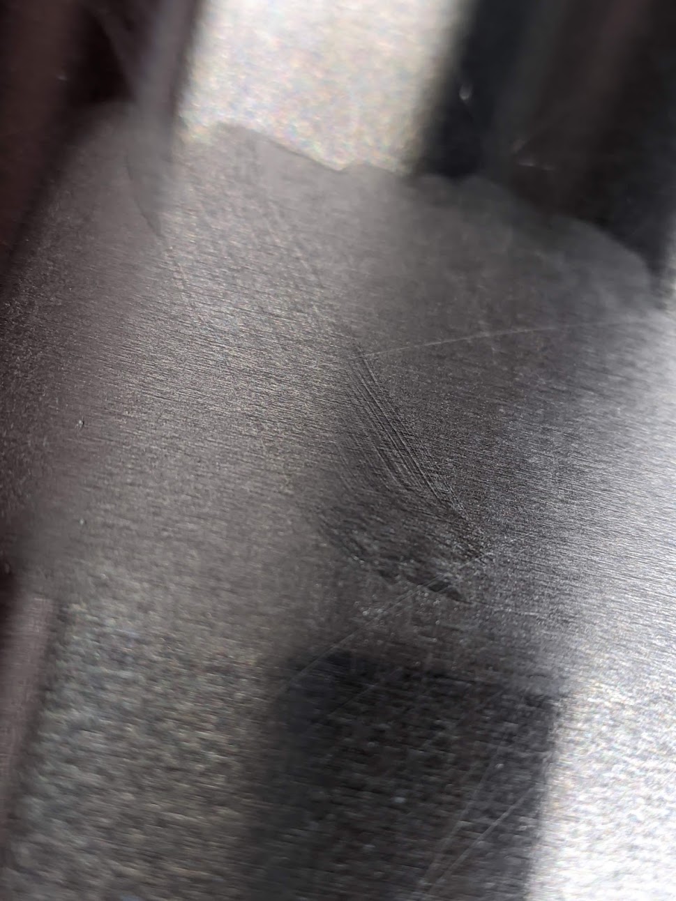

Xylene seems to dissolve wax pretty well (albeit very slowly). I soaked some blue alps stems in it and they seem untouched after a few days so it should be safe to use. I made a solution of xylene with as much paraffin as it can hold and filtered out all the particles. Applying it to a surface with a cotton swab and letting it fully dry does leave a nice coat of wax.
I tried a few switches with it and overall it's not as good as boiling imo. The wax never gets back the film strength that it had before being dissolved. Boiled switches are just a hair smoother, less bindy, etc and all the messing around with xylene is way more mess than a pot of hot water.
