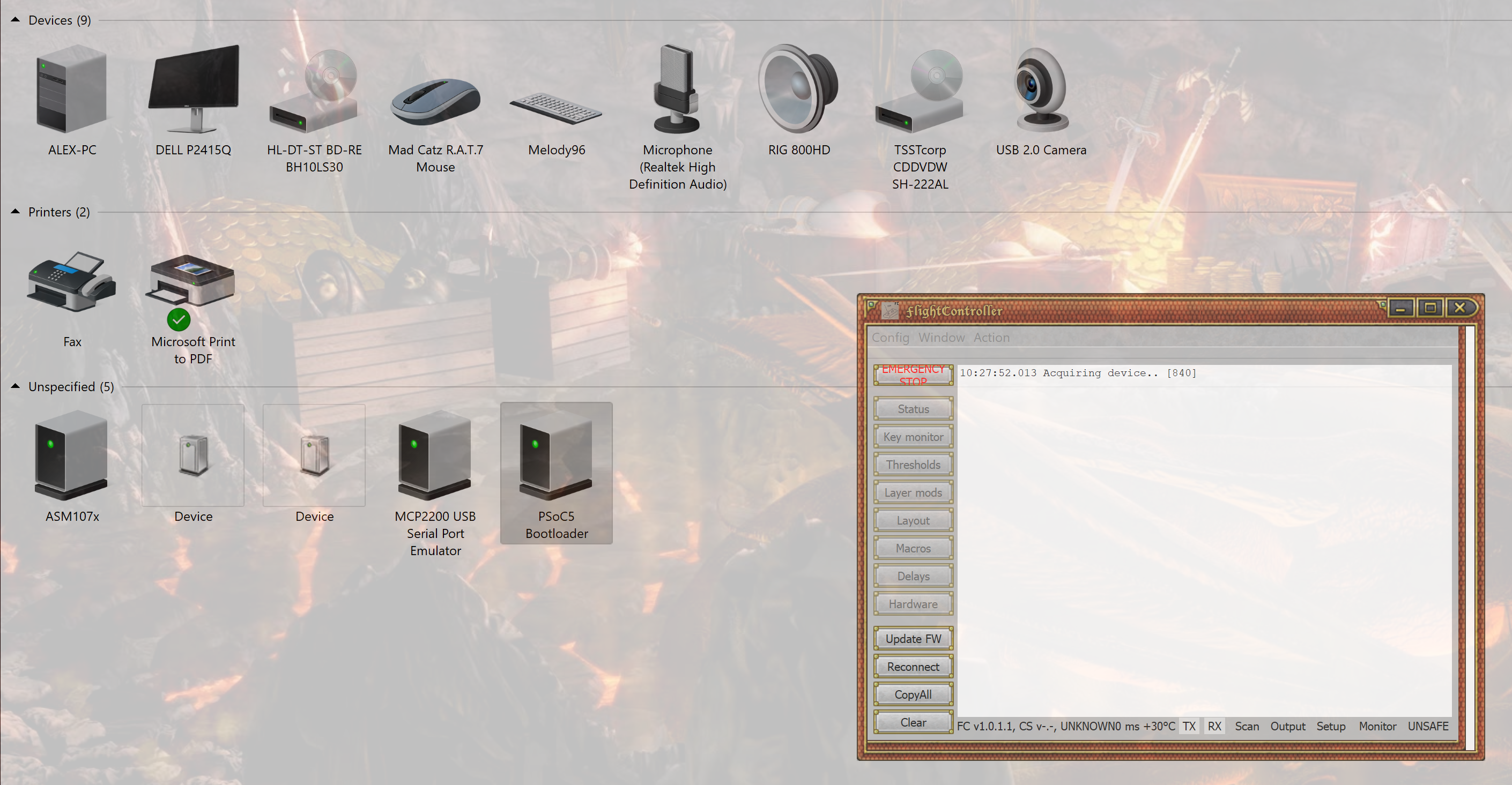

ok I am getting this error from the PSoC when trying to aquire ports
There was an error running port acquire: PSoC device is not acquired! Check connection of the chip to the programmer
This same error i get with 2 controllers when they are soldered with rows/colums. The 1st board after desoldered would program fine, as would the 2nd before soldering to the keyboard.

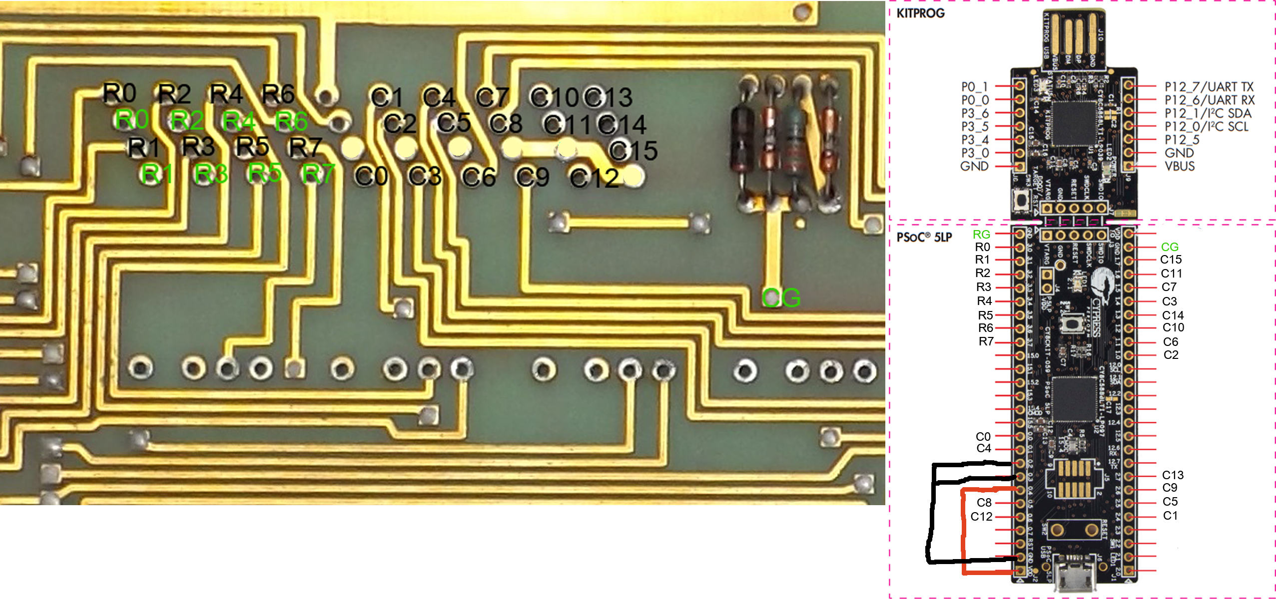

Below is the layout of connections on keyboard and also pins on the contrioller, please could someone tell me where i am going wrong, thanks.
RG = Row Ground each row is connected together CG = Column Ground

Wiring looks good, I believe. Are you by any chance using a USB hub? I had trouble with USB hub (even a powered one) when trying to connect/write to the board. Only plugging it into a dedicated port on my PC did the trick.Anakey wrote: 16 Mar 2020, 23:09 ok I am getting this error from the PSoC when trying to aquire ports
Also did you try aquire port at all before you did your wiring? Just to make sure it wasn't faulty. If not, I know it doesn't help now but that's what I first started checking the second time I did a commonsense project.

Hi Snack, i was able to flash the bootloader perfectly fine before soldering the rows/columns first thing i did with the new controller to check it was not a software issue
tried different cables and ports on the motherboard still same issue

I should have checked better. Didn't realize you had the full thing pinned out.
I know that 3.2 is skipped. Try disconnecting that maybe? I'm not sure what the pin is used for but it's skipped in the documentation. https://github.com/dmaone/CommonSense

You can only program from the KitProg end **once** - KitProg will fail to acquire port after programming because programming pins are reused as GPIOs. This is fine - use the other end and FlightController.
If you _seriously_ screw up something - USB pins can be used as programming pins, but this is a bit trickier to do.
You can't fry the chip by swapping SWDIO and SWDCK - but make sure that Vbus, ground, and reset pin are connected properly. Swapping ground and Vbus is obviously fatal.
Your PCB looks significantly different from 4 ITWs I've seen. Like, _completely_ different. Post the full keyboard pic, top and bottom. Doesn't have to be 12MP, but decent resolution so pads are 3+ pixels across.

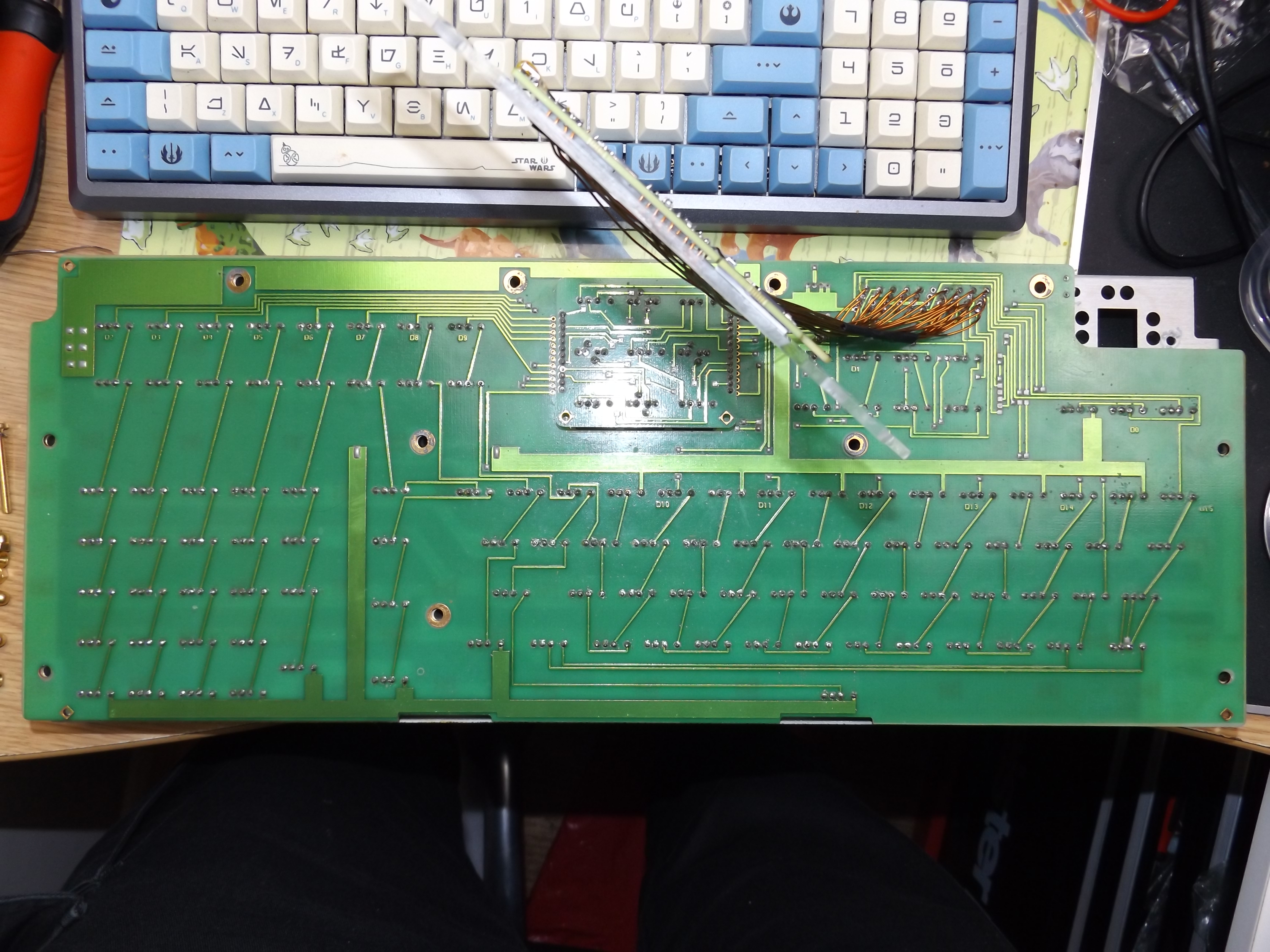

Hi DMA, i made a thread on this perticular board here viewtopic.php?f=7&t=22722 where there is a shot of the full pcb bfrom the front side
here is from the back

Sorry, I don't really exist here - I'm summoned by PMs and couple topic's notifications and miss a lot of things.
Interesting - matrix PCB completely devoid of active components.
You have BIG cojones or an access to a good desoldering tool or both, Sir.
Do not do that at home, kids, especially with intermediates. Those ferrite rings are brittle as hell and, in intermediate magvalve, the leads are hanging off the ring with virtually nothing to support them. One unlucky pull is all it takes to break that ring.
It's hard to trace the PCB without colored pens - but it looks like you're driving by the long trace (the one that gets from entry point to the far end of the row.
I did it the other way - primarily because that long trace was shared by 2 (sometimes more) rows and they are shorted together at the driver. Might be important - but then again, might be not.
I guess you have access to a scope. Go here, look at *_clk_pulse_*.png and compare with your favorite row and column at PCB edge. I would recommend starting with one that doesn't go via the daughterboard.
If you don't - well, good luck, I guess.
If your problem is acquiring the port tho - you are not expected to program more than once, as everything is configurable via FC. But even if you want to remap pins or change code - FlightController has "Update FW" button. If you change the code enough to crash firmware - the button on the kit resets it to bootloader, which you can program with either FC or "Bootloader Host" utility (in creator's menu somewhere)
PS: Oh, and another thing. Columns usually have diodes between column traces and common point. Are you sure the CG is directly connected to the far end of the column switch chain?

Hi DMA, this was all hand desoldered using a ss02 engineer though i did get a desoldering gun for christmas so if i ever need to do something as complex in the future it would be a lot easier.DMA wrote: 18 Mar 2020, 04:08 Sorry, I don't really exist here - I'm summoned by PMs and couple topic's notifications and miss a lot of things.
yes you are correct the rows are starting all the way to the far right of the pcb. not sure about what to drive, as i have not got to programming with flight controller yet, still trying to work this out given its frirst time i have used capsense, as i am more used to programming contact switch boards using a teensy and QMK.DMA wrote: 18 Mar 2020, 04:08 It's hard to trace the PCB without colored pens - but it looks like you're driving by the long trace (the one that gets from entry point to the far end of the row.

If you have a look at the back picture i posed above you can see the wide trace to the right of the daughterboard, this is where all the columns are joined to and if you follow it up you can just see if you look closely where the solder point is just above where the kitprog part of the controller is. If you then look at the front of the pcb, that solder point was a through hole connection between the back and front of the board, with the only thing after it being the 4 diodes/resistors as can be seen in my earlier pic a few posts up. I guess as this pcb is very old in terms of mag valve, that is why the layoout and setup with the logic being on a seperate controller board looks so different compared to the more recent versions of the switch.DMA wrote: 18 Mar 2020, 04:08 PS: Oh, and another thing. Columns usually have diodes between column traces and common point. Are you sure the CG is directly connected to the far end of the column switch chain?

This is inductive, not capacitive. This makes things much, much worse. Capacitive is walk in the park compared to inductive. You're at the edge of this hardware's capabilities.
As for QMK vs FC configuration - just forget about reflashing, ever. Set number of rows in config.h, flash firmware, you're done with reflashing for the kit's lifetime (unless there are serious bugs in firmware).
All settings are applied as soon as you upload them, without firmware restart even. If you did something you regret doing, and lost connection - pull out, plug in, you're back to EEPROM config.
I do not know why, in 2020, you must reflash QMK without any changes to hardware. This is plain stupid.
It wasn't an option for capacitive boards because you need to _fiddle_ with thresholds and good luck doing that with reflash at every iteration, so I did it the way I did - but also because requiring people to reflash because they wanted to remap a key is plain disrespect for your users' time.
About logic being on a separate board - here's the thing: on other magvalves columns have diodes and those are connected to this common point which has approximately the same diodes/resistors arrangement. I might have missed something, that's why I was asking.

Platform, screenshot of main window?Anakey wrote: 19 Mar 2020, 22:07 I am having a problem, flight controller does not see the controller board so can't connect to it connecting it from the micro usb side

OK. Looks like it's in bootloader for some reason. update fw - navigate to project dir/Compiled, find .cyacd there. It should program the device and after that it will likely boot up.
Do you by chance have the button on the kit pressed by something?

Thank you for that, managed to flash the board and get it into safe mode
now i have the seemingly impossible task to get the keys registering which is going to take a few hours to do. i may need to look at replacing the magnet wire i have used possibly with shielded wire to reduce interferance

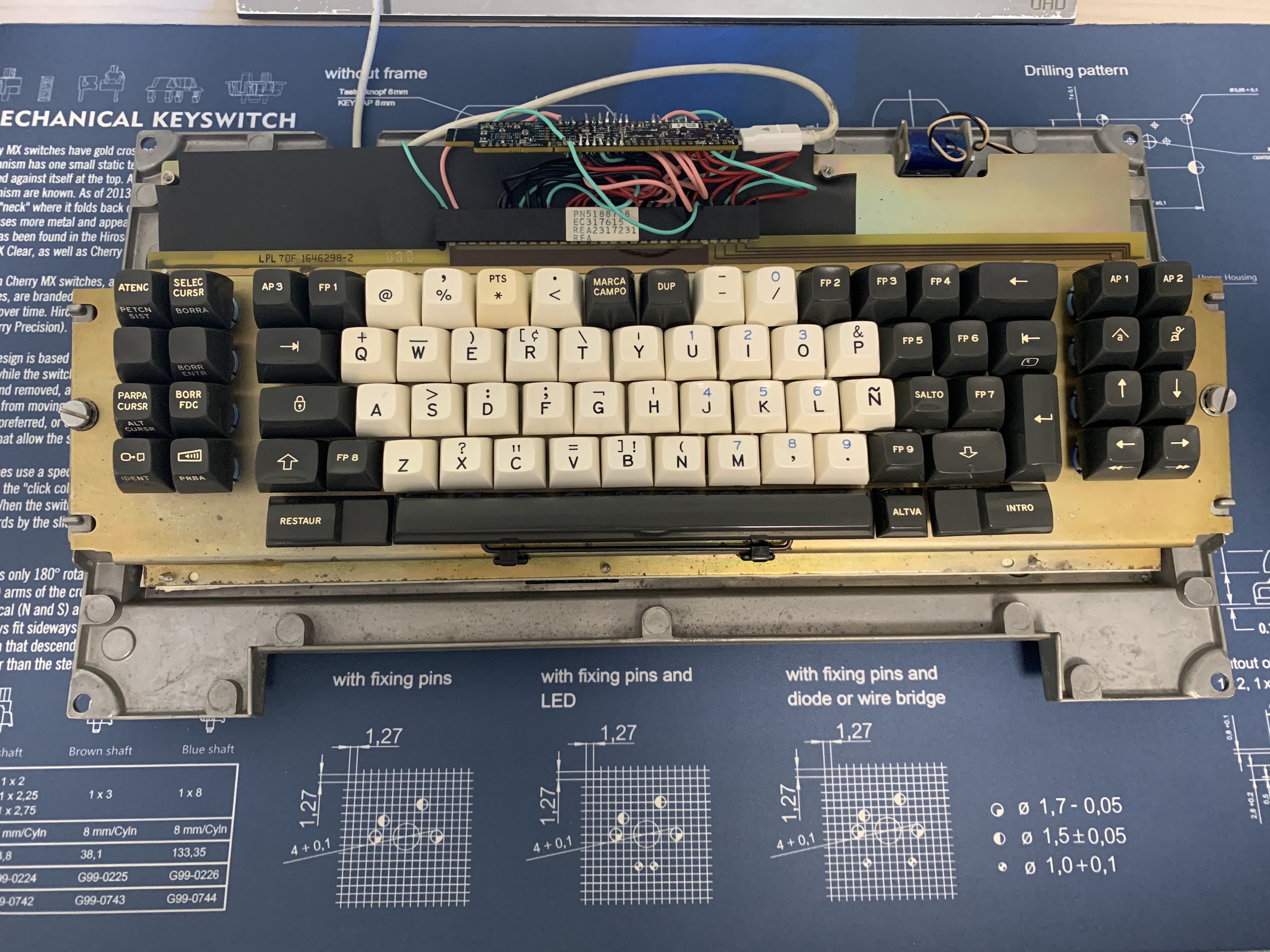

I succeeded! Did a messy soldering job but it worked just fine.
Currently typyng on my Beamspring, can't be happier about this. I ran over some issues with some keys actuating multiple times, in particular the "M" key. Without even full pressing the key it triggered 20 M's, atm everything works perfect.

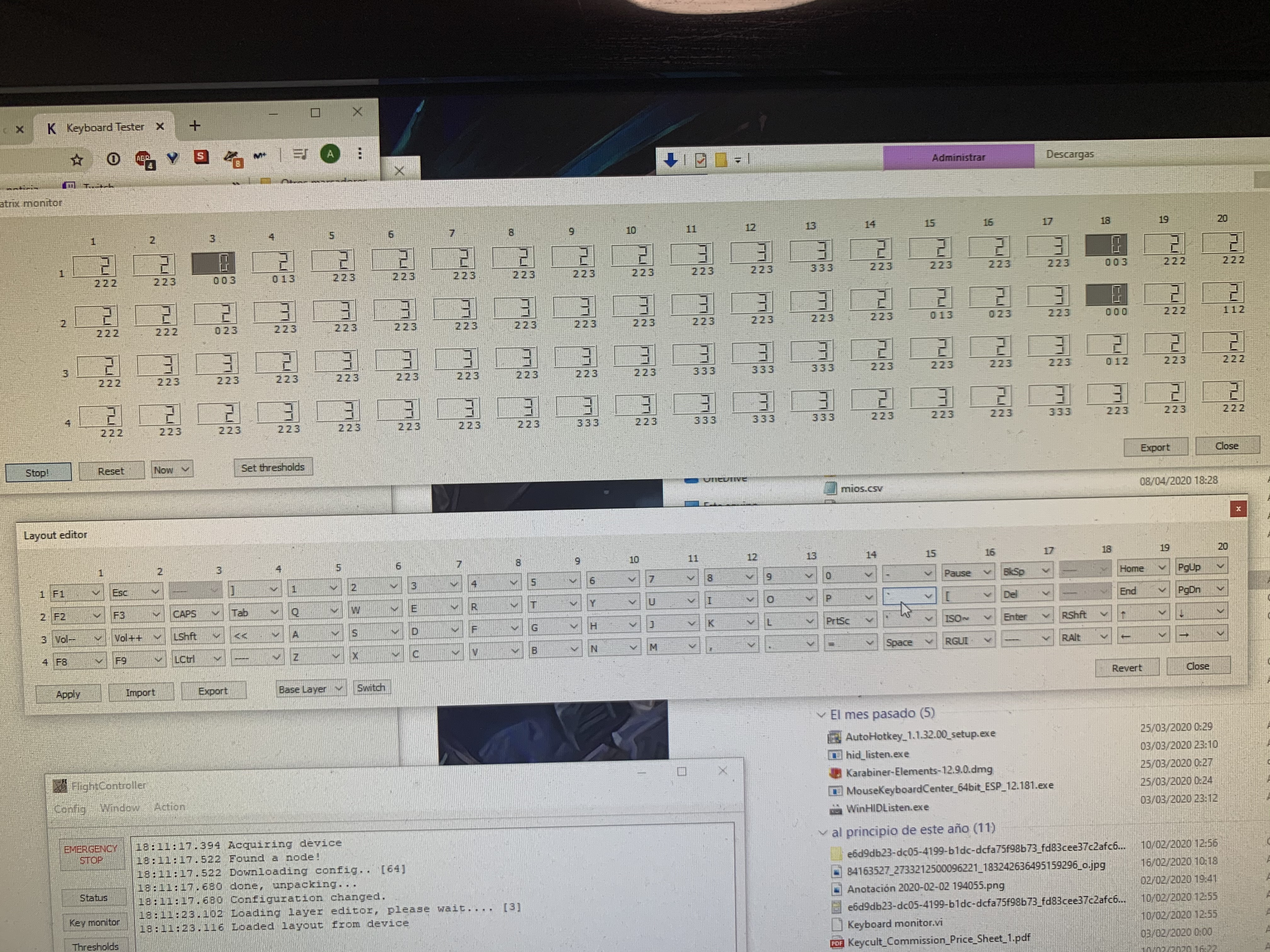

My 3276 data entry has a 20x4 matrix, I want to share the thresholds because i think they are really low numbers. All of them between 1 and 3.
Thanks to everyone involved in this project!!

Hardware -> ADC resolution, bit -> 12shine wrote: 09 Apr 2020, 20:11 I want to share the thresholds because i think they are really low numbers. All of them between 1 and 3.
That should pull you into 40-ish-at-rest territory, so you can set thresholds to like 15 and forget about key spam.
Wiring is fine but kek try to get xwhatsit working with that
