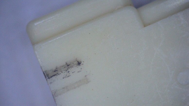

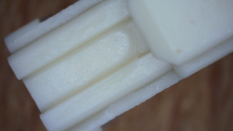

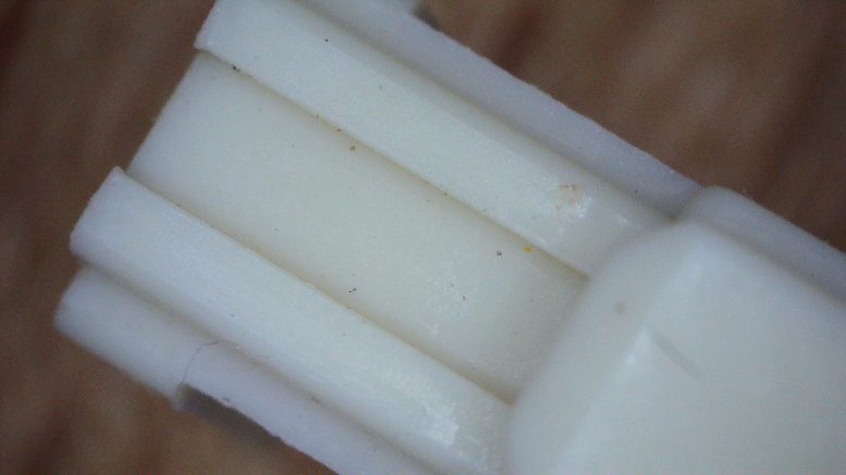

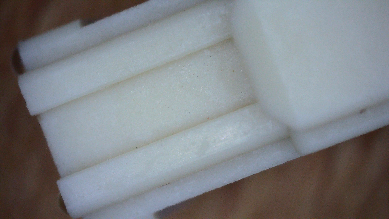

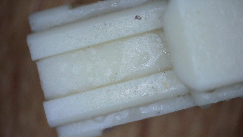

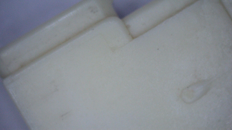

Some USB microscope pics.
These SKCM Cream were in fairly okay condition to start with, which was one of the things that interested me. Some observations:
- Of these, the one that felt best was the one that had only been boiled. I think if a switch isn't in garbage condition, it's worth doing boil only first and seeing what your results are like before moving on to waxboil.
- Interestingly, it looks like just boiling might also reflow the factory lubricant? You can see in the two additional pics that the strange streaking is gone, but the slider still shimmers under the light.
- Just boiling in wax is a clearly terribad idea. It looks awfully dirty, worse than untouched.
I'm getting a proper stand for this microscope soon so I'll be able to faff with the focal length and use the full 1000x magnification hopefully. I also need to locate my tronched SKCL green so I can get proper images of truly bad switches.

- unboiled factory lube.png (711.81 KiB) Viewed 8892 times
- boiled (possibly reflowed lube).png (694.32 KiB) Viewed 8892 times
- before any cleaning
- unclean.png (780.73 KiB) Viewed 8892 times
- boiled in wax only
- just waxboil.png (794.27 KiB) Viewed 8892 times
- boiled, then waxboiled
- boil waxboil.png (790.53 KiB) Viewed 8892 times
- boiled only
- boil only.png (772.69 KiB) Viewed 8892 times
