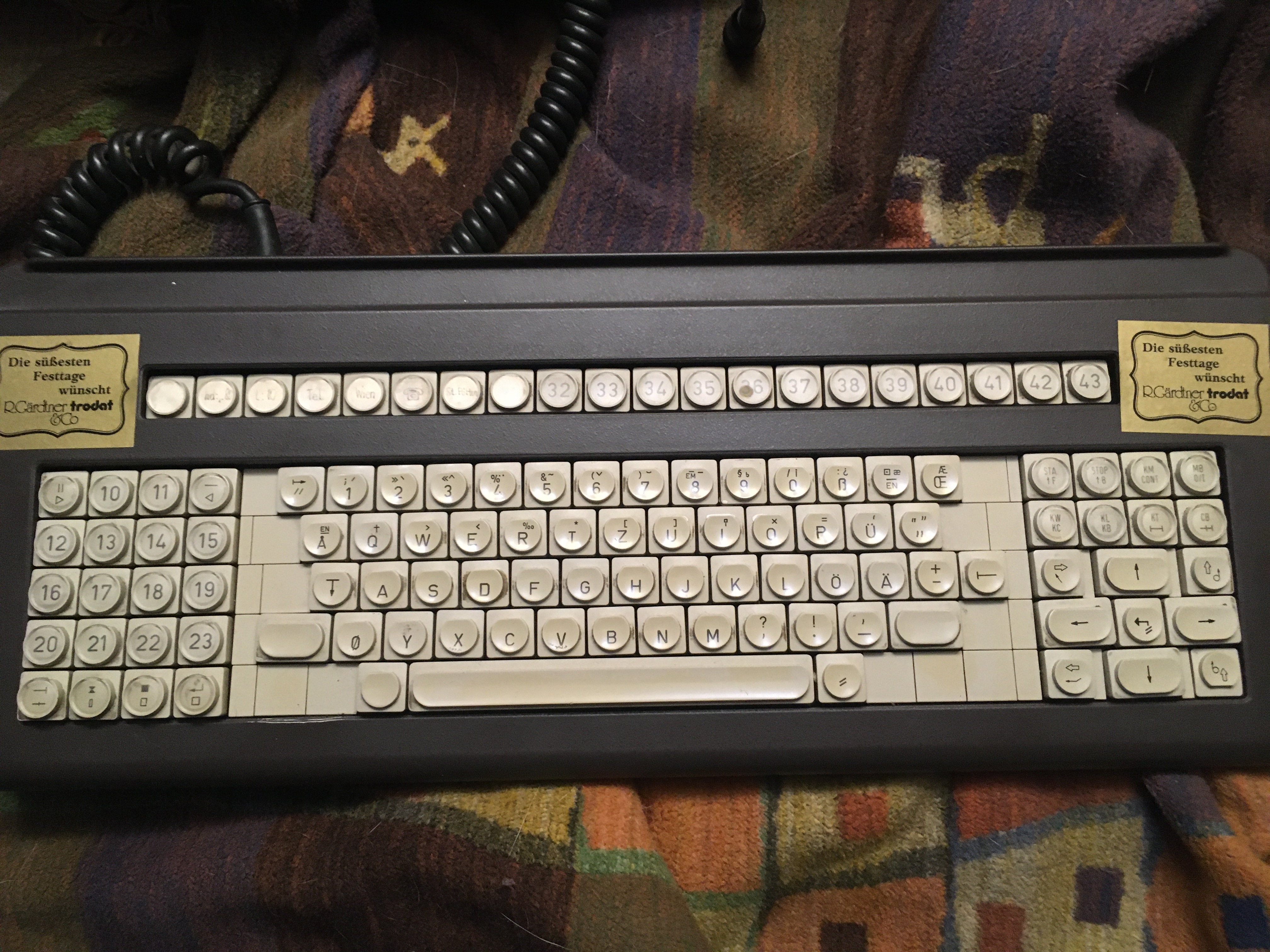

Posted: 20 Mar 2021, 20:04
by wanderhoden
hiho guys i found a beauty someone know somthing about it and if its possible to convert to ps/2 or usb
Re: IDENTIFY THE KEYBOARD thread
Posted: 20 Mar 2021, 20:14
by Tahoma
Grüẞ Gott! Greetings!
Very cool keyboard; would it be possible to show the connector type for it? Might help in figuring out if it is convertible to PS/2 or USB.

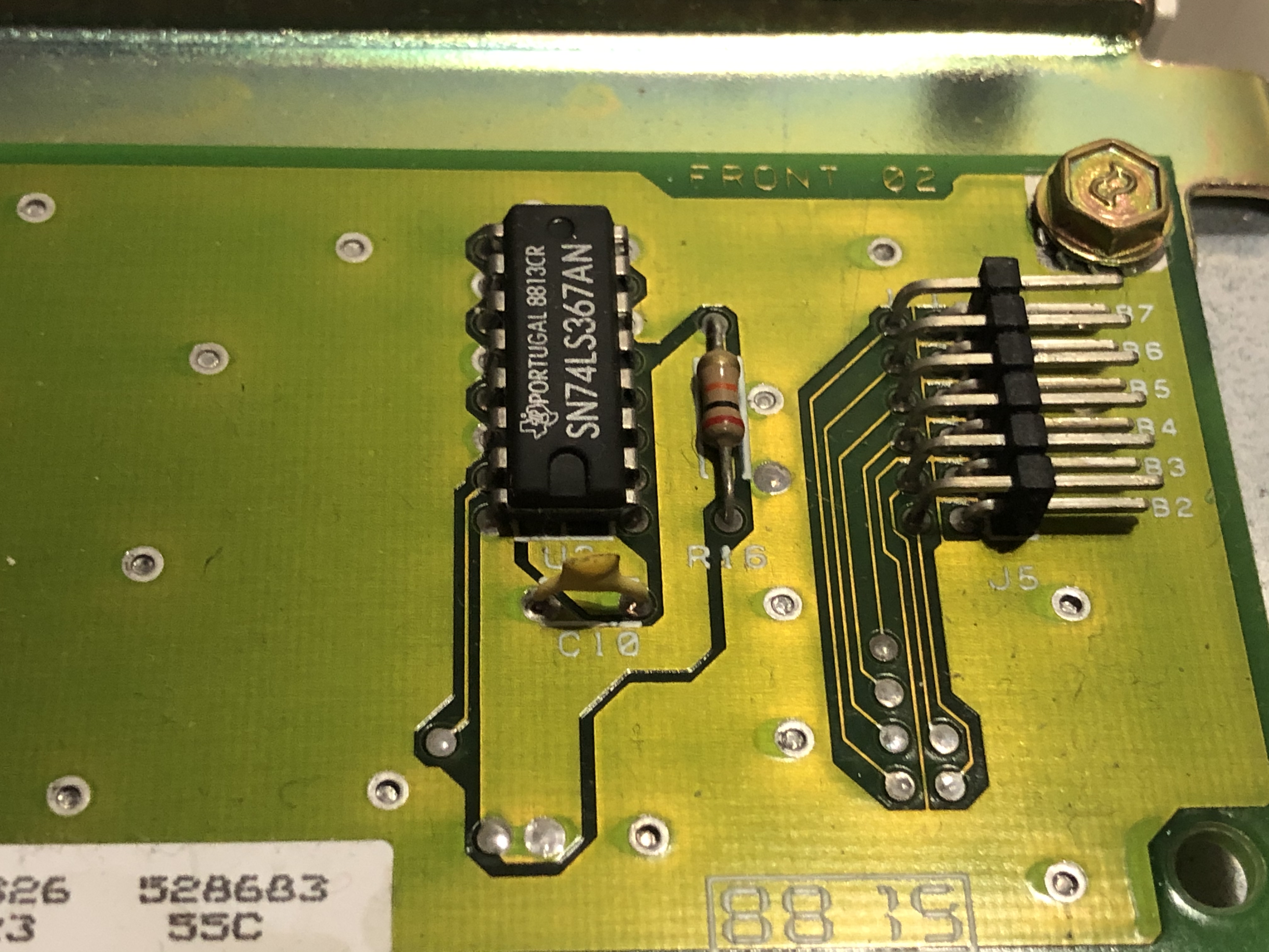

Posted: 20 Mar 2021, 20:16
by wanderhoden
look plz under spoiler the last pic :D
Posted: 20 Mar 2021, 20:35
by Tahoma
Oops, I'm a newbie here and missed the spoiler button. :+)
Thanks!!
Based on almost nothing, I think so. Pretty sure Amphenol makes a connector that will mate with that plug, and also the IC pictured is similar to one of the IC's on the Model M I am working on.

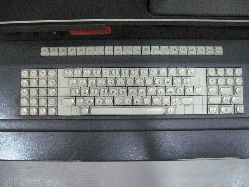

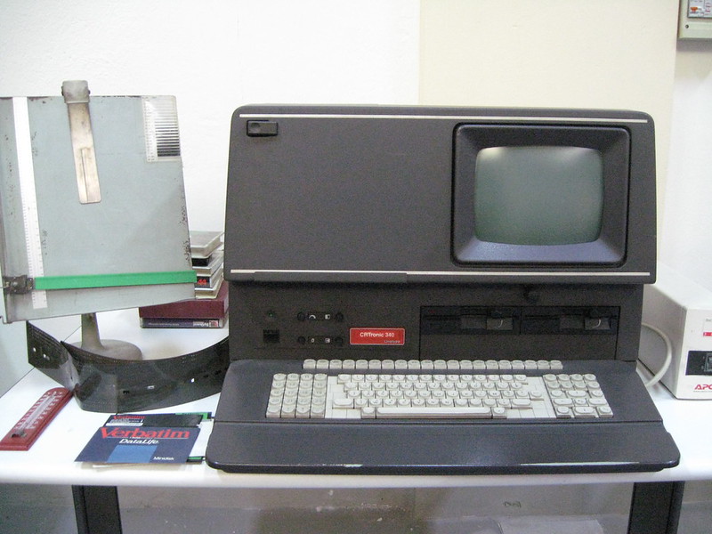

by wanderhoden
oh i found pics its a linotype crtronic 340
now i just ned the manual not that easy to find :(
