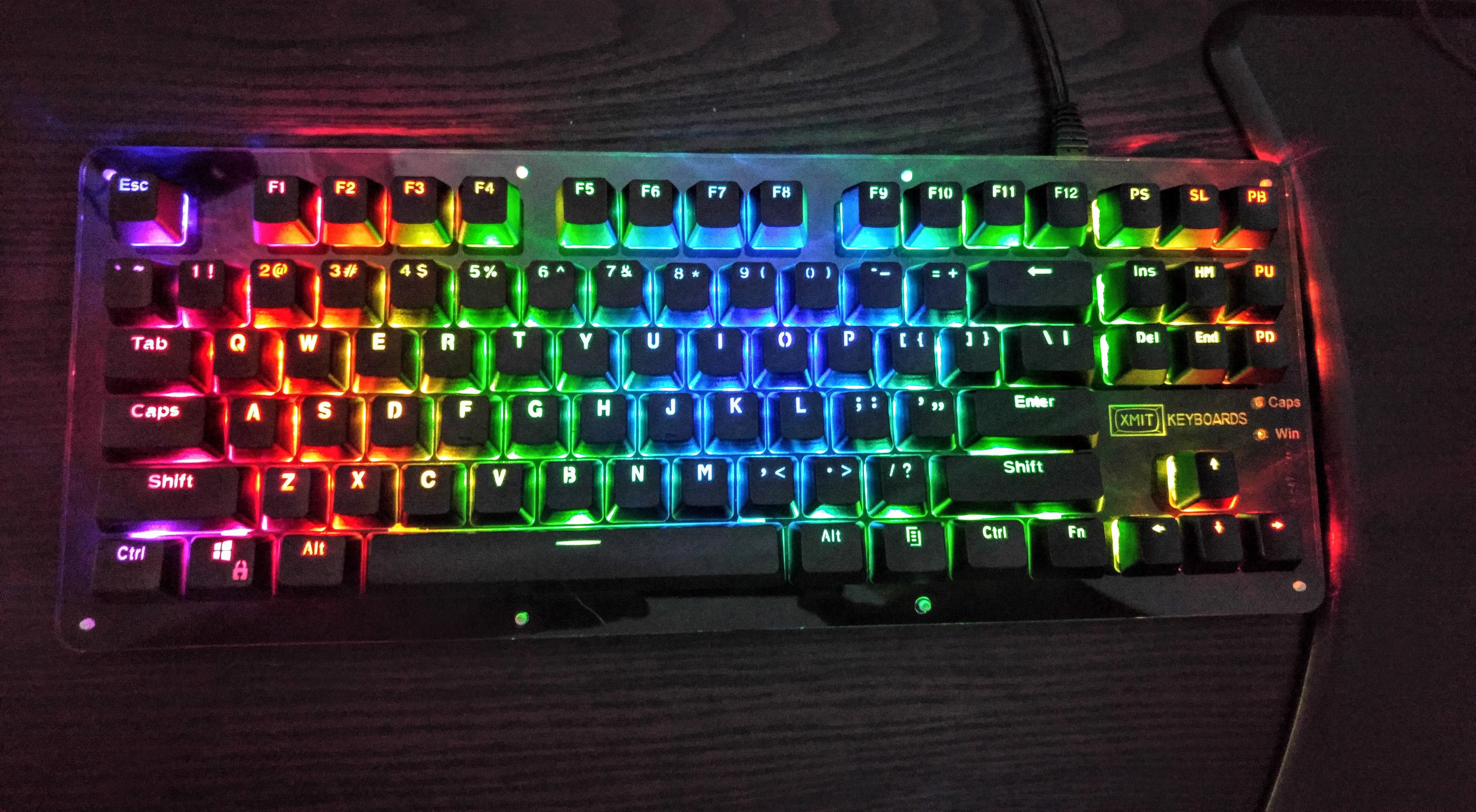

In case you're curious, here is what a clear/acrylic 87-key board looks like with Round 6. Works great!
Man that acrylic version looks good! Sorry to hear about the issues with the stems. Although I am very glad you decided to address it before letting them leave the factory. It may delay the boards getting in our hands but I'm perfectly content with waiting longer for higher QC. I hope things go more smoothly for you with these boards once that kink is worked out XMIT! ;)
