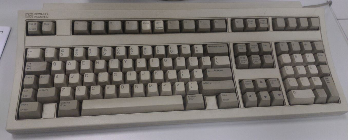

by mars
Guys I found this HP keyboard attached to an old terminal in a datacenter.
It felt really great, maybe even more so than my hhkb, I don't know if it has some kind of tactile switches or rubberdome.
There was no hint on the back.
Can anyone identify it?
Thanks
Posted: 25 Feb 2016, 11:11

Posted: 25 Feb 2016, 14:08
by Chyros
Key Tronic rubber; rattley and rubbery...
Posted: 25 Feb 2016, 15:06
by mars
I couldn't pull a cap as I was by a client and in a hurry.
An helpful anon on the most famous imageboard in the west found it though:
HP C3340-60201
