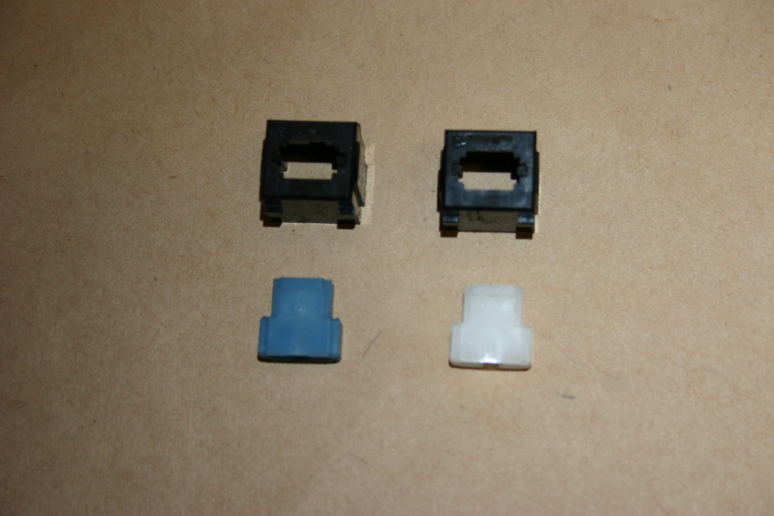

Here are the two sliders, from gold label Northgates dated three weeks apart.

The newer material is easy to distinguish. It is more specular, more smooth and more slippery.
From the photo I can see 2-3 differences (apart from the color obviously): 1) the little round bit on the center of the blue stem is missing from the white. 2) the light reflected out of the white stem is more specular (more intense). 3) I can barely see the characteristic two band stripes that are vertically on the white surface. Which are missing in the blue one.
If you run your fingernail on the surface of both, can you feel a difference? I bet the white one will feel much smoother.
However for the differences to shows clearly, the surfaces should be cleaned well. (Using a cloth + window cleaner or something)

Well my point was that these two keyboards, in clean original condition, the same make and model, and dated three weeks apart, one with white SKCM and one with blue, are indistinguishable in sound and feel to me. I've owned them for thirty years, so I know nobody has ever cleaned or lubed them or swapped parts. This compared to my many later white SKCM keyboards, which are quite different in sound and feel (even the Northgate ones). So...if you can tell the slider material is different from one blurry photo (my fault) then why are these white SKCM switches (very early, unbranded upper housings) the same in feel and sound as late blues, but different than all my later whites?
Here's an older post with more details on the two Northgates:

Tbh dirt is the least of the issues. The whole point is it to make the plastic stem surfaces as smooth and polished as possible. I use a dremel with felt tip to polish them one by one. Also the metal leafs need to be polished as well. And all of that before adding any kind of lube.
I think the boiling is for using heat to polish them instead. Right?
mode1ace
25 Aug 2021, 08:22
NeK wrote: 25 Aug 2021, 08:18 Tbh dirt is the least of the issues. The whole point is it to make the plastic stem surfaces as smooth and polished as possible. I use a dremel with felt tip to polish them one by one. Also the metal leafs need to be polished as well. And all of that before adding any kind of lube.
I'm very skeptical of this, it's not about literally being as smooth as possible, completely flat surfaces can be highly frictional. It's about reducing friction. NOS alps sliders have a leathered appearance, but the switch housing itself is smooth, one slide leathered and the other smooth has less contact area, and no meshing of rough surfaces.
My worst condition blue sliders have seen so much use they have worn smooth, unlubircated this binds horribly.
Just boil and wax your switches, it works amazingly. This problem has now been solved and everyone just has to try this method.
Jan Pospisil
25 Aug 2021, 09:27
So what does the boiling part do supposedly?
soyuz
25 Aug 2021, 10:02
Jan Pospisil wrote: 25 Aug 2021, 09:27 So what does the boiling part do supposedly?
cleans utterly and completely. there's a microscope image of a boiled vs ultrasonic slider floating around somewhere
mode1ace
25 Aug 2021, 10:03
It's a very effective cleaning method, it's also good for evenly coating things in paraffin wax. Dip anything in boiling water with a bit of wax in it, dry that thing off and you'll see it's got a thin coating of wax.
soyuz
25 Aug 2021, 10:11
nope. boiling scalds the dirt off, the temparatures involved are nowhere near the plastic's melt or mould points. simply put, the community has been too gentle with switches for years out of fear, which has left people trying to lube dirty switches and shocked pikachu facing when it doesn't work perfectly. for example, i legit find it ironic that you're worried about deforming switches by boiling them when you are taking a dremel to yours.
the wax is plenty to smooth over any remaining issues, and for once, actually prevents the awful scratchy sound, even in linears. we're now at the stage where I personally consider this problem to be solved.
