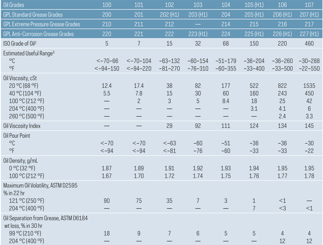

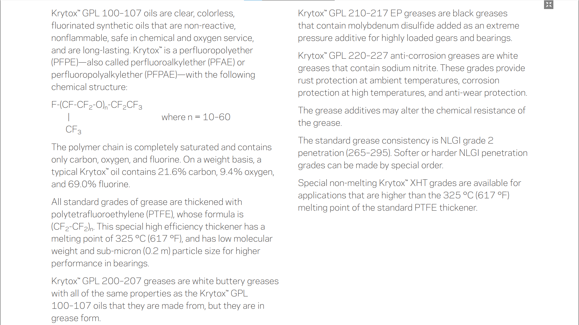

Krytox 206 and 207 look like interesting candidates, PFPE (100% plastic safe) thickened with PTFE
Captura de pantalla 2021-05-26 202911.png (393.2 KiB) Viewed 9294 times
Captura de pantalla 2021-05-26 203029.png (226.45 KiB) Viewed 9294 times

Krytox is very popular in the community at large, so I would bet 206/207 has been already tried. However it doesn't hurt to do noe if someone has any and let us know. I only have the Krytox 104, which is very thin.
However, I have came to understand that the thickener plays a big role, after the failure with OKS 1110 which despite being overwhelmingly viscous, at 9500 cSt @40C (which means at 25C should measure much higher than > 20000 cSt). I wouldn't get my hopes up for Krytox.
Having tried at least 20 - widely - different lubes up untill now, still, the *only* lubes that at least worked by eliminating the binding and stick-slip is 1) the NyoGel 767A and 2) plain candle wax (!!!). The NG 767A is a behemoth titan of viscosity and tackiness, same as the... candle wax, must mean something. To me that is evidence, that a very strong film is required that sticks strongly to the surfaces, stays in place and is not penetrated by the surfaces which get pushed by the high forces of angled sliding.
The data that ThreeBond gave us for the TB2581P, states a viscosity of only ~656 cSt @40C, which has thrown me completely off. How come a lube that is that lowly viscous, can cut it with SKCM where nothing short of the strongest lubes can? On top of that, having tried the SKF lube yesterday, that is of a very similar composition (same Lithium Soap thickener and "same" heavy Mineral Oil, with Extreme Pressure additives thrown if for good measure), with the viscosity of 560 cSt @40c, which is close enough and failing miserably, has totally confused me.
The fact that TB2581P was custom made for ALPS and was never available to buy, is very weird and suspicious. And it really does not help clear the confusion. I now start to doubt how accurate the data is that ThreeBond gave us about it.
The whole thing has turned upside down. I now consider that only certain types of thickener can work and that the base oil must have some other important property, besides the plain "viscosity" measurement, that gives TB2581P the film strength necessary to sustain the brutal forces that SKCM switches are subjected to.
It must have something to do with the actual molecular structure of the oil and how strong it is. The various hints point out that they must be (very) heavy in terms of number of carbon atoms per molecule. This is because Paraffin Oil is just that, heavy hydrocarbons with more than 20 carbon atoms per molecule. And I have a feeling that the "Paraffin based mineral oil" used in TB2581P has much more heavier ones than that. Almost to the point as to be similar to candle wax (perhaps Paraffin Wax? I don't know, the terms used on the internet at large are interchangable and make little sense). NG 767A, also must be made of very heavy hydrocarbons too, which is another strong hint.
I don't know, the internet is full of misinformation and it is very difficult to gain a better understanding.

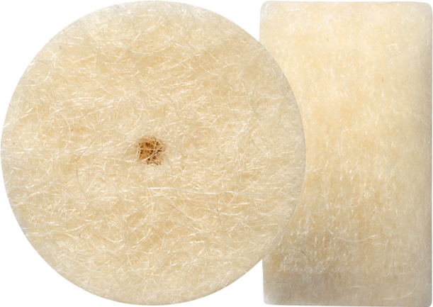

It's simple: I use a Dremel with a cotton felt tip. It does wonders. But it is time consuming to say the least hehe... But I actually really enjoy it.

No compound! Not at all because the plastics are very delicate. And I am talking about only 1st gen pine versions. The next generation stem plastic, is much more delicate and it will actually melt from the friction pretty easily, but those are already smoother and much easier to polish. Just use very low RPMs and ofcourse no pressure! However, the 1st gen are like stones.
Of course we are talking about very small cotton felt tips and low rotary speeds e.g. 10krpm

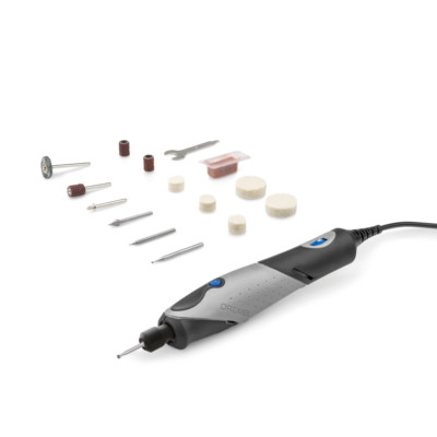

NeK wrote: 14 Jul 2021, 09:07 No compound! Not at all because the plastics are very delicate. And I am talking about only 1st gen pine versions. The next generation stem plastic, is much more delicate and it will actually melt from the friction pretty easily, but those are already smoother and much easier to polish. Just use very low RPMs and ofcourse no pressure! However, the 1st gen are like stones.
So here is what I use:
Dremel 2050-15 Stylo+
https://us.dremel.com/en_US/products/-/ ... craft-tool
Dremel 414 Felt Polishing Wheel
https://us.dremel.com/en_US/products/-/ ... hing-wheel
Dremel Stylo is the best (quality wise) but I'm pretty sure *any* rotary tool can do the job. The hard thing to find is the felt tips that must be the ones that I list. Probably there are other brands too but I haven't tried them, they must be good quality cotton felt, so I only recommend what I know that works. ;)
