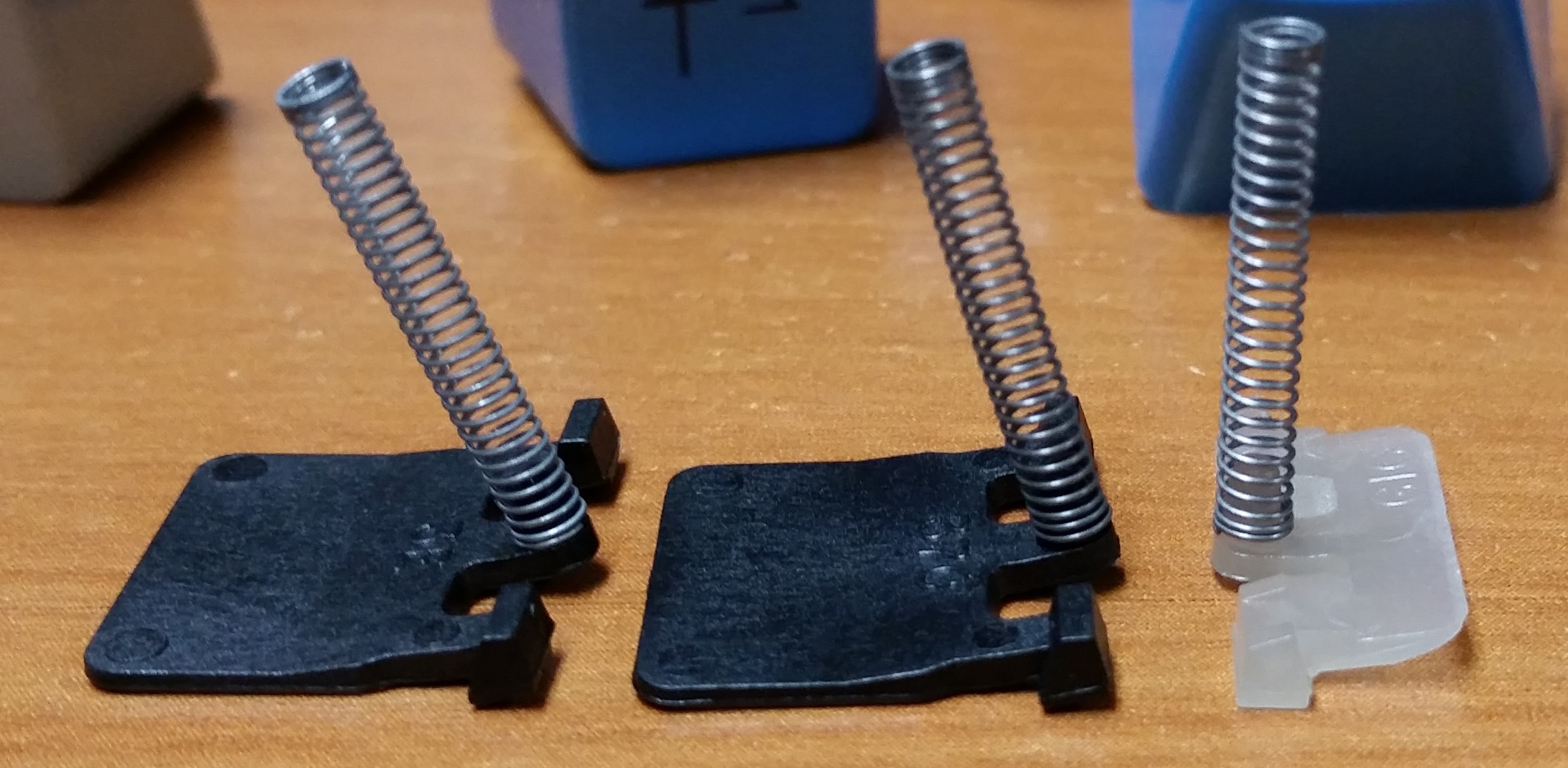

Tomorrow I hope to pay for the barrel and flipper molds and enough samples for an entire F77 and F62. I decided against CNC milled plastic samples (way too expensive due to the intricate detail in each barrel), and I decided against 3D printing due to the tolerances not being good enough for this project.
The spring factory has a spring force testing machine and they will be testing each of the thousands of springs to make sure they are within the original 1980s spring force spec tolerance range. The spring tolerances I'm aiming for are two times tighter than the currently produced Model M springs, meaning the buckling springs will hopefully be slightly more even than from a new production Model M that you could buy today. Attached is a photo of original Model F and M springs and flippers (pivot plates) for reference, with some blue Industrial SSK keys in the background :)

Ellipse wrote: Tomorrow I hope to pay for the barrel and flipper molds and enough samples for an entire F77 and F62. I decided against CNC milled plastic samples (way too expensive due to the intricate detail in each barrel), and I decided against 3D printing due to the tolerances not being good enough for this project.
I am curious, which material are you aiming for the 3D printing ? It shall be able to change the capacitance of in the PCB.
Have you checked that this material will be within the limits of allowed by the xwhatsit controller ?
These flippers may be useful for other purposes, but if the capacitance change is not similar to the original Fs:
1.- individual replacement will not be possible in regular Fs with adapter (F122 + Soarer for instance). Any difference in the closed capacitance value, due to a deviation from the nominal-built value or error, will lead to a non-working key press.
2.- individual replacement will not be possible with xwhatsit. One will need to replace all of them provided that the xwhatsit can sense the new flippers. I am assuming that this will be the case as if not, this project will not work. Note that this option is also function of the new PCB to be created.
Am I wrong ?

But I am going even further, I am not just asking about the quality of the 3D print. It may be sufficient for prototyping as you said. My point is that the material should be analysed. It shall be able to change the capacitance. Pure plastic does not. so I wonder what he is thinking to do about it. The solution shall combine physical and electromagnetic properties.
Ellipse
31 Aug 2015, 17:25
No 3D printing will be used, not even for the prototypes. I will be using a specialized resin for injection molding that contains a good amount of carbon so that it is capacitive. I will use another material for the production run if the prototype resin is not satisfactory. The prototypes will be made with the full production molds I ordered. The prototypes should be done in 5-6 weeks.

Idollar has a good point though... Will you be testing one of new pivot plates in an old school Model F to ensure they are interchangeable and work together? That would be really useful for spare parts.
Ellipse
31 Aug 2015, 18:20
Yes they will be tested in an original and new model f.
