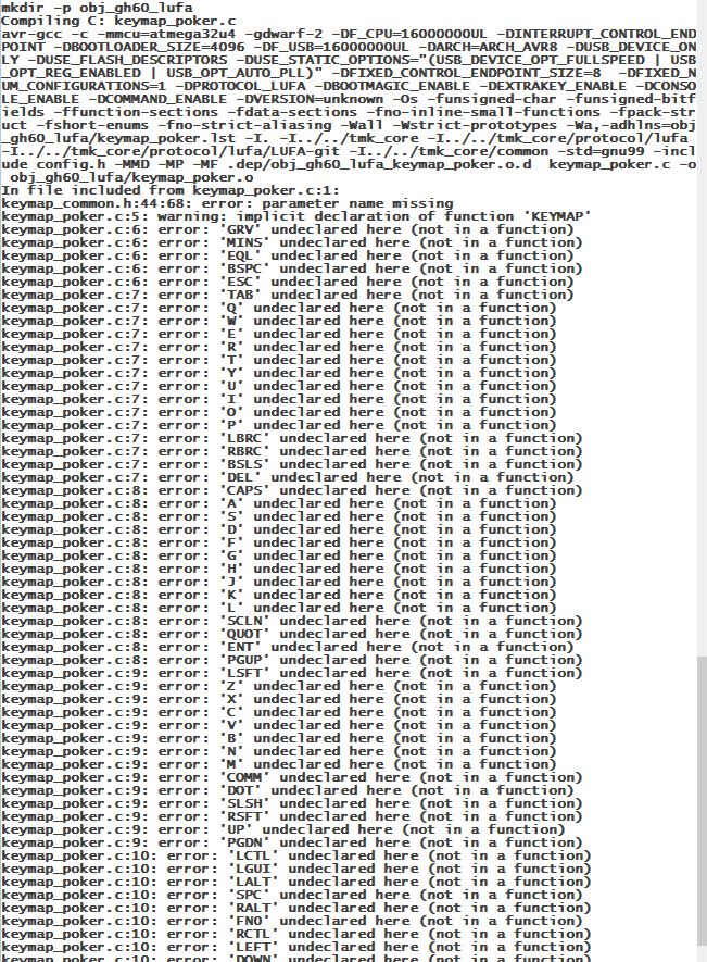

Hey guys,
I'm trying to make a small keyboard but I'm stuck at making the firmware. For some reason I get this error when I run make -f makefile
Error Makefile.JPG (256.52 KiB) Viewed 8818 times
I've duble-triple checked all the code in the H60 folder but I don't seem to see any problem with it (considering that I mostly copy/paste-ed everyting....the tutorial was almost exactly with what I had in mind 15 columns and 5 rows.
gh60.zip
(17.8 KiB) Downloaded 219 times
I've attached the files if someone is nice enough to look at them and/or just compile them. Also I have Windows 10 installed so I'm not sure if that's the problem considering that make.exe had it's last update some 5 years ago.
gogusrl
08 Nov 2015, 00:54
Hehe, a fellow romanian. I got stuck there as well earlier today and decided to try my luck with Soarer's (and failed there as well).
joc
08 Nov 2015, 01:37
[email protected] wrote: Hey guys,
keymap_common.h:44:68: error: parameter name missing
This line says the error is on line 44, column 68 in keymap_common.h. You either have a missing parameter or extra comma. Assuming it's an extra comma, removing the comma and recompiling gives this error:
keymap_common.h:45:75: error: macro parameters must be comma-separated
Going to line 45, column 75 in keymap_common.h you'll notice that there's a missing comma between the K4D and K4E parameters. Adding the comma and recompiling gives this error:
keymap_poker.c:25:1: error: expected '}' before 'RNS'
Going to line 25 in keymap_poker.c you'll notice that there's a space between the 'T' and 'RNS'. Removing the space allows the code to compile successfully.

obj_gh60_lufa/common/keyboard.o: In function `keyboard_set_leds':
C:\Users\Administrator\Downloads\tmk_keyboard-master\tmk_keyboard-master\keyboard\gh60/../../tmk_core/common/keyboard.c:176: undefined reference to `led_set'
obj_gh60_lufa/common/keymap.o: In function `action_for_key':
C:\Users\Administrator\Downloads\tmk_keyboard-master\tmk_keyboard-master\keyboard\gh60/../../tmk_core/common/keymap.c:36: undefined reference to `keymap_fn_to_action'
make: *** [gh60_lufa.elf] Error 1
The above is what cmd spits out after trying to compile. I do not wish to include any LEDs or a FN layer. What items need to be edited to reflect a keyboard that does not have a FN layer or LED array?
I am no coder by any amount, but I assume that there are empty variables that are causing this error because I have not defined the led_set or a fn key or layer.
Thanks
Halvar
15 Dec 2015, 11:25
Hi, welcome to DT!
Did you delete or edit the file led.c? Or the file keymap_common.c? Because these are the files where the function belong that cannot be found.
If you don`t want to use LEDs, you can empty the function led_set(), but you should not delete it.
void led_set(uint8_t usb_led)
I would leave keymap_fn_to_action() untouched.
/* translates Fn keycode to action */
action_t keymap_fn_to_action(uint8_t keycode)
    return (action_t){ .code = pgm_read_word(&fn_actions[FN_INDEX(keycode)]) };
rockosmodlife
16 Dec 2015, 02:12
Halvar wrote: Hi, welcome to DT!
Thanks!
Now I get the following:
keymap_common.c: In function 'keymap_fn_to_action':
keymap_common.c:29: error: 'fn_actions' undeclared (first use in this function)
keymap_common.c:29: error: (Each undeclared identifier is reported only once
keymap_common.c:29: error: for each function it appears in.)
make: *** [obj_gh60_lufa/keymap_common.o] Error 1
