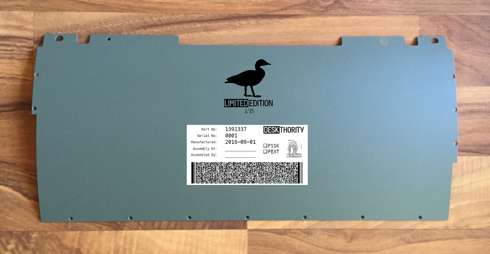

So the idea is to only have the WCass sticker on the red top plate/black backplate... as a tribute. All the other configurations would only have the sticker from Techno Trousers (which would be included on all). The only other variation will be a limited run (say 10-15 total) of all stainless steel boards. The stainless steel variety would be the only ones with the duck. This is not to make any of them cost more. Just a way to spice up a couple of editions to keep things interesting.
Again, the standard board regardless of color configuration will be just as you mentioned (assembly plate sticker only). This Limited Edition Stainless (with duck etching) and WCass Tribute (red/black with Living Fossil sticker) is just something to make it more interesting of a process (at least for me)
EDIT: Apologize for the confusion. There are several posts you would have to digest to get the full picture. At the time we actually run a group buy, I would make this "edition" fluff very obvious

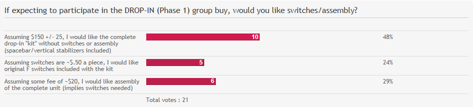

Thanks again for participating in the Switches/Assembly survey. We are at a 20% margin of error at 95% confidence, but the numbers remained consistent as votes came in. So half of the orders would need switches (barrels/flippers), and of that half, half again (25% of total) would like assembly. ONE MORE POLL for the foreseeable future... PROMISE. I need to be able to communicate to the manufacturer the percentages of FSSK vs FEXT form factors. I need to know the RATIO between the two for a variety of reasons. We will still need to prove the FEXT metal sample I have here, but for now, assume it works well (will be well tested before any GB would think of beginning).
For pricing, assume $150 +/- 25 for the base kit (same as the FSSK). The more numbers I have received back, the more I am feeling like we are under (not over) $150. Again... appreciate the help. This understanding is needed before I have the confidence to proceed.
- Ratio of orders needing switches
- Capture.PNG (19.24 KiB) Viewed 7692 times

Was bored on the plane last night and threw this together. Just an optional sticker that wouldn't be tied to anything particular, but something you could grab to dress things up a bit if wanted. It's a tribute sticker to Soarer, xWhatsit (Tom Wong-Cornall), Hasu, WCass, and I$ as projects/activities that have had significant impact on this project ever taking place. Still needs polishing (font changes, etc), but the general idea. if I'm missing someone let me know
EDIT: Also went back and cleaned up the XTant Tribute Badge to avoid confusion. The update was added to the previous post with the original to show the difference
- Location: UK
- DT Pro Member: 0167
I like it , but it would be cool if it has more of a pixilated dot matrix look.
EDIT
Very quick and dirty filter but to get an idea
EDIT
- lot_lizard
- Location: Minnesota
- Main keyboard: Indy SSK Model MF
- Main mouse: Logitech Anywhere MX
- Favorite switch: Beamspring
That's an interesting idea. I'll try that this evening. Maybe add a faint circuit board pattern to the whitespace on the left as well? Something to make it yell a little less would be nice and give better depth
EDIT: Haven't played with the dot matrix pattern on the images yet, but over lunch added the circuit board to the white background, and your dot matrix idea gave me a better direction for the junk font before. Getting more retro
EDIT the EDIT: Changed the font again to something more "comforting" > happy.me
It seems fitting here...
