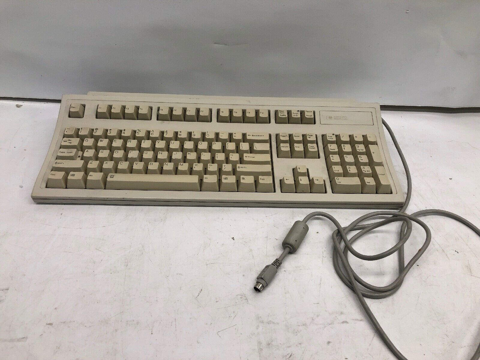

Thanks for all the info it was very helpful. The switches I found on these known auction sites are expensive! 5$ for a switch? Gosh! I think I will have a much better change in buying an old terminal keyboard and convert it for ps2, although it won't have all the standard keys.
I've also found 2 HP keyboards I remember we had in the university back then. I was really thrilled by the feeling of the keys and I think these were membrane as these were not clicky at all. But the feeling was great. A smooth force all the way to the bottom and no click (linear?). A fat plastic sound but not very loud.
I attach you the image
