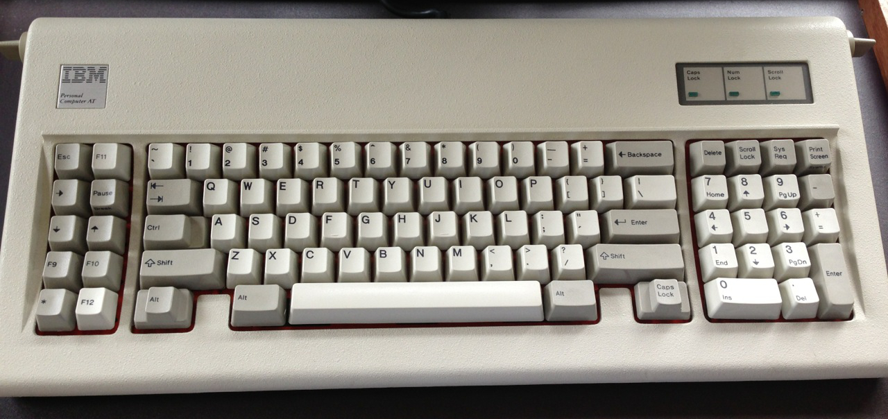

Thus far, on my XT, I've done a partial Unicomp treatment, trying to keep the Unicomp caps symmetrically arranged on the board.
I would really like to get an Xtant kit, because I would prefer to modify an XT to my liking rather than an AT. I like the XT case much better than the AT case, and some aspects of the XT layout lend themselves to greater flexibility than found on the AT.
