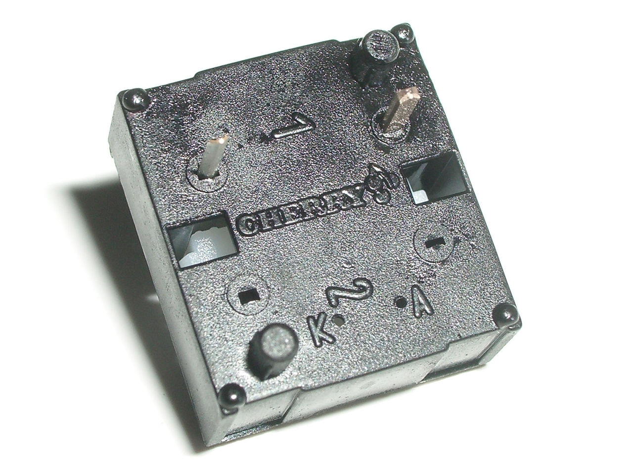

It will be interesting to see how well the dual contacts do in improving switch reliability. It's certainly not something that I expected to see; I wasn't aware that any DPST switches were still sold, so it may be that Omron are selling the only ones on the market. Cherry MX in particular was not designed to support DPST, being presumably the point where Cherry wrote off DPST.
rindorbrot
05 Nov 2014, 08:41
What's DPST?
002
Topre Enthusiast
05 Nov 2014, 08:58
It stands for Double Pole, Single Throw. I am not sure what benefits that this design will bring to the keyboard...maybe something to do with the light pipe?
05 Nov 2014, 09:50
rindorbrot wrote: What's DPST?
Proper DPST switches have two sets of switch contacts sharing one plunger, i.e. when you press the switch you connect two circuits at once. You can use this for redundancy, i.e. at least one pair of contacts is likely to connect even if the other has broken or become dirty.
In the case of the Romer-G, it's not actually DPST as it's only got one set of legs and the contacts are connected (actual DPST switches are two independent switches operated concurrently). Cherry switches prior to MX did all support two independent sets of contacts, though; you can see the holes for the second set of legs on this M8 switch:
Cherry M8 base.jpg (223.52 KiB) Viewed 9444 times
The two pairs of contacts and legs are numbered 1 and 2. There's also a pair of holes for a diode or jumper to be fitted instead.
DPST is covered in Cherry patents and catalogues but not seen in keyboards. I think Micro Switch Hall Effect keyboards are the only ones I've seen with actual redundancy in the switches.
