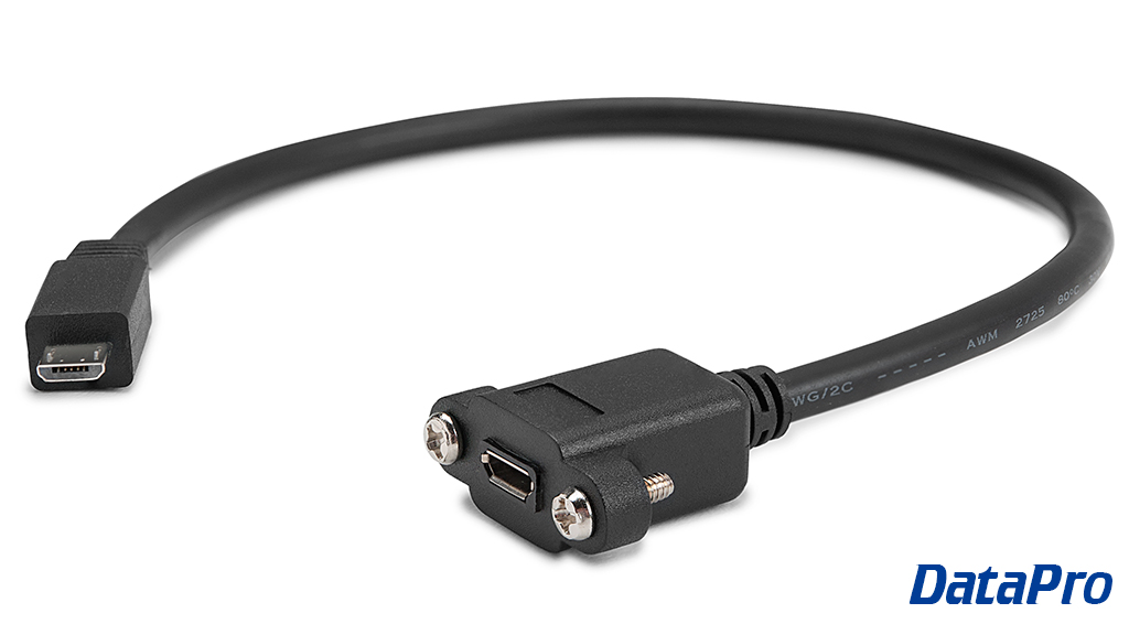

I finally found a panel-mount micro USB cable, except that it has a micro USB plug on the other end of the cable:
http://www.datapro.net/products/usb-mic ... e-m-f.html
However, this could be used directly with a Teensy 3.0, which has a micro USB on board.

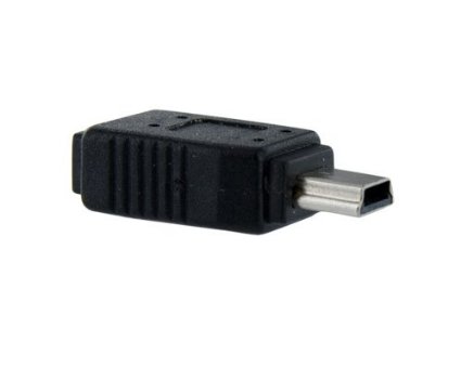

With a Teensy 2.0, there are cable or block micro USB to mni USB adapters, such as this one:
http://www.amazon.com/StarTech-com-Micr ... KGWF7PP70R

rjrich wrote:I finally found a panel-mount micro USB cable, except that it has a micro USB plug on the other end of the cable:
Hey, great find! Now we just need to arrange a group buy to get the price down or find DataPro's Chinese source. I'm never happy unless it's less than a buck. ;)

Thanks. Took some digging. DataPro will make custom cables. I have a request pending with them. I will let everyone know their price; I am sure it will be more than $1.00.
Edit: I heard back from DataPro. The "custom" cable would simply be spliced and shrink-tubed. They can put the splice anywhere along the length of the cable that the customer specifies. The cost would be $21 per cable for 1 to 10 cables. This is clearly a lot more than $1.00, and I suppose any of us could splice and shrink-tube a cable. I think I might try their panel-mount micro USB cable and use a short micro to mini adapter on the plug end. Alternatively, I could use a panel-mount USB-B to mini USB cable from Adafruit or PJRC.

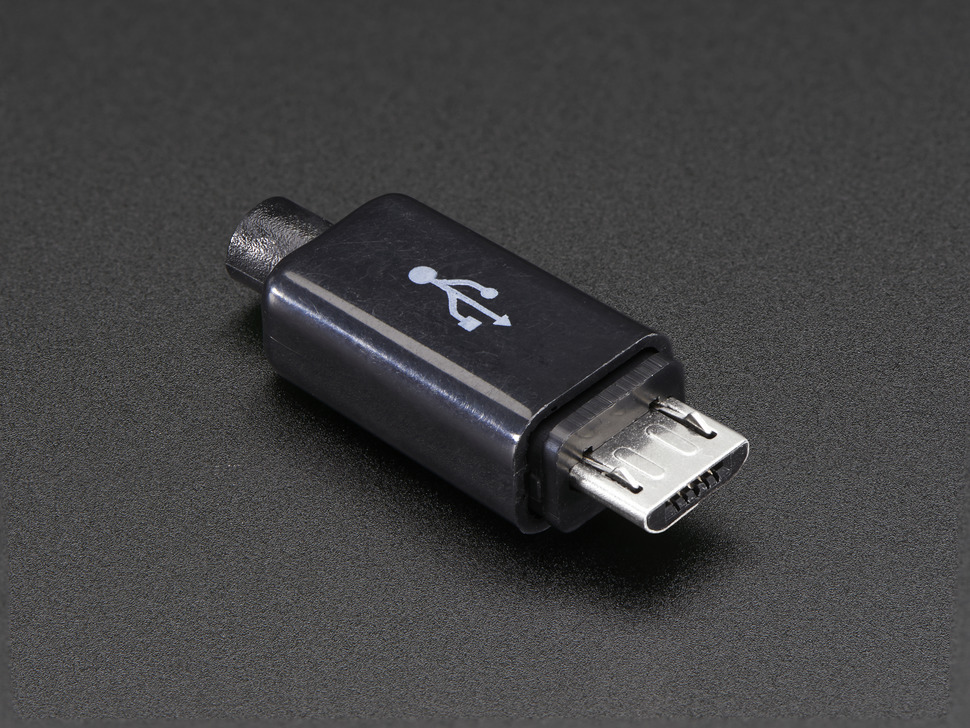

Adafruit sells DIY USB connector shells of various kinds, including this MicroB plug:
https://www.adafruit.com/products/1826
And it's less than a buck, thereby satisfying quantalume's criterion!

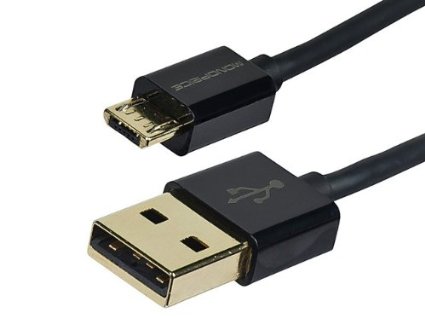

I found a slim micro USB to USB cable in my collection, but I don't know where I got it. I've seen flat USB cables, but the connectors are still large.
The Monoprice premium cable looks like it has substantially reduced the size of the USB 2 connector, but the micro USB connector still looks like it has a larger diameter than necessary; if so, presumably it could be trimmed with a razor knife. Connector dimensions: 0.74" x 0.36" x 0.25" on the micro USB end and 0.97" x 0.54" x 0.25" on the USB A end.
http://www.monoprice.com/Product?c_id=1 ... 1&format=2

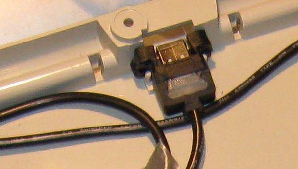

Well, as we were saying, the best way seems to be something like this:
Halvar
31 May 2014, 18:54
That's also pretty much what I ended up doing.
IMG_3737 (Small).JPG (30.02 KiB) Viewed 6478 times
Hypersphere
31 May 2014, 19:04
Halvar wrote:That's also pretty much what I ended up doing.
Looks like the connector I am thinking of using. I have several different types on order to see which will work best. I will be installing in AT, XT, and F-122; might end up using somewhat different connectors in each. It appears that you did not use the mounting screws, as the connector fits snugly between the pins and wall of the keyboard case.
Halvar
31 May 2014, 19:39
I had to whittle around on the connector a bit, especially on the upper side where you see the grey innards of the connector because it was a bit too high, but now it fits without screws or any other fixing.
