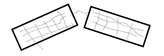

I plan on using two of them to make one complete keyboard, as depicted by the attached picture, so I think I'm going to have to come up with a way to make the connection external, perhaps jack the existing PS/2 connectors??

intealls, I'm planning the same, and I was going to connect them with the "tipro-cable" -> ps2 approach. Can't program the second module on the fly, but they'd be maneuverable.
Posted: 17 Aug 2011, 21:21
by intealls
Cool, it's a great idea :)
I *think* the problem with that setup would be that the modules are not able to share the same layer configuration, so if you shift to layer 2 on device one, device two will not shift to that layer. I need them to share the layer config :/

So obviously the idea of a split keyboard requires both modules to be connected via Tipro bus, which in its actual form (very short cable connects units joined together side by side) is... incompatible with a split keyboard. It would be necessary to "externalise" the Tipro bus so that keyboards can be connected via an external cable.
In my opininon the best solution would be to install a socket on the small removable cover at the rear of the keyboard (which obviously is prepared for adding such a socket, PS/2 size) and connect it to the Tipro bus. The Tipro connector itself could be used for units up to 8x8, bigger units would require a somewhat longer internal cable. This solution would have the advantage of leaving the keyboard itself completely unaffected otherwise and of allowing swapping between any Tipro keyboards.
If anyone has the necessary skills, I'd be interested in six units, please :mrgreen:
