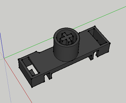

Ledies and Gents... The first Cherry MX Realforce :)

I would need a really huge GB to go into mass production. Anyway there's a small local company that casts fishing hooks, they can CNC the mold and do the casting... Last time I asked the price wasn't that bad.

the stem is not 100% clear. I believe that is due to the 3d printing process/material. I'd have to replace a cluster of sliders to say if the feel is really different. If me mass produce in ABS I'd say that the feel will be the same. The prototyping material is a bit stiffer and brittler than ABS, but I doubt you can feel the difference.

i can't say from a single key. The material is definitely different from ABS but I don't think the difference is perceivable

"frosted ultra detail" material is not. I believe it's some kind of resin or wax

These are printed from a resin cured by light, so I the polymer is very different.

there seems to be quite a lot of interest in such a thing, I've been contacted by a couple of vendors too.
let's see which is the best way to proceed into production.
I believe the mold would cost around €1000, but once we have it the cost per slider is really really low.

matt3o would also have to make space bar stabilizer sliders with cross-mount.

because otherwise we have to also make the mold for the case of the stabilized keys (not just the slider)...

Second prototype. It totally works. It can be perfected a bit more, basically to reduce 3d printing cost, but it's totally usable.
The white one is in low quality material and it turned out very well. The problem is that different materials shrink differently so I should make a model per material. Also the white one looks a bit brittle, the frosted one feels more solid.
