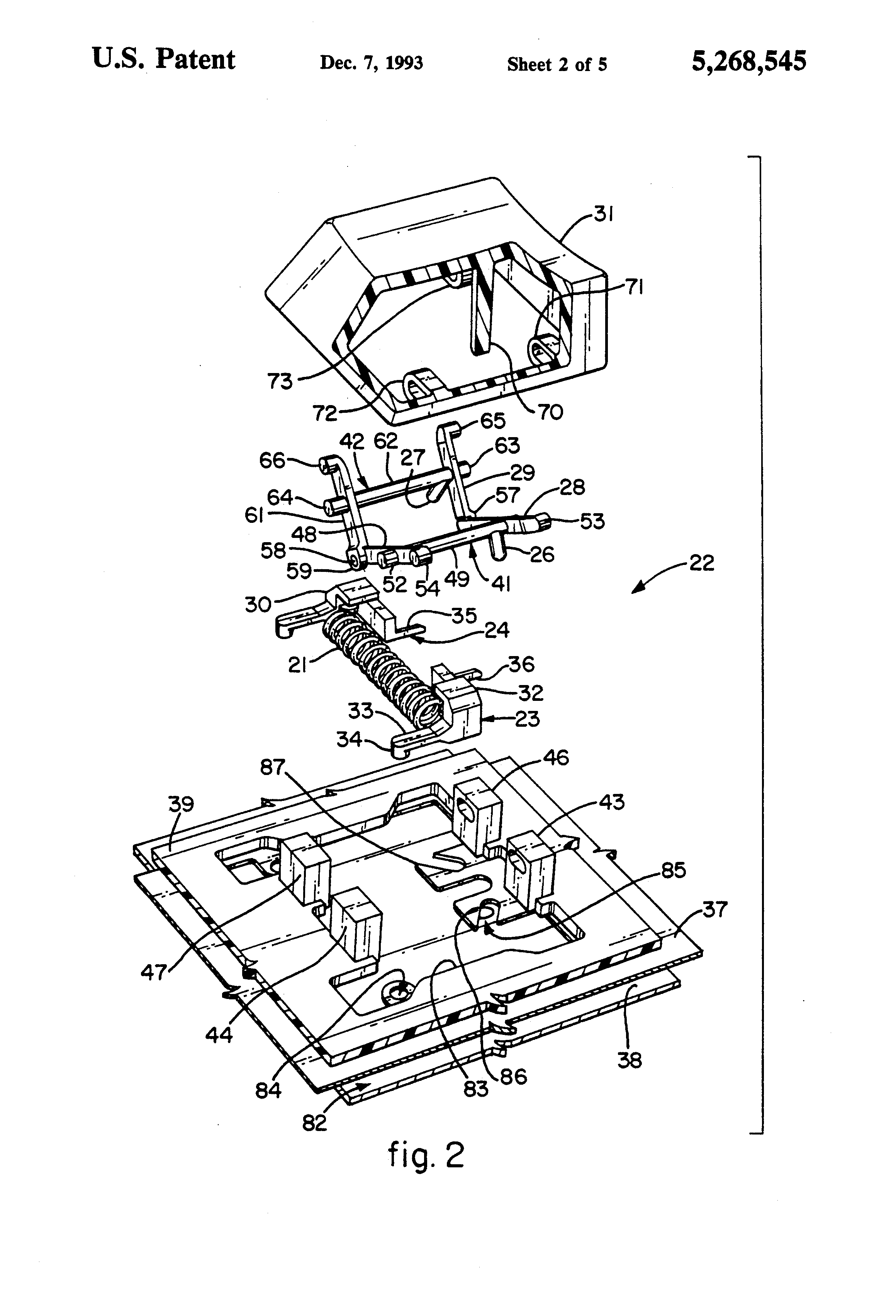

Lexmark took out a patent on an even lower profile buckling spring variant, but to my knowledge no prototypes were ever produced. Probably ditched the effort due to the complexity.

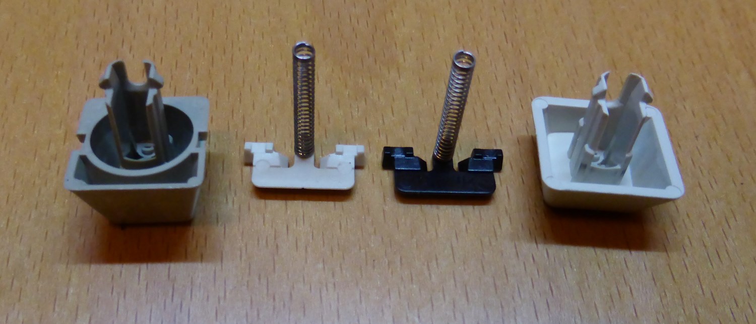

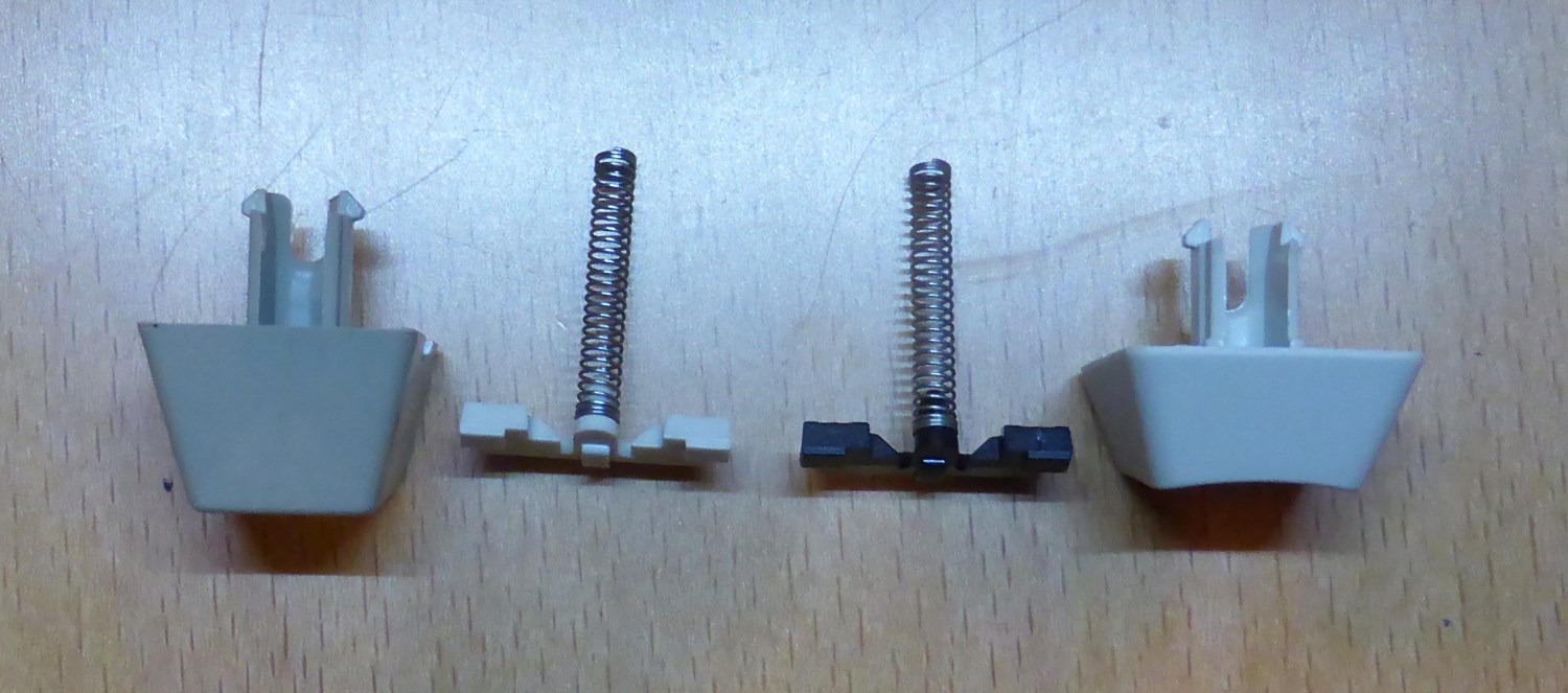

Quick & dirty pictures of the spring and a cap from Model M (left) vs. Model M2 (right).M'er Forever wrote: Very interesting, thanks Mu! Do you have a photo of the topside of that barrel frame? Are the barrels shorter? If so, then the springs must be shorter (and perhaps smaller diameter) than the M's springs. That might explain the difference in key feel and/or sound.
While the key is higher on the original Model M, the functional part of it (stem) has pretty much the same size, as has the spring.
- m_bird.jpg (159.23 KiB) Viewed 7037 times
- m_side.jpg (184.91 KiB) Viewed 7038 times
