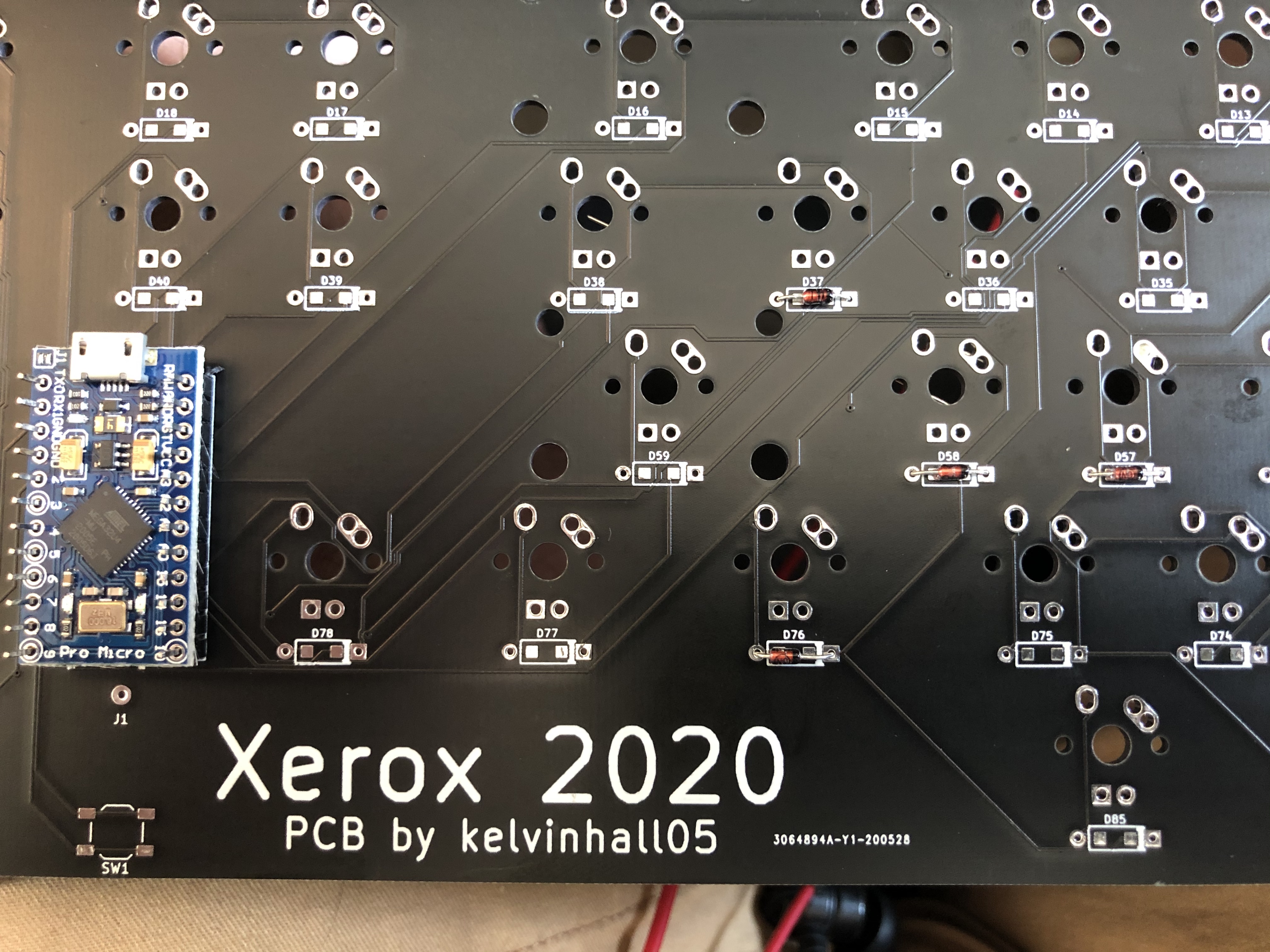

ddrfraser1
09 Jun 2020, 21:49

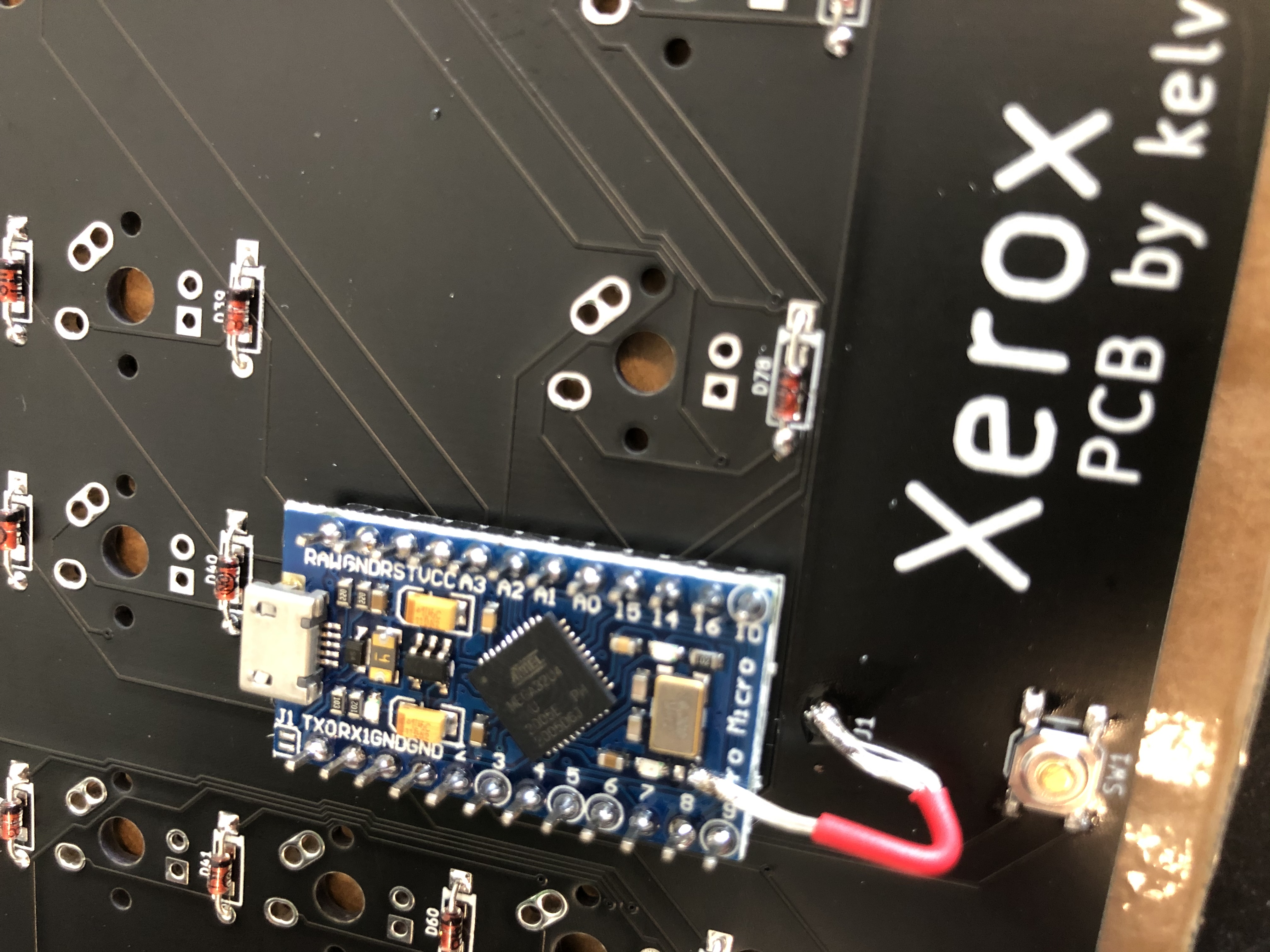

Someone please correct me if I’m doing this wrong. Also, does the orientation of the reset button matter?
kelvinhall05
09 Jun 2020, 22:14
ddrfraser1 wrote: 09 Jun 2020, 21:49 Someone please correct me if I’m doing this wrong. Also, does the orientation of the reset button matter?
Nope, orientation doesn't matter. Glad the PCB appears to have turned out well.

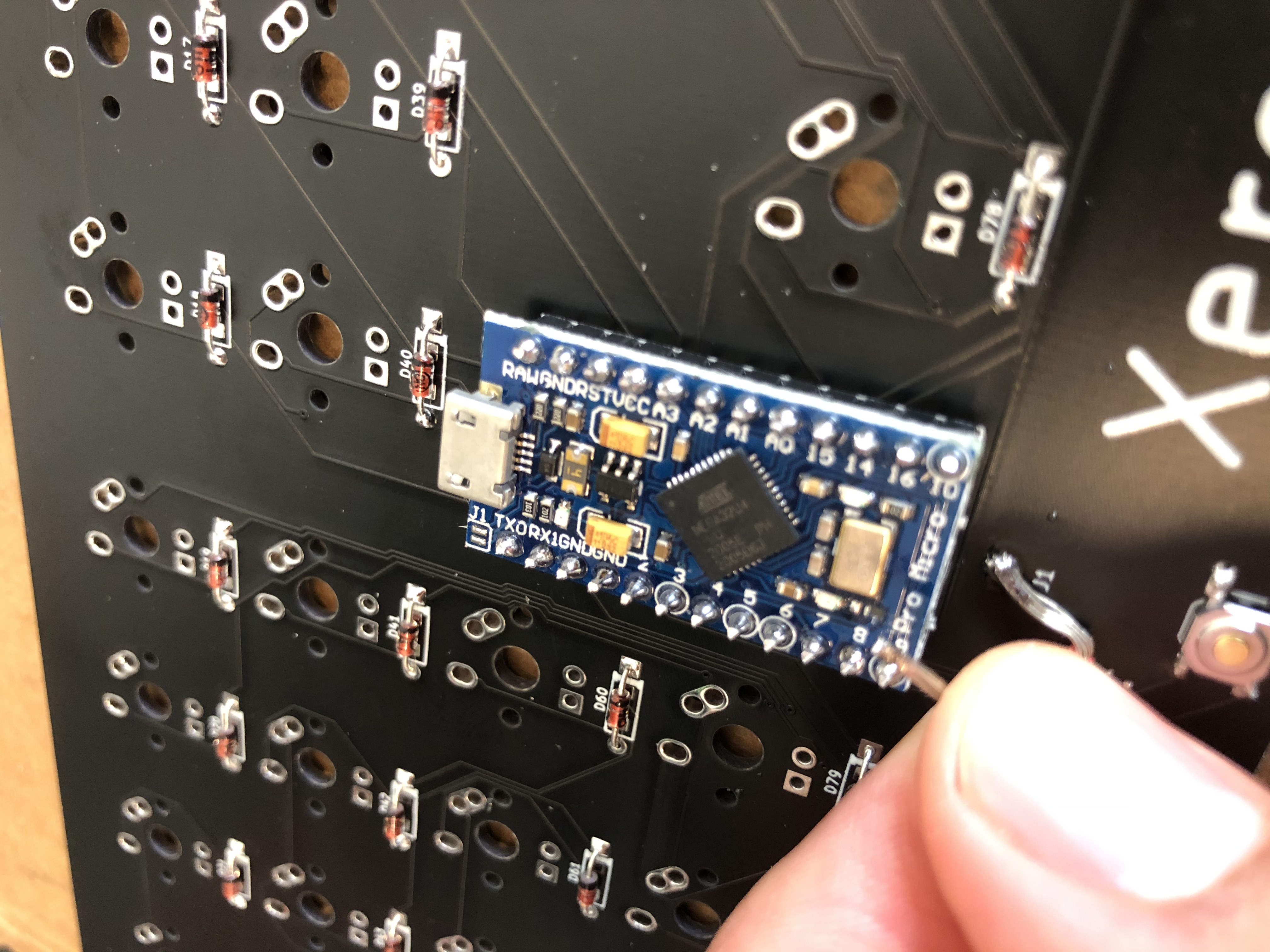

kelvinhall05
09 Jun 2020, 22:16
Btw before you solder the pro micro, I highly recommend you remove the resistor going to the TX/RX LED now. Will be easier now than later.
Doesn't matter which LED, but make sure you are soldering to the lower leg of where the resistor used to be (circled part in the pic) and also note which one you are using as you will have to use it in your firmware.
ddrfraser1
09 Jun 2020, 22:42
Yikes. I've read this a few times but you've still lost me. Are you saying I should desolder and remove those resister's marked in the yellow circles or do I need to reroute something?
I was just planning on soldering up all 24 of those pins to the pro micro. Is that not what I'm supposed to do?
kelvinhall05
09 Jun 2020, 23:41
ddrfraser1 wrote: 09 Jun 2020, 22:42 Yikes. I've read this a few times but you've still lost me. Are you saying I should desolder and remove those resister's marked in the yellow circles or do I need to reroute something?
Don't have to reroute anything. So there is that one hole on the PCB near the back of the Pro Micro. I believe I told this to you in our conversation (sorry if I didn't) but you are going to have to take a wire and solder one end to that hole and one end to a pad for that resistor on the Pro Micro. No rerouting or anything, but for a matrix above 81 keys, you have to tap into those two resistors (at least, on a Pro Micro).
EDIT: to better answer your question, just remove one of the resistors (doesn't matter which one, again, just make note of it when doing your firmware) and solder the other end of the wire going to that hole on the PCB near the Pro Micro to the lower pad of where the resistor used to be. You are still going to want to solder the 24 pins like normal though.
ddrfraser1
09 Jun 2020, 23:52
Got it. So that hole marked J1. I'm gonna solder a wire from there to the pro micro? Specifically, I'm going to remove that tiny little resider in the B0 circle and solder the wire to that empty spot? Do I solder the wire to the top pad or the bottom pad? ie, positive or negitive?
kelvinhall05
10 Jun 2020, 00:01
ddrfraser1 wrote: 09 Jun 2020, 23:52 Got it. So that hole marked J1. I'm gonna solder a wire from there to the pro micro? Specifically, I'm going to remove that tiny little resider in the B0 circle and solder the wire to that empty spot? Do I solder the wire to the top pad or the bottom pad? ie, positive or negitive?
Solder to the bottom pad. Again, you can use B0 or the other pad, both will work.

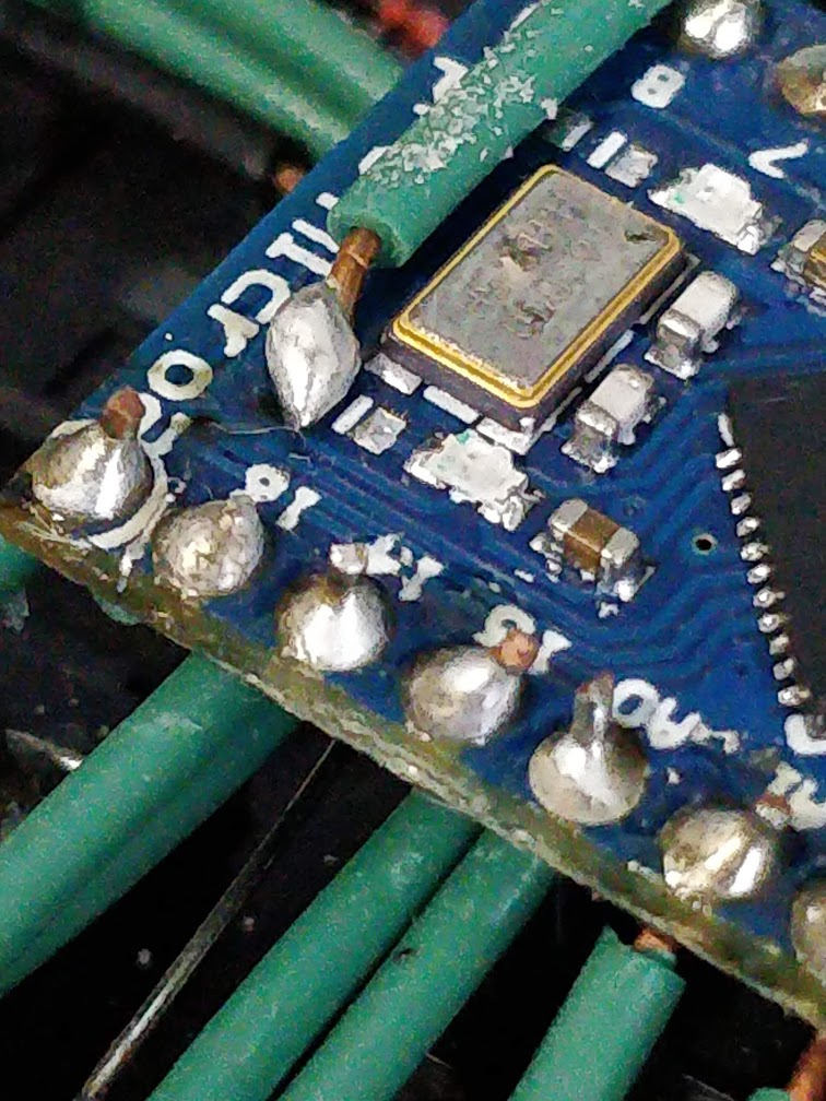

Pic of the handwire I did that used one of these pins:
ddrfraser1
10 Jun 2020, 00:16
Sweet! Thanks man! Is this standard for every build?
kelvinhall05
10 Jun 2020, 00:25
ddrfraser1 wrote: 10 Jun 2020, 00:16 Sweet! Thanks man! Is this standard for every build?
If you want a Pro Micro and over 81 keys, yes :)
ddrfraser1
10 Jun 2020, 00:34
Gotcha. Here’s what I did.
ddrfraser1
10 Jun 2020, 00:43
Umm... crap. The pad came loose. Did I just kill my pro micro or can I still use the other pad under the other resistor?
kelvinhall05
10 Jun 2020, 01:41
You can use the other pad. Only difference between those two pads (rather, the two lower pads of the two different resistors) is that they have different pin "names" or whatever. It will still work, don't worry. If you have any fine wire (magnet wire is what I use, it's perfect) I recommend that.
Good luck...
ddrfraser1
10 Jun 2020, 03:55
Sweet. Thanks

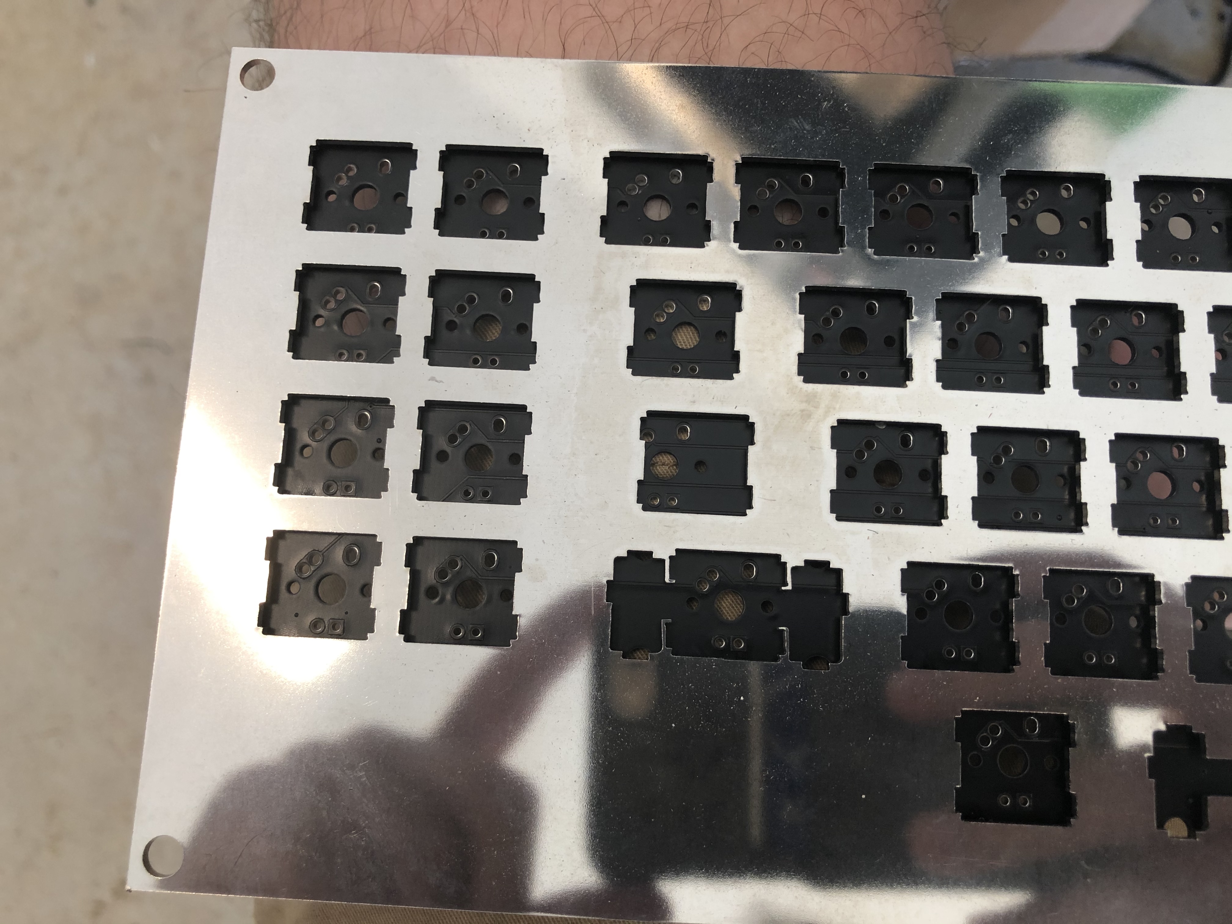

ddrfraser1
11 Jun 2020, 00:42
Retreating to familiar territory for a while while I (with a lot of help from Kevin) figure out the firmware.

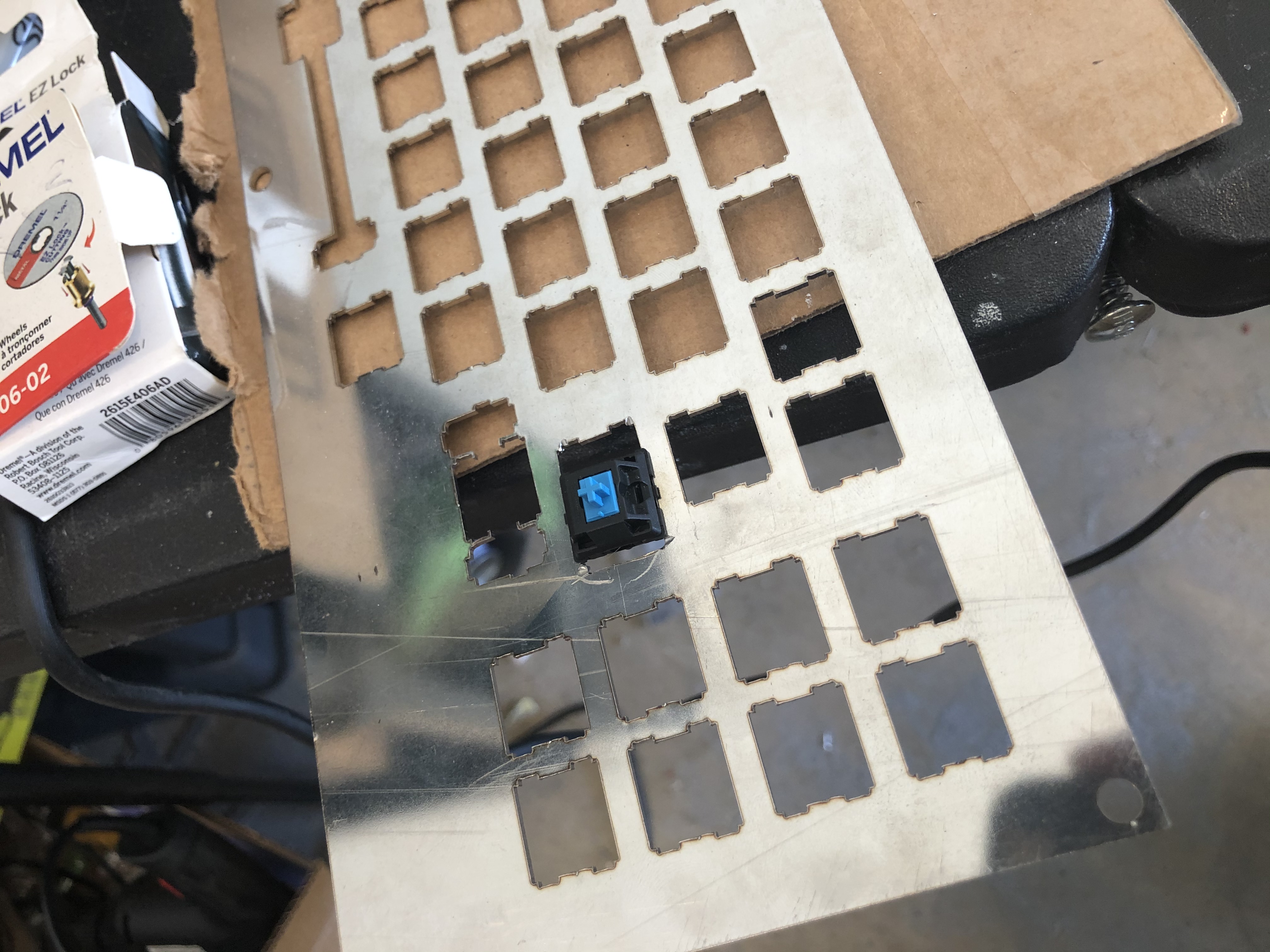

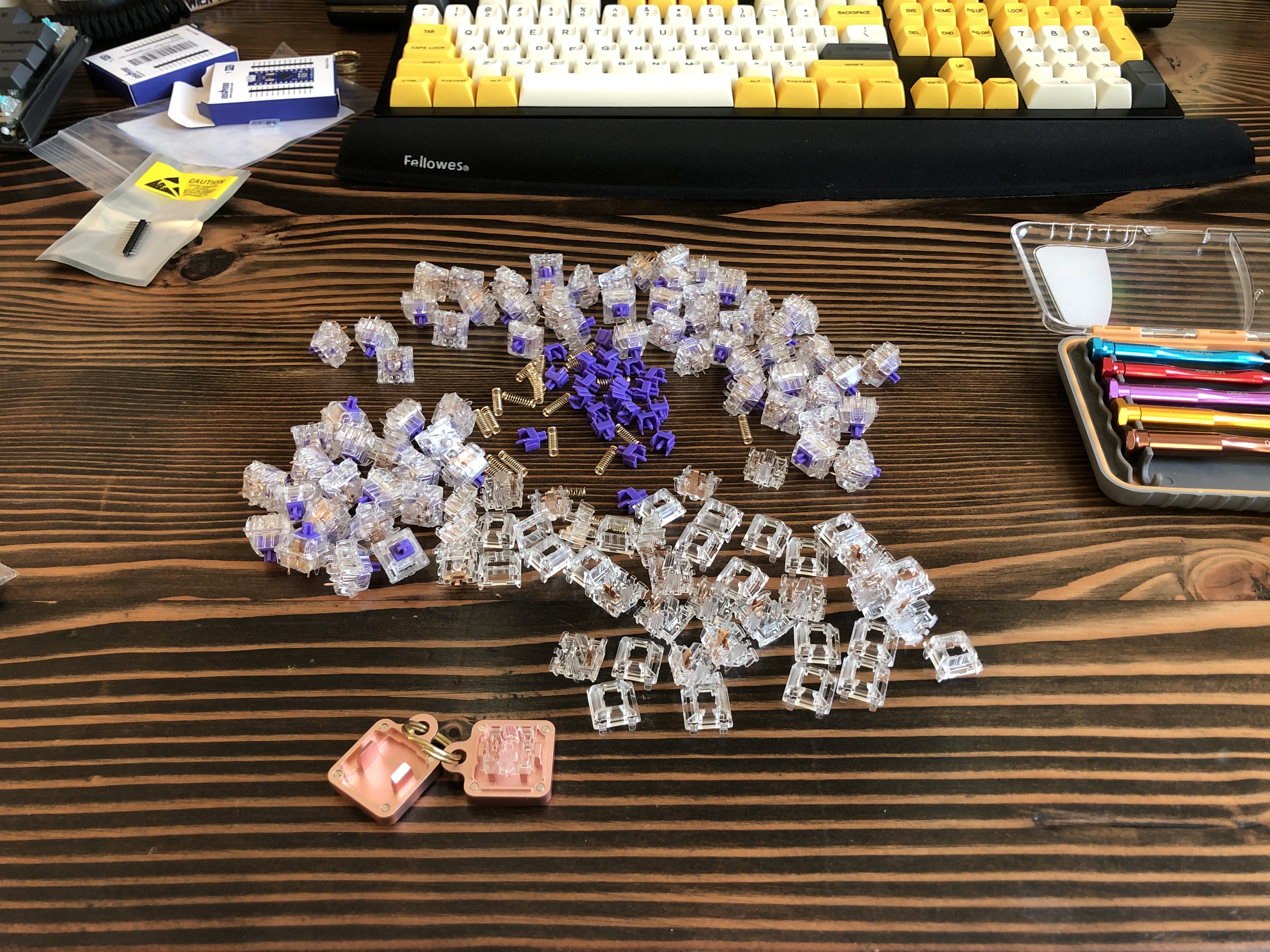

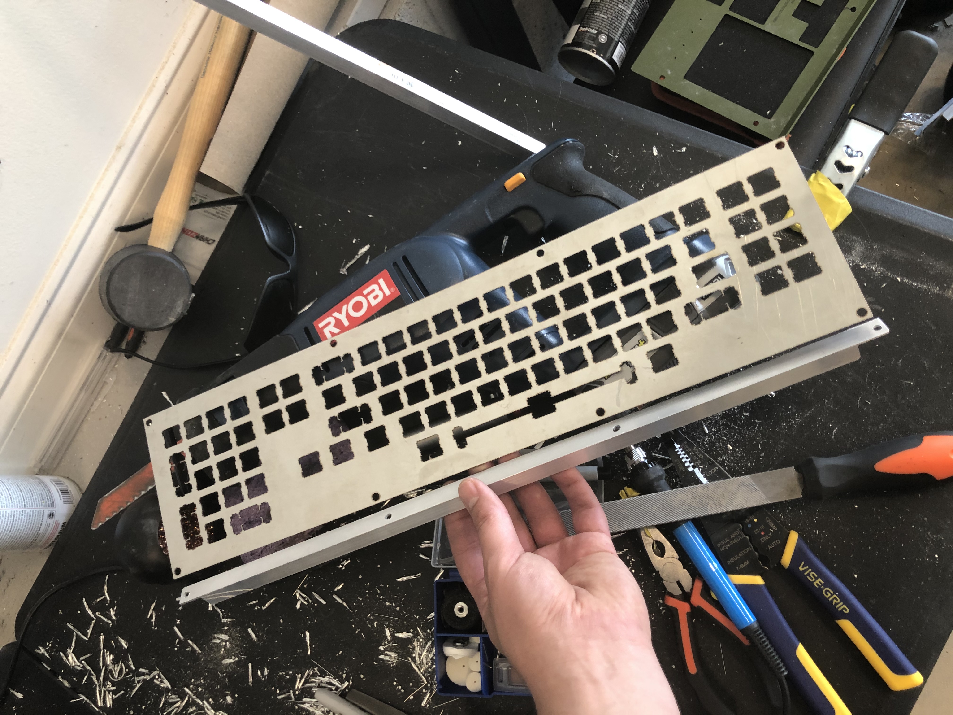

Lubing my zealios. Using Krytox 1514 VPF oil.

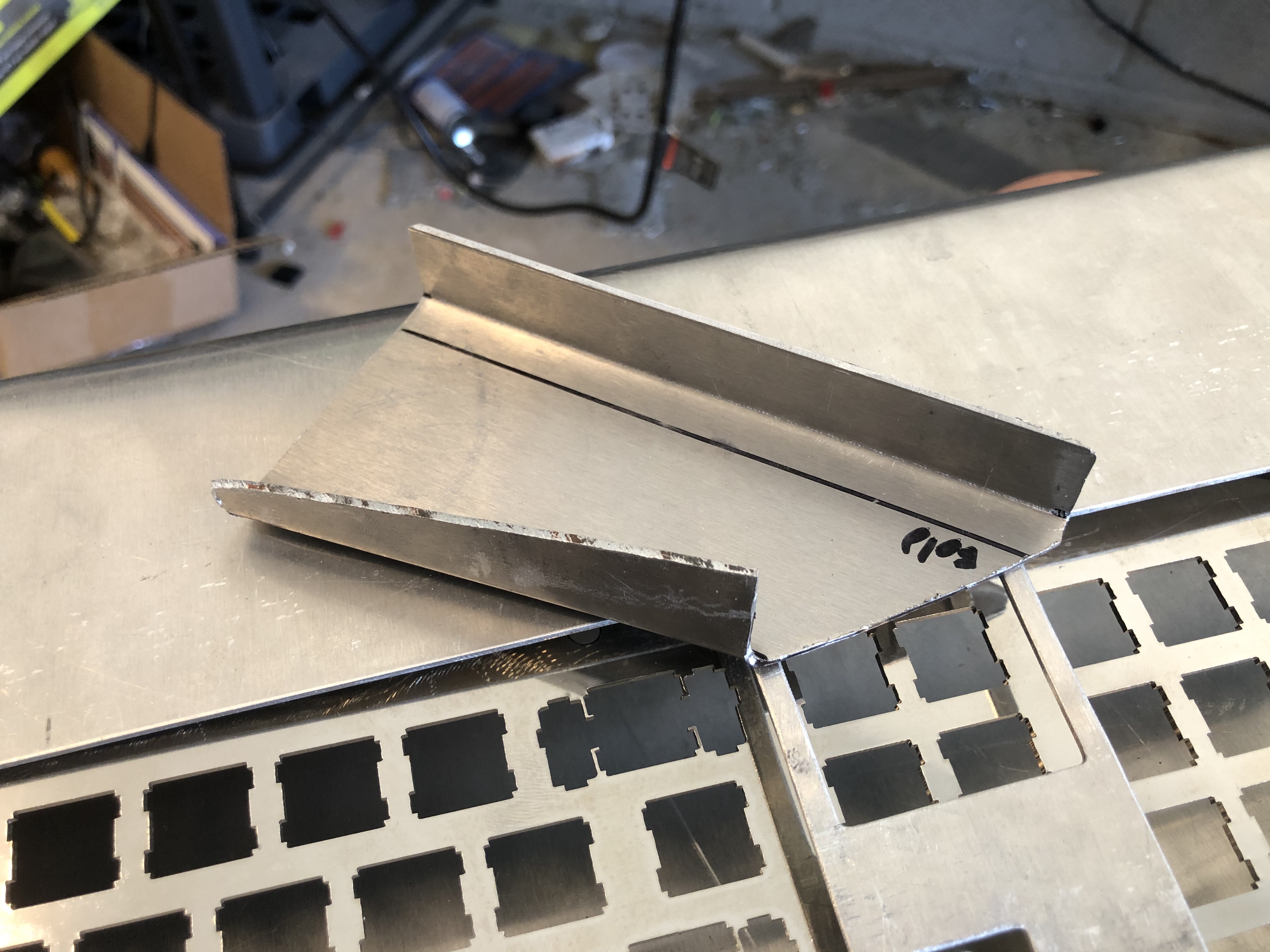

Made these things to mount everything and add some rigidity to the long and floppy (...) keyboard.
Lasergist messed up the cutout, not sure how, so the pinholes for the stepped caps lock didn’t line up properly.
Nothing a bit of dremeling couldn’t fix.

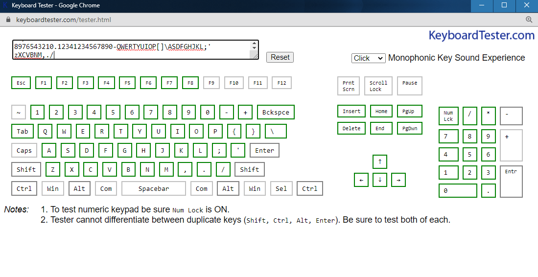

ddrfraser1
11 Jun 2020, 17:18
Phew! Everything works! To me, this was the most difficult/worrying part. It's nice to have it out of the way! It's mostly all down hill from here :D

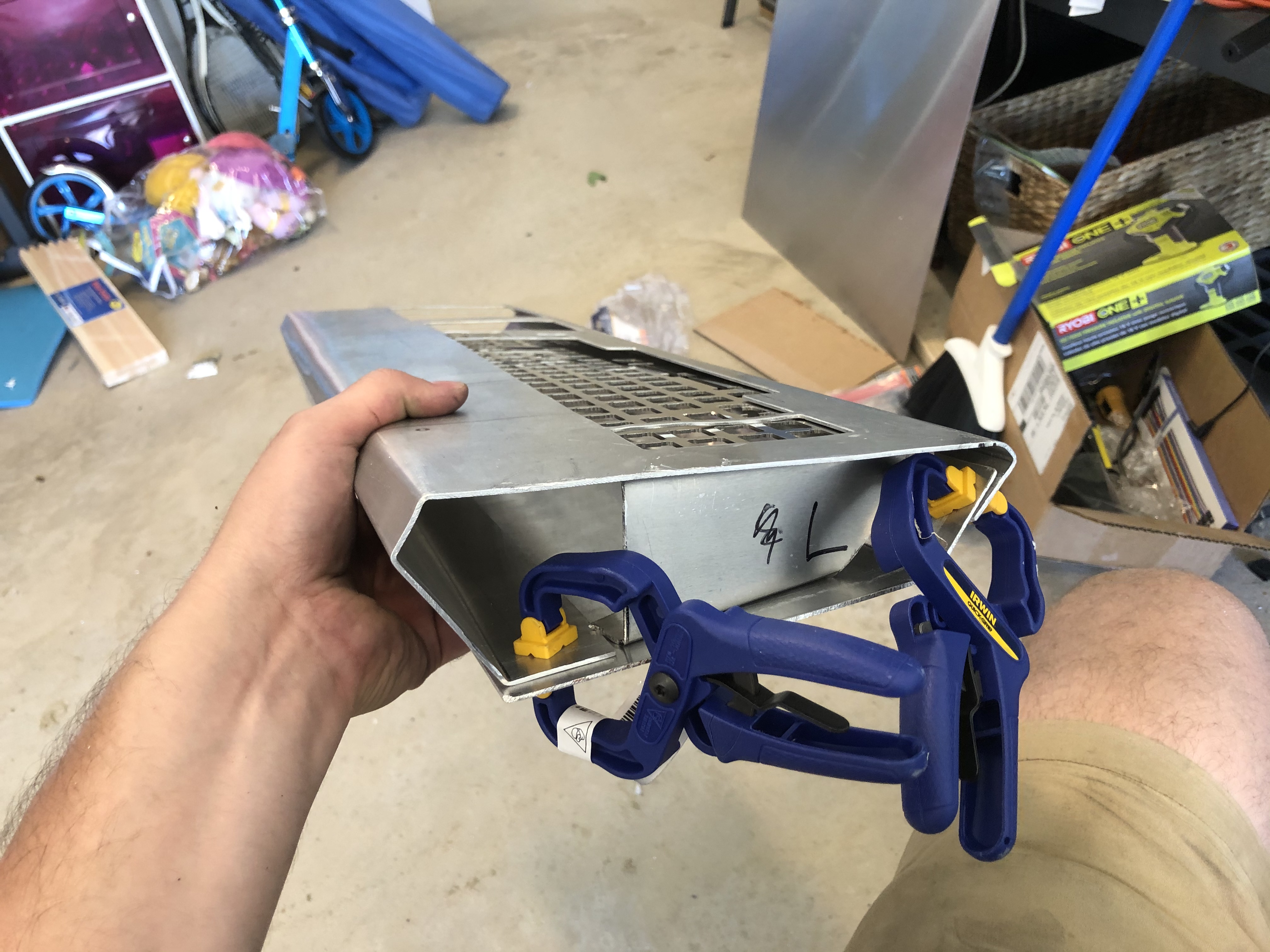

Prototyping
I made these things to mount everything. Unfortunately they ended up being too tall and the plate is pressed right up against the case. Bah, I’ll try again another day. I’m tired.

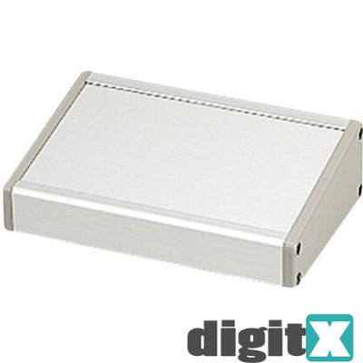

keyboardist
12 Jun 2020, 00:07
Ummm, have you tried finding long slanted industrial prototype enclosure? I see enclosures with trapeze like side shape (think 1980s 8-bit and 16-bit machines) in online shops. Been wondering for a while why no one uses them for keyboard projects. But no idea if there is any as long as you need.
ddrfraser1
12 Jun 2020, 00:42
keyboardist wrote: 12 Jun 2020, 00:07 Ummm, have you tried finding long slanted industrial prototype enclosure? I see enclosures with trapeze like side shape (think 1980s 8-bit and 16-bit machines) in online shops. Been wondering for a while why no one uses them for keyboard projects. But no idea if there is any as long as you need.
I have not. I've been looking for stuff like that. Link?
keyboardist
12 Jun 2020, 02:27
For example:
https://mt.rsdelivers.com/product/hammo ... -x/1931040
https://www.digitx.it/codice/c-cf45_28g ... od-102097/
Search for alluminium angled/slanted/wedge enclosure. There are plenty such things in different dimensions. But as I said - no idea if they come in size you are looking for and are they in acceptable price range.
Metal one can be pricey . But there are also made from different materials - like different types of plastic from thin cheap to thick ABS. I once even went into that retro 70s style wood plus metal like used forn example vintage Korg synthesizers.
Maybe look for audio hardware enclosures. They are often bigger - like ones for mixing consoles, modular synthesizers or some other stuf like this
https://www.jands.com.au/brands/clear-c ... and-kb-701
