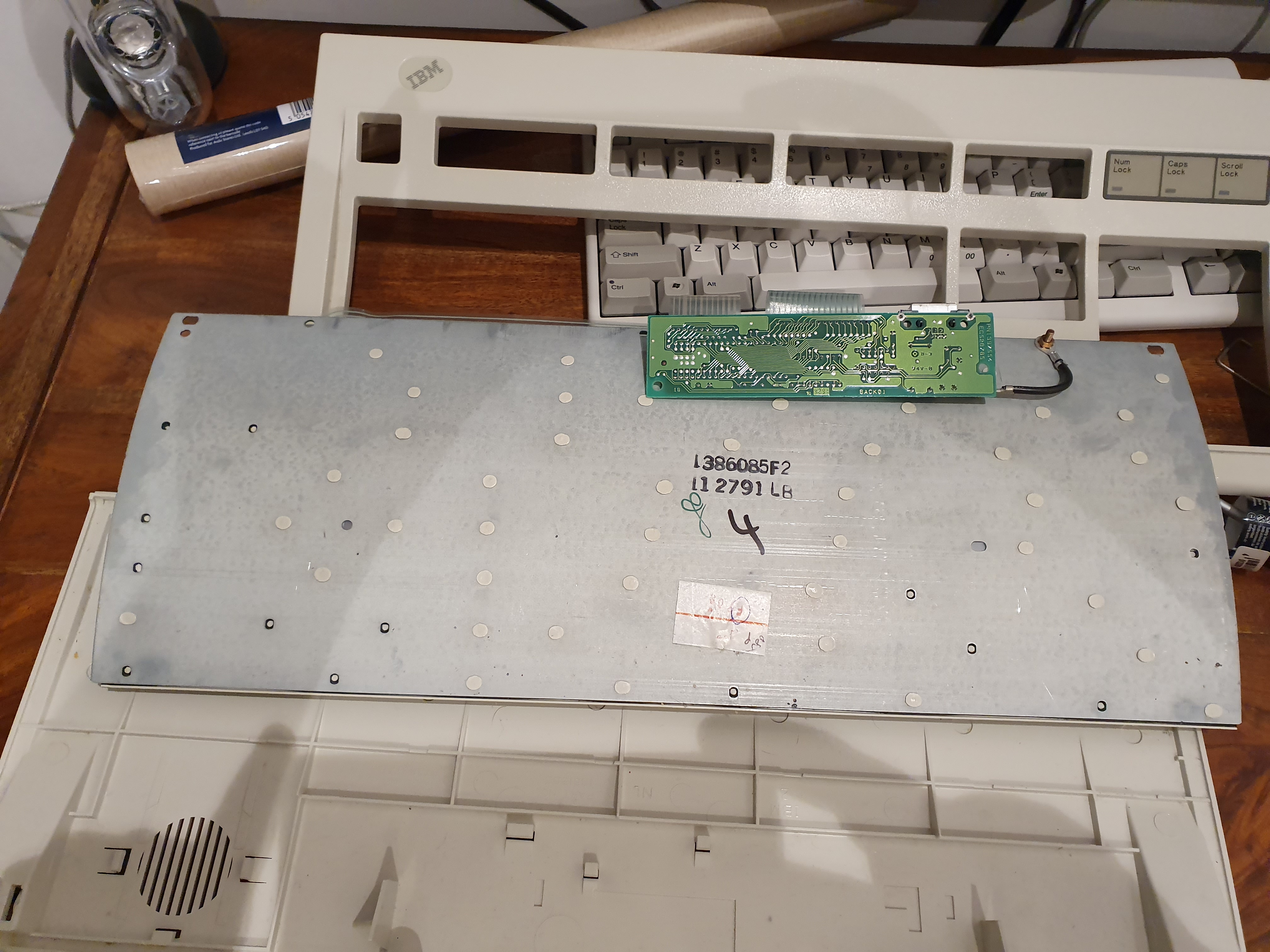

Ordered one on amazon, came in today, 5.5mm
Opened it up.
Few rivets are gone, but whole board is stable.
What do you guys think?
No need for bolt mod just now?

You could potentially just screw mod the few broken rivets for now, and do a full screw mod later.
Lost In Static
08 Feb 2020, 16:49
As long as it shows no issues I'd leave it as is
swampangel
08 Feb 2020, 18:29
If it feels good to type on, leave it. If there are keys that feel noticeably mushy, you might want to add screws in that area of the board.

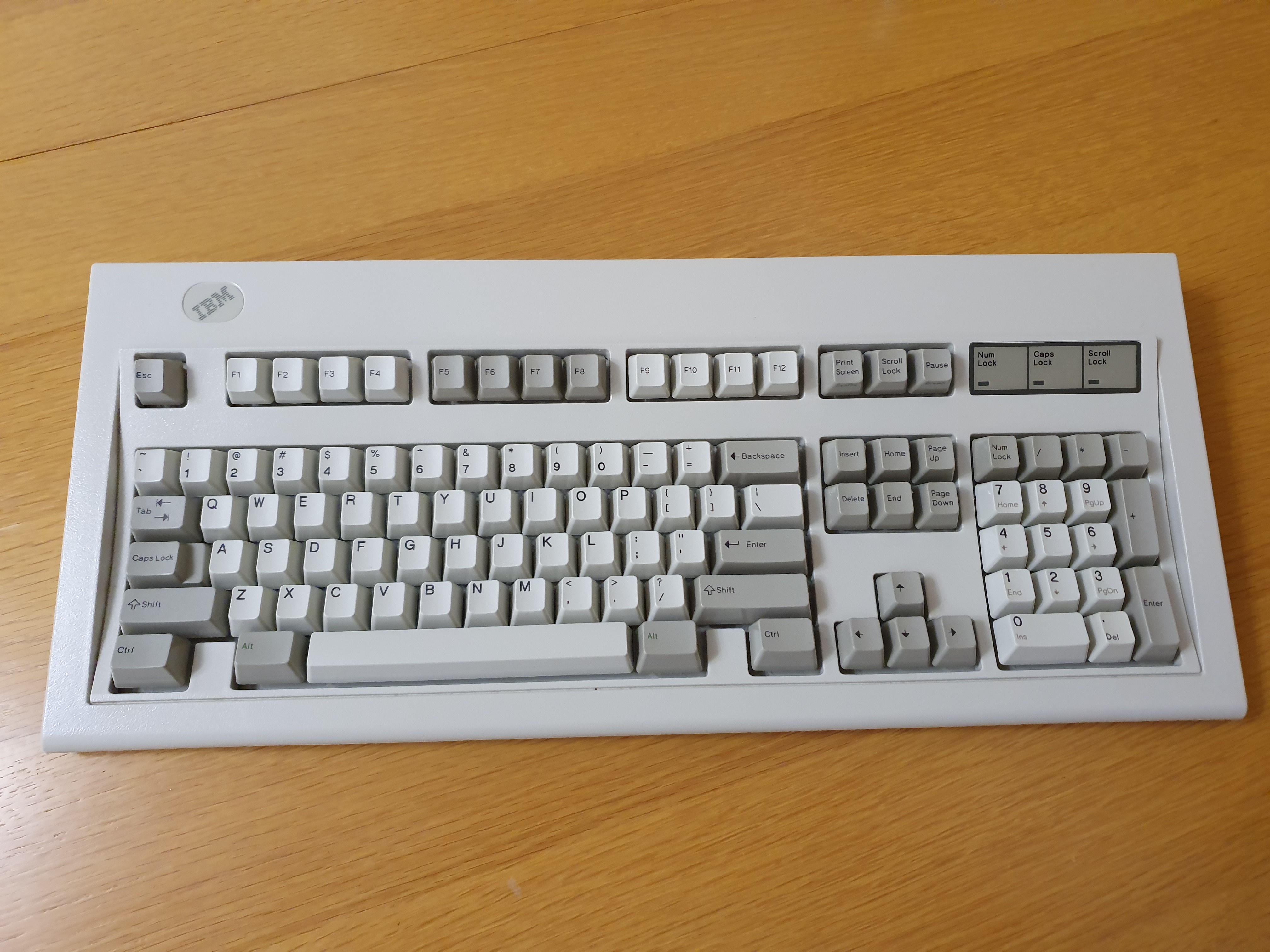

Cool, thansk guys.
Feels all good now, I guess with time I may need to this mod.
Typing on it now, feels great:)

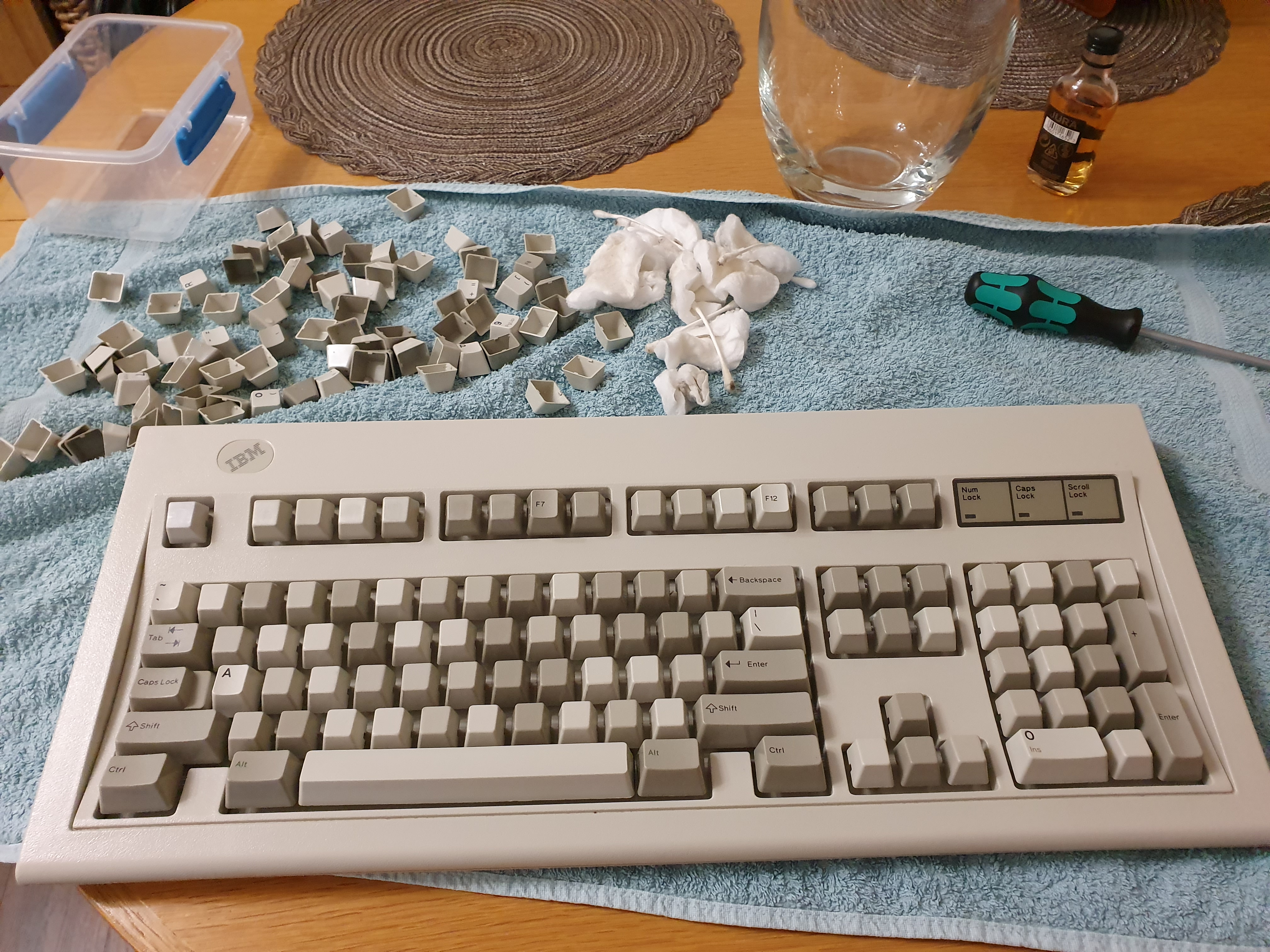

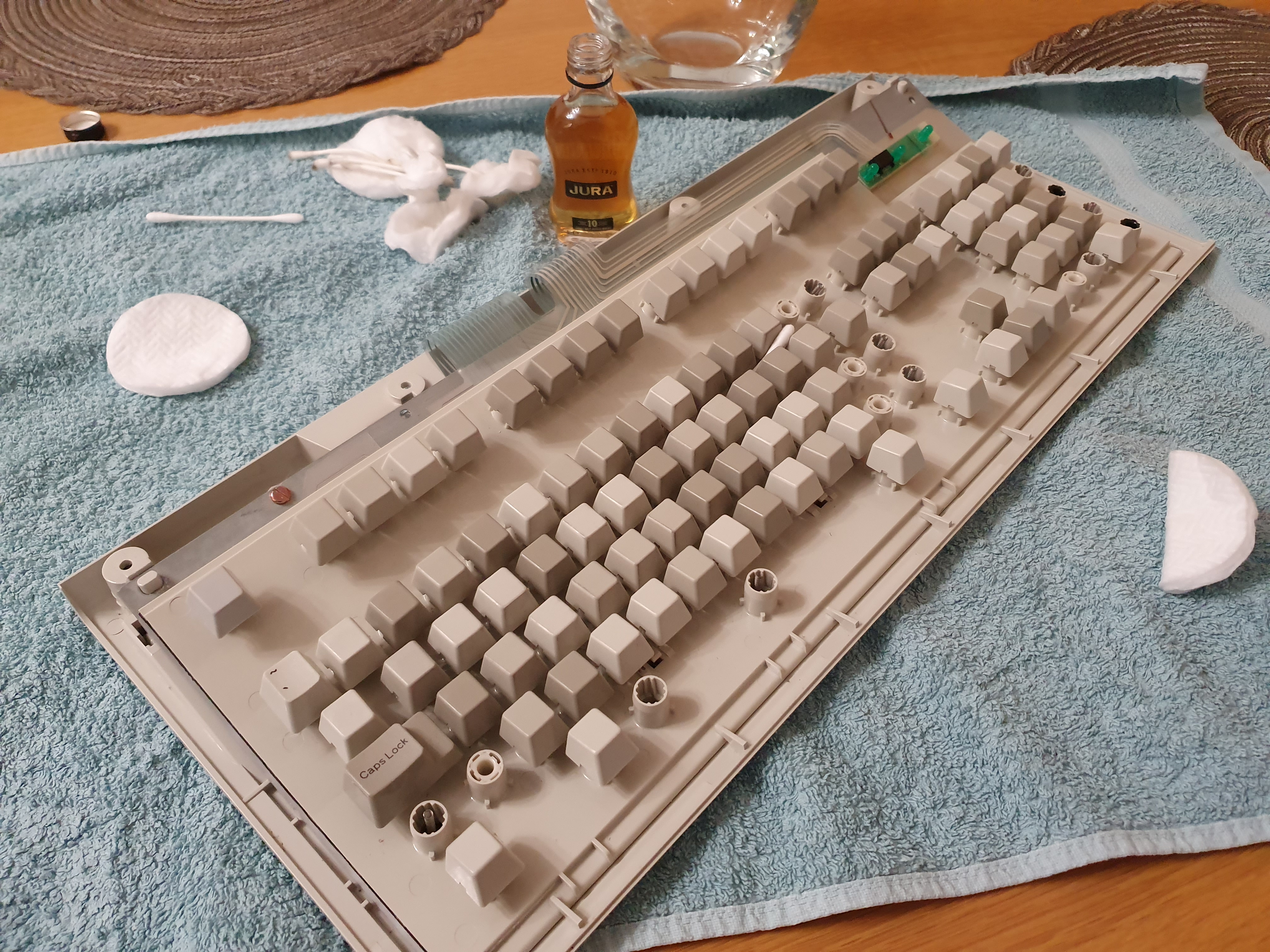

I gave it a good clean - used whiskey to clean all insides, plate, between keys, all nice and clean now.
Cleaned case top and bottom, cleaned cable.
Now it looks like new:)

If you only have a handful of broken rivets don't bother with a full bolt/screw mod, just drill out the failed rivets with a 1/16" dill bit and replace them with M2 6mm machine screws. Don't tighten them hard, just enough to grip while still allowing the springs to move freely back and forth in the barrel.
I will generally only do a full screw mod on a board that either needs to be taken apart (dead membrane or broken striker) or has a ton of broken rivets.
