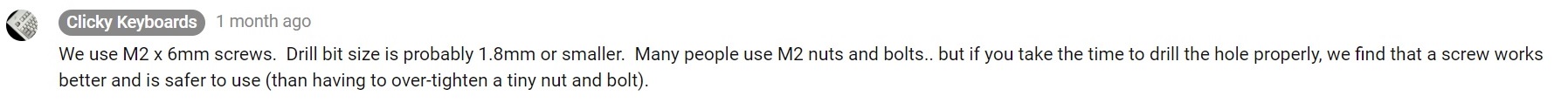

I plan to also bolt mod my model m but not an ssk, i have come across the video you linked it seems to be the only video for bolt modding a model m, but in fact i found a video of someone bolt modding a ibm wheel writer that has more or less the same design as the model m and it helped me to figure out how i will go about bolt modding my m.
https://www.youtube.com/watch?v=2kUG1vt_O2g&t=117s
This is what i have come up with so far.
1.Dissasemble the model m
2.Remove rivets with a stanley blade (carpet knife blade) marking the posts with a silver sharpie as i go, so i know where to trim down.
3.Remove the Back plate, Trim down the posts to those little triangles, marking them once again with the silver sharpie but this time so i know where to drill.
4. Before i begin drilling i use a small file to file down any posts that were not cut properly. The file has a pointy tip which i will use to make pilot holes for the drill.
5.Begin to drill the holes and pray i dont crack the barrel plate
6.Reassemble the barrel plate and back plate use the hardware suggested on geekhack.org's guide
Considering i have never bolt modded an model m before this is the best i have come up with. I myself dont see any flaws in my plan but would be greatful if someone could point them out to me if there is any. Good luck with bolt modding your ssk. I hope to buy one myself.

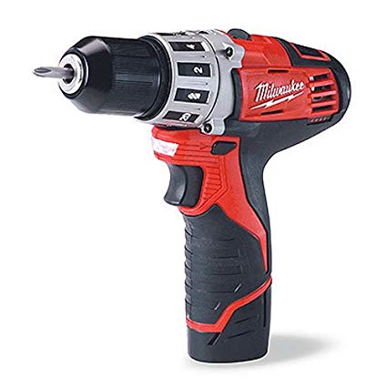

I am only going to be bolt modding one board, i thought of making a jig but i do not have access to a drill press so i will just have to use a hand drill. In the video i recommended the guy uses a pointy file to make pilot holes and it looked like it worked so i am going to give it a shot.

I have neither a dremel or rotary tool i was looking at investing in one but decided againsted it as most the reviews for dremels on amazon or local shops said they would break with in the first month. Instead i have a small little hand drill like the one pictured
i plan to use this. I may or may not make a little jig to hold the barrel plate

Yeah, as long as the barrel plate isn't flexing when you drill, you should be alright. At least with the Model F bolt mod, cracking wasn't a concern.

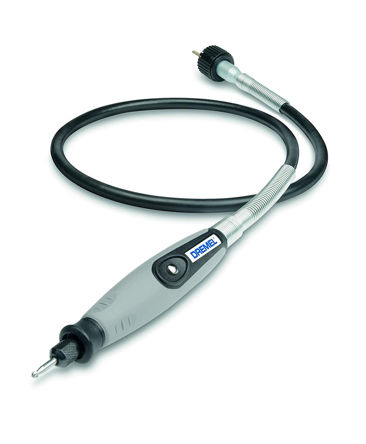

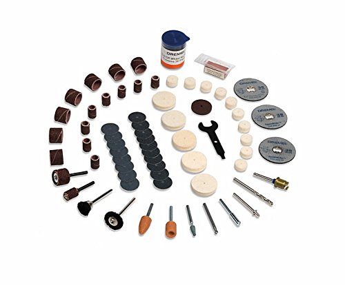

So it turns out my dad had a dremel and he is letting me use it for the bolt mod, although when i dug it out it had none of the pieces he said he may have put them away some where else, so i have ordered the multi purpose chuck, 100 piece muti purpose tool accessory kit.
Which attachment should i use to grind down the posts on the switch plate. i have only done a few with the hand file i have but the file is not completely flat so its making the posts domed. i was thinking the smallest sand paper piece would do.Also which attachment should i use to make little guide holes for the drill bit.
PS. i also bought the flexi shaft tool in hopes of making life easier

That is some nice gear! My Dremel is a standard basic cheapie from the 1980s.
That burr tip still looks large - I have one that is much smaller than the diameter of the primary shaft.
I do all the cutting with a chisel tip blade on an Xacto knife. I do the rough cuts with one blade, pull all the plates apart, and shave the flat tops of the "mesas" with at fresh new chisel tip. Try to do it in a single stroke.
As always, get in very close with your reading glasses and do it 2-handed.
