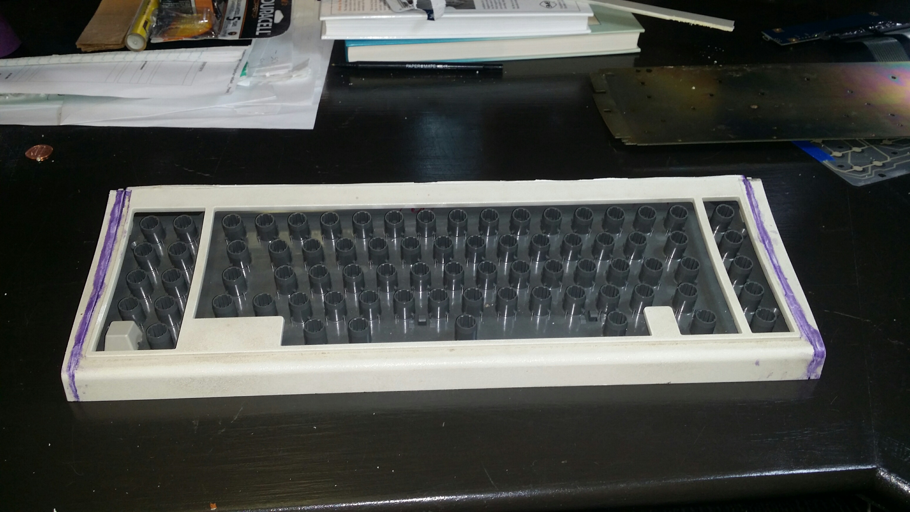

Started working on the case and decided I would hack down the original as a starting point by lopping off over 4 inches in the width. I will need to cut down the metal plate as well. I did test some scraps and they appear to be solvent weldable so I will reuse the ends after they have been trimmed and filed to a minimum. Because the keyboard originally came from a typewriter there is no base plate or cover for the topside and those will need to be fabricated. I may be able to find some suitable material in my stash of old rubber domes otherwise I will do something with composite materials.
Ends trimmed and top flange removed.
Posted: 22 Jun 2017, 20:16
by rsbseb
Got the ends trimmed, edge sanded and glued during my lunch break.The case is starting to take shape. :)
Can't hardly wait to see what this little board is going to look like with some SBS caps on it.

Model M cases are made from PVC plastic so it doesn't terribly surprise me that these are solvent weldable. That's a good trick to know! I had a Wheelwriter typewriter keyboard with the full case assembly and I tossed the assembly. D'oh! But this is still encouraging to know for Model M chop projects.
