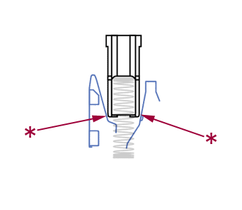

In my experience, metal to plastic friction was the main culprit of gritty feel in NEW Alps black switch in Dell AT101W. Most of the gritty feel went away after lubricating the metal leaves with silicone oil(I used Victorinox multi tool oil). It was about two years ago when I first tried lubricating and silicone oil was only lubricant I had at the moment. After two years of spotty use, it works just fine. It didn't get sticky and dust accumulation didn't seem to cause issues.
Here is where you should put some lubricants. I used oil dropper and smeared some oil on the metal leaves.
source: http://www.kbdmania.net/xe/116178<br />by digipen(2004)
by digipen(2004)
Alps lubrication points 1.gif (7.56 KiB) Viewed 7513 times

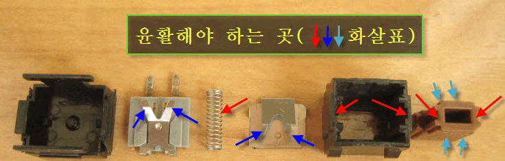

Also, the Alps switch housings are ABS plastic which is known to have friction issues. ABS plastics degrade when rubbed against and the friction becomes an issue after some time. So, I think it is important to put some lubricant on the sliders where it touches the switch housing. See red arrows in the below pics.
source: http://www.kbdmania.net/xe/122939<br />by Capriong(2008)
by Capriong(2008)
Alps lubrication points 2.gif (98.71 KiB) Viewed 7513 times
