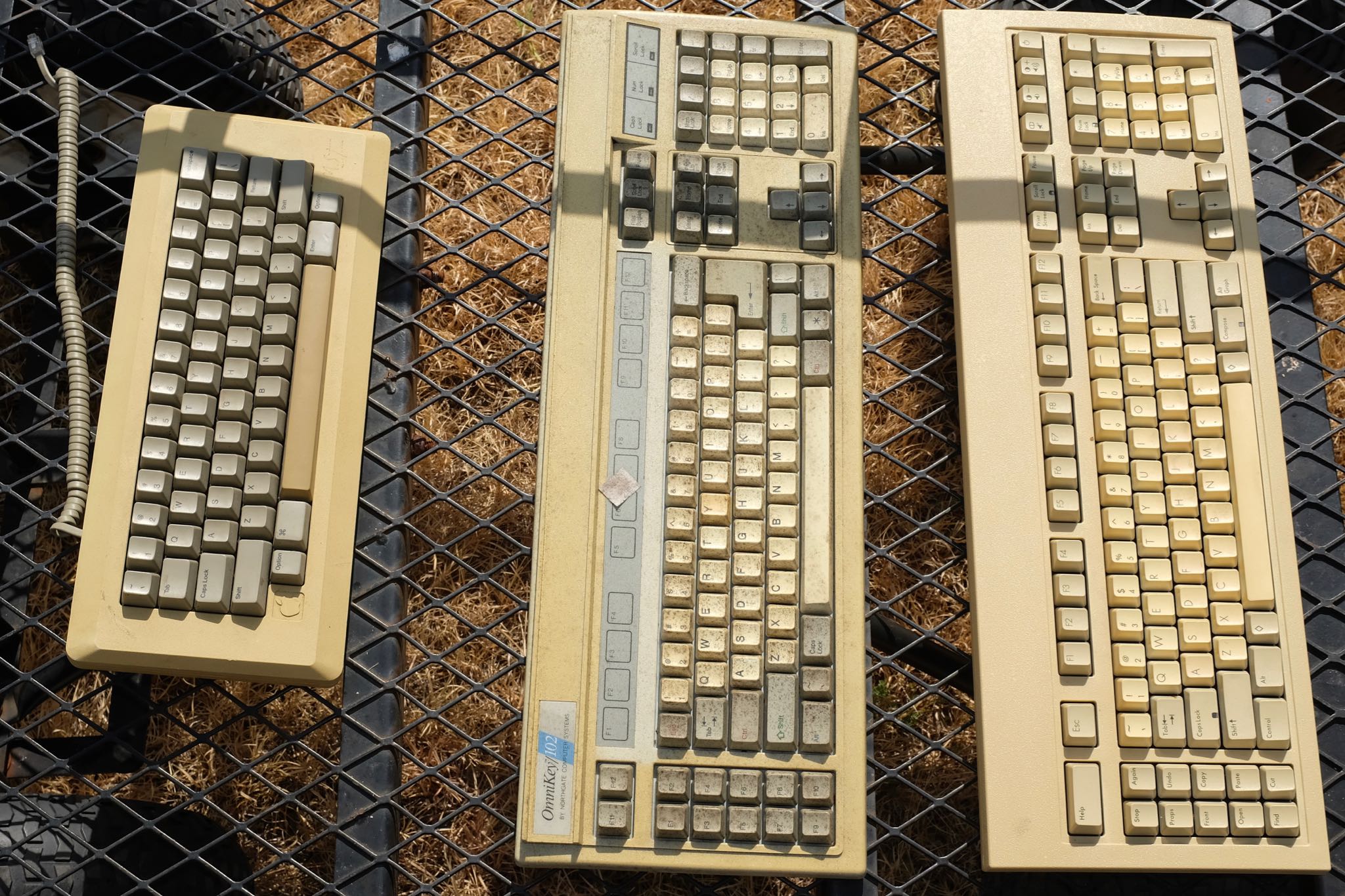

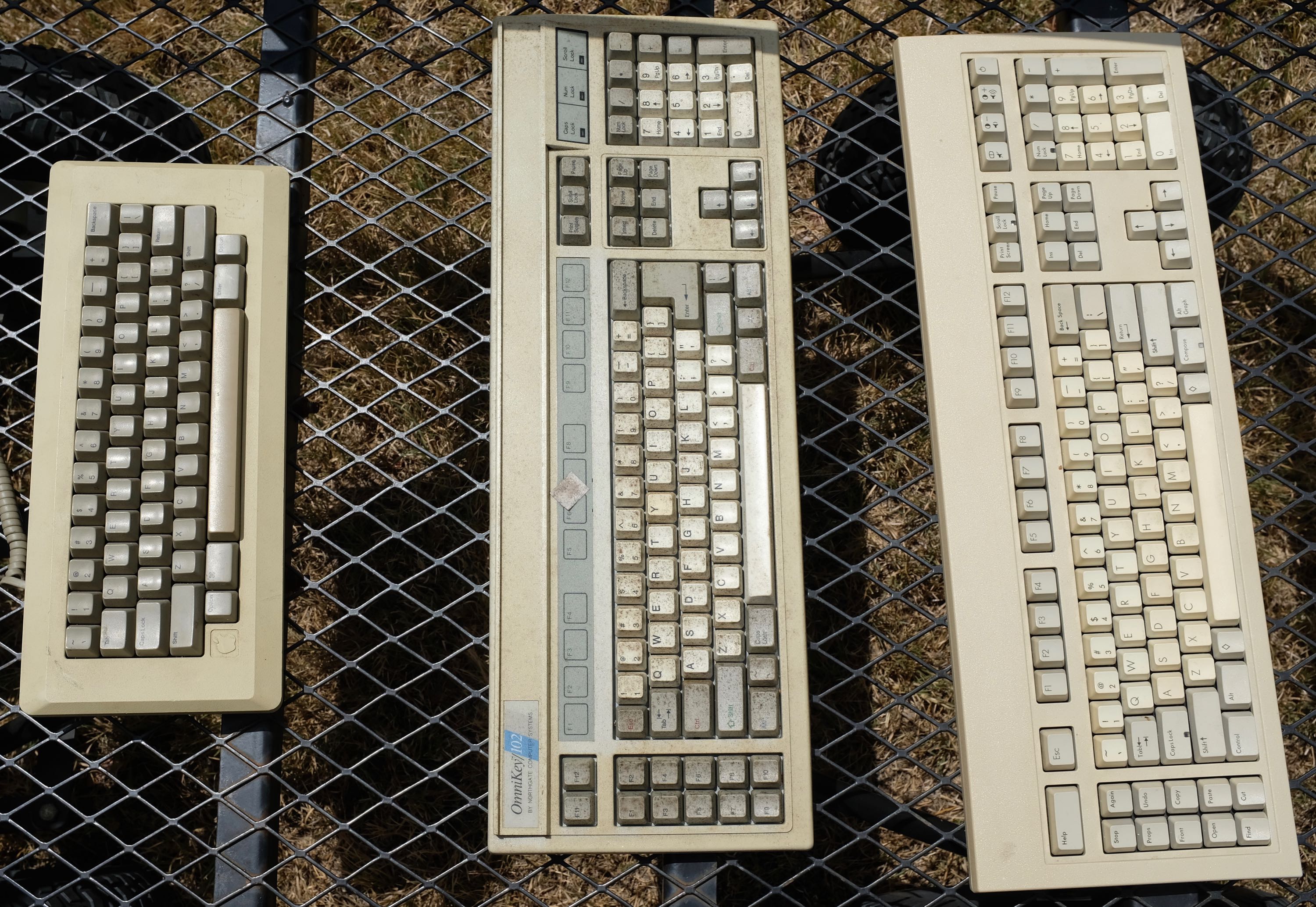

The UV index [1] here in Central Texas [2] is 11.
I have three keyboards out for whitening out right now: an Apple M0110, a Northgate OmniKey 102, and a Sun Cherry keyboard. They were real bananas, the most yellow keyboards I could quickly find. I set them out at 10:20 local time, in a garden cart, in a place with no shade.
It is now 14:34 local time and the whitening results are noticeable.
As you can see the cases and in particular the key caps on the OmniKey are notably lighter. This is also super easy to do, with almost no prep other than putting the wagon out. I see a lot of keyboards getting whitened in this way soon...
Sunset is at 20:10 local time so I have at least five more hours of whitening to go!
According to [3] if you happen to live in Nairobi, or Darwin, or Singapore, this should work great for you. :mrgreen:
My biggest concern is brittling of the plastic from all the added UV exposure. I'll crack these boards open and pull key caps at some point to see what has changed.

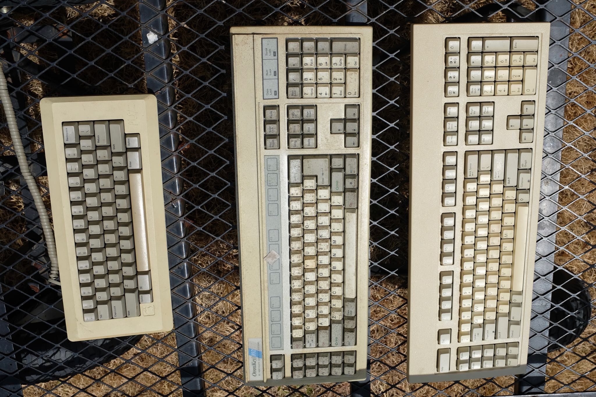

25 Aug 2019, 14:48
I left the keyboards out for a second day. They got a little brighter.
Solar bleaching, day two.
DSCF6160 (3).jpg (989.93 KiB) Viewed 10938 times
I don't fully understand the processes at work here but I expect that this follows a logarithmic curve, meaning, you'll see the most pronounced results in a few hours, and steady but increasingly slow progress as time continues. Perhaps another week could get things lighter?

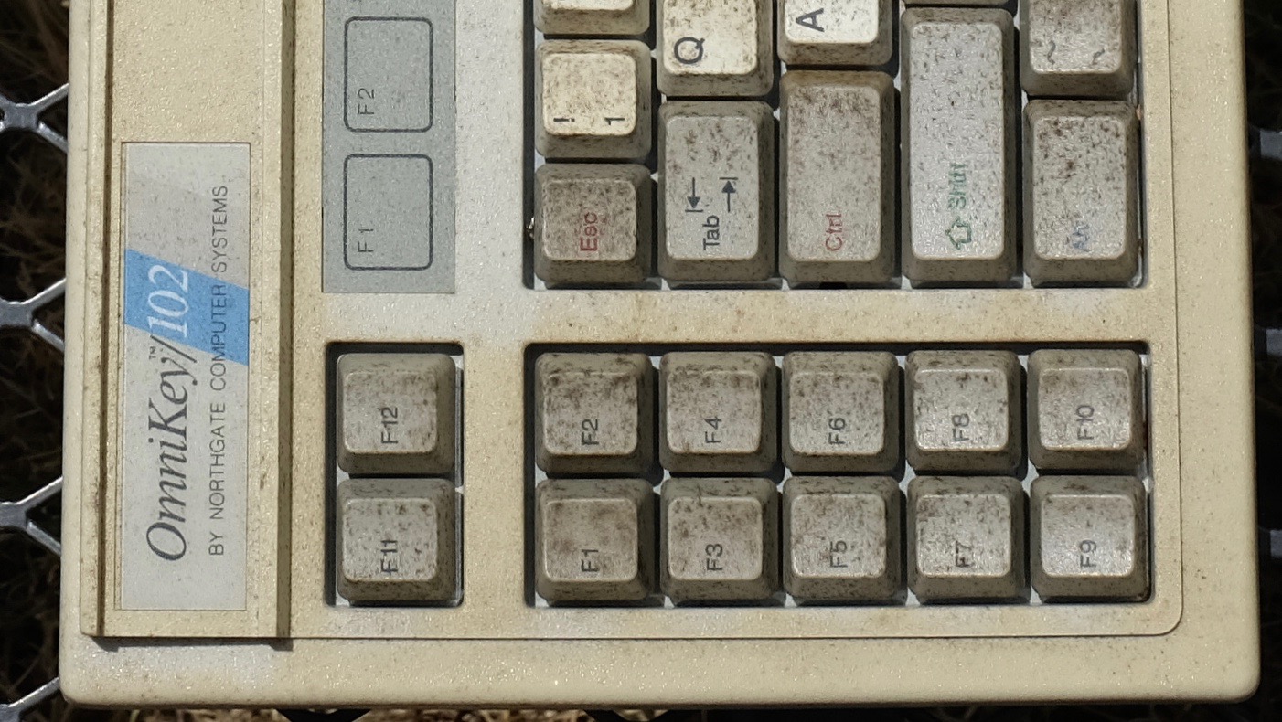

Here's a detail shot of the OmniKey/102. The keyboard had a legend card over the function key area that protected part of the case from yellowing damage. So you can clearly see, there is some difference between the bleached result, and the original, which is lighter still.
OmniKey/102 after day two.

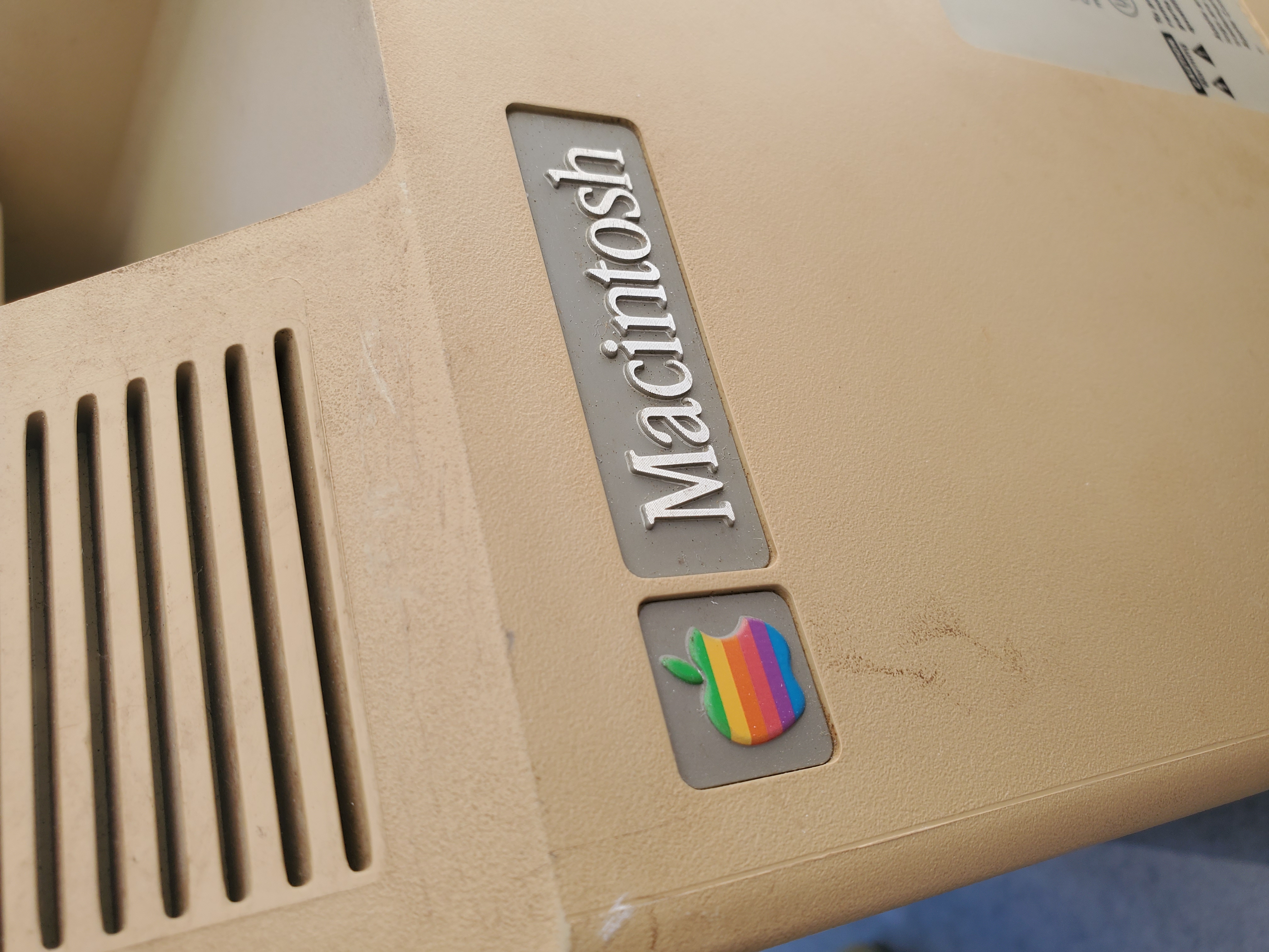

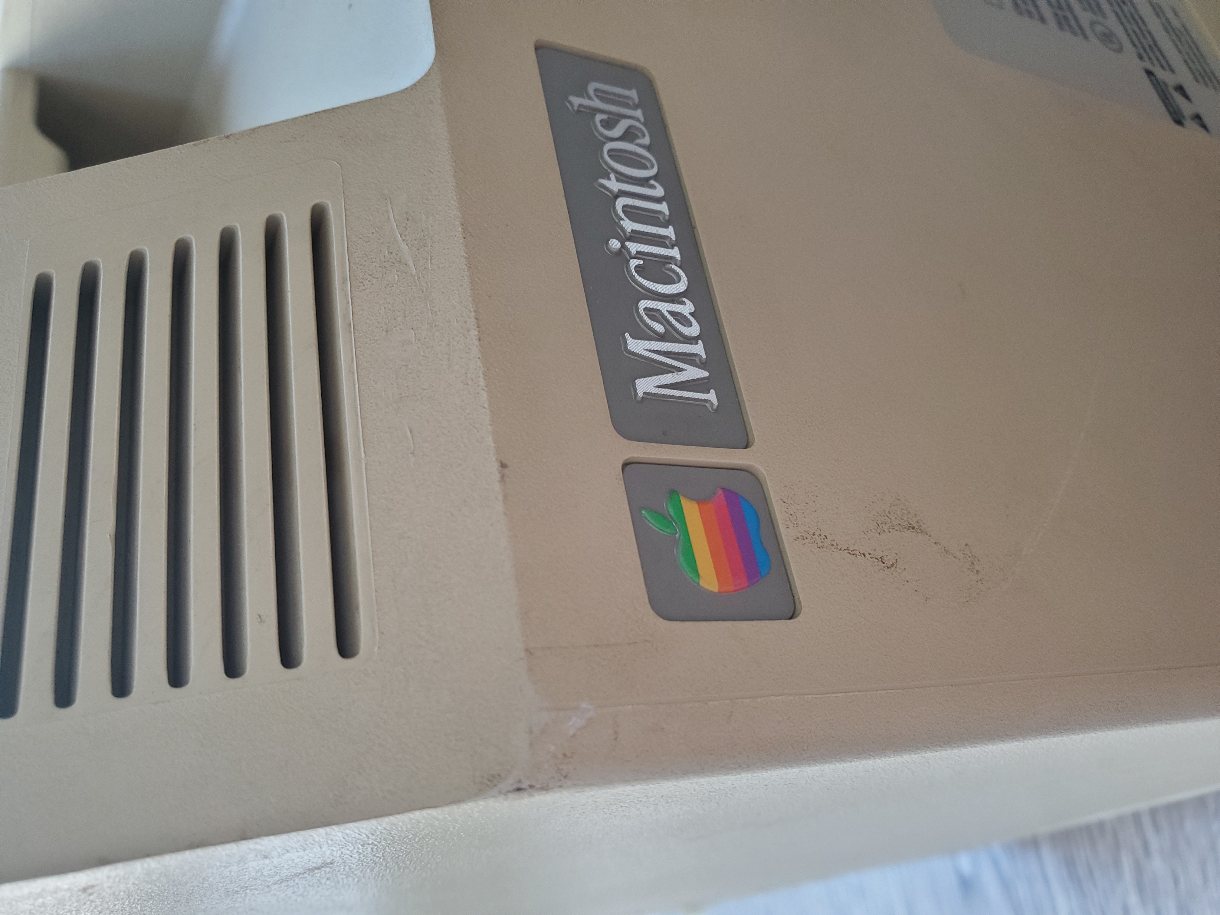

So I live in socal, its not that hot but the sun is strong. I think theres plenty of UV here.
So last weekend I threw an Macintosh case out. This is the result:
So heres before
Bear in mind that these two photos were taken in different times of a day so take them with a grain of salt. From my eyes theres definitely a little bit of brightening but nothing significant enough...

User101 wrote: 25 Aug 2019, 22:26So last weekend I threw an Macintosh case out. This is the result:
That's beyond yellow. Maybe it's too far gone to be recovered. I've seen badly yellowed plastic before, but this looks like hardened orange. I've got an Amiga 500 that's the yellowest I've ever seen, but it never went past yellow to dark orange.

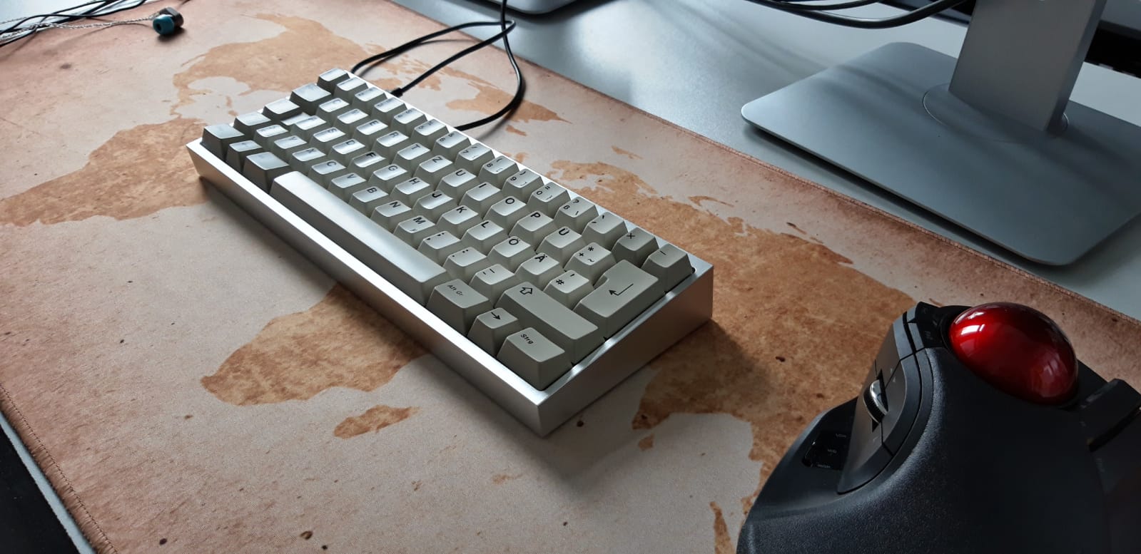

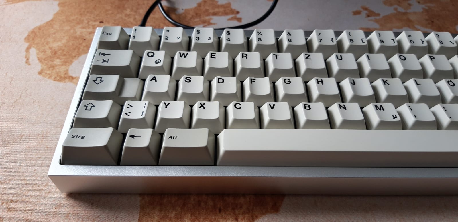

On doubleshot caps, just use very fine sandpaper or sandblasting. Not a fan of retrobright due to inconsistent results.
The keycaps in my example were not yellow, they were brown before I used sandpaper 600 --> sandpaper 1500 --> microfiber cloth on them. In my opinion there is no easier way to bring back the original color.
The caps have a satin finish to them now which I like a lot. If you need the original grainy texture, you can sandblast with glass beads.
From my point of view, Retrobright makes only sense on cases but not on keycaps, especially not doubleshot ones.
BTW: Thanks for sharing the story. It helped me a lot.
