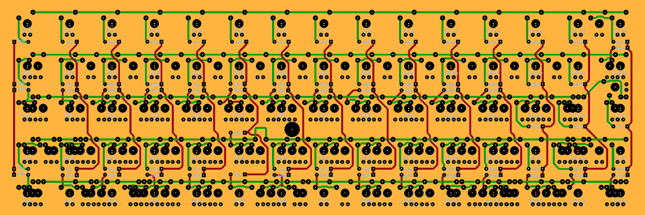

First solution:
24 Nov 2012, 19:54
The big hole in the middle is for a pointing stick. Does anybody know what diameter that hole must have?
This layout supports symmetric 1/4-stagger layout, 7bit, ANSI, ISO, HHKB-JP and matrix layout!
Because there is no space, the controller must be connected with wires to the PCB. I will add soldering pads for the whole matrix later.
The little holes below the switches are for the LEDs. Traces for them are still missing ...

7bit wrote:Becuase there is no space, the controller must be connected with wires to the PCB.
How is that going to fit into your case design for this keyboard?
24 Nov 2012, 20:26
As far as I know the Poker does not have space for a controller section above the key-field.

7bit wrote:First solution:
would this layout work on that pcb? Image
I mean, isnt this as sexy as it gets?
27 Nov 2012, 18:03
Yes, no problem!
Once I've conquered the PCB, I will post CAD files for the mount plates.

27 Nov 2012, 19:56
PCB: yes.
Plate: I must look, but I'm quite sure it works ...
More important for me is to know how the LEDs should be traced up.
