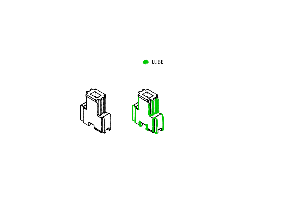

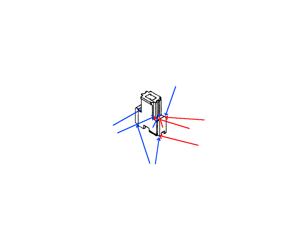

UPDATE:
if you get any binding, it means that there isn't any lube in the most important places. Those places are, in my experience, these. Let me know if the graphs need some clarification.
NOTE: no need or point to lube the insides of the sliders. The friction happens on their outside corners mostly, with the exception of the insides of the top sliders.
lube points
lube points

andresteare
20 Apr 2021, 00:01
Anyone tried mixing Nyogel 767A with with a more conventional lube, for those who can't get OKS?
What I get from this conversation is that you use a thicc boi (Nyogel) for binding and stability and a thin boi for smoothness (OKS) to get the right balance. So would it make sense to mix nyogel with krytox/tribosys?
NeK
20 Apr 2021, 06:23
you got the main point right. however you missed on the greases combination.
Krytox/tribosys first of all are not hydrocarbon oils, synthetic or otherwise, they are a different type of oils, a synthetic PFPE, so they don't get mixed well with nyogel which is a synthetic hydrocarbon one. and secondly, they are way too light (non-viscous) to make any difference anyhow. nyogel would dominate them. it is as if you are mixing cement with yogurt and expecting yogurt to make the cement softer. (a monstrously exagerated example, I know and thus not accurate, but illustrates the point)
ALPS switches need heavy viscosity lubricants, because of their big stems, materials and the more steep angles that they can travel.
OKS is way more viscous than krytox/tribosys and works with ALPS and can actually mix well with nyogel, and lube them nicely.
to clarify further the general point:
NyoGel 767A is a *dampening* grease i.e., it makes for a slower and heavier slide, whereas OKS and krytox/tribosys are *lubricants* i.e. they make the slide lighter and faster.
Dampening gives a precise, controlled and stabilized feeling, and thus improving the quality of the sliding and the whole switch. Lube, just provides a smoother and faster slide, but when it is light viscous and is used on big and harsh surfaces, it tends to result in *stiction* (sticky + friction, i.e. heavy ier static friction and lighter dynamic friction) which is actually worse in feeling.
