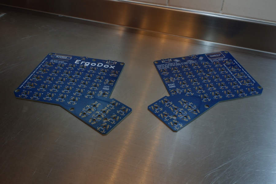

Look what no one but me have got =D

I knew it! Very nice bpiphany, I can't wait to test it!

Looking good!

Great job on the pcb design!!
DV, could you please add me to the list? Thanks. Definitely in for the PCB (1 pair) and we'll see about cases when the prices are known for sure.

This PCB will only take platemounted switches, amirite?

Djuzuh wrote:This PCB will only take platemounted switches, amirite?
If you notice the two small holes either side (directly either side) of the larger center hole.... Those are for PCB mounted switches.

Oh thanks, didn't see those !
That's excellent news ! It means I don't need to get a case to make proper use of it !

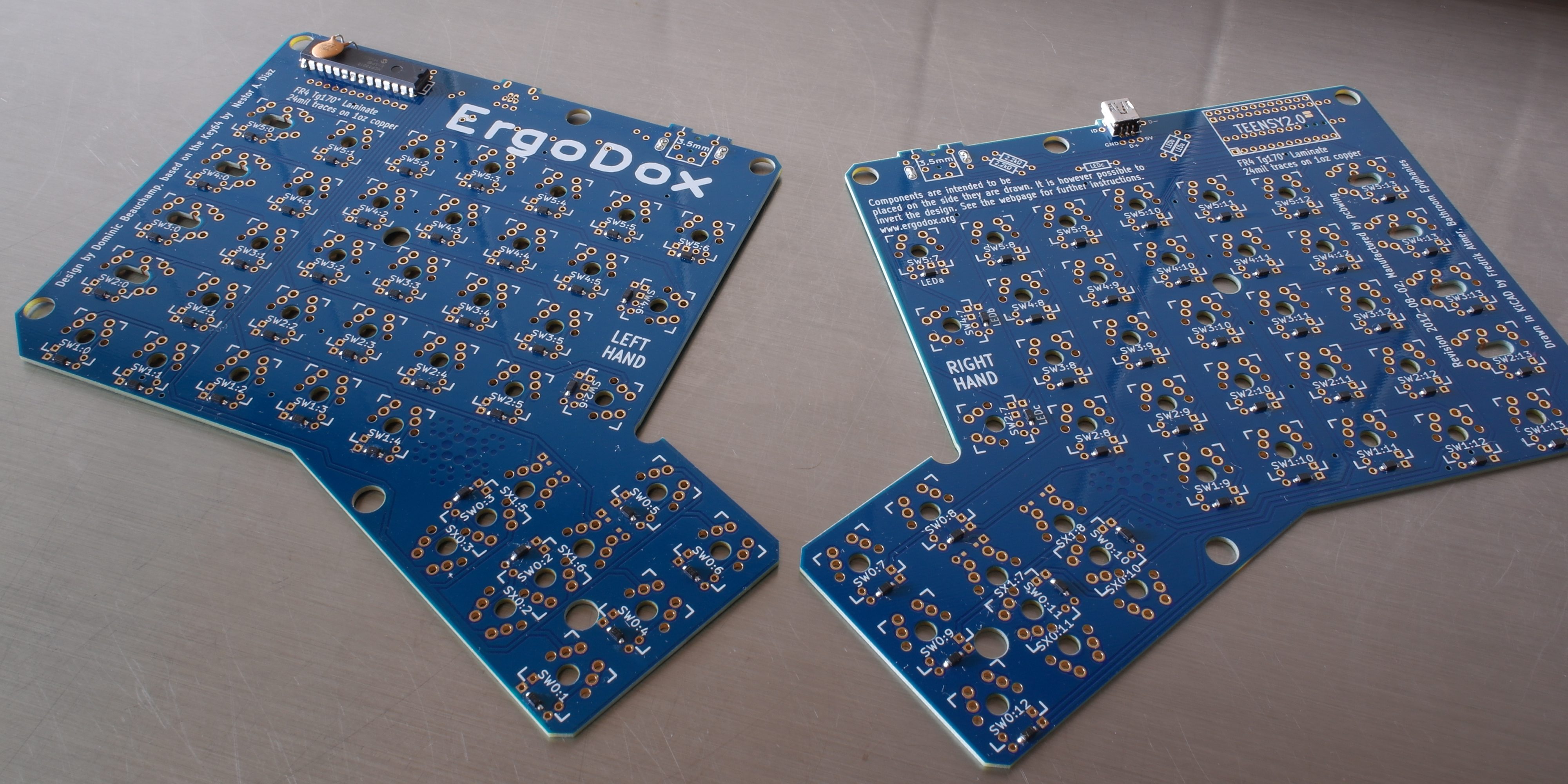

So I did all the diodes this morning, and some of the other components I had at home. I don't actually have any Teensy in good enough condition. I think I am going to put it in a socket on my own ErgoDox as well, to be able to remove it easily for other purposes.
Here is a higher resolution picture, sorry about the dust and flux residues. I should give them a proper rubbing alcohol bath...
I will ship dox and ic07 their boards today.

Those boards look fantastic! It's funny to see all those nice little SMD Diodes... then that huge old Ceramic Cap hiding out in the back, almost like it's bowing down to the SMDs.

regack wrote:Those boards look fantastic! It's funny to see all those nice little SMD Diodes... then that huge old Ceramic Cap hiding out in the back, almost like it's bowing down to the SMDs.
I didn't know they were going to b that big.. I just got the cheapishest 100nF ceramic caps there were. They are only for decoupling and apparently the previous ErgoDoxes have been doing just fine without them.

Haha, yeah, they felt like back to the 90s :)

Could you guys explain what those caps and diodes are good for?
JBert
18 Aug 2012, 00:19
The diodes make sure that the current only flows in one direction - preventing shortcuts in the keyboard matrix which would make the keyboard 2KRO (details left out for brevity).
The capacitor is likely only there to prevent a current spike when the keyboard is turned on - after all, this keyboard has electronics in both parts and powering up everything at the same time might confuse your computer's USB host.

JBert wrote:The capacitor is likely only there to prevent a current spike when the keyboard is turned on - after all, this keyboard has electronics in both parts and powering up everything at the same time might confuse your computer's USB host.
As I understand it, they are in fact used to prevent dips in the supply, as well as to reduce EMI.
