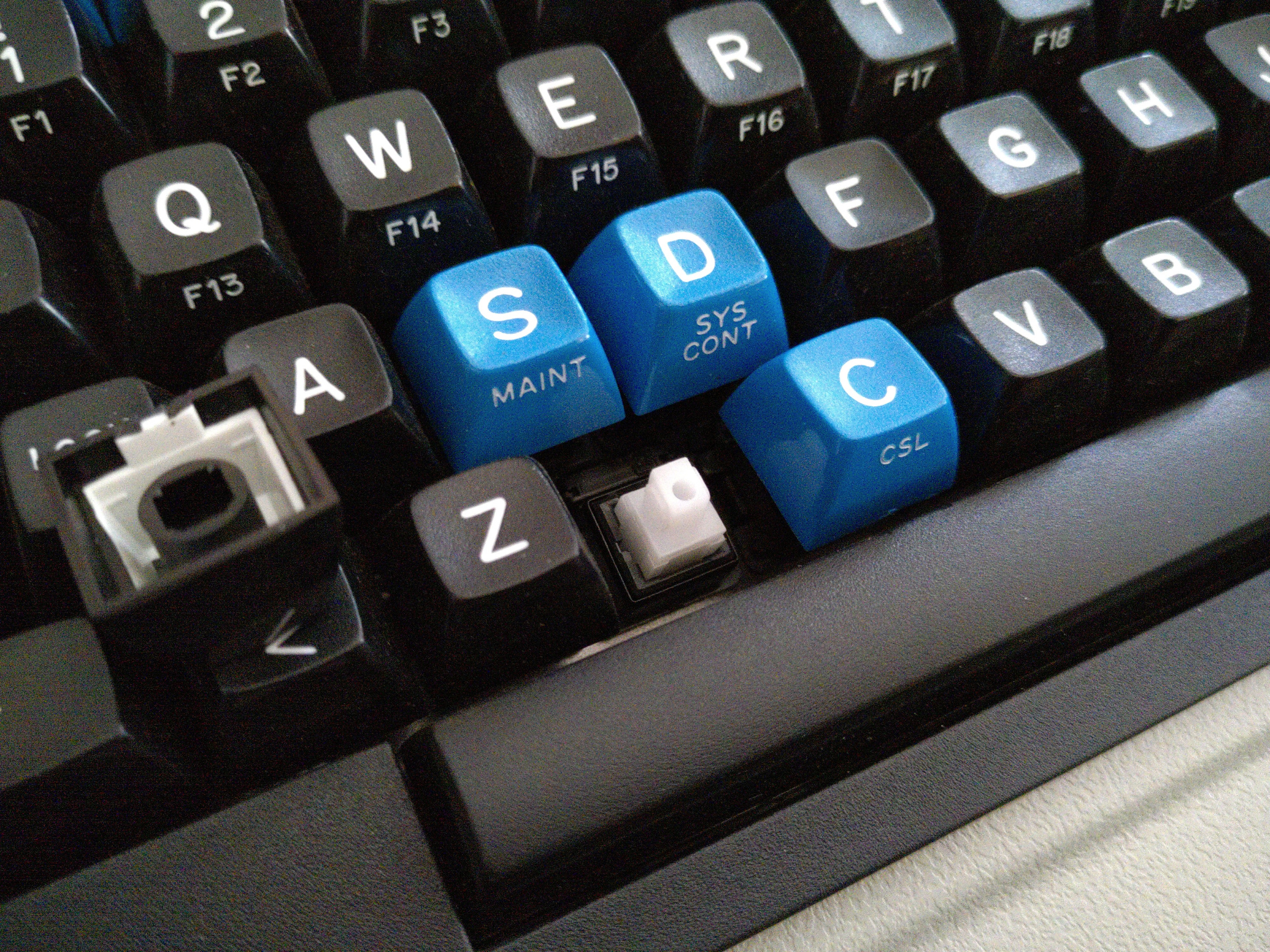

John Doe wrote: 18 Mar 2022, 14:14 So at least there're two variants existing, hall effect and ITW switches respectively?
I doubt if we could distinguish from just observing keycaps.
This one has the ITW switches. Honeywell mount, so indistinguishable by caps.

TNT wrote: 22 Mar 2022, 15:57
Wish its hall effect keeb as I really want one but ITW is aswell cool, I also won one from seller's auctions and its in the mail still, lets see if we could convert it.

TNT
22 Mar 2022, 18:50
John Doe wrote: 22 Mar 2022, 16:02
I think they're a little less thocky than honeywells, but also bit lighter. Still very nice! Definitely interested in converting this one
