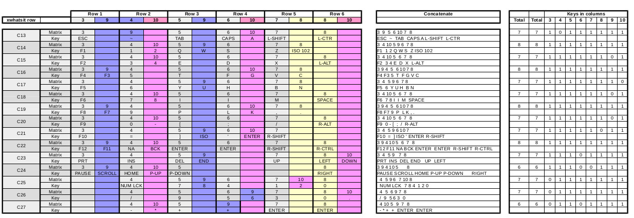

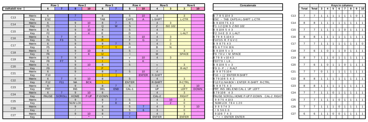

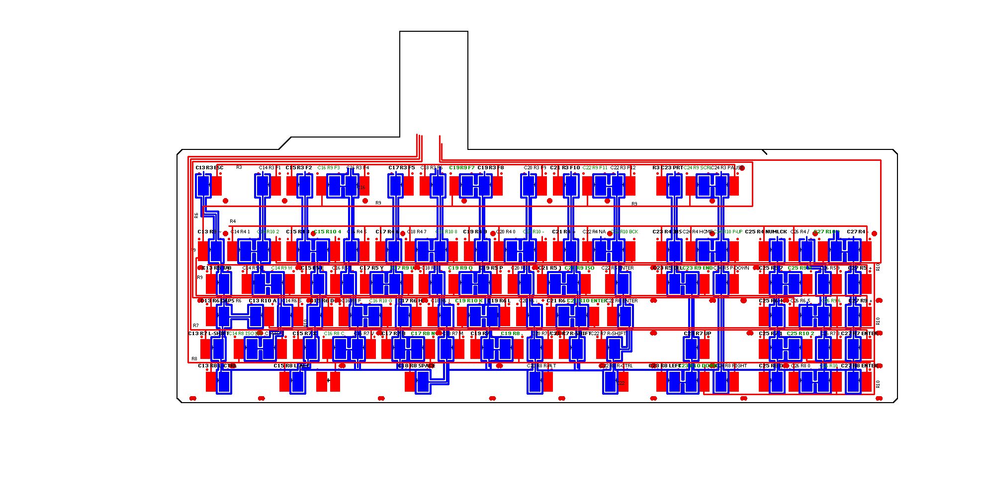

What I am sending with this post is still in draft.
I think that I have managed to create a valid matrix and correct all errors, but I need to check it once more.
table v0.16 .jpg (116.88 KiB) Viewed 10397 times
FSSK v0.16 - bottom - draft.jpg (179.91 KiB) Viewed 10397 times
FSSK v0.16 - top - draft.jpg (217.59 KiB) Viewed 10397 times
FSSK v0.16 - both layers - draft.jpg (255.69 KiB) Viewed 10397 times

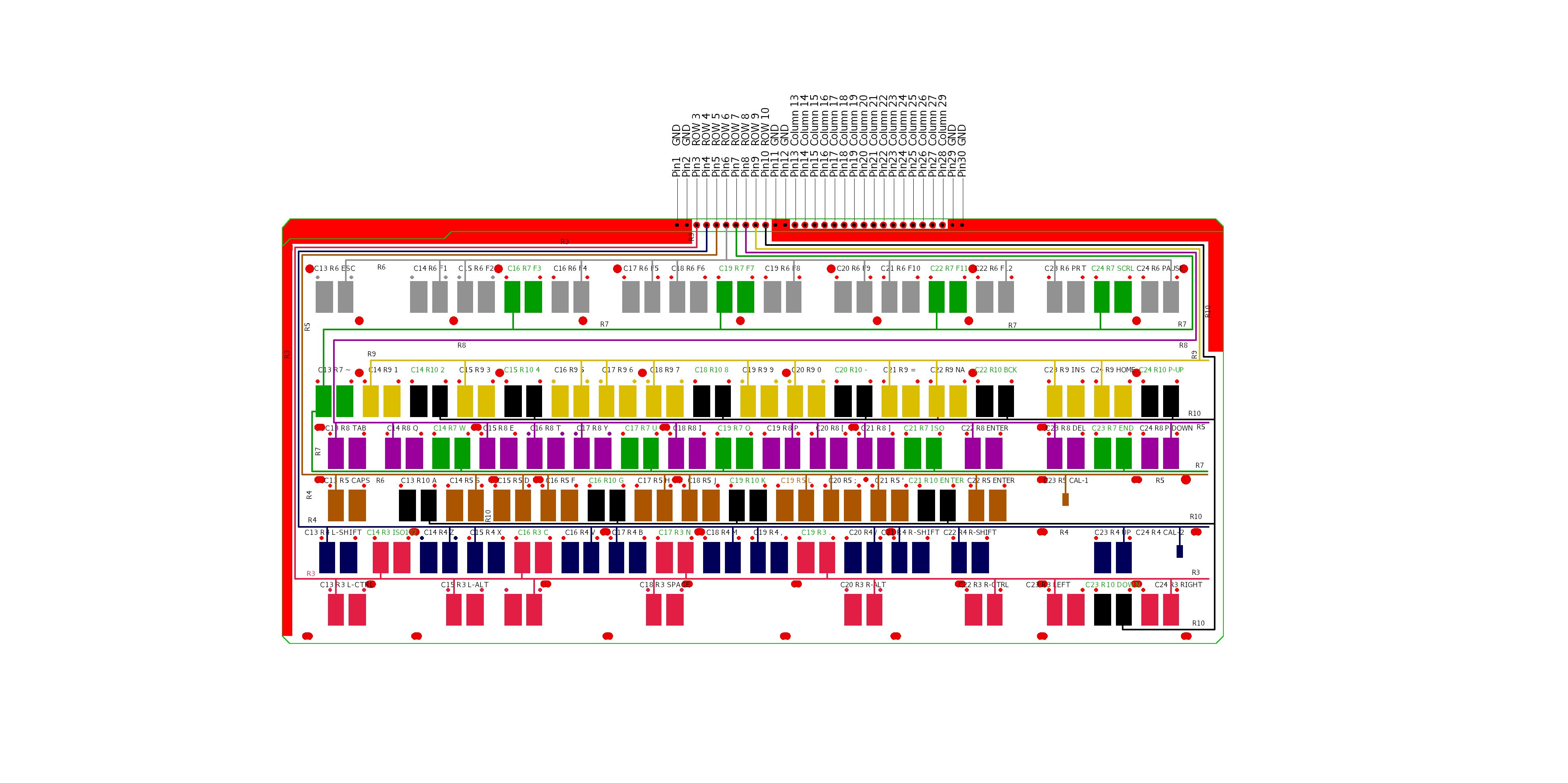

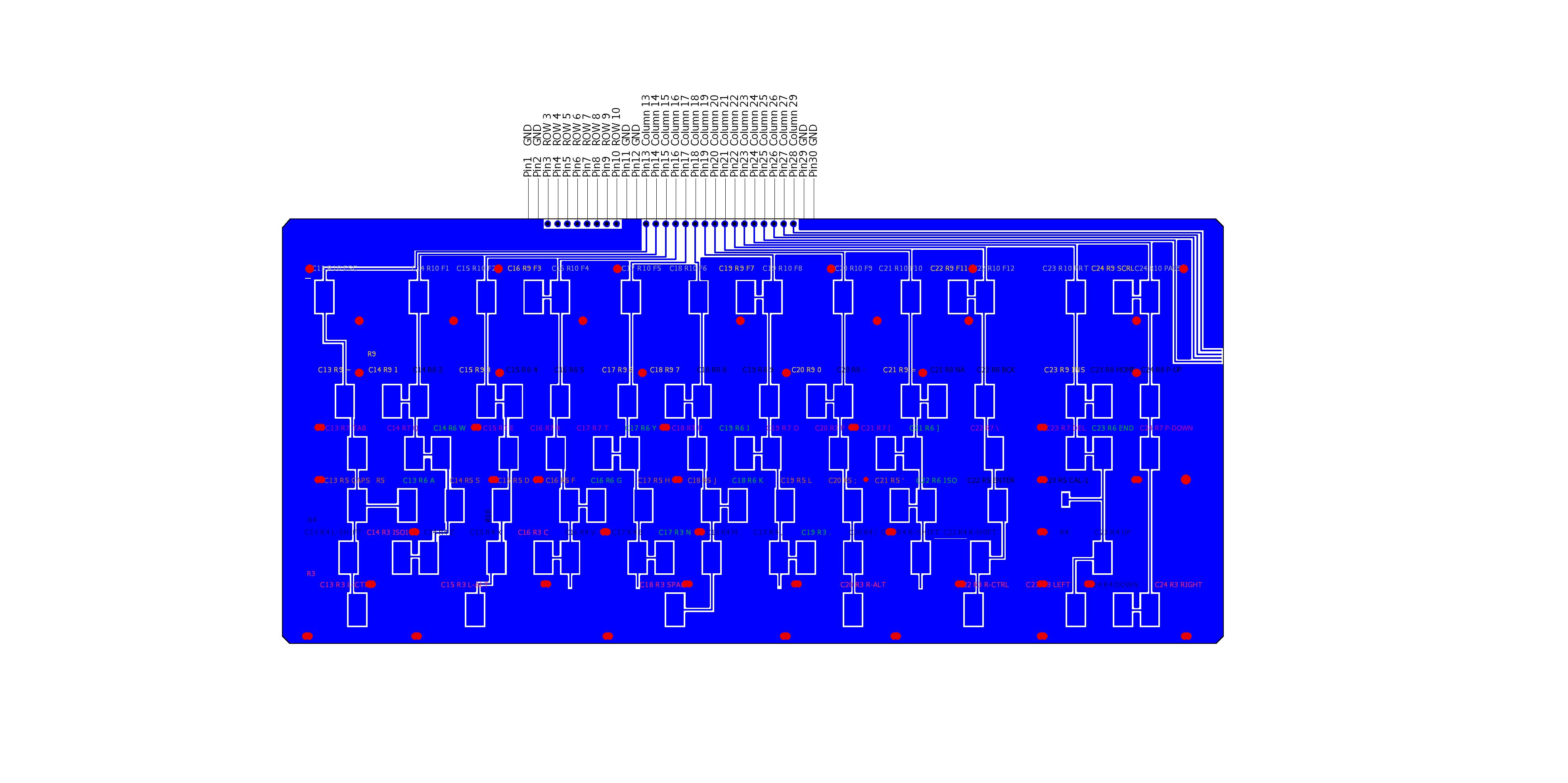

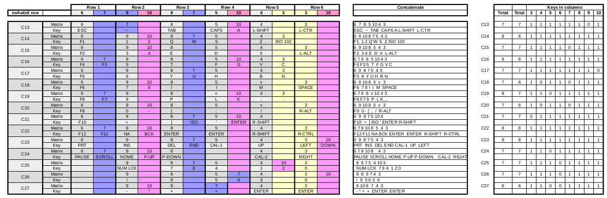

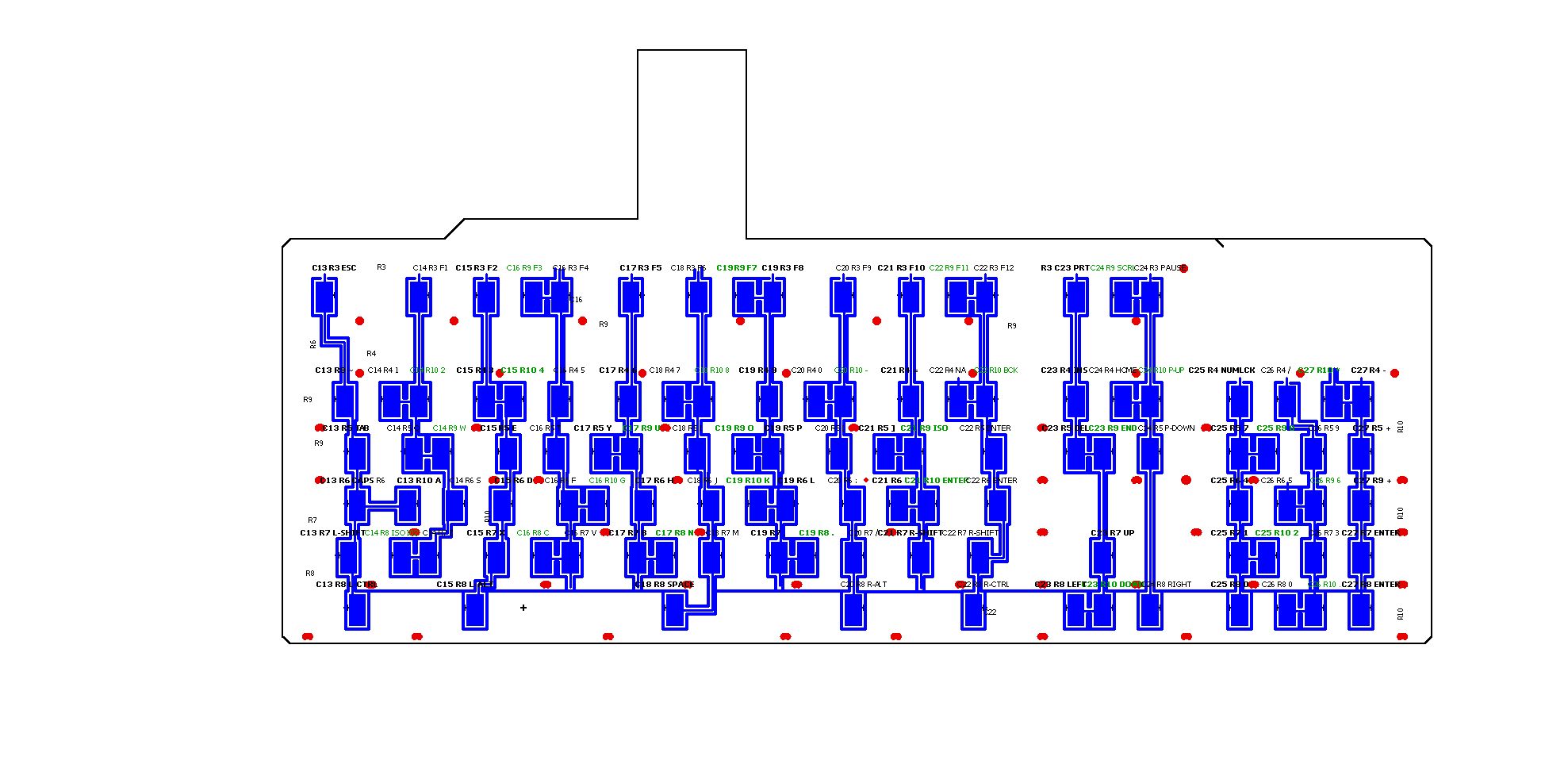

I think that this version, missing the routing to the top of the plate that will connect to the controller resolves all the matrix.
I post the top, bottom and combined layers as well as the table that I am using to track the matrix.
The spreadsheet has a side table counting the number of keys on each row for every column, to ensure that there are not repeated column/row allocations.
I have created a legend for each key in the PCB to track the keys, rows and columns, not only in the table but also in the PCB itself. It consists of three references 1) Column 2) Row 3) key
I will appreciate any feedback
table v0.17 - concatenateC.jpg (182 KiB) Viewed 10360 times
FSSK v0.17 - draft - bottom B.jpg (203.85 KiB) Viewed 10373 times
FSSK v0.17 - draft - top.jpg (232.95 KiB) Viewed 10373 times
FSSK v0.17 - draft - both.jpg (266.16 KiB) Viewed 10373 times

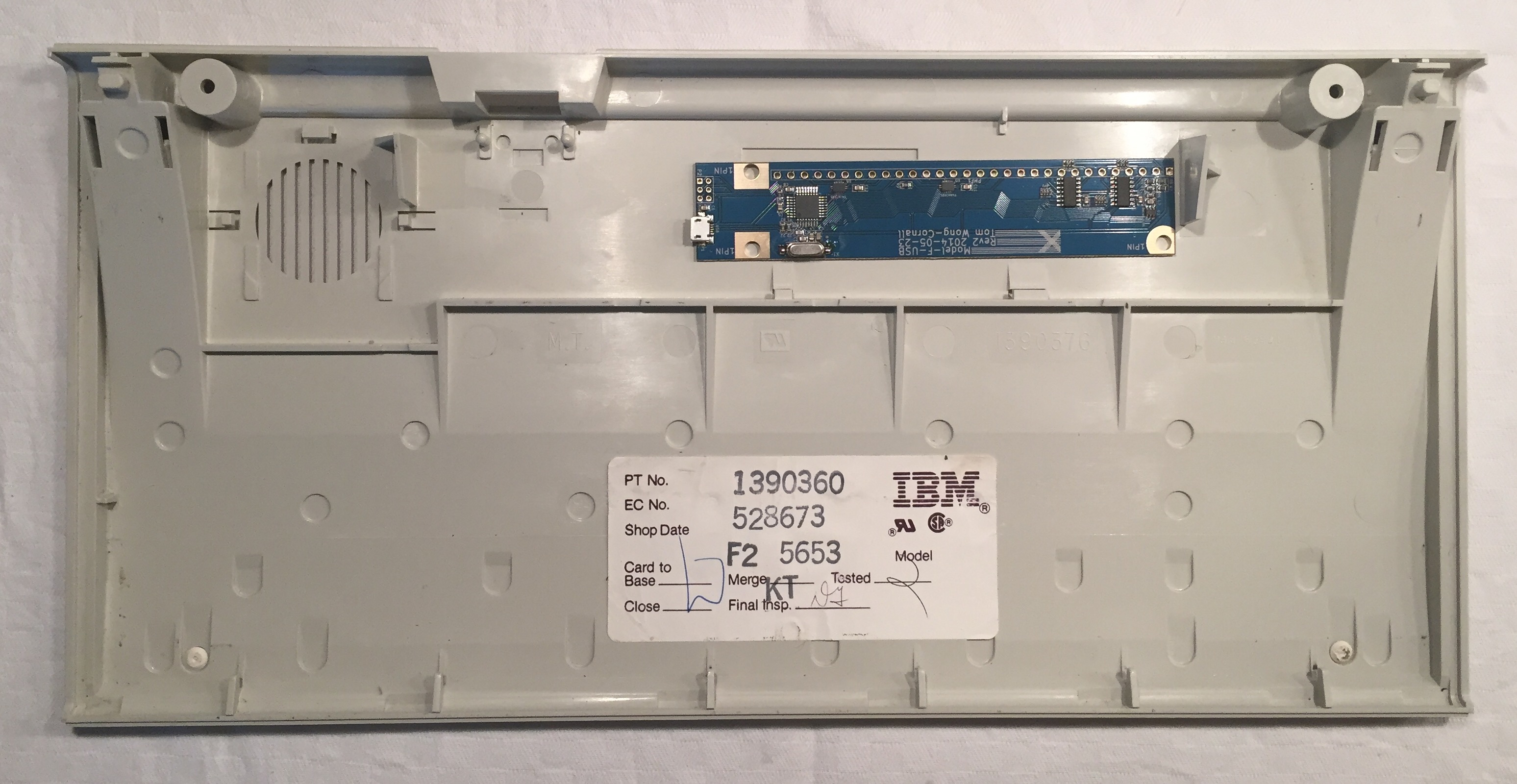

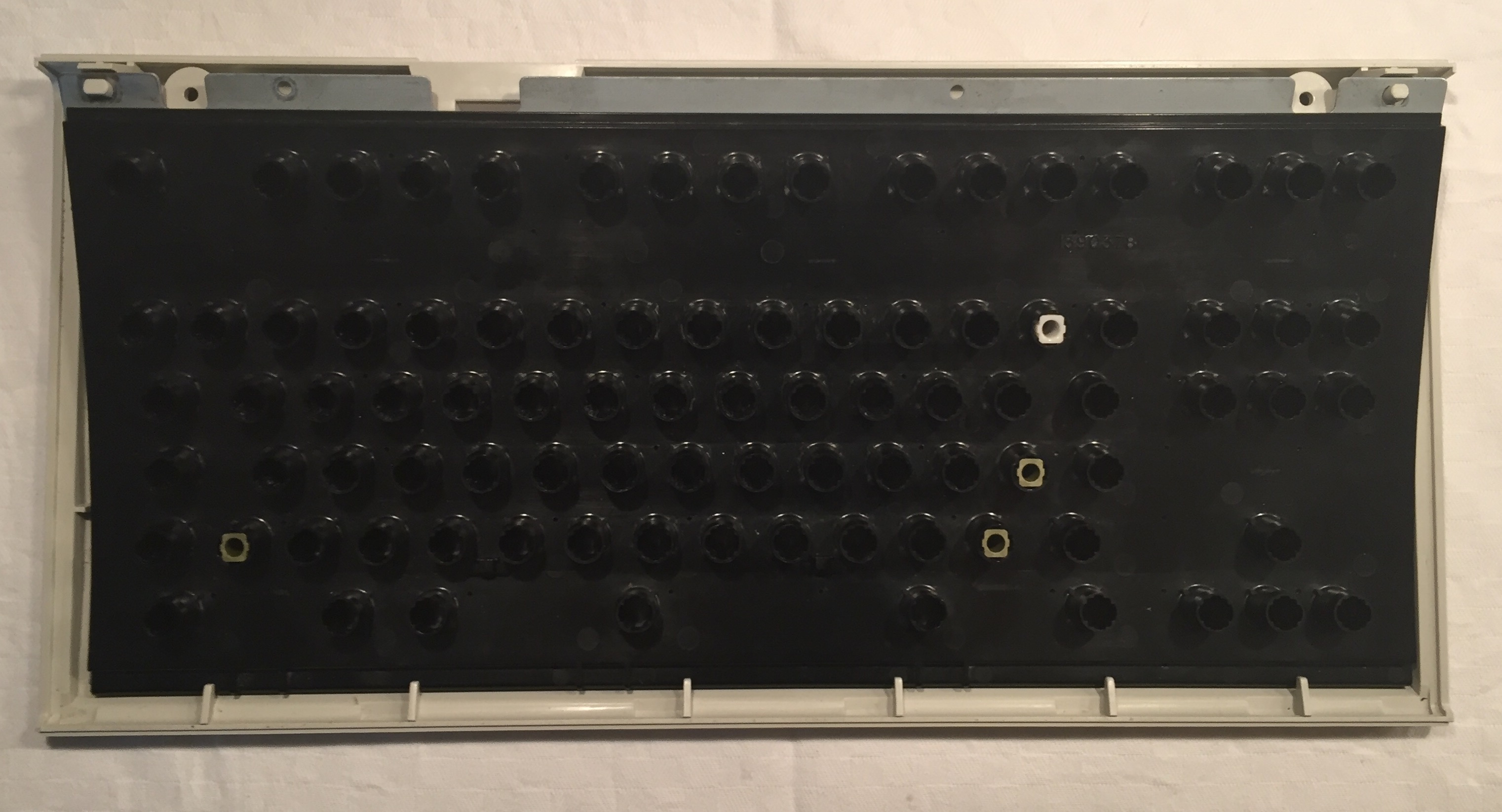

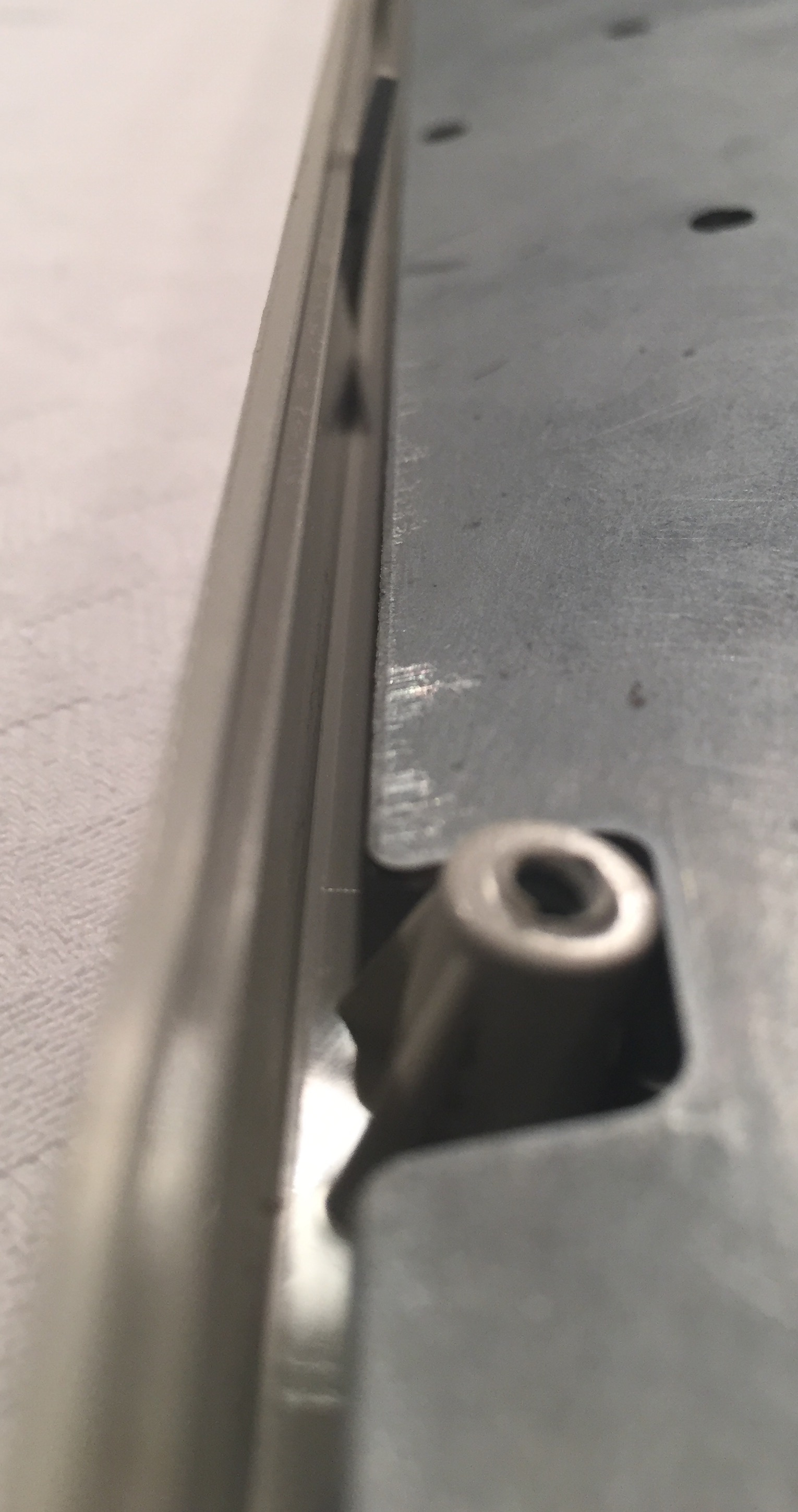

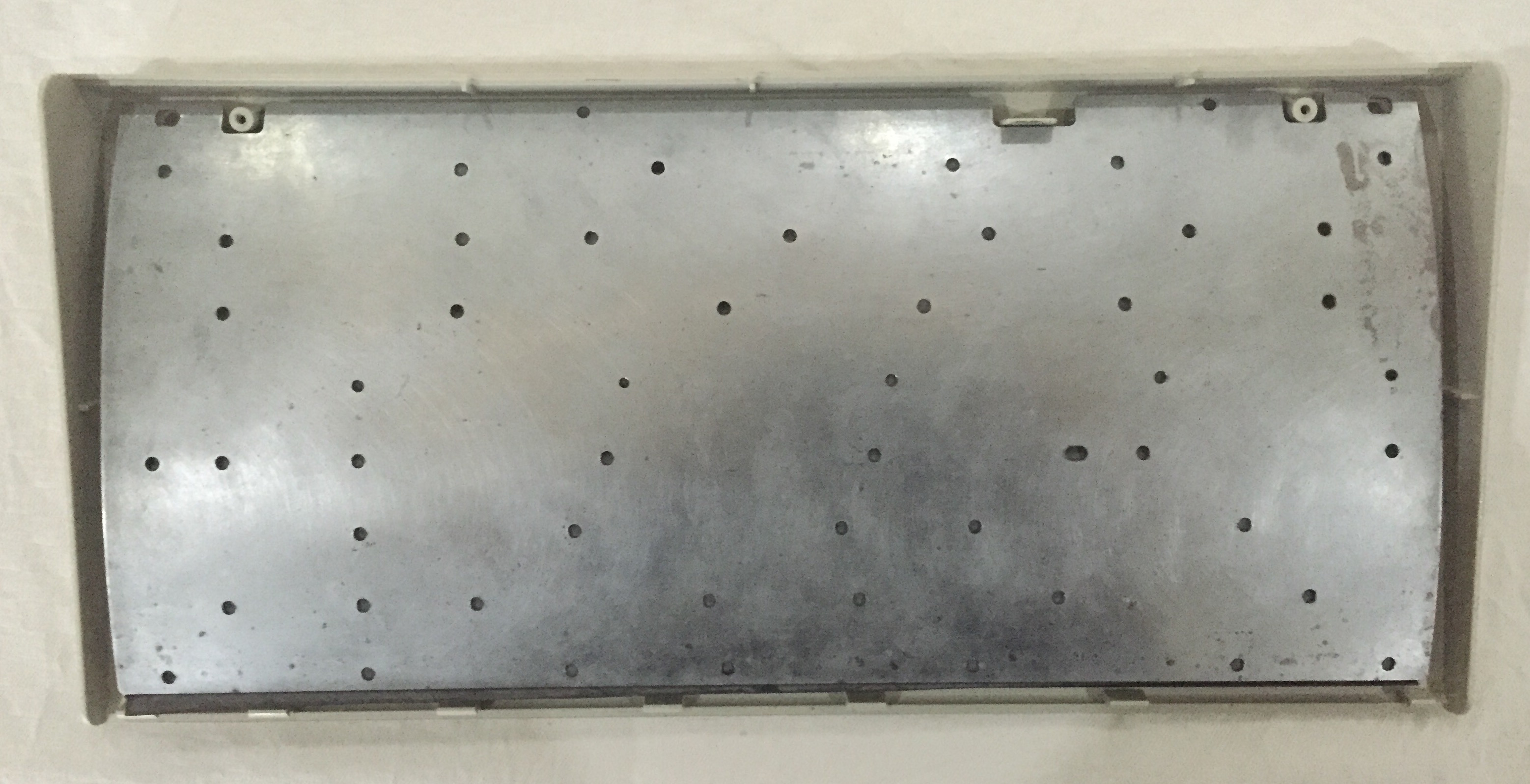

The next step is to route the rows and columns to the xwhatsit controller.
This will not be simple as there is little space between the back plate and the case:

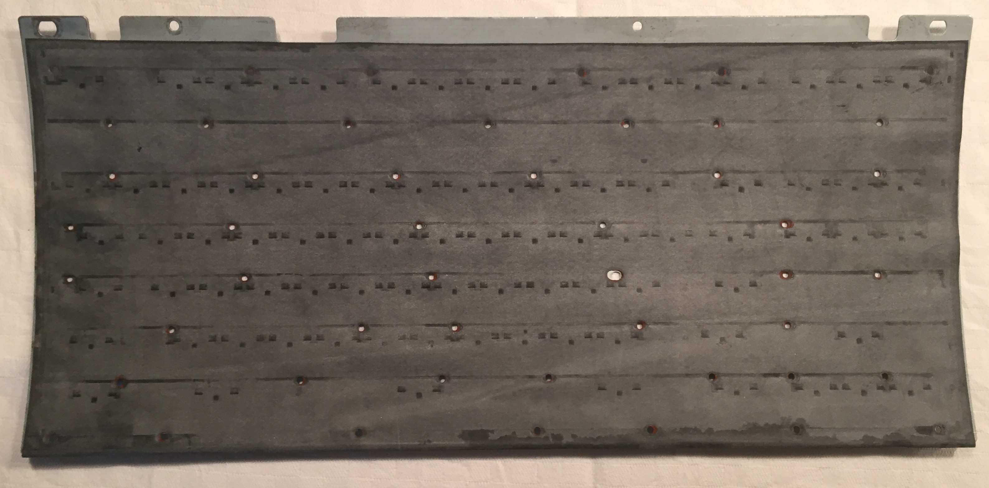

Photo 25-12-15 11 14 19.jpg (607.41 KiB) Viewed 10344 times
Photo 25-12-15 11 14 35.jpg (766.79 KiB) Viewed 10344 times
Photo 25-12-15 11 21 16.jpg (738.88 KiB) Viewed 10344 times
Photo 25-12-15 11 15 10.jpg (531.56 KiB) Viewed 10344 times
My proposed solution is to use the space in on top of the back plate to solder a flat cable that could be routed between the metal plate and the case as the membrane does.
Photo 25-12-15 11 31 15.jpg (633.48 KiB) Viewed 10344 times
We will need to isolate electrically this part of the plate.
I plan to use the original layer between the flippers and the membrane under the pcb ....
Photo 25-12-15 11 34 57.jpg (712.59 KiB) Viewed 10344 times
Posted: 25 Dec 2015, 12:04
by chzel
Wouldn't a length of kapton tape work well enough? I'd prefer if the final solution keeps the rubber mat intact, to easily switch back to regular SSK.
Posted: 25 Dec 2015, 18:02
by idollar
chzel wrote: Wouldn't a length of kapton tape work well enough? I'd prefer if the final solution keeps the rubber mat intact, to easily switch back to regular SSK.
I do not plan to modify the rubber may in any way. I will only use under the pcb.

Posted: 25 Dec 2015, 21:42
by chzel
I'm a bit confused...Shouldn't
C21 R7  be ]}
C22 R8  be \|
C21 R10 be ISO
About the rubber mat, you mean to use it between the PCB and the metal backplate like the F's use the transparent sheet?
Posted: 25 Dec 2015, 22:28
by idollar
chzel wrote: I'm a bit confused...Shouldn't
C21 R7  be ]}
C22 R8  be \|
C21 R10 be ISO
It is even worst, the complete row is incorrect. I miss the "R" !!!
Thanks for pointing it out. I will correct it, both in the table and the references in the PCB.
Yes, this is what I mean.

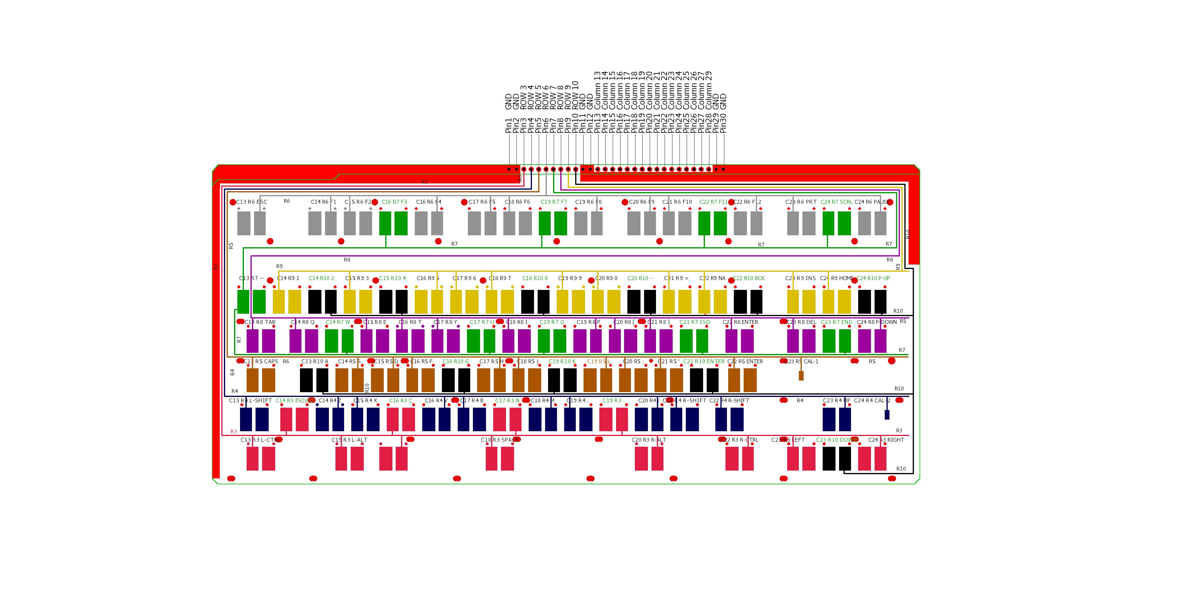

WCASS has commented that each row trace shall cross a column only once.
I need to review the PCBs completely.
Please do not spend time with these versions

Posted: 26 Dec 2015, 04:56
by wcass
IBM did design all of the F with every column crossing ever row exactly one time. The reason for this is that every crossing introduces not-insignificant parasitic capacitance (Cp). Making every row cross every column exactly once is an attempt to keep Cp uniform for every button.
Another thing you will notice about IBM design is that rows gather and come in from one side (with a ground flood on the flip side of the PCB); columns gather and come in from the other side (with a ground flood on the flip side of the PCB). Again, this is to minimize Cp.
Atmel published a great reference for capacitive PCB design. Anyone considering designing a capacitive input device should consider this required reading. IBM and Topre are both "mutual-capacitance buttons", so study section 4.
http://www.atmel.com/images/doc10752.pdf
In this document sense lines are called "Y electrodes" and signal lines are called "X electrodes". On IBM boards, "Y electrodes" run left and right on the top (rows) vs "X electrodes" run up and down on the bottom (columns).
To avoid false keys, use any of the following tricks:
* Cross the X and Y traces as little as possible and then only at 90°
* If the X and Y traces must run parallel to each other for a distance, separate the traces with a ground trace.
* Generally, keep all the X traces together and all the Y traces together. This way the number of potential false keys is substantially reduced.

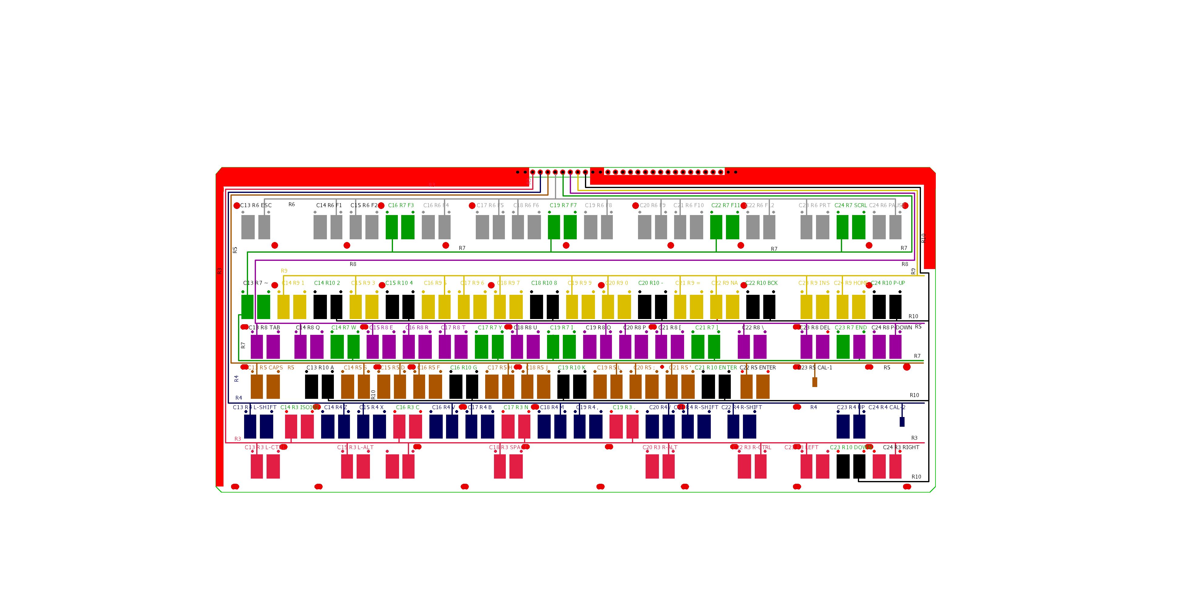

Thanks a lot wcass !!!
Here a new version 0.25 taking in consideration your comments.
I had to move the connector to the left to avoid the overlapping that you mentioned.
Let me know you comments :-)
*) I have worked on the FSSK only. The Extended side will come latter.
Design 0.25.jpg (205.62 KiB) Viewed 10216 times
FSSF v0.25 - bottom.jpg (570.63 KiB) Viewed 10216 times
FSSF v0.25 - top.jpg (513.89 KiB) Viewed 10216 times

Posted: 26 Dec 2015, 14:26
by idollar

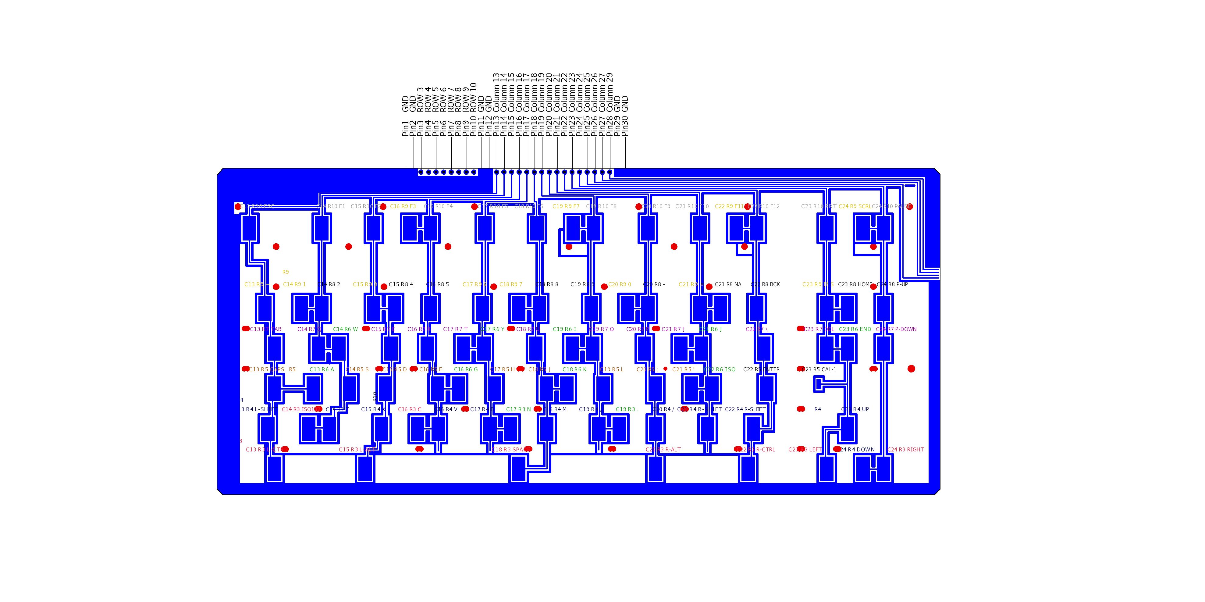

I was thinking that this could make sense for the bottom layer.
What do you think, wcass ?
FSSF v0.26 - bottom.jpg (472.37 KiB) Viewed 10200 times

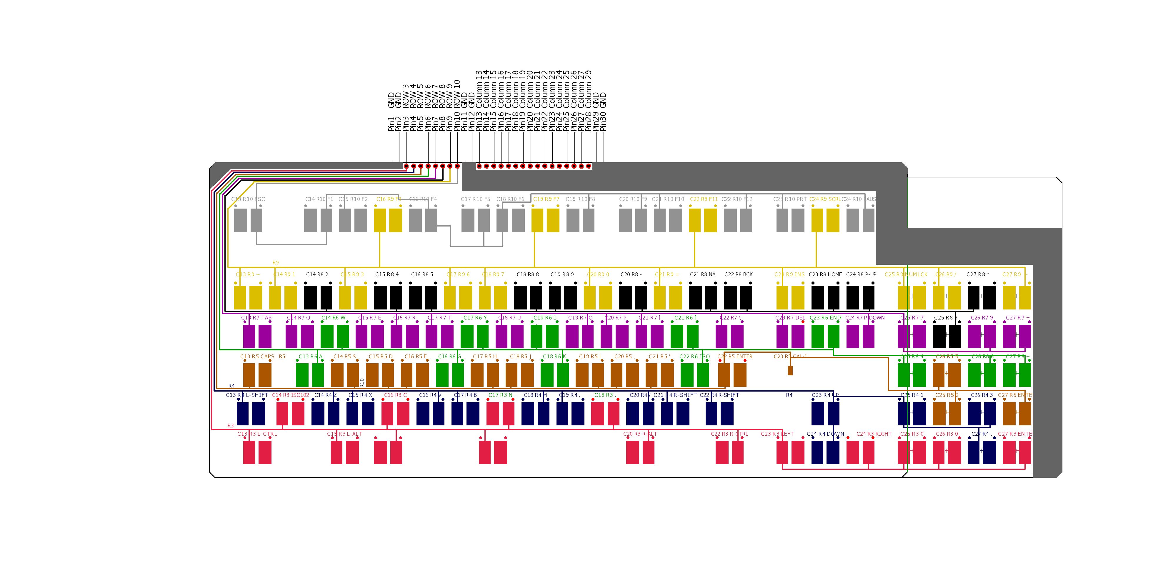

I have worked out the PCB for the full extended Keyboard also:
Design 0.27.jpg (197.55 KiB) Viewed 10145 times
Both layers without the extra ground.
Extended F v0.27 - both.jpg (750.76 KiB) Viewed 10145 times
The top.
Extended F v0.27 - top.jpg (563.16 KiB) Viewed 10145 times
The bottom.
Extended F v0.27 - bottom.jpg (514.68 KiB) Viewed 10145 times

The flood on the bottom should probably be avoided. IBM left it off for some reason.
From section 4.2.3 of the Atmel design guide ...
Bringing ground flood or traces close to Y adds parasitic capacitance (Cp) and can cause loss of sensitivity. Keep this in mind when flooding around keys. ... Be careful when adding ground floods on thin PCBs, as the Cp build-up on Y could be substantial due to the reduced separation between layers.
We are talking about using a very thin PCB ... 0.8mm or thinner.
Posted: 27 Dec 2015, 10:22
by idollar
Thanks. Got it.
I add it as new layers to the PCB. They are easy to remove.

Hello again,
I have been working in a new version, which tries to capture and implement all the comments that I have received so far.
Here it is:
Matrix
Design 0.30.jpg (696.2 KiB) Viewed 10030 times
FSSK
FSSK 0.30 - top.jpg (506.8 KiB) Viewed 10028 times
FSSK 0.30 - bottom.jpg (566.3 KiB) Viewed 10026 times
FSSK 0.30 - both.jpg (679.2 KiB) Viewed 10028 times
FEXM
Extended 0.30 - top.jpg (576.17 KiB) Viewed 10028 times
Extended 0.30 - bottom.jpg (624.04 KiB) Viewed 10028 times
Extended 0.30 - both.jpg (776.3 KiB) Viewed 10027 times
I would appreciate comments.
Next steps are to print out the layers, test them, produce the PCB and to enjoy :-)
Posted: 30 Dec 2015, 04:21
by wcass
One thing i noticed is that the bottom row (pin 3) does not cross any columns. All of IBM's designs have every row crossing every column exactly one time and I made sure i did that with the XTant, but I'm not sure how much difference this makes or what it does. My best guess is that it is an attempt to make all of the rows/columns as uniform as possible vis-a-vis Cx and Cp.
I think you see what i was talking about earlier; this being difficult to do with IBM's original capacitive pad design due to the number and location of the model M rivets. You might look at some of the other capacitive pad designs that i suggested earlier in this thread that allow the rows to pass through the center of the switch rather than forcing them to always go around. At worse you will have one trace competing with a hole in the space between rows rather than two.
