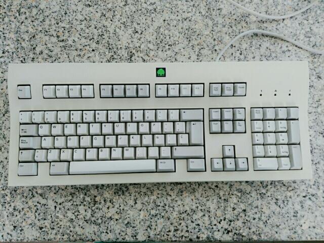

Somebody know something about the second one from up or if it matchs with this board?

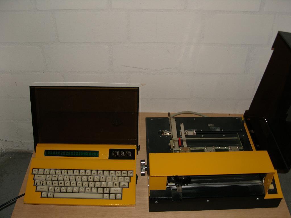

Hey. Am I right in assuming that keyboard is Cherry made and will almost certainly have MX blacks? Nice spherical caps, eh? Still trying to convince the owner to sell / send it to me without that monster of a printer, though...

I'm almost certain it has Cherry M8 switches, see: wiki/Cherry_G80-0662
Most likely that's Cherry M8. These keycaps look like the flat cherry caps and Cherry liked to use those with M8 switches (eg the G80-0662). Also this is a laptop so it would make sense to use low profile switches, there are some other laptops which use M8 + these caps too.
As far as I know these style of caps can come with mx black too but there is a low profile and a medium profile version of the caps, I would expect that the medium profile version comes with MX but I don't have personal experience in that regard.
The laptop with the printer is still a nice thing due to its absurd color, lovely piece of computer hardware

M8 - I see, thanks a lot. I'll pass then. Seller in Germany is only asking for 20€, but it might be tough to convince him to mail it. Here is the URL: https://www.ebay-kleinanzeigen.de/s-anz ... pp_android
- Daniel Beardsmore
- Main mouse: MS IMO 1.1
For $5 I would be very tempted, as those switches (Peerless) are really interesting, and that one has proper 105-key ISO layout (mine's only 102-key, which is a deal-breaker for me). Be careful about cleaning though as the space bar has a weird little spring around the stabiliser wire for stiffness (mine's around the wrong way and it's jammed the space bar solid) and the wide keys may need lubricating after cleaning otherwise they can become too stiff to use. (I've never tried to resurrect mine.)
