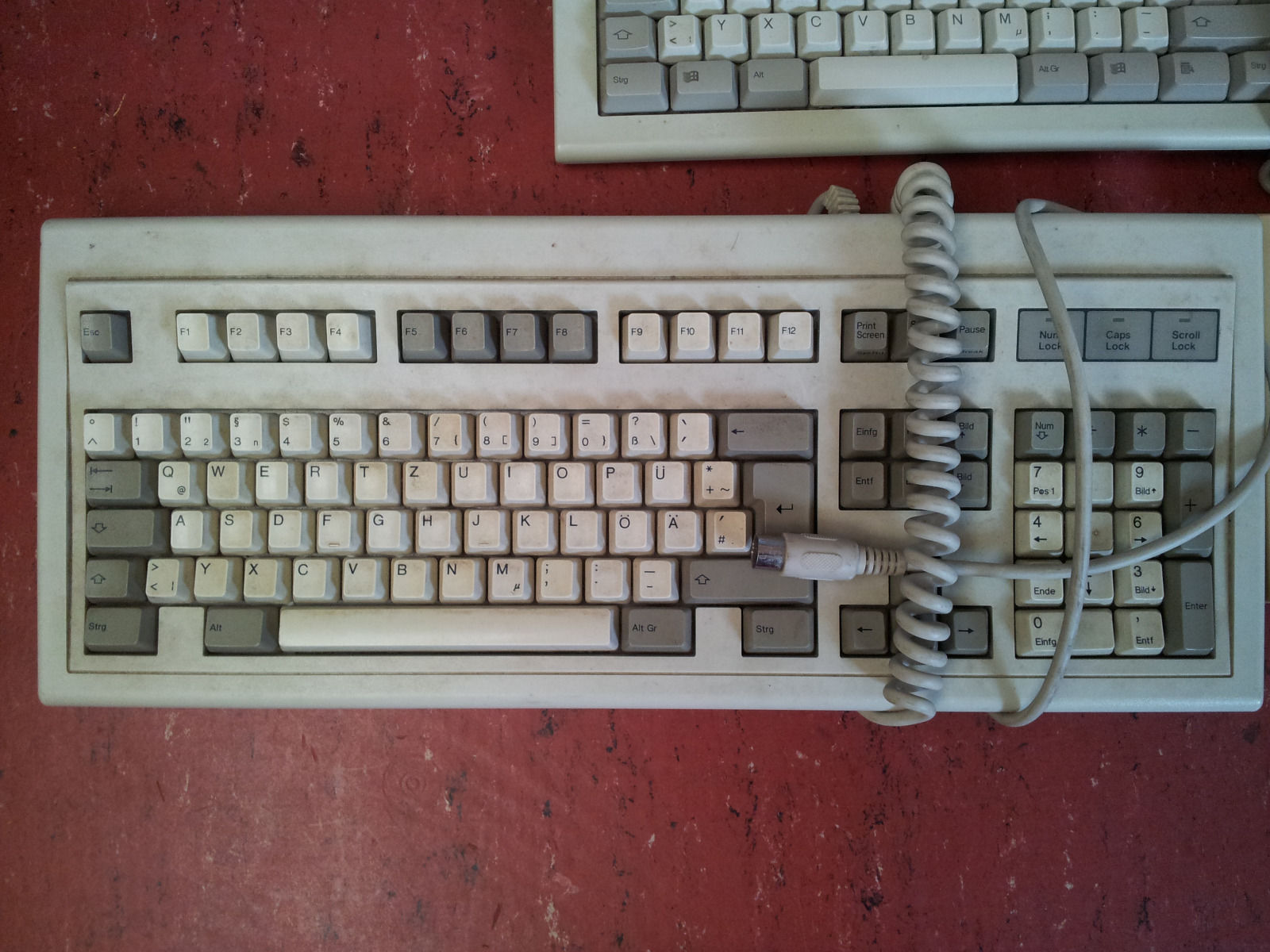

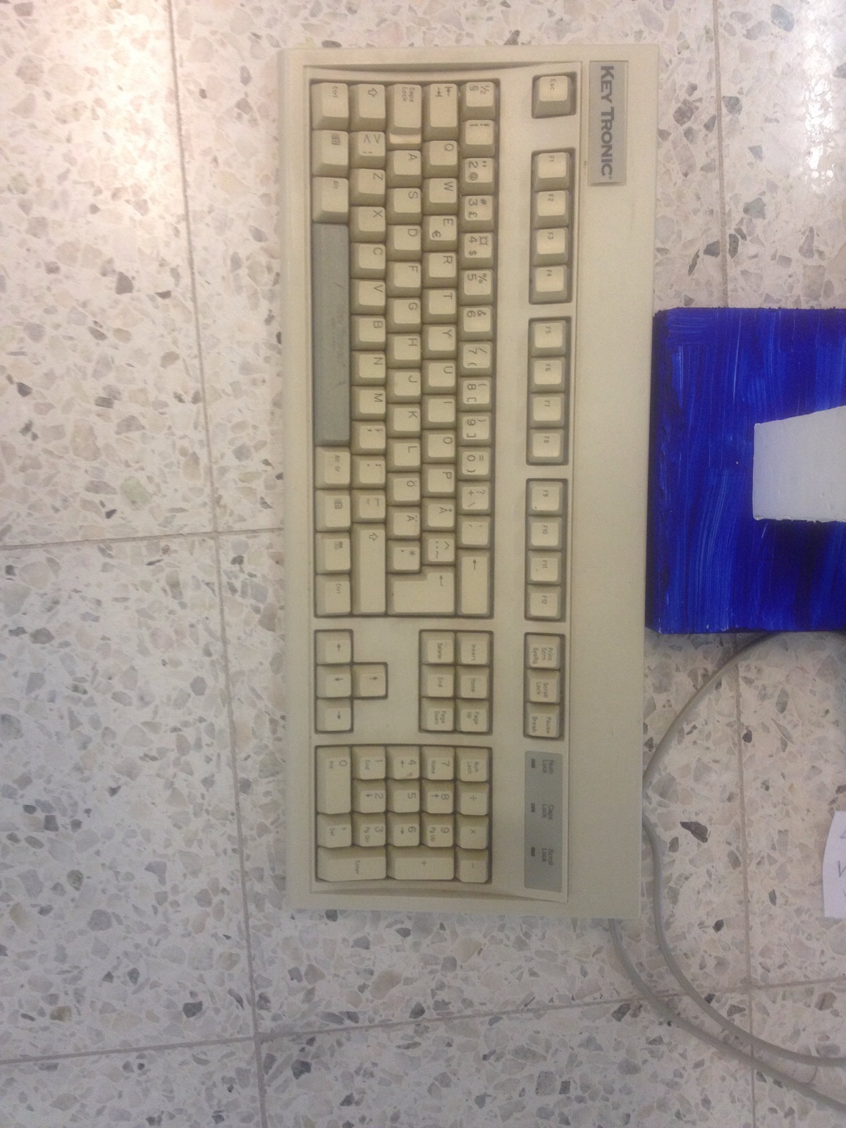

zuglufttier
23 Oct 2015, 14:27
Does anybody know what these two boards may be? Is the key tronic something to consider? I might get it for free...
terrycherry
23 Oct 2015, 14:40
Free is not to afraid which switch it has. Just bring it and shot the switch to us. We"ll id it later. Don't worry.
23 Oct 2015, 14:56
Key Tronic will be either overrated rubber dome or foam and foil, almost certainly the former in this case. The scond I'm not sure about.
zuglufttier
23 Oct 2015, 15:15
OK, I can't get the key tronic anyway but I think I'll get the other board in a few days... I'll post some pictures if it doesn't feel like crap to begin with ;)
