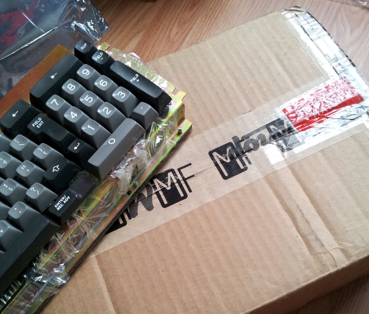

A package arrived to my door today.
Looks like someone run out of plain packing tape :)
Now I'll let it sit for a couple of hours - it's not like condensate formed on it, but I'm not taking chances.
And then I'll bring it to the scope.

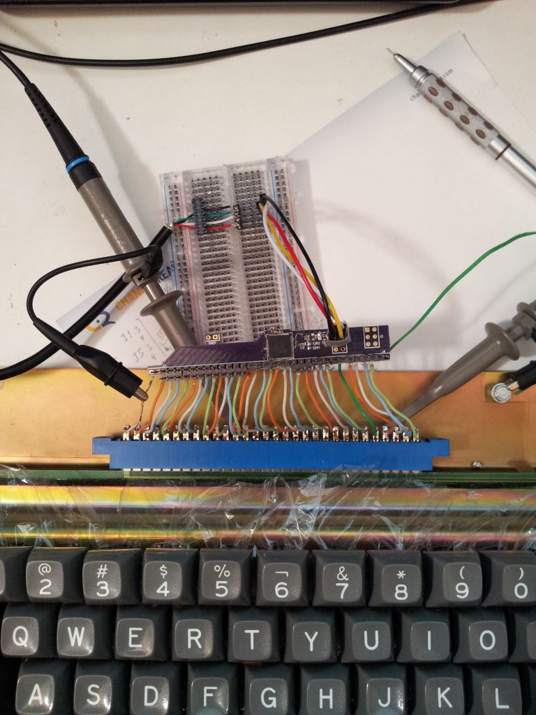

19 Mar 2017, 09:00
Wingklip wrote: Wait you have beam springs? Please send me one I'll pay xd
Got one on loan from lot_lizard.
Looks this way now:
I'm afraid it's not for sale though.

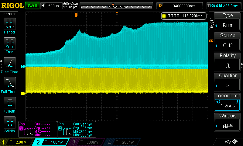

In other news - beamspring gives ~2 times stronger signal than F122, doesn't mind being driven by rows, scanrate 7.75kHz, and (surprise!) is bouncy on the way up: if you lift your finger too quickly, you have a chance to get this:
I.e. hurray, unified capsense hardware is possible and lies at my table.
